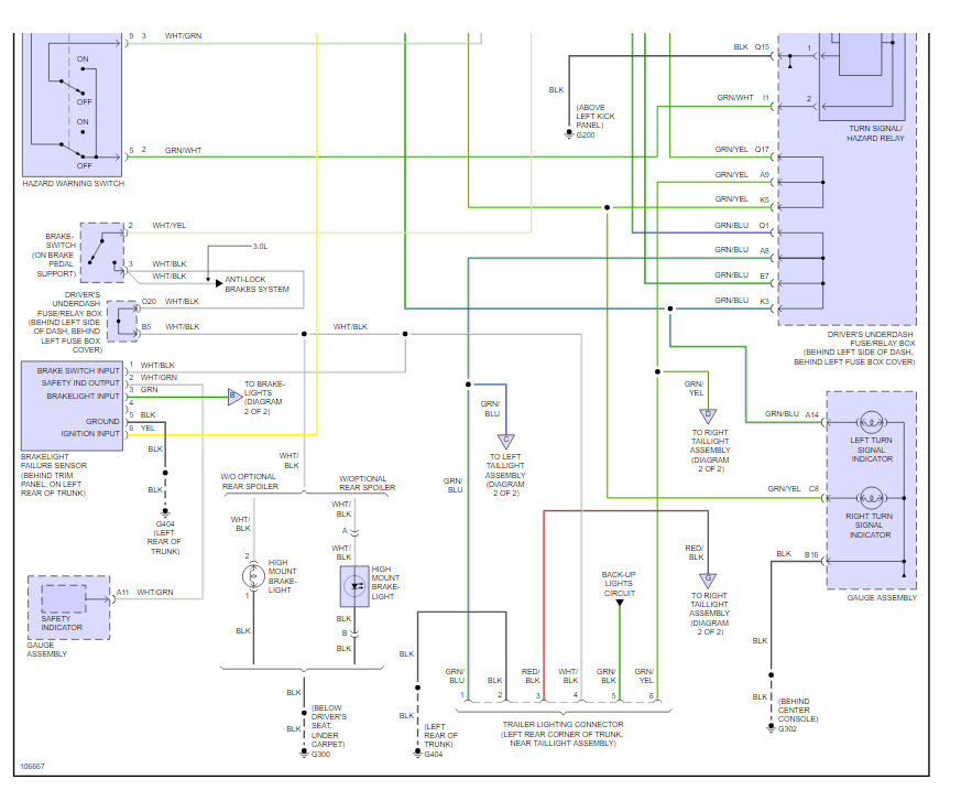

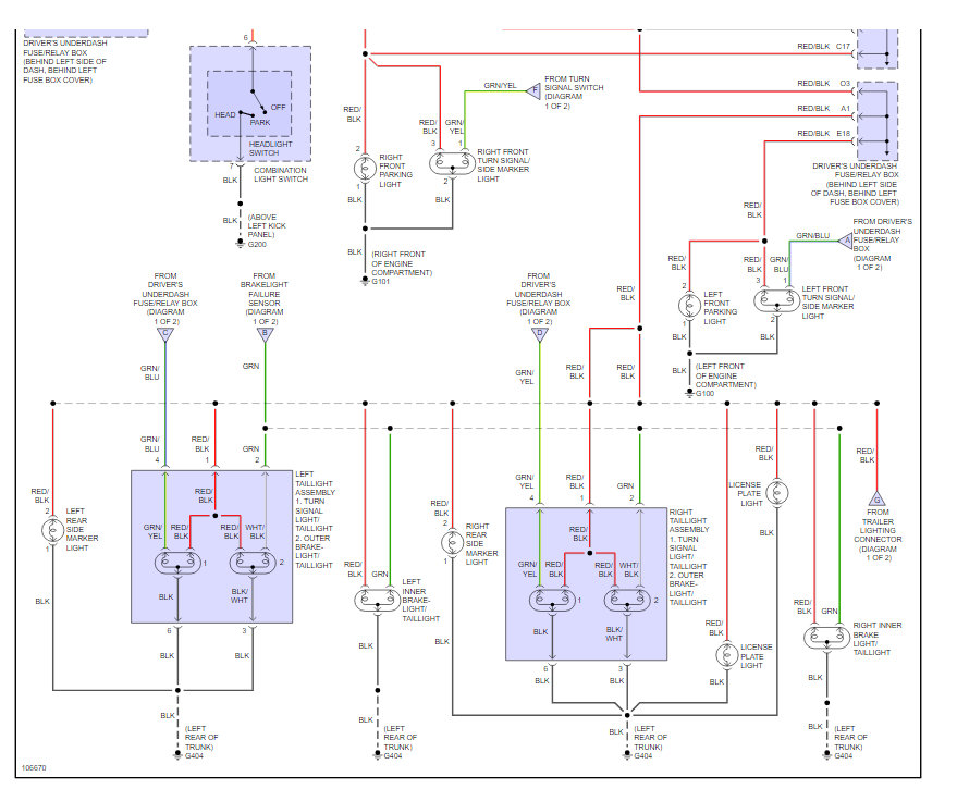

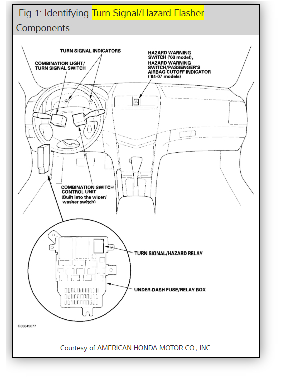

Yesterday I was at a turn and switched on my left signals. They were working normal but then suddenly stopped working. No clicking sound, no indicator on the dash as well.
Few things I checked:
1) Bulbs are fine, the indicator lights come on when i lock/unlock the car
2) All the fuses are fine.
3) Hazard switch only glows the right side signals front and back but the entire left side is not working.
4) Right side lights works like they should.
After doing my own research, I think the flasher relay could be bad but not sure at all. If someone thinks that relay is bad then please for everyone's knowledge explain the difference between a turn switch fault vs flasher relay fault vs blown fuse.
Thank you
Sep 24, 2019 at 1:08 AM
  • 55,224 POSTS

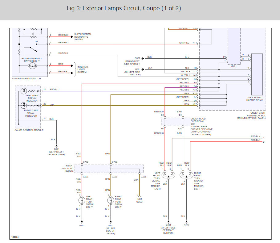

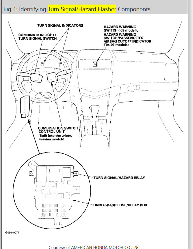

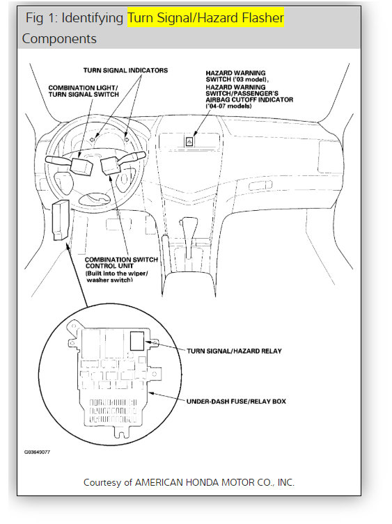

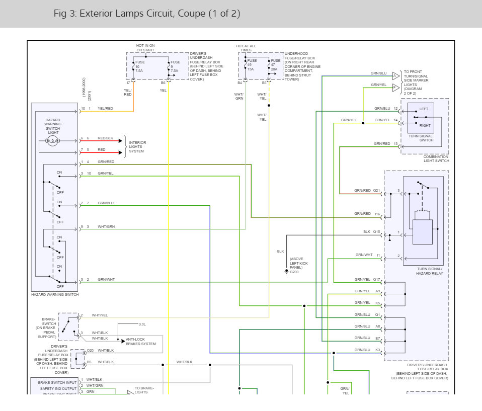

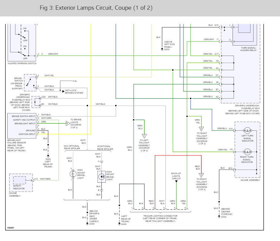

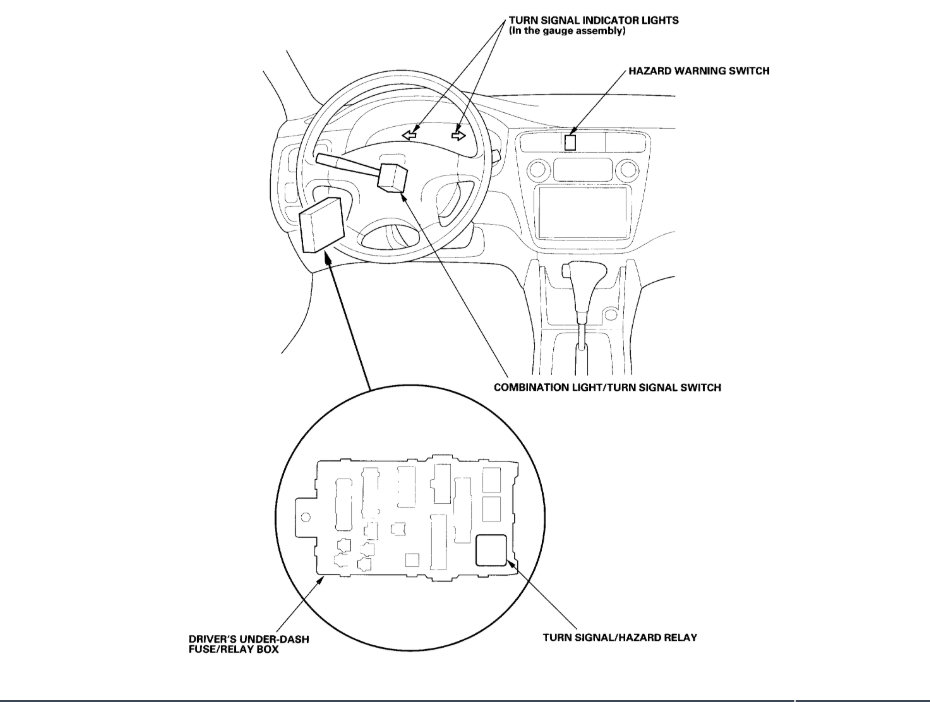

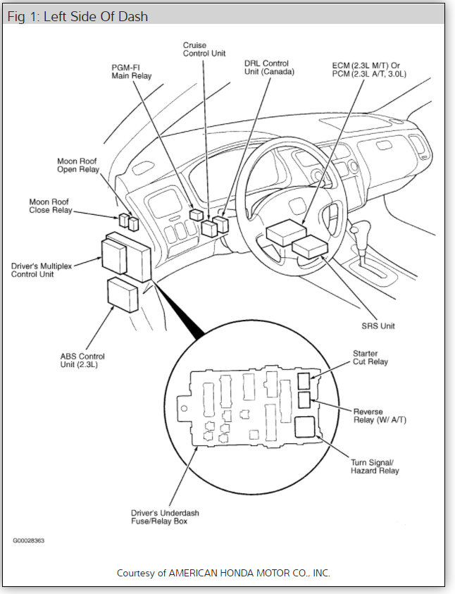

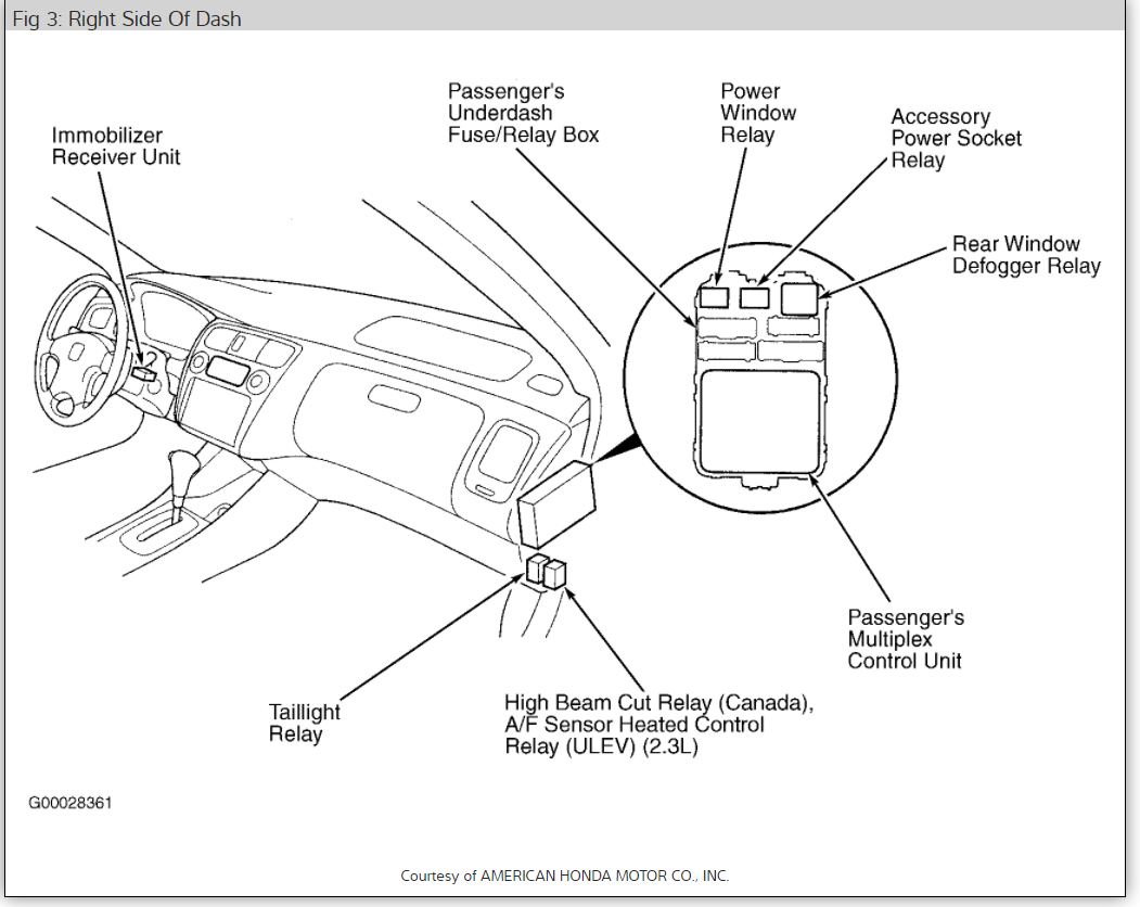

It sounds like the flasher has gone out which is common. To be sure here are the blinker wiring diagrams and the flasher location below and a guide to help check for power to see where you loose it:
This guide can help as well
https://www.2carpros.com/articles/turn-signals-not-working-blinker
Nov 3, 2020 at 3:26 AM
ASH_K
Hello Ken,
Thanks for digging out the wiring diagram for me.
I just used the method of elimination and found that the flasher relay was indeed bad and replaced it and now the signals work fine.
Here's how I worked it out with few points that I noticed:
1) If the fuse blows then the power to both sides will be interrupted but in my case right side was working fine.
2) If it was the turn switch then the hazard lights button should have both sides flash but in my case it only made the right side light come on.
3) If the bulb blows then the light should flash faster but in my case it didn't work at all.
So, flasher relay was my prime suspect.

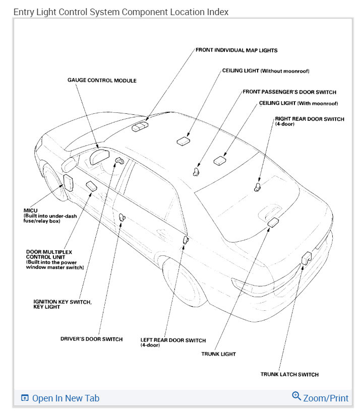

My hazard lights still work though. I can't find a fuse for the turn signals. but i have replaced the relay, both the turn signal switch and the combination switch.
May 17, 2021 at 5:21 AM (Merged)
  • 55,224 POSTS

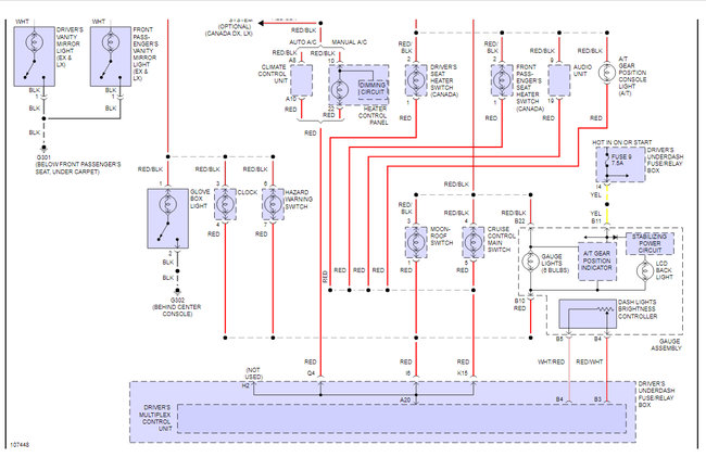

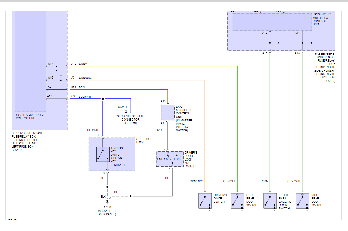

By relay do you mean the turn signal flasher? because that is what controls the blinkers. Here is a turn signal wiring diagram so you can see how the system works and the flasher location as well. Check out the diagrams (below). Please let us know what you find. We are interested to see what it is.
LEX109
  • 8 POSTS
Yes sir, the turn signal flasher.
  • 55,224 POSTS

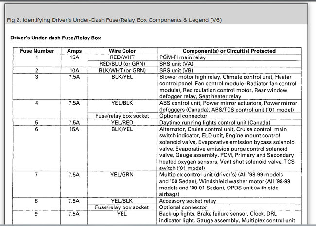

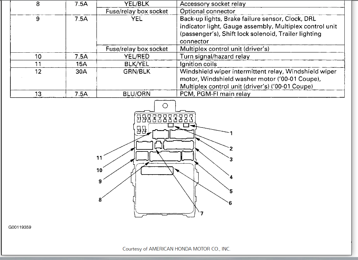

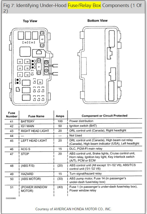

Do you have power at fuse #7 and 21?
Here is a guide and the fuse locations:
LEX109
  • 8 POSTS
Yes, there is power to those two fuses.

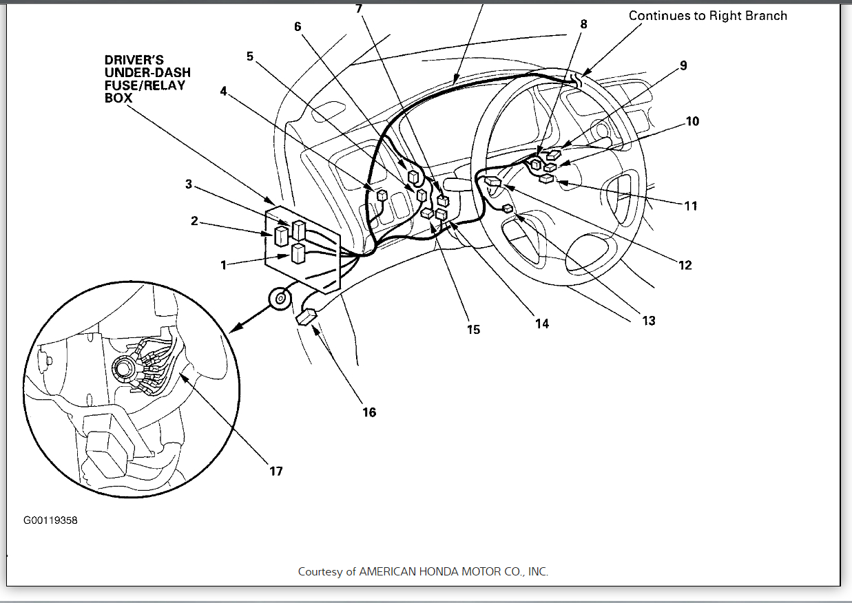

  • 55,224 POSTS

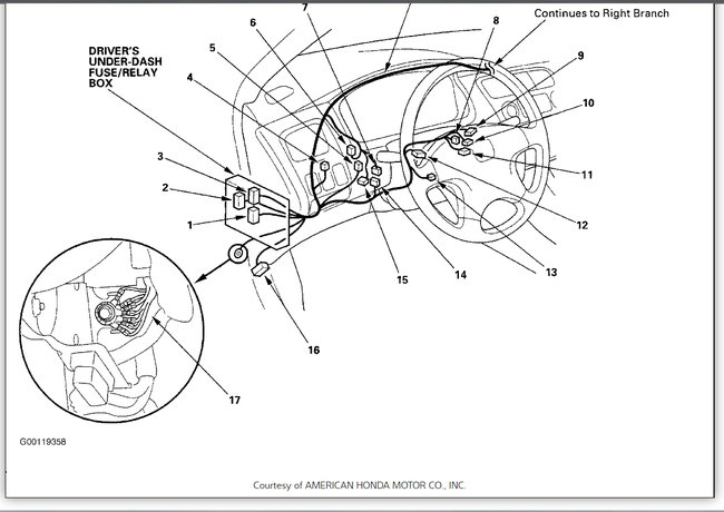

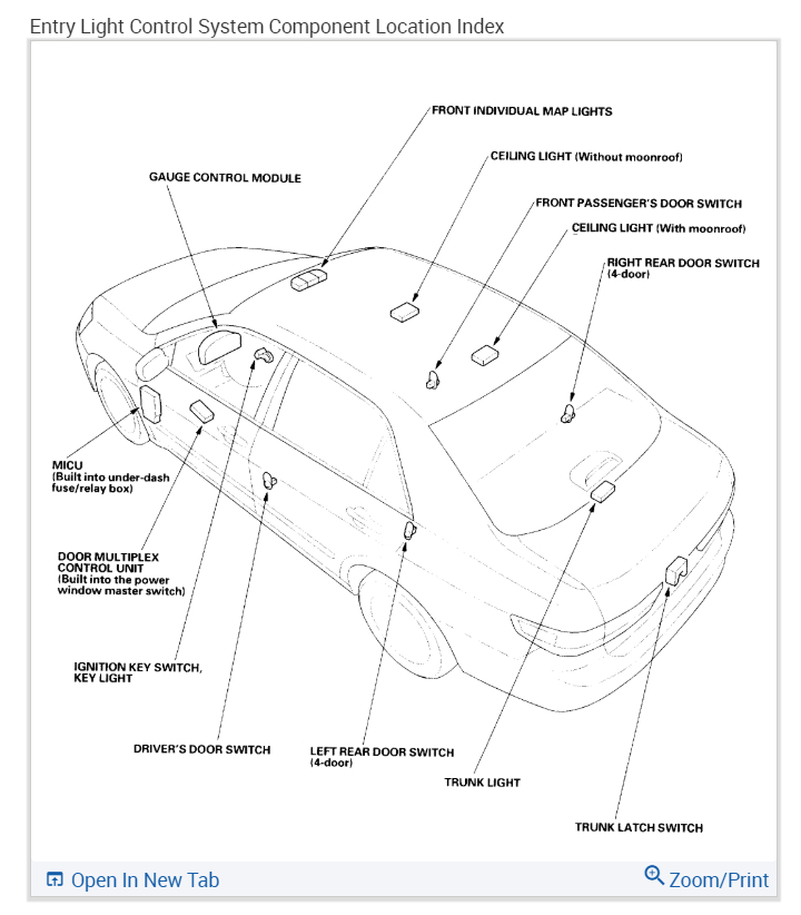

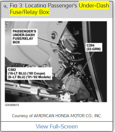

Then is looks like the MICU is the problem which is built into the fuse panel. Here is the location. Check out the diagrams (below). Please let us know what happens.
LEX109
  • 8 POSTS
Would you know where to buy this at?
This part is built into the under dash fuse panel. Unfortunately, this may be a dealer only option or a salvage yard. I checked a few of the major parts sites and they don't offer it. The reason is, it is not a common part so they won't sell a lot of them which means they won't make much money off them.
Sorry to not have a better answer for you.
LEX109
  • 8 POSTS
I replaced the MICU, but now the left blinker won’t stop blinking and the right side still isn’t blinking.

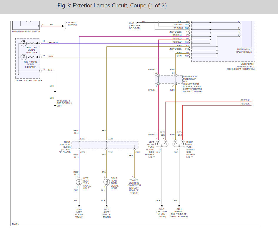

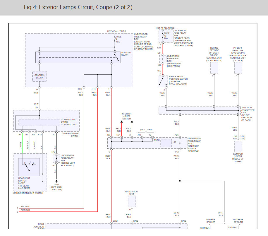

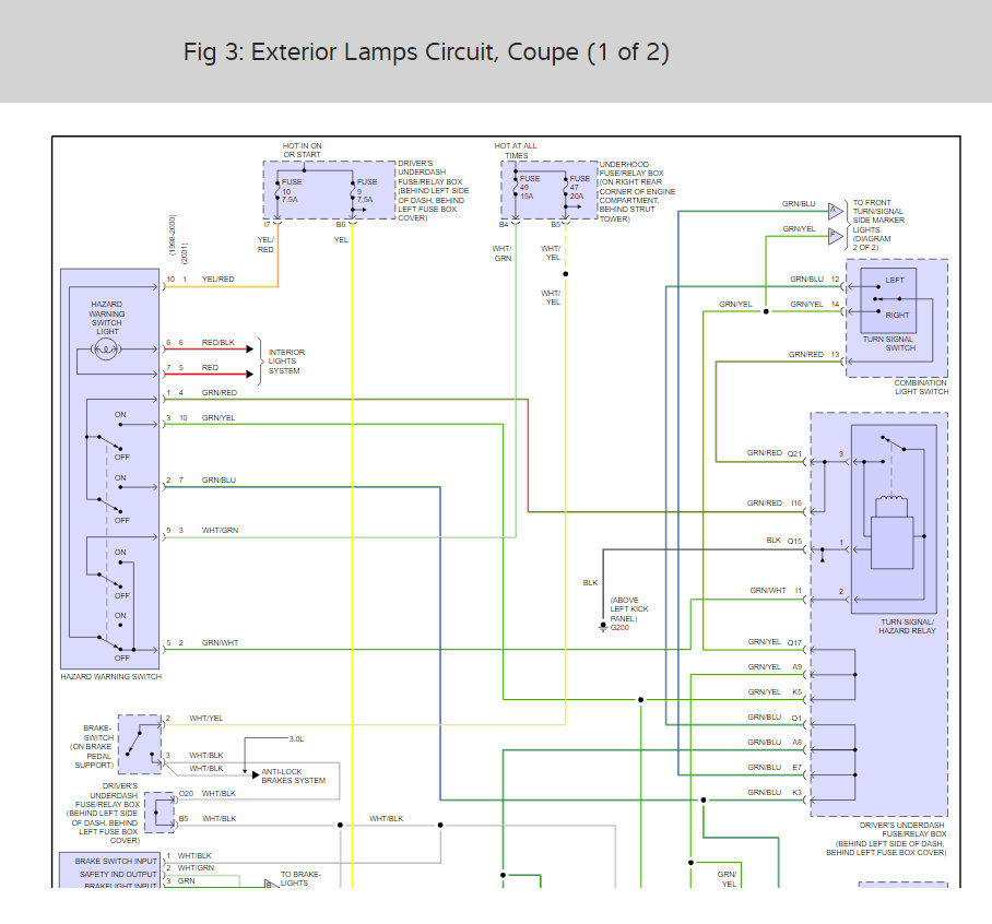

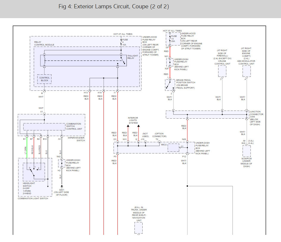

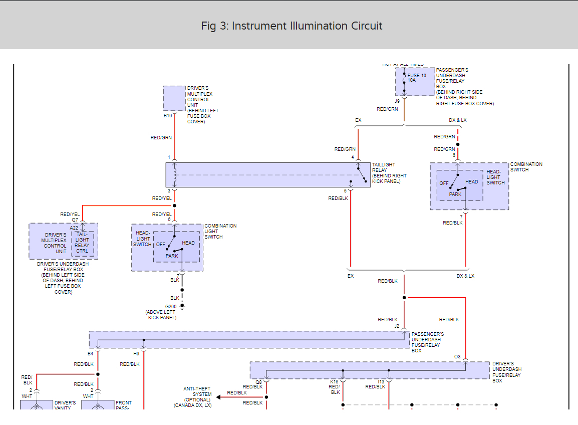

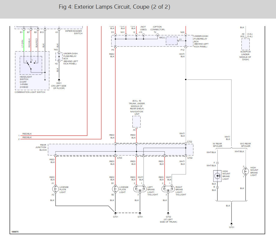

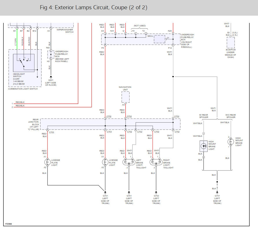

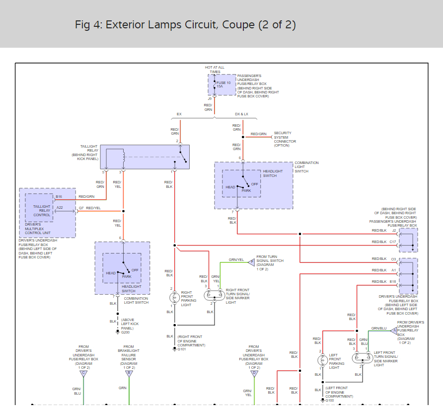

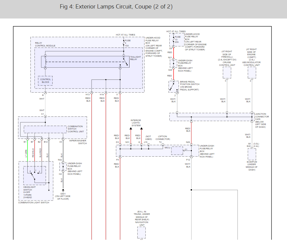

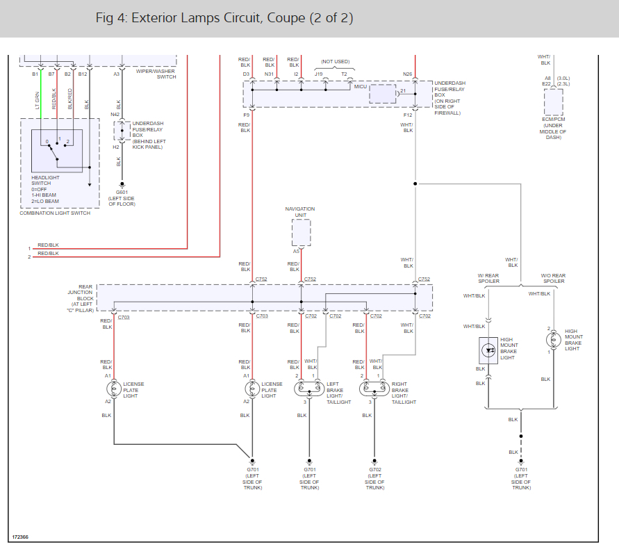

A.ESTRADA

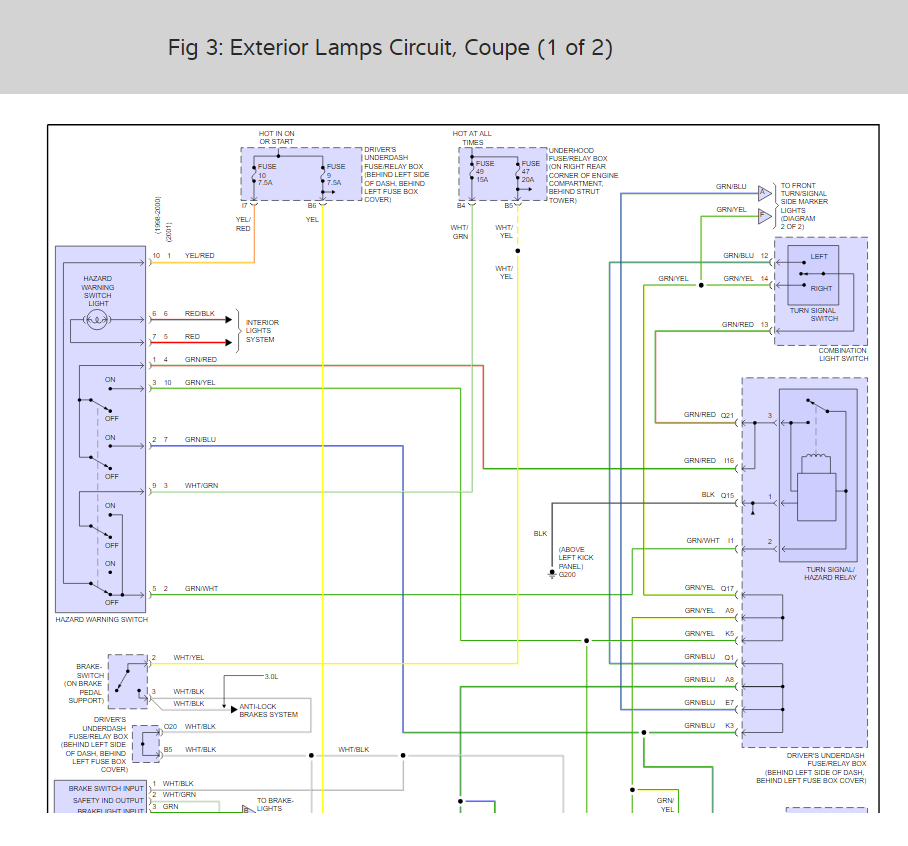

(Coupe model) When headlights on blinker does not work. When headlights off blinker works until I press on the brakes and when I press the brakes the low beams turn on in place of the blinker. Hazard lights as well stop working when I press the brakes or have my headlights on.
SCGRANTURISMO
  • 4,897 POSTS

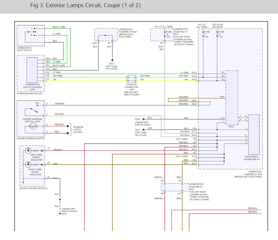

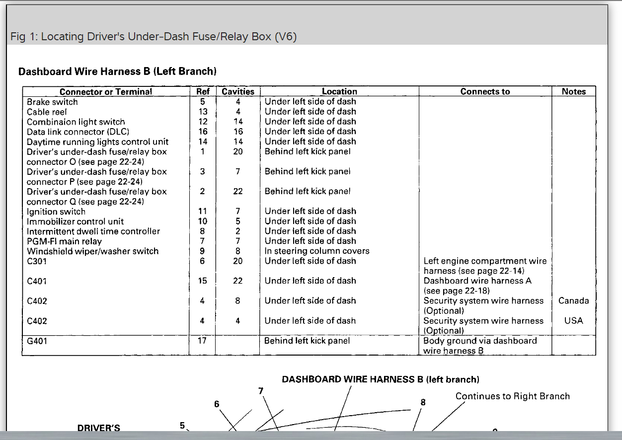

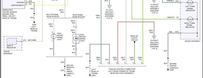

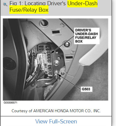

It sounds to me like you have got some wires that shorting together, probably coming from the driver's side under dash fuse box. I have included a diagram of the fuse box and wiring diagrams in the diagrams below. Please check it out and get back to us with what you find out.
Thanks,
Alex
2CarPros

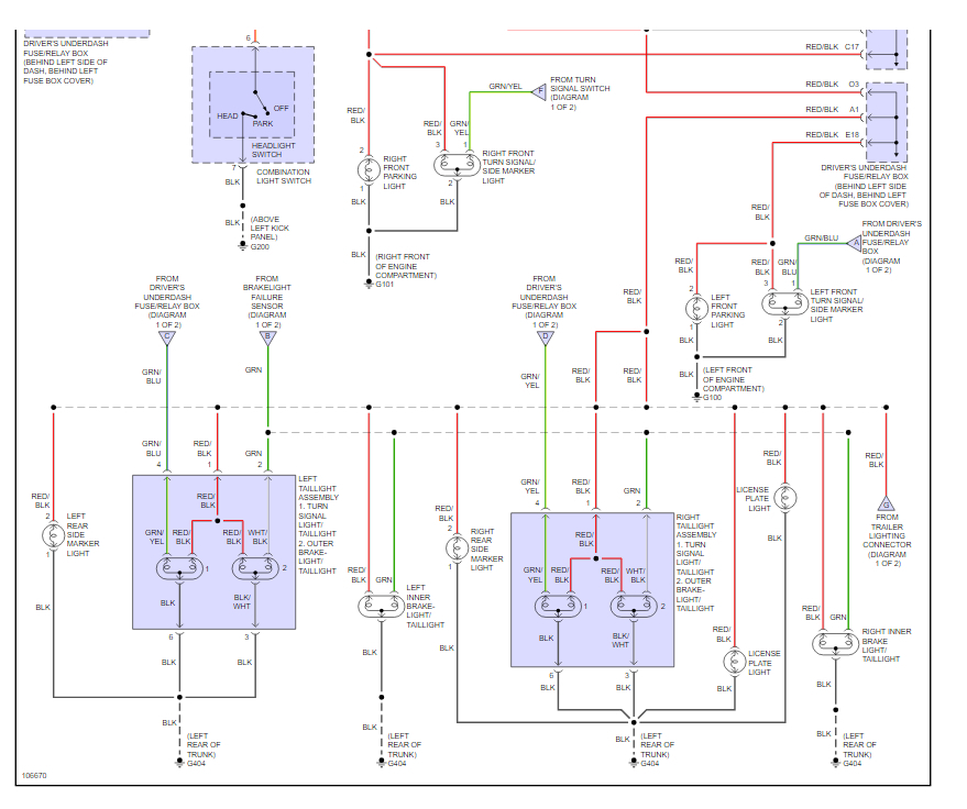

94 TRANSAM
  • 680 POSTS
It sounds like you either have a bad ground or low circuit voltage.
I would test your battery ground to the motor, frame and body and then test your lighting ground. You should read 0.04 ohms at each location.
The ground locations are noted in the diagram below. There are 4 in total.
Also test the voltage at the battery while running. This should be around 14.5 volts. If it reads 13 or less your voltage regulator had failed.
I would do an alternator check here is a guide to help you.
Check out the diagrams (Below). Please run this test and get back to us.

It could be the turn signal flasher relay contacts are wearing and causing resistance this will slow down the flashing when the system takes on more load like turning on the head lamps. Check all the exterior lights be sure they good and bright like they should be a blown bulb or poorly lite bulb will indicate an electrical problem in the power or ground circuit. I'm attaching repair guides and turn signal flasher relay location below. Let us know if you need more information for this problem and we will get for you.
