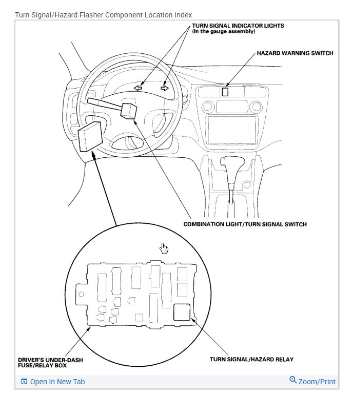

during a complete stop and a turn signal is activated, there is a slight sound o clicks, and i don't mean the turn signals clicks. What should i do?
Aug 18, 2008 at 12:02 AM
MHPAUTOS
  • 31,937 POSTS

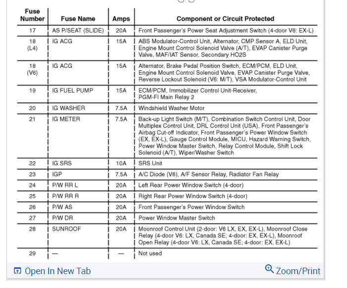

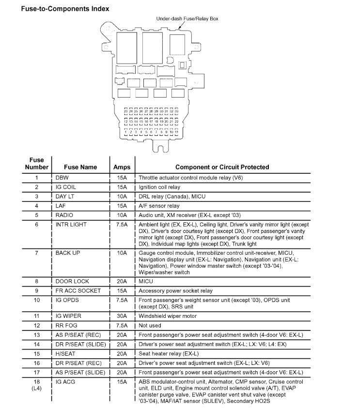

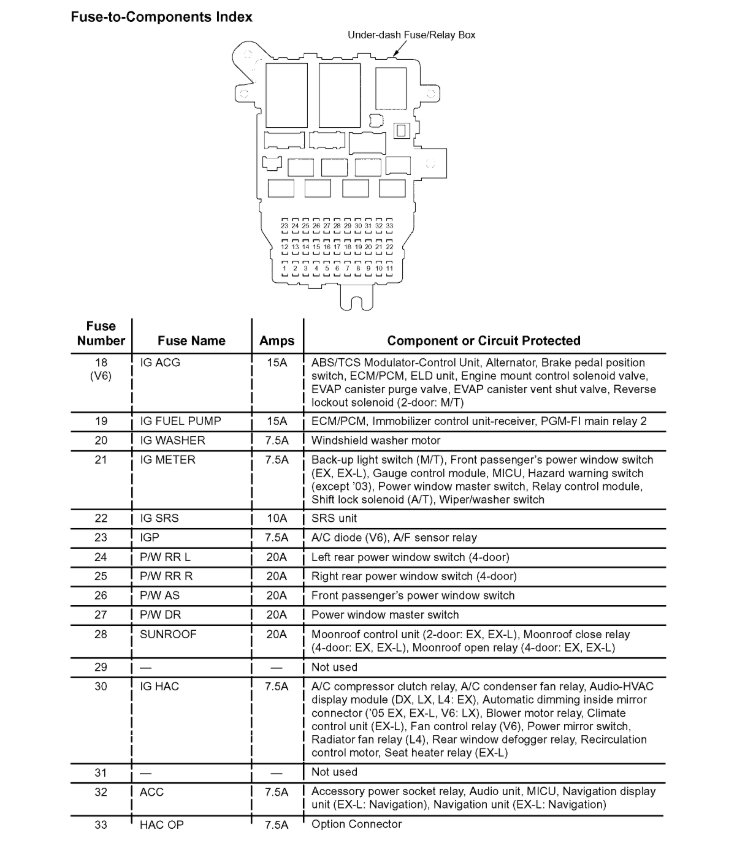

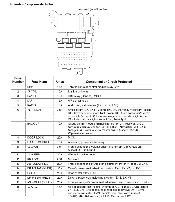

this sounds like the flasher is out but let's start with the easy stuff, the fuses # 21 and 7 in the under dash fuse panel. this guide will help you with the test if the fuse is okay and I have included the flasher location as well just in case. I have also included the blinker wiring diagrams as well so you can see how the system works.
Check out the diagrams (Below). Let us know what happens and please upload pictures or videos of the problem.
Aug 18, 2008 at 1:02 AM
M15TUHW15E
it was the flasher thank you this site is great!

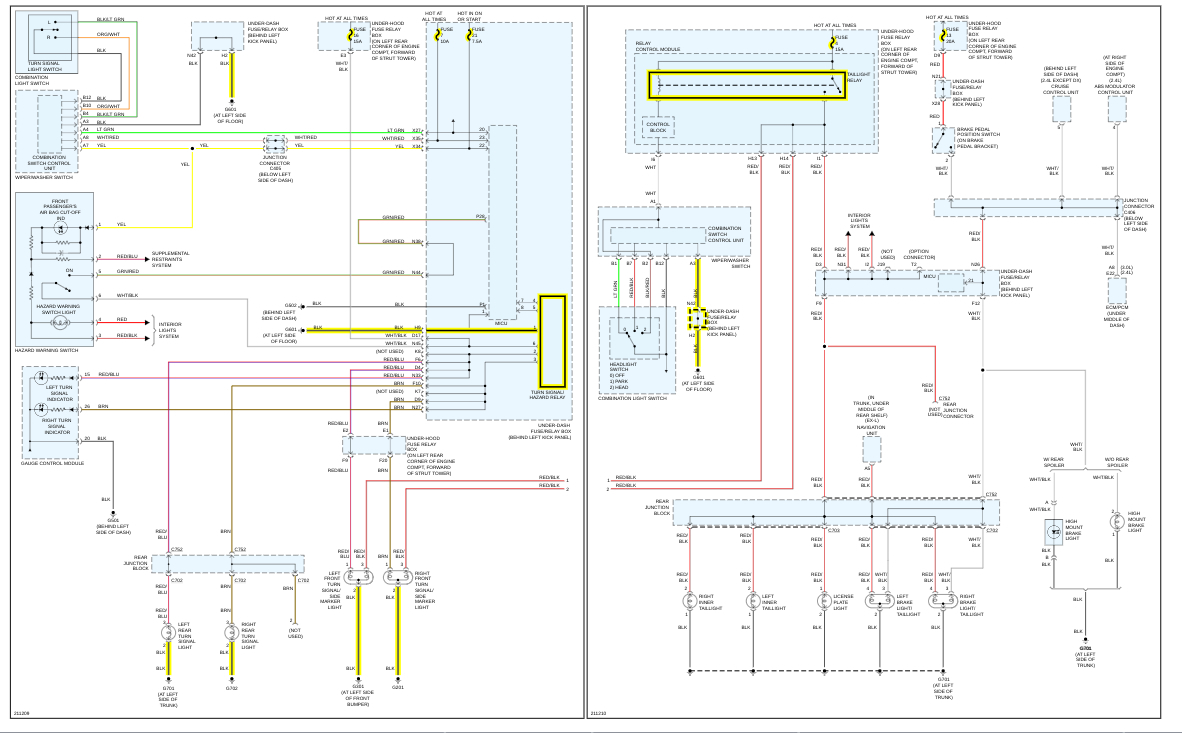

A few days ago the right turn signal light came on in my Accord and stayed lit (not blinking) while I was driving. The turn signals and emergency flashers didn’t work. I parked my car and a few hours later saw that my right front and back signal lights were on (as though I had left my lights on). My auto door locks worked and lights inside worked. When I went to drive home later that day my battery was dead. AAA jumped me and I drove home with the dash turn signal still on. About fifteen minutes into driving the dash light went out and turn signals worked again. Strange. This morning my dash light right signal came on again but went out again a few minutes later. I drove my car home and used a different one.
Could this be a bad battery causing this? If not, what could it be? Thanks for the help.
May 17, 2021 at 12:05 PM (Merged)
KHLOW2008
  • 41,814 POSTS

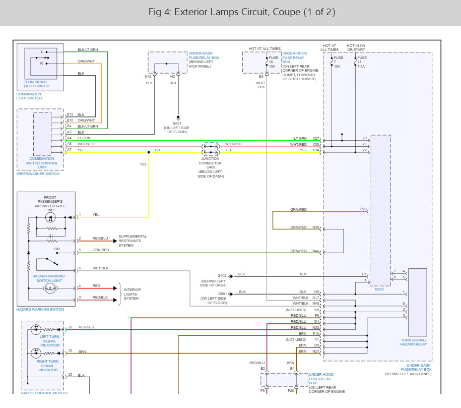

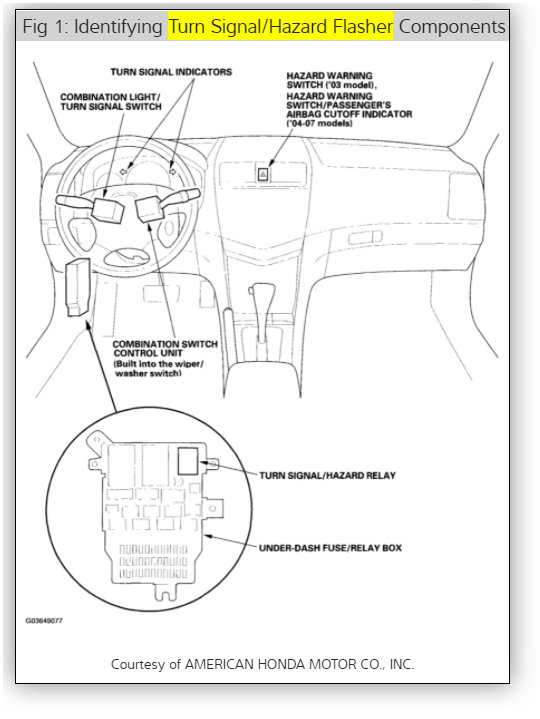

this sounds like the turn signal flasher is stuck or going bad here is the location so you can change it out. Check out the diagrams (Below). Please let us know what you find.

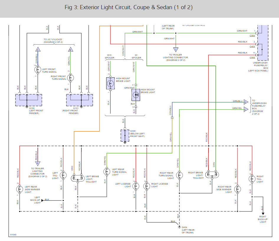

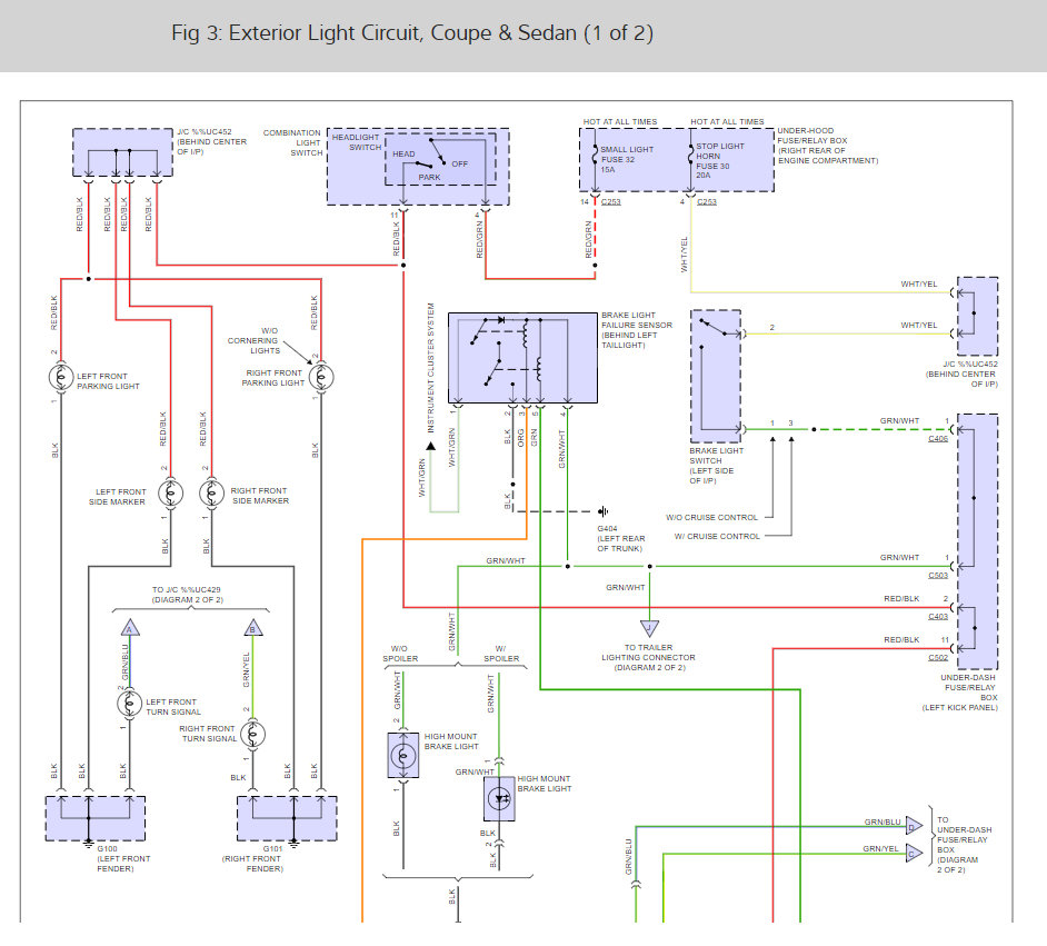

NIKIANDJUNE

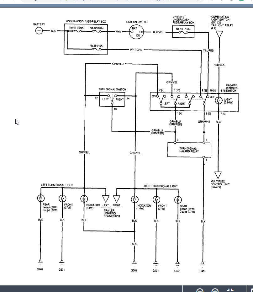

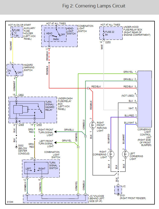

My blinkers work fine when my headlights are not on. When I turn on my headlights and try to turn on my blinker, both blinkers start to flash and it looks like my hazard lights are on. We have already changed the multi function switch.....

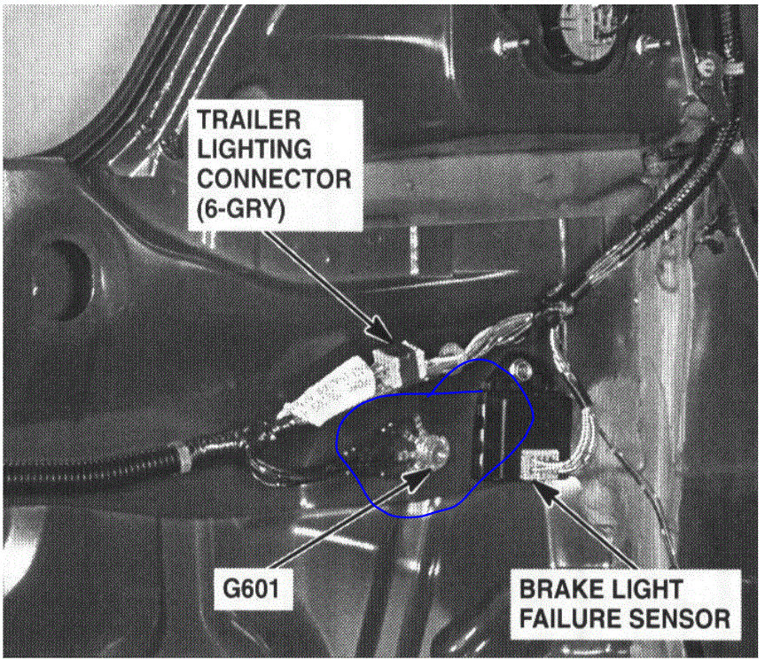

TOUGHDIVER
  • 226 POSTS

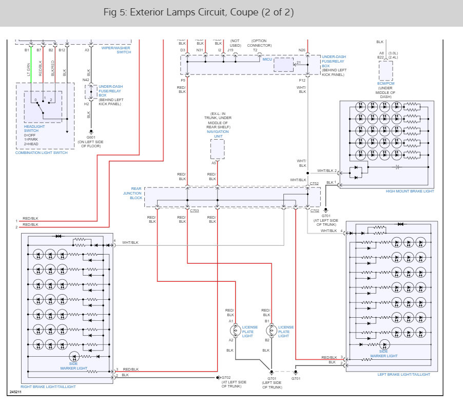

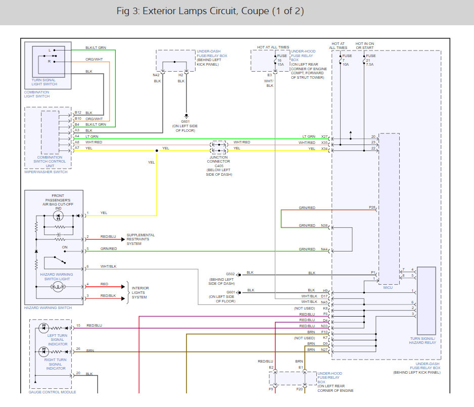

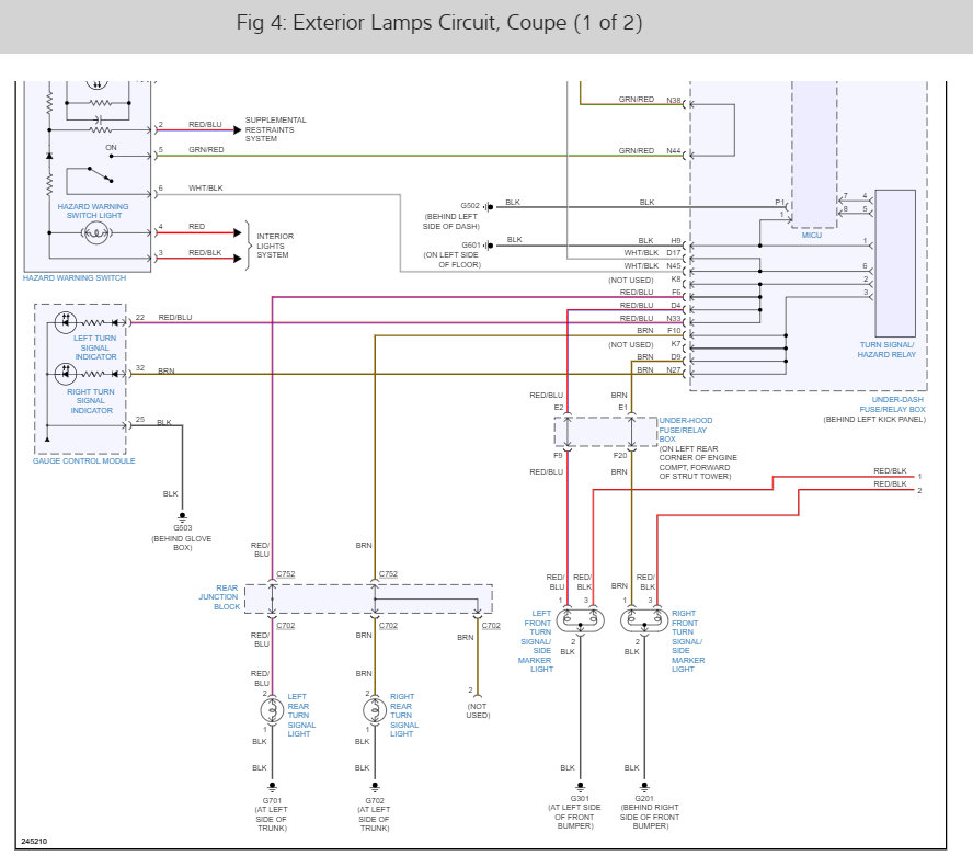

It's possible you there is a poor ground at G601 or a blown fuse or relay causing a voltage drop in the electrical system. I'm attaching exterior light wiring diagram, fuse block location and repair guides below. I highlighted the grounds and fuses for you to pay special attention too. The ground wire on the left front drivers side front floor ground. Lift the carpet up and make sure the ground wire is clean and tight. Let us know if this information was helpful and what repair the lights.

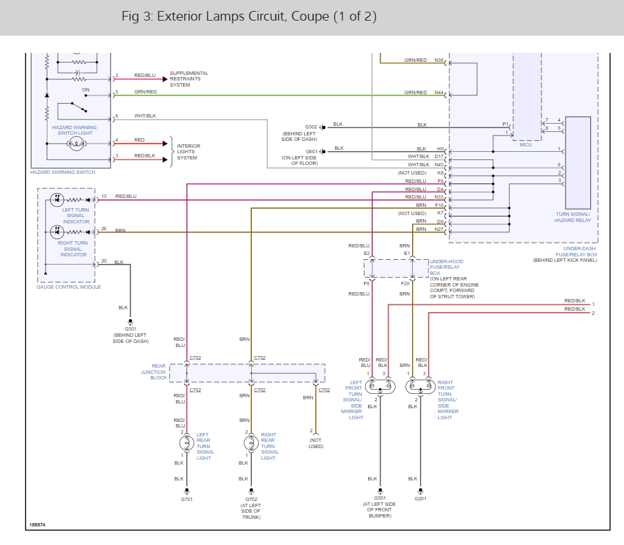

If the hazard lights do not work for these bulbs as well, either the bulbs, flasher relay or wiring has a fault. Such diagnostics do not require any computers and neither would it help. It sounds like one of the fuses is out please check #16 under the hood and #7 and 21 under the dash here is guide to help check for power.
This wiring diagrams will show how the system works with the fuse locations as well. Check out the diagrams (Below). Please let us know what happens.

If the bulbs check OK, and the right turn signal works, it is most likely the flasher relay. It is located behind the left kick panel, in front of driver door. to the upper right. Pull out the flasher unit, jumper between pins 2 & 6 (1 is at top, 6 is at bottom) Switch on left blinker. If the bulbs light up, you have a faulty flasher unit. New ones are about $35 at your dealer. It's only money! Cheaper diong it yourself.

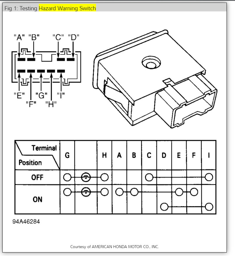

The turn signals don"t work and the fuse is fine. The hazard switch is missing because. Does the hazard switch have to be plugged in for the turn signals to work.
May 17, 2021 at 12:06 PM (Merged)
KHLOW2008
  • 41,814 POSTS
Hi chrish139@gmail.com,
Yes, the hazard switch has to be plugged in for the turn signals to work.

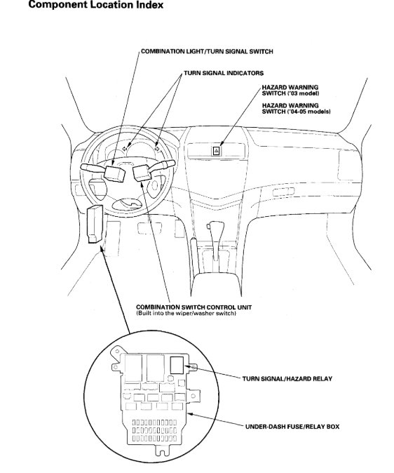

This will be your flasher, which is located in your fuse box (under dash-drivers side). Pull the cover off of the fuse box and look at the diagram the tells you which fuse and relay goes where.
It will say "Flasher" or "Blinker" or something to that affect. Take it out and to a parts store such as AutoZone.
Then just plug in the new one.
Check out the wiring diagram below for the fuses you need to check as well.

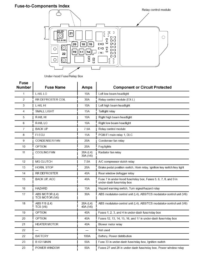

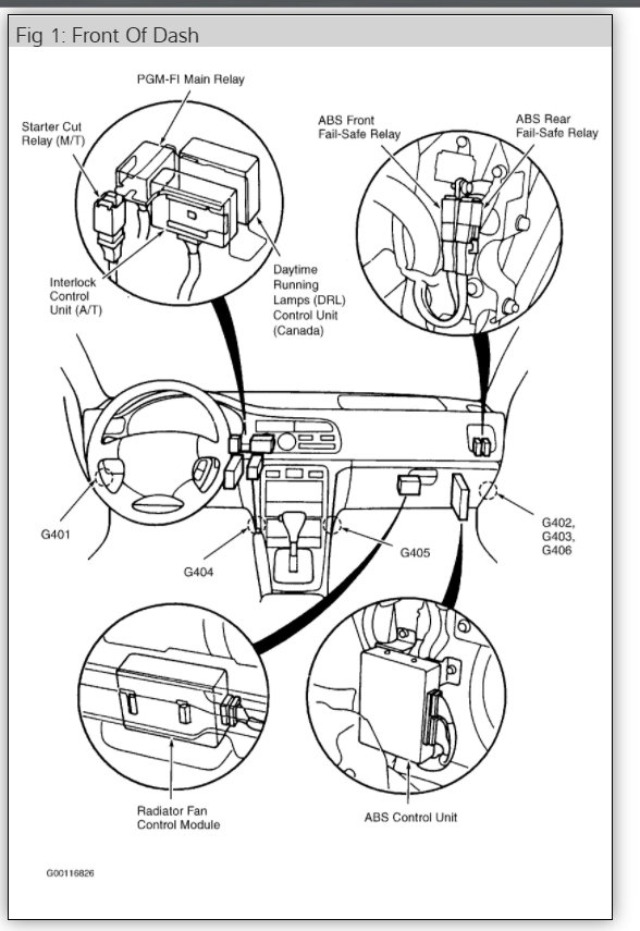

TEMPEST33

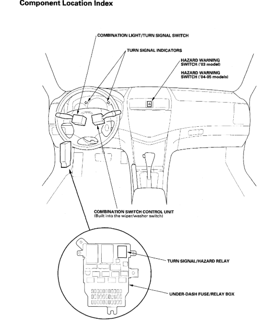

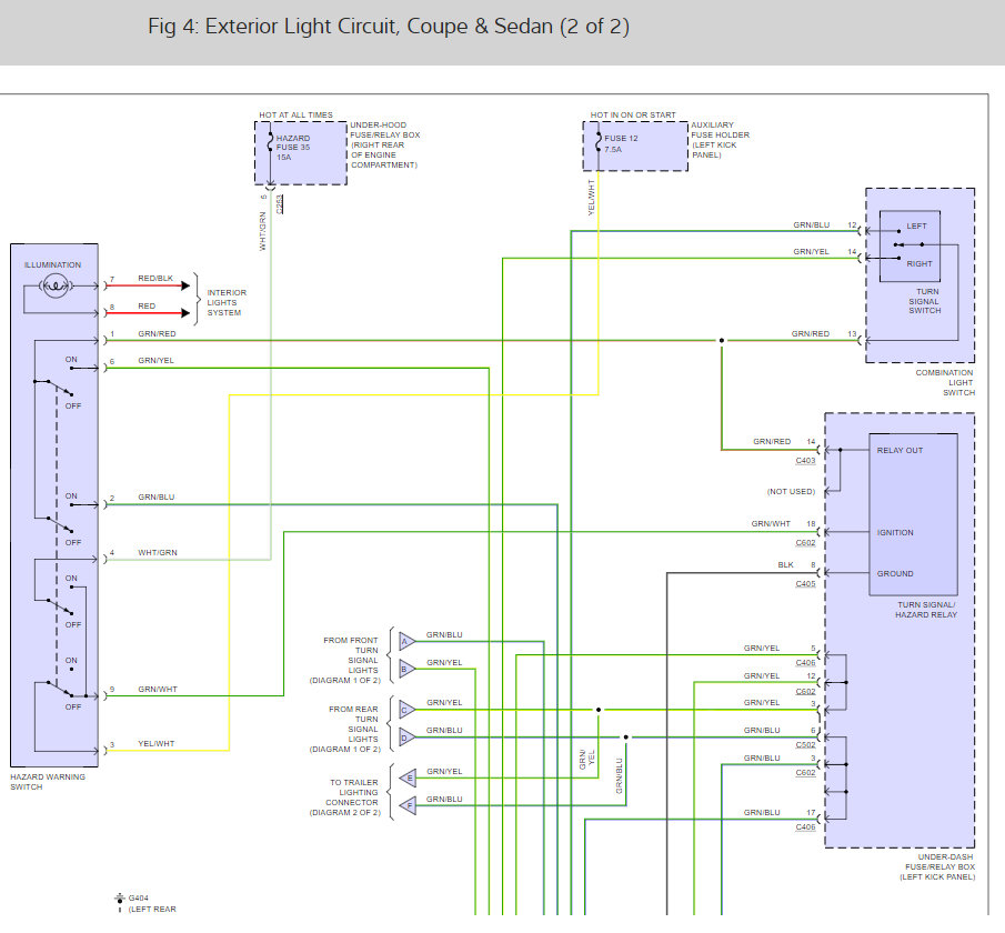

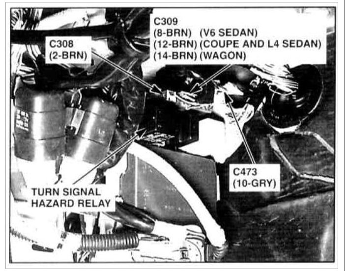

Was wondering if my issue is from the turn switch relay or from the turn switch itself on the car listed above ex model. I can manually click the lights of the blinker when i have my hazard switch on but when the hazard switch is not on i don't get anything from using the turn blinker. All lights work for the blinker when i manually engage the signals by clicking on and off on the turn switch. So basically when i engage either the left or right blinker it will just stay on instead of blink only when i have the hazards engaged. However the hazards do not blink when the hazard light switch is engaged. Thank you for anyone's time to help me with this.

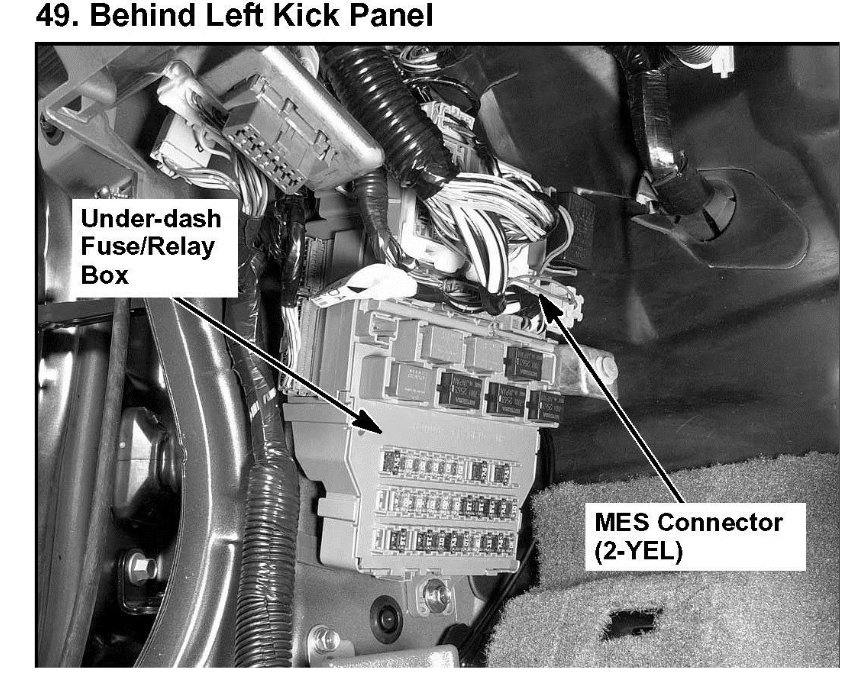

The issue is most likely the relay itself. On your vehicle the flasher is for the hazard lights and turn signal lights. So if when turning the hazard switch on and to get them to blink you turn the turn switch on, that points to the flasher.
I would suggest replacing that relay and then retesting.
I attached the material on the location. Let me know if you have questions. Thanks.

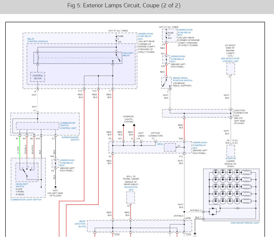

DEVINDC
  • 13 POSTS

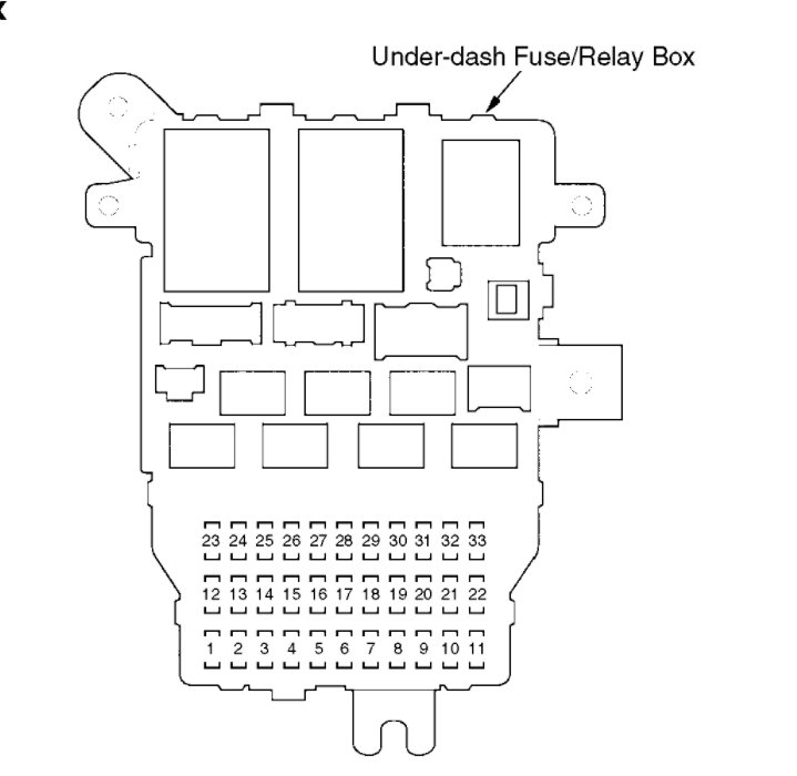

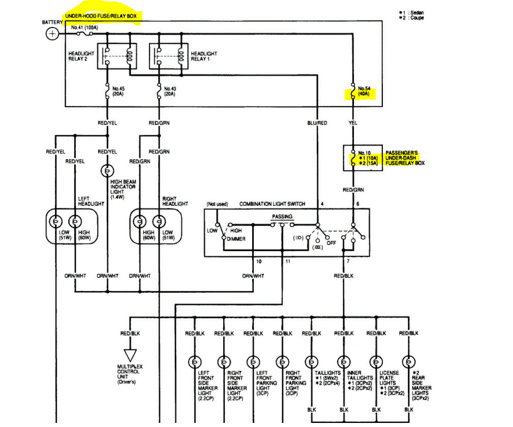

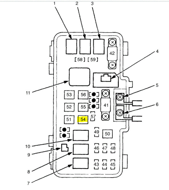

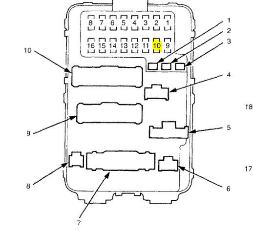

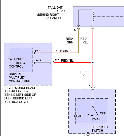

I have the car listed above (lx) and my dash lights won’t stay on unless you move the radio around to a certain place. Also my signals also won’t work and tonight on the way home my taillights stop working until i braked. anyone know what it could be?

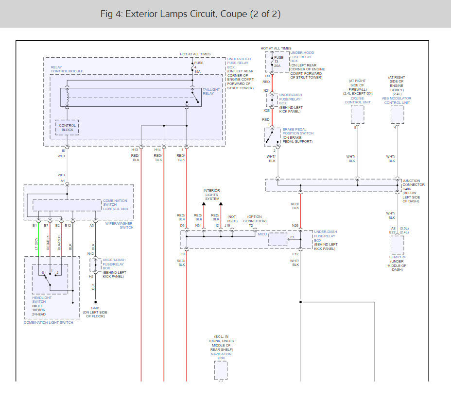

  • 110,194 POSTS
When you say move the radio around, do you mean the physical radio is loose? Is it still the factory radio?
If that is the case, have you checked under the dash near the radio for a loose ground or connections?

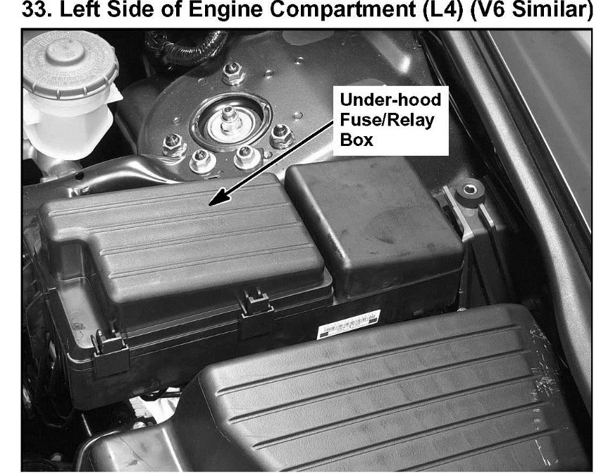

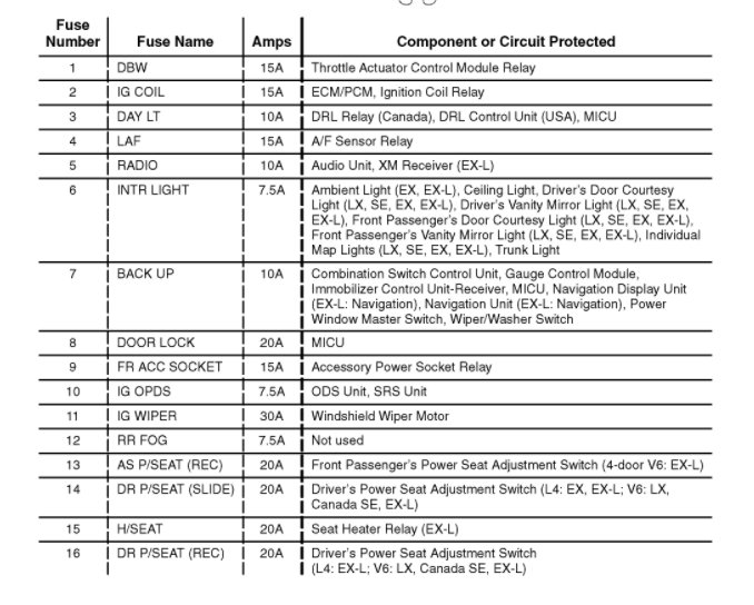

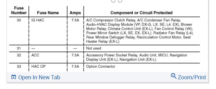

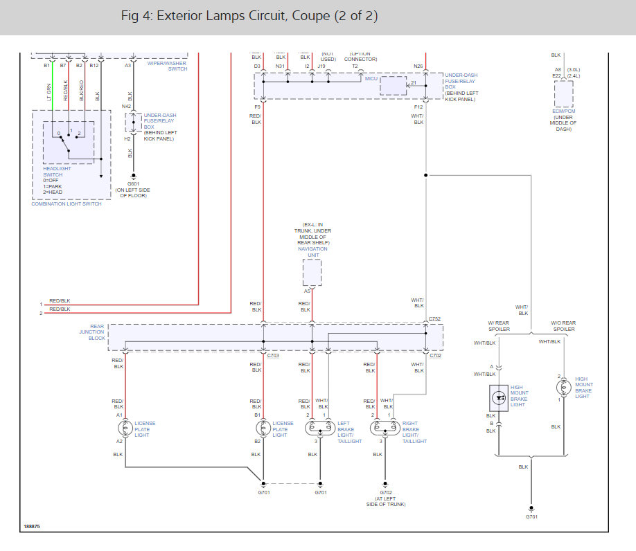

As far as the exterior lights, do the front parking lights work? If not, check the two fuses I highlighted in pic 1. In addition to just checking the fuses, make sure they have power. Here is a link to help with that.
Pic 2 shows the fuse location for the interior passenger side fuse box. Pic 3 shows the fuse in the under hood fuse box which sends power to the interior fuse box. Pic 4 shows the left rear of trunk where ground 601 is located.
If the fuses are good, the bulbs are good, check ground (G601) which is for the tail lights.

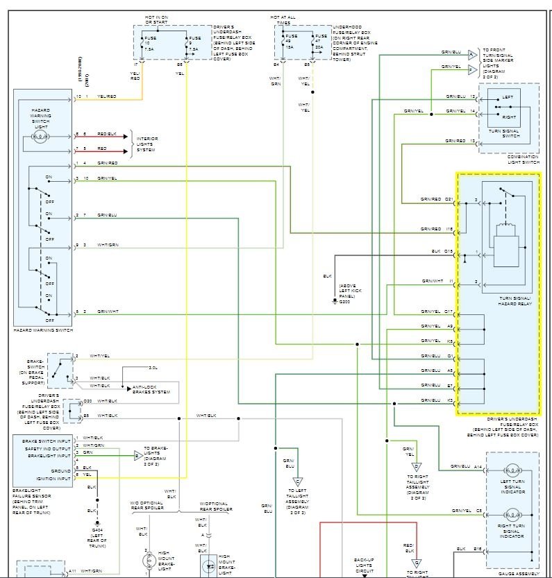

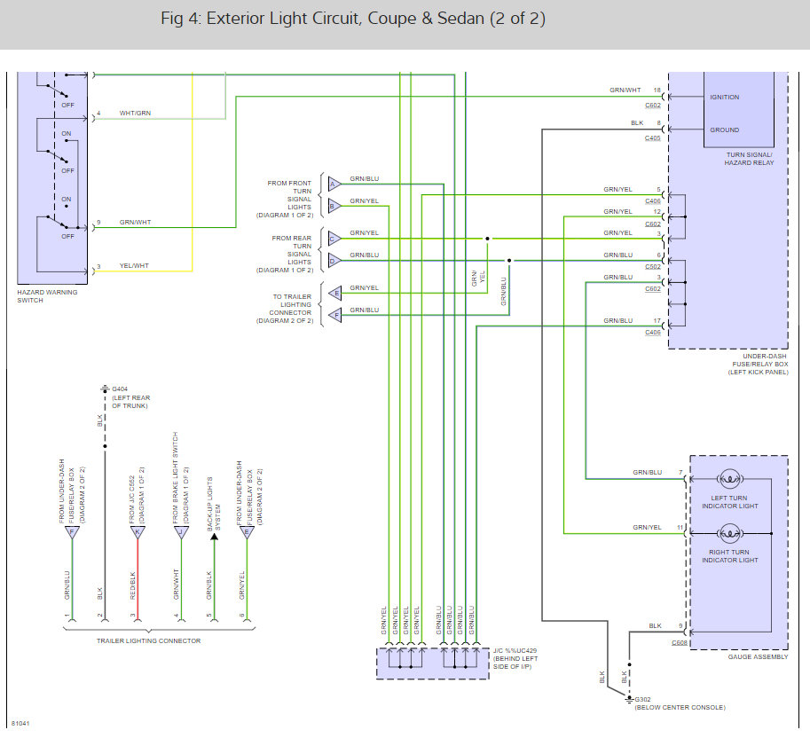

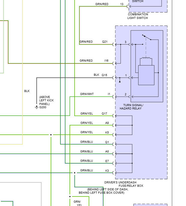

So, a couple of days ago my turn signal stopped working along with the hazard lights. When I flip the arm to activate the turn signal, the light in the dash does NOT light up at all and it doesn't make the "click sound" that the blinkers do when they are going, but when I make the turn, the arm goes back to the neutral position. I checked the hazard light fuse and it is still good. Brake lights are working fine. Thanks in advance for any help :)
May 17, 2021 at 12:07 PM (Merged)
  • 54,840 POSTS

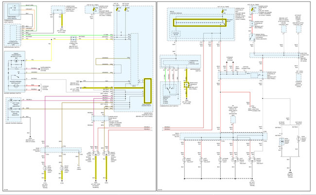

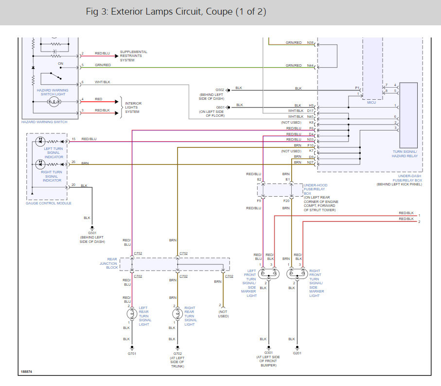

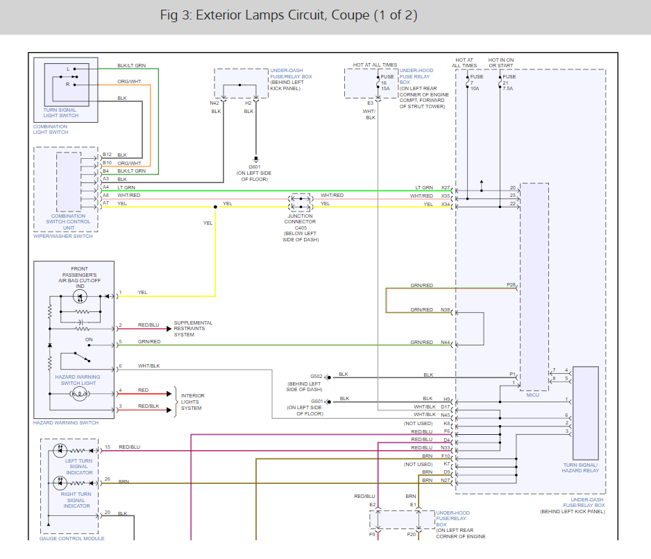

There is a light out module and a flasher that need to see if they are getting power and connecting to the remainder of the system. It sounds like the flasher has gone bad.
Here is a guide to help you see how to test the system with diagrams below to show you on your car
Here are the wiring diagrams for the blinkers etc. (below)
