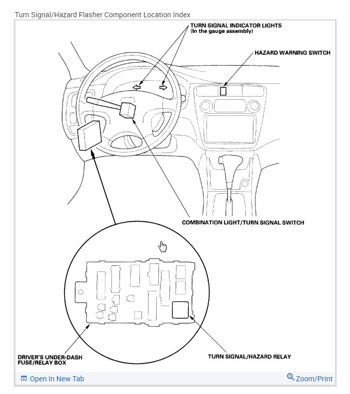

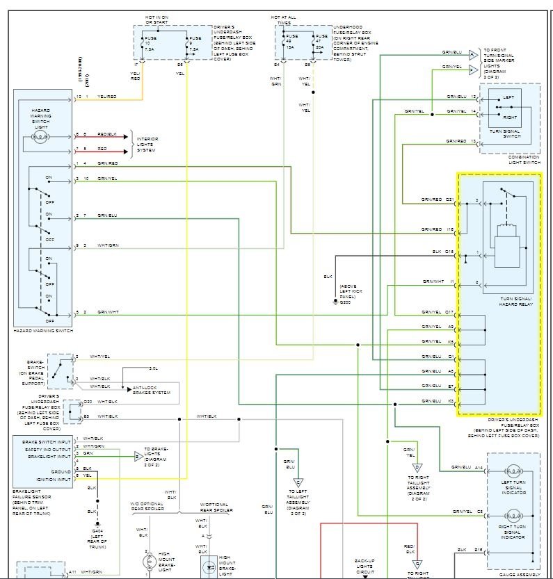

My left turn signal stopped working on both the front and back of my car. It also does not light up or click on the dash. The right side works fine and the hazards work.
I have checked the bulbs, the fuses and Iooked at the flash relay. I am stumped please help.
May 17, 2021 at 5:07 AM (Merged)
HARRY P
  • 2,292 POSTS

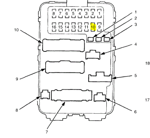

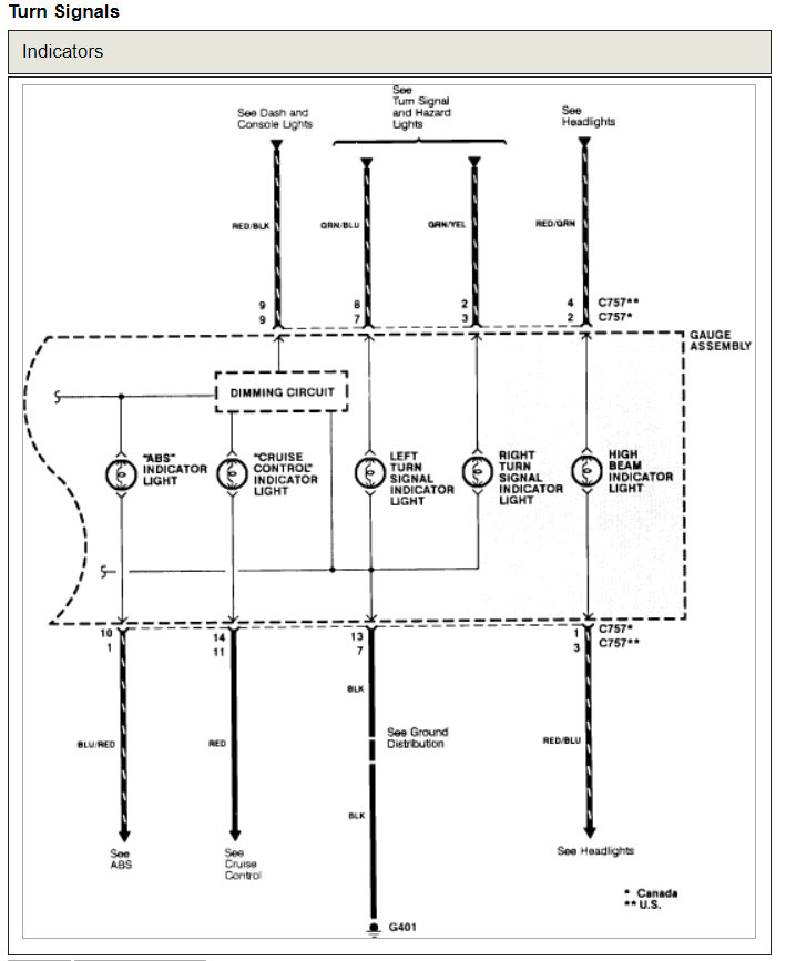

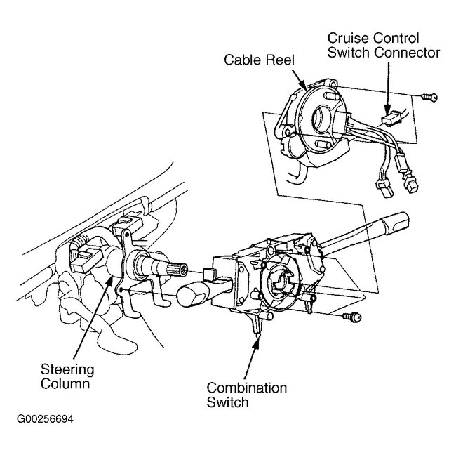

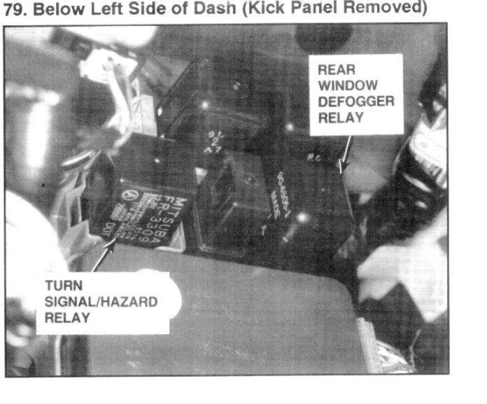

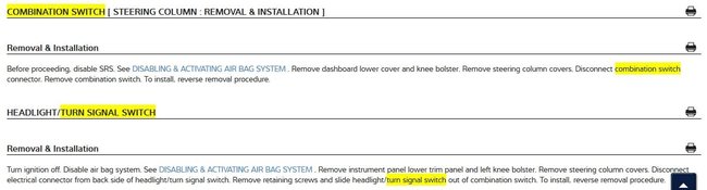

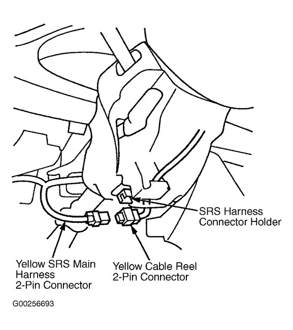

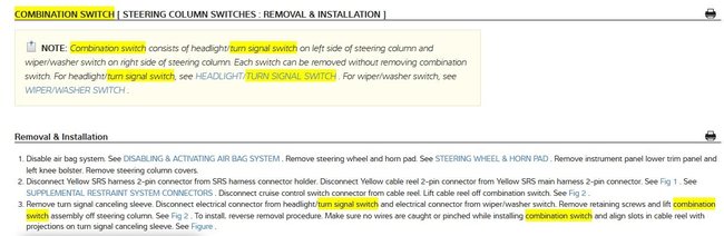

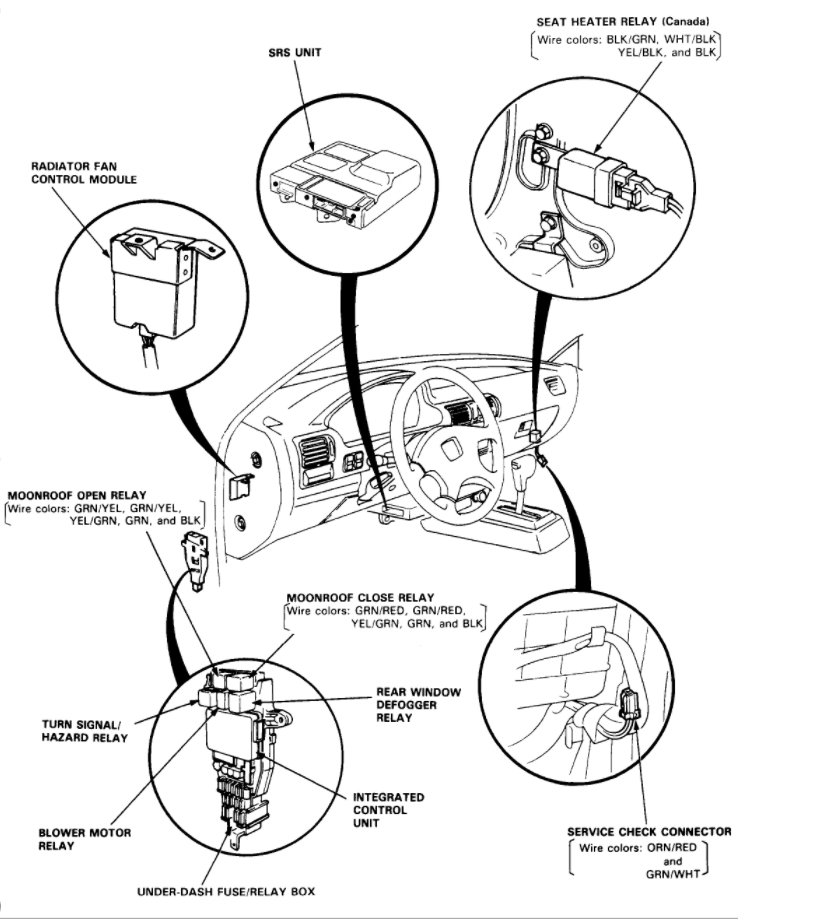

I would bet on a bad turn signal switch. You can try to replace the flasher first though, which is in the under dash fuse box (driver's side of the car, under the dash). They are usually cheap enough to replace. I am attaching Prodemand's instructions on replacing the turn signal switch.
Also, here is our general guide on testing and replacing the switch: https://www.2carpros.com/articles/turn-signals-not-working-blinker

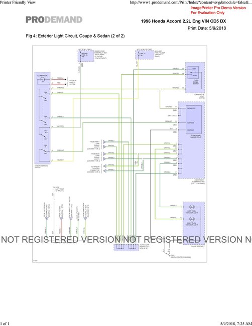

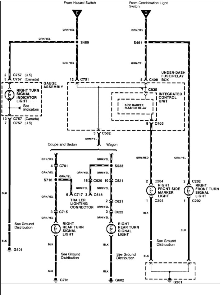

I am attaching the wiring diagrams in another post below.
HARRY P
  • 2,292 POSTS

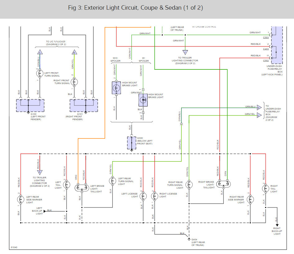

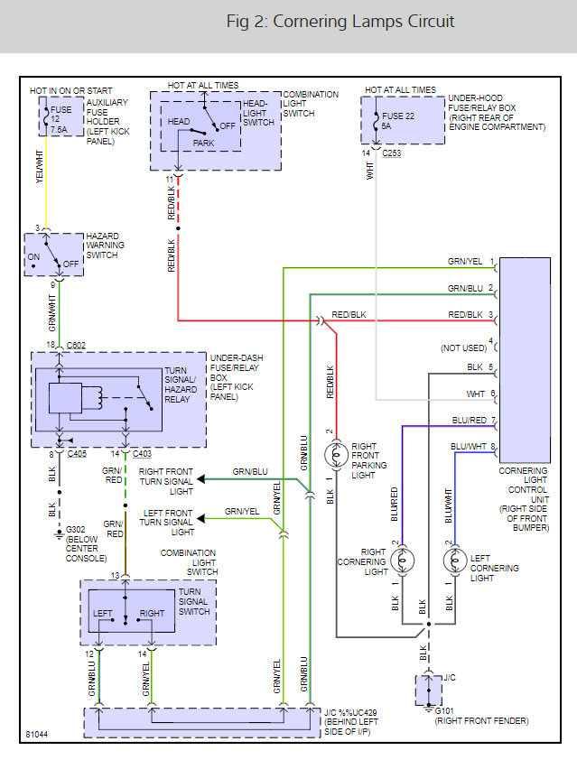

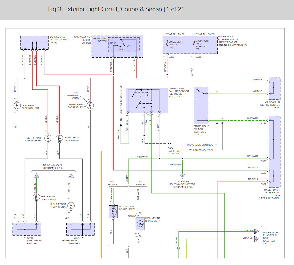

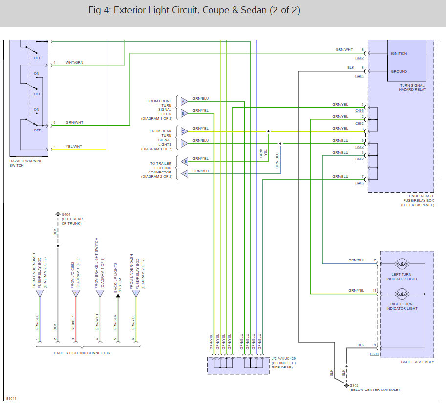

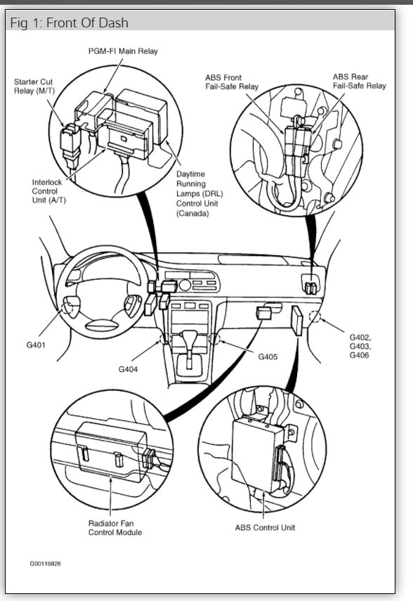

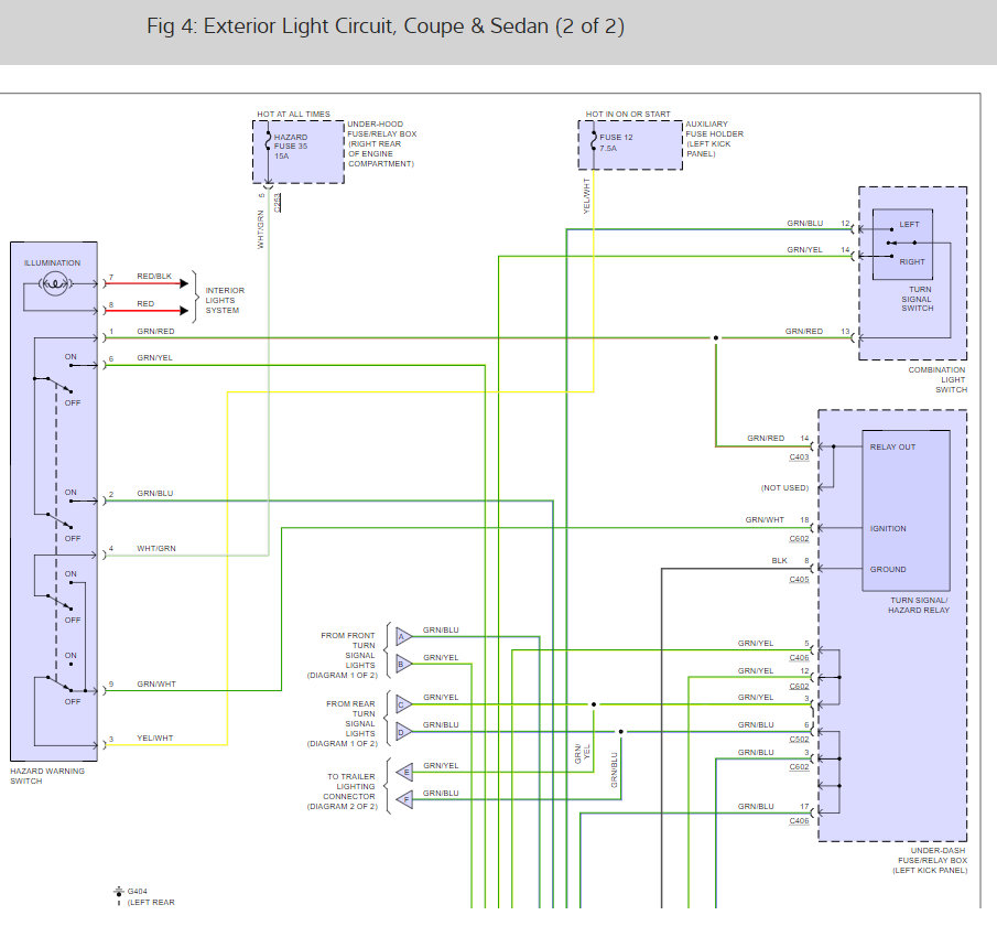

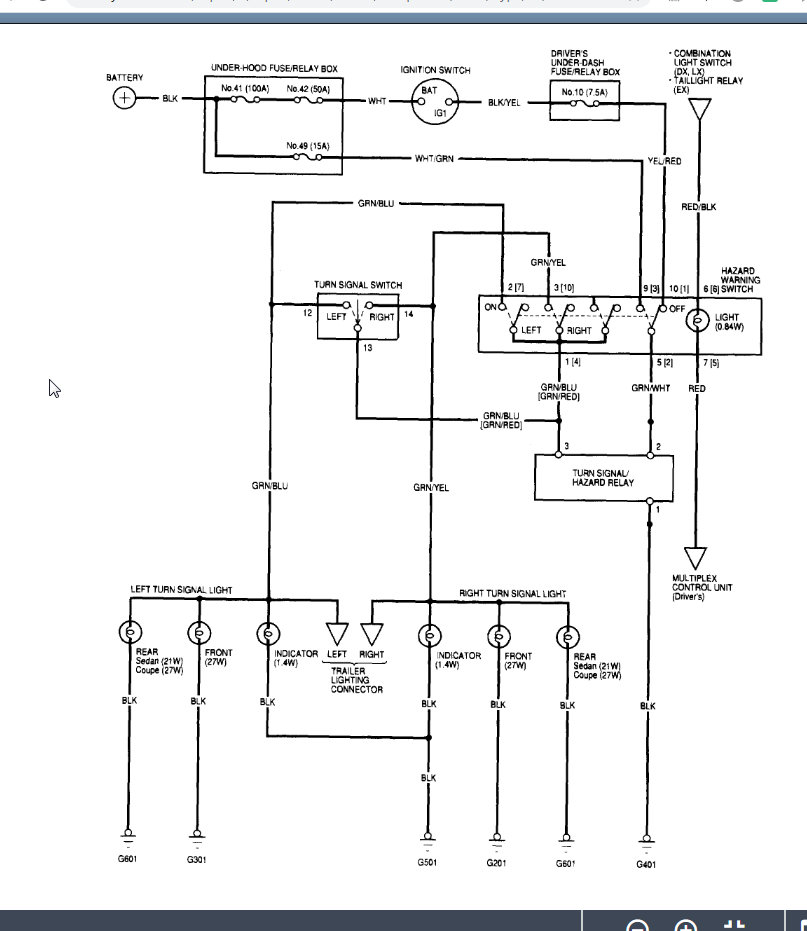

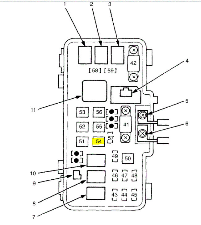

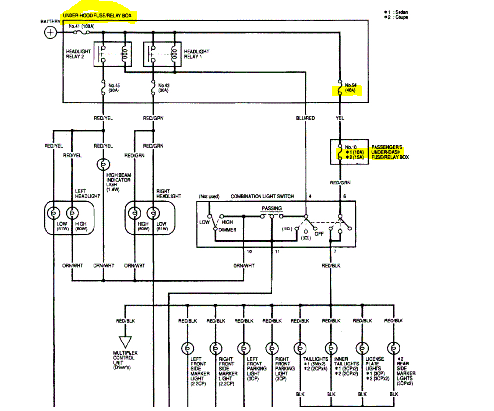

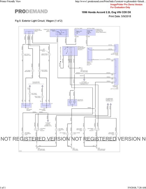

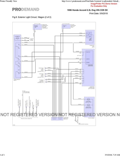

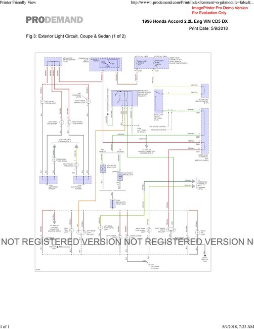

There are a few diagrams available, depending on exactly which car you have. I have attached them all.

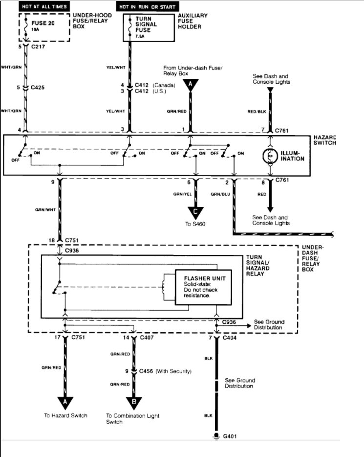

GARY5X5

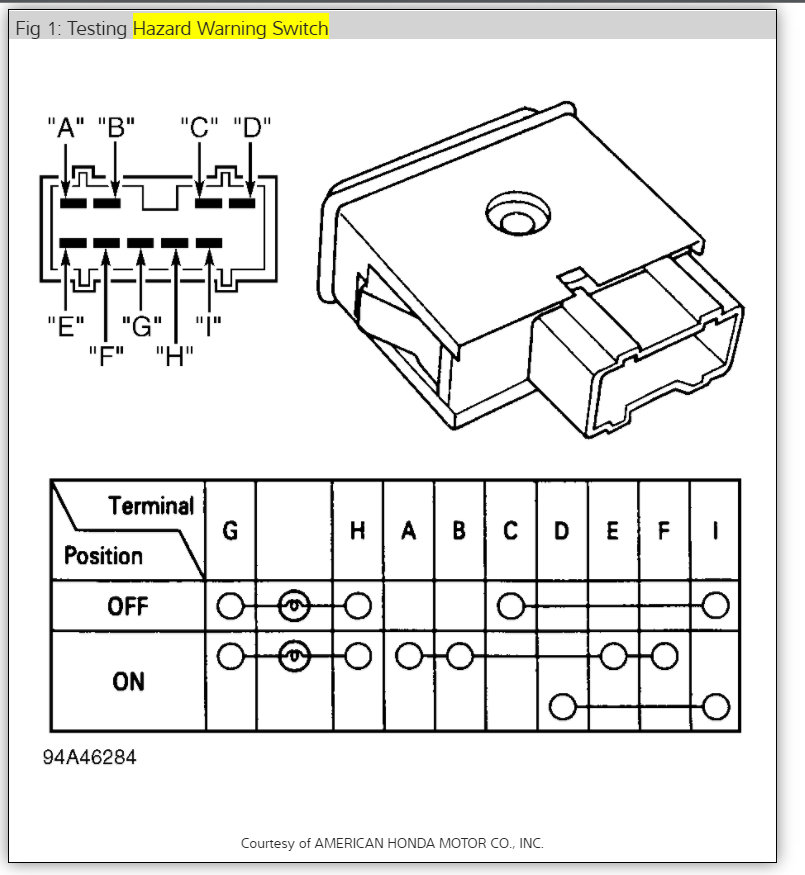

I have a 1994 Honda Accord and the turn signals and the hazard light is buzzing when I use them. Discovered it was the relay that was buzzing (just above the fuse box by the driver's left foot, the one furthest from the motor; do not need to remove the fuse box cover). I replaced it (bending the two tabs outward) but the problem persisted. I took the car to an electronic automotive repair shop and they discovered that it was the hazard switch that was the problem. Voltage to the relay goes through this switch before it goes to the relay. I replaced it and the problem was resolved. The hazard switch is easy to replace; just insert a spade screwdriver at the bottom, where there is a little notch. Pry the switch out. Disconnect it from the connector (by pressing in the little tab) and pull it out. Replace it with Honda part number 35510-SV4-003. It costs about $60 but if other foreign auto parts stores have it, it is probably cheaper. You could always get one from an auto wrecking yard but who knows if it will last very long. The problem was not caused by a faulty ground connection somewhere as suggested by other websites.

It is possible to fix dead buzz turn signals by *cleaning* the contacts inside the Hazard Switch box, ymmv.
Dirty/Corroded innards of my hazard switch made my 1994 Accord Wagon have no turn signals... took the hazard switch apart, cleaned and back together. A little bad news in that I killed the "switcher" mechanism in my Hazards; they work but I have to hold it to keep it on! I'll get a new one soon, but at least the signals work in the meantime.
(Original Symptom: right and left turn signal didn't work and the flasher relay BUZZED really loudly. Like a 1960s VW horn. I replaced the flasher relay and the new one didn't work either and made a rapid clicky noise, twice as fast as a "hyper-flash" that LED bulbs will cause. Other symptom that the bad hazard switch will give is your turn signals will trigger even without a key in the ignition: hazards are always Hot Voltage but turn signals *should* require key.)

More than likely it is an issue in the multi-function switch itself. It not wanting to move until you moved the column around some suggests a piece failed and the motion dislodged it, quite possibly part of the cancelling cam.
Not a hard item to change. You disconnect the battery, remove the plastic covers on the steering column, disconnect the electrical connector and remove the screws that secure the switch. Slide it out and reverse the process to install the new one.

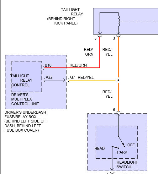

  • 55,433 POSTS

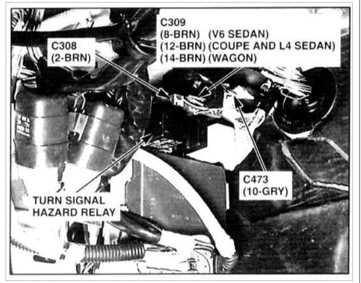

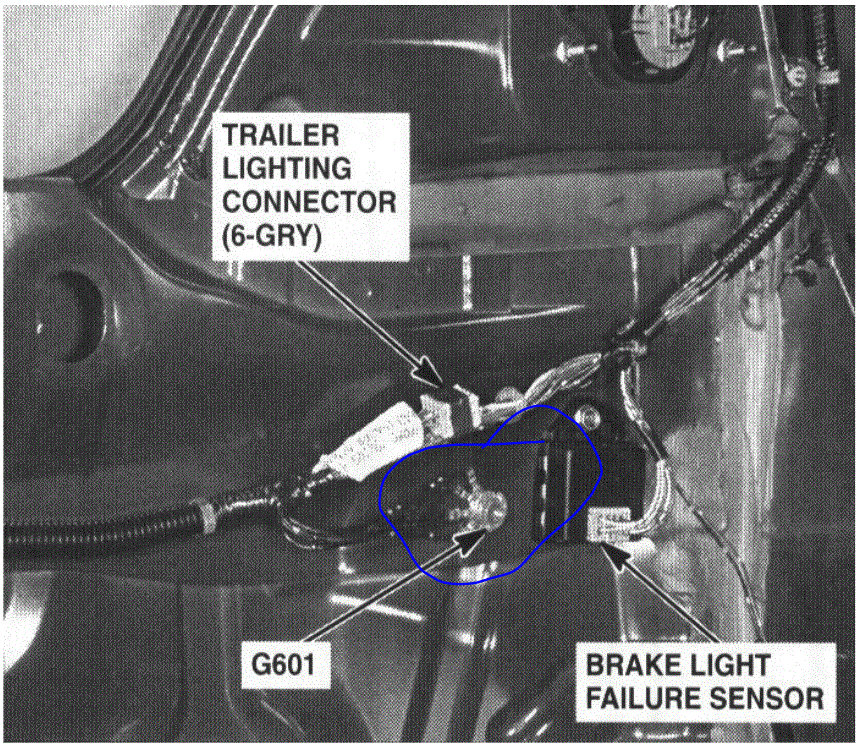

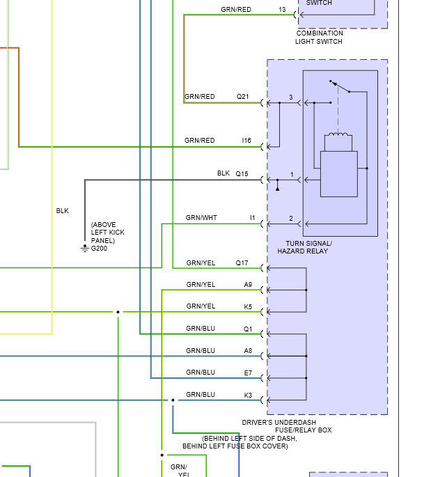

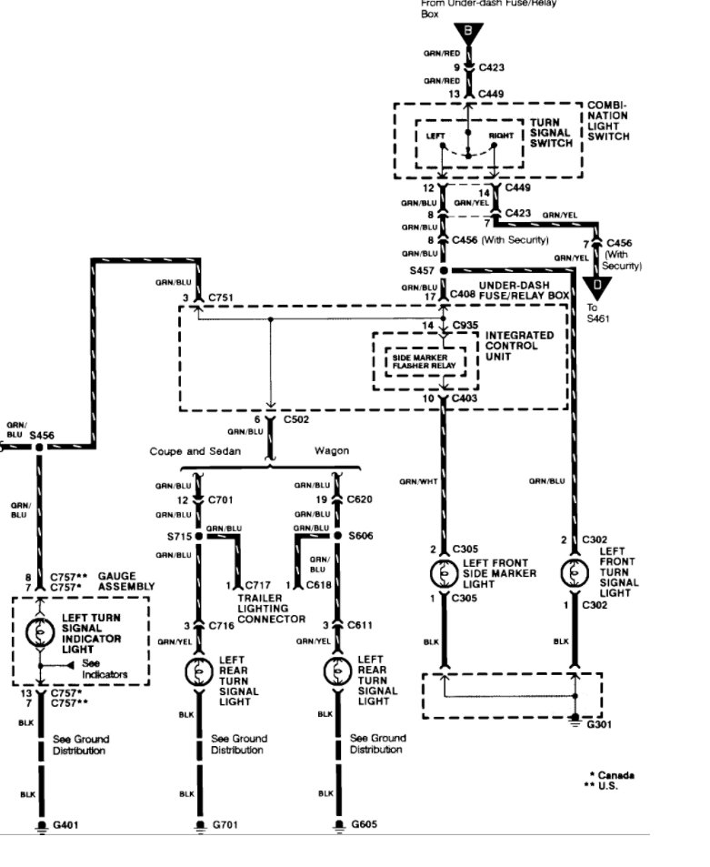

There is a turn signal relay and integrated controller that needs to be checked for power. Here is a guide that will show you how to check for power.
Here are the wiring diagrams for the blinkers and the turn signal flasher and module locations (below).
