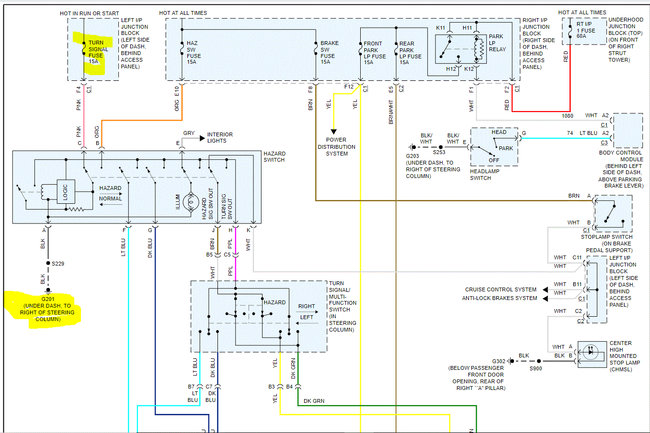

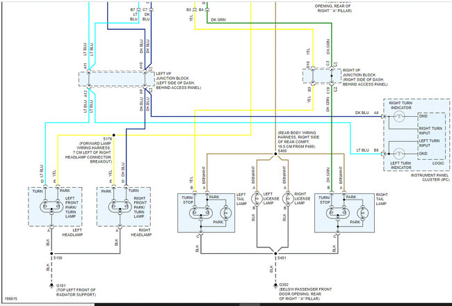

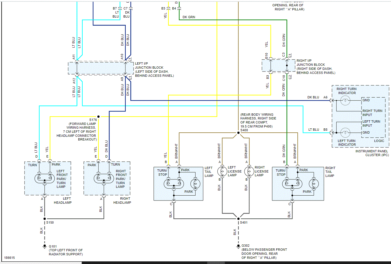

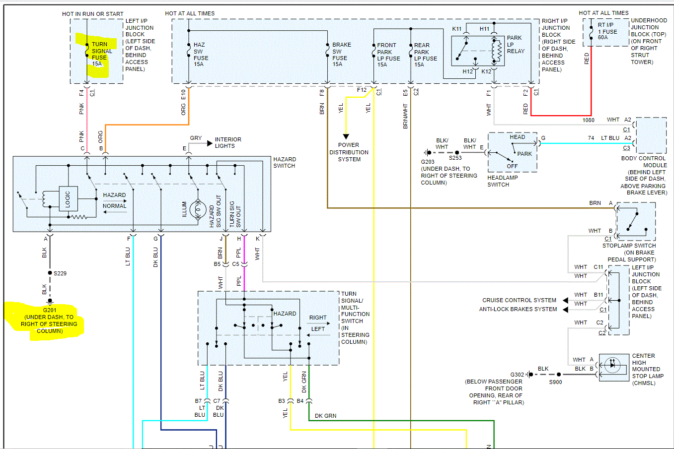

To get you started, I attached the wiring schematic related to the exterior wiring. I cut it in half to make it readable, but I did overlap them so you can follow from one to the next.

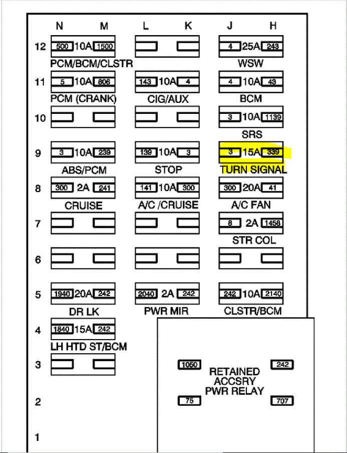

First, check the 15 amp turn signal fuse in the fuse box on the left side of the dash. See pic 3.
In addition to checking the fuse, confirm there is power to and from it. Here is a link you may find helpful:
Also, I need you to check the ground wire for the signal system. It is located under the dash to the right of the steering column.
