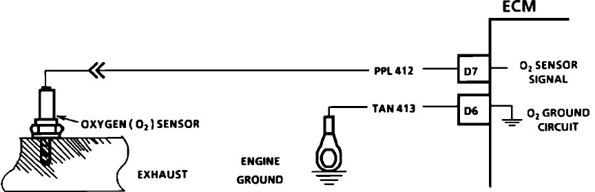

Okay, thank you. 44 means the engine is not getting enough fuel, that shows up as a lean code in the exhaust. Common causes are low fuel pressure from a weak pump or partly plugged fuel filter. On that truck the fuel pressure needs to be between 10 and 16 psi. tested after the inline filter. Lower will set a lean code. Have you noticed any poor running or surges or is it just the light on?
Another common cause would be if the sensor wiring is damaged by grounding out say on the exhaust manifold or engine, that would drop the voltage the ECU sees and make it set the code. A good visual inspection of the sensor wiring from under the truck and through the harness would be the first step. Then a continuity check from the ECU to the sensor to verify wire integrity is good.

To cause this code the leak would have to be in front of the O2 sensor. So look for cracks or damage to the manifolds the manifold to pipe gaskets and damage to the pipes themselves. Normally you would hear the leak that would set this code. Plus the light would come on regardless of throttle position because it would be a constant leak.

It was the EGR valve. It runs good now. Thanks for the help.
