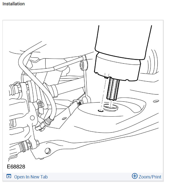

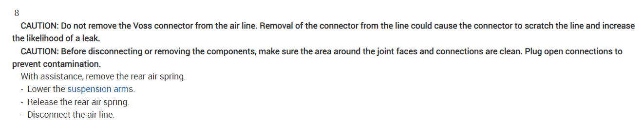

i was driving my range rover on the free-way today and air suspension was changing to a low height and i think the wind today blocked my car from getting lower. so this it said eas fault. and it was stuck so that the front of the car is lower than the back of it.
Nov 28, 2007 at 10:18 AM
DAVE H
  • 13,384 POSTS
have the vehicle plugged into a diagnostic computer to locate the cause of the fault
Jan 4, 2010 at 7:54 PM
  • 55,224 POSTS

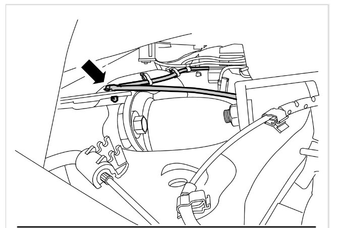

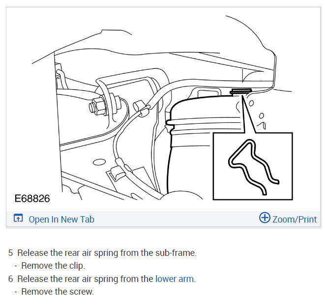

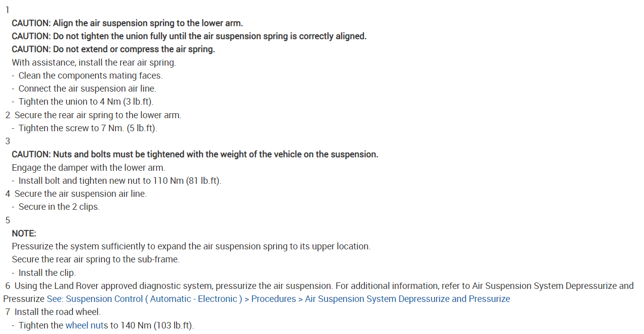

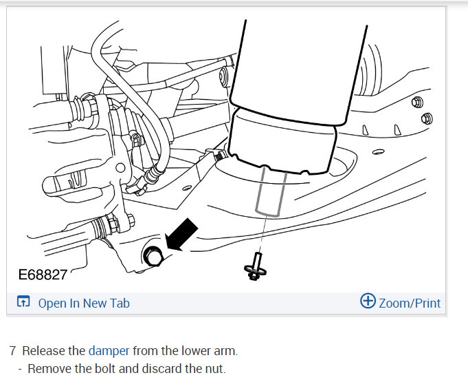

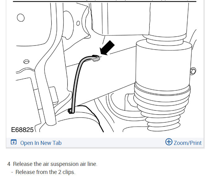

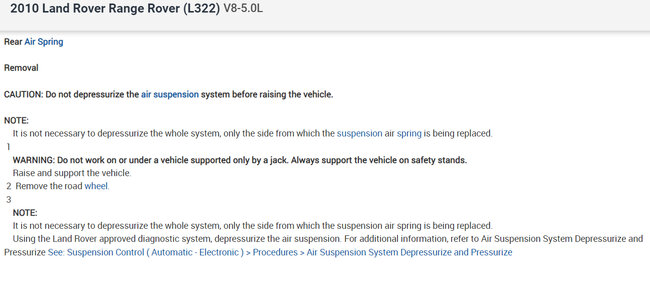

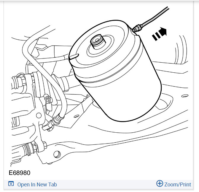

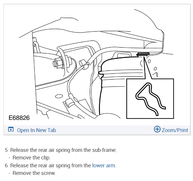

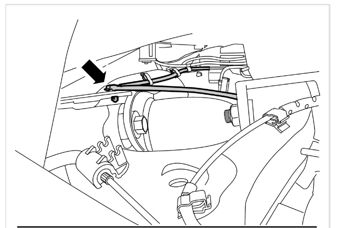

This happens when one of the rear shocks has a leak which is super common. Here is how to change them out, FYI these are a normal service item. Check out the images (below). Please let us know what happens.
