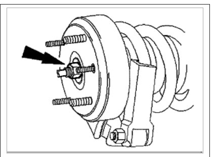

WARNING: IT IS ESSENTIAL THAT THE SPRINGS ARE CORRECTLY POSITIONED IN THE VEHICLE. THE UPPER MOUNT HOUSING CONTAINS A PAINTED MARK THAT CORRESPONDS WITH THE COIL SPRING UPPER WIRE END. IF THE MARK IS NOT EVIDENT IT IS NECESSARY TO PAINT A NEW MARK IN THE REQUIRED LOCATION.
WARNING: IF THE UPPER MOUNT HOUSING IS REPLACED, THE PAINTED MARK MUST BE COPIED ACROSS FROM THE PREVIOUS MOUNT.

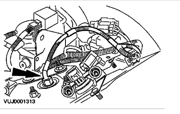

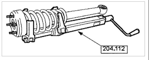

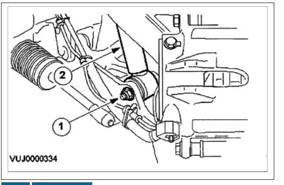

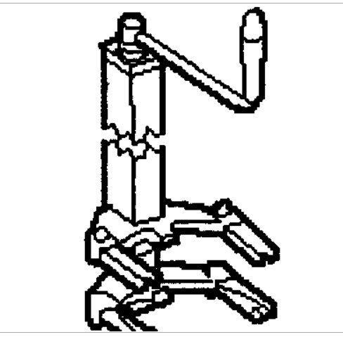

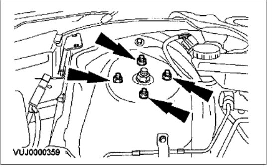

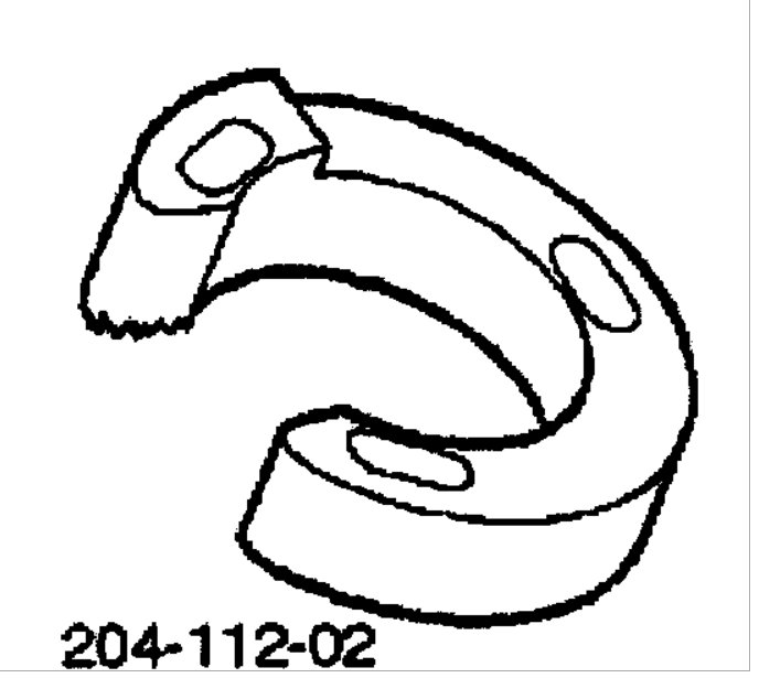

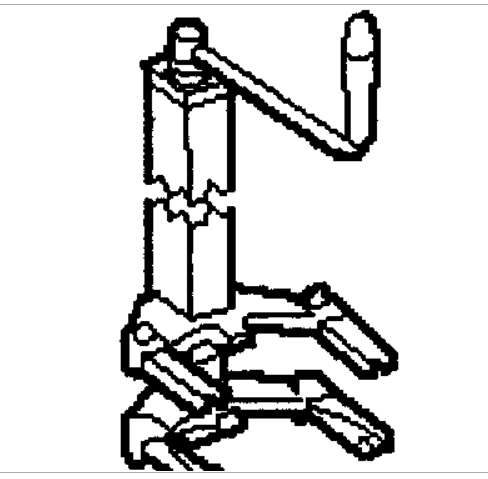

Here are some diagrams to show people how to replace front struts on your car.
