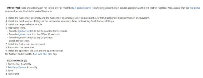

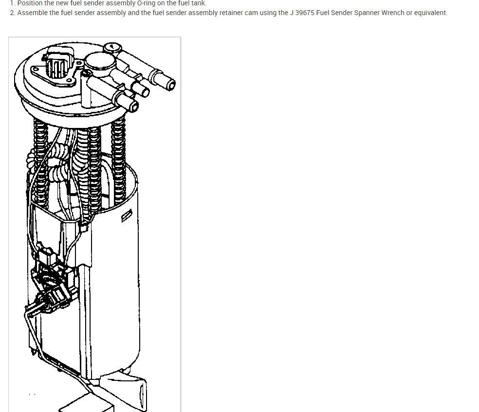

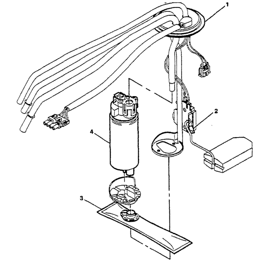

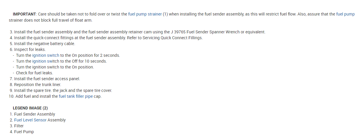

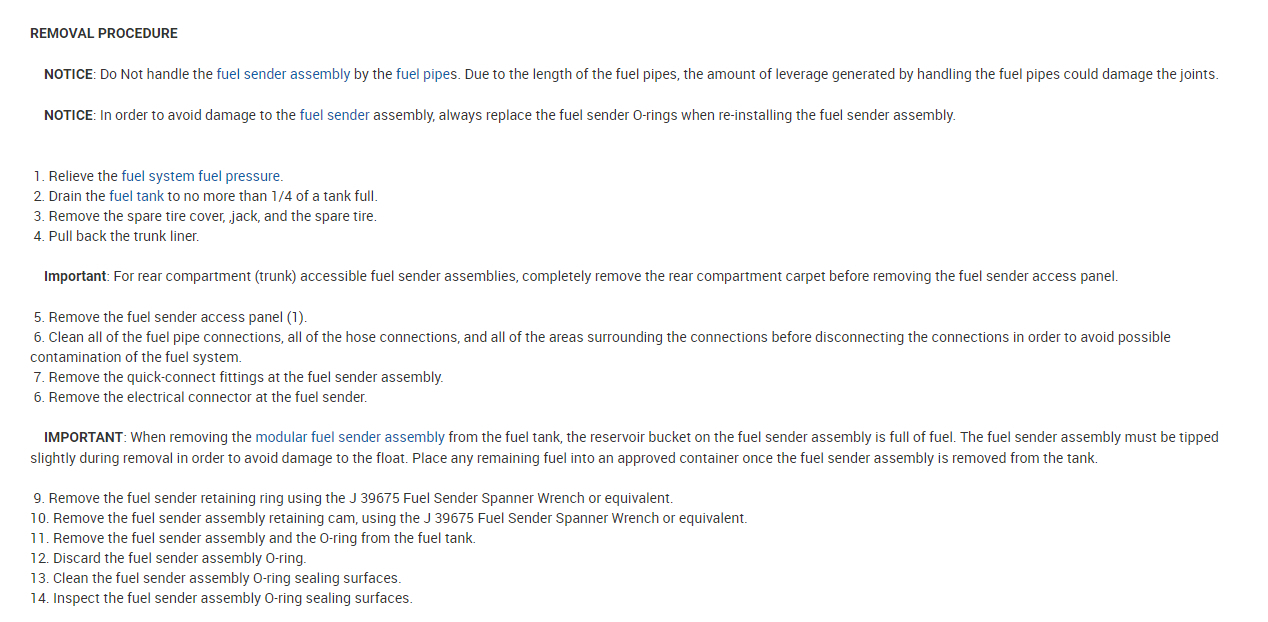

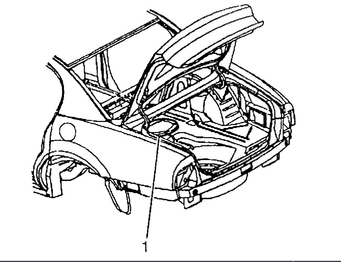

https://www.2carpros.com/articles/how-to-replace-an-electric-fuel-pump
I also attached the procedure for replacing the pump. This one you can access from the trunk. You do not have to remove the tank from the car.
