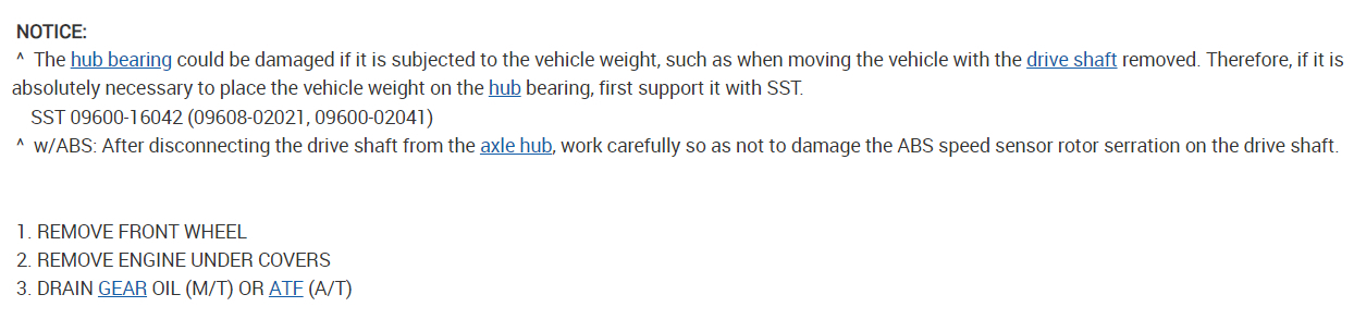

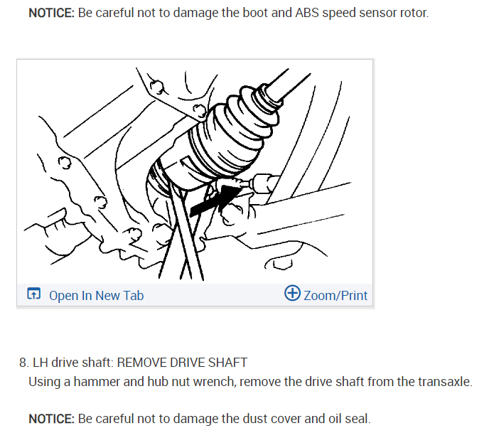

When shifting the transmission into gear and accelerating there is a knocking/ticking sound?
2002 TOYOTA COROLLA
300,000 MILES • 4 CYL • 2WD • MANUAL
SAMMY YATICH
When the car is on idle there is no sound but when put in the gear and accelerate there is a knocking sound
Dec 28, 2023 at 1:04 PM
  • 55,447 POSTS

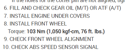

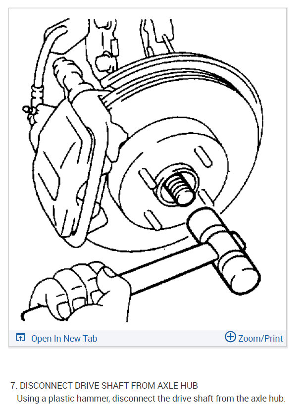

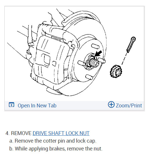

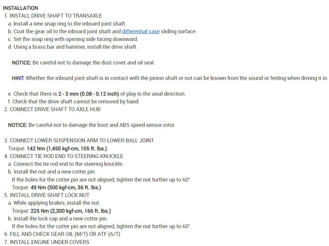

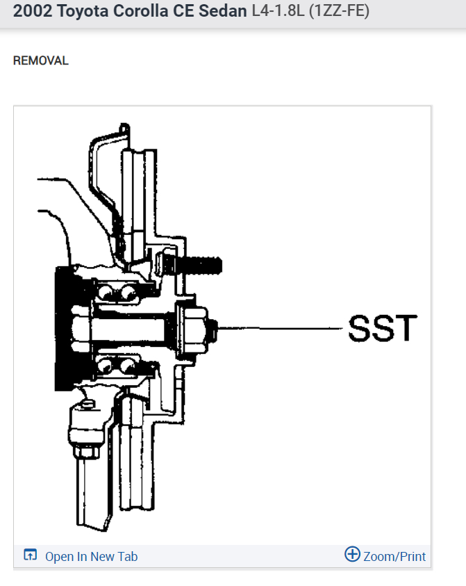

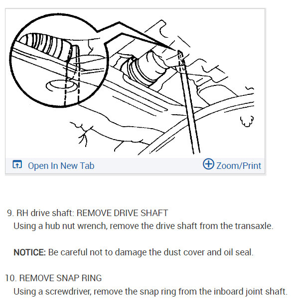

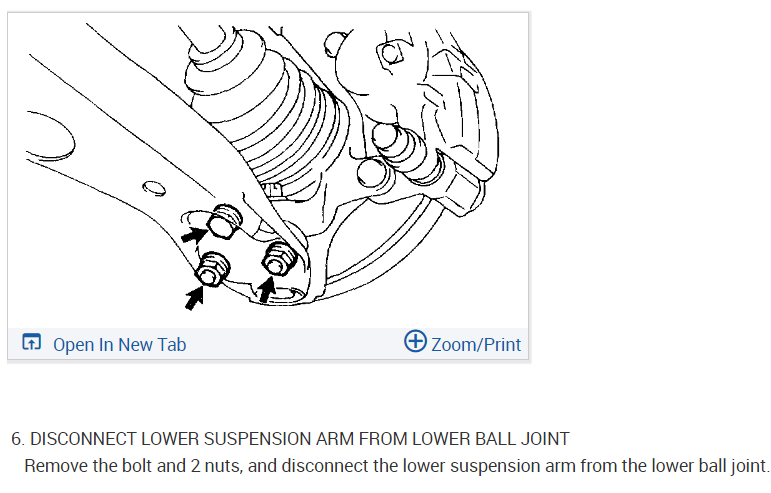

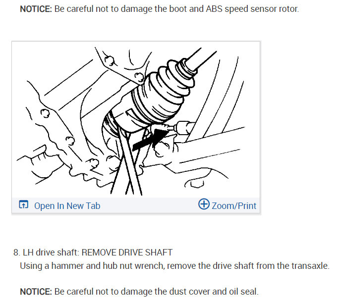

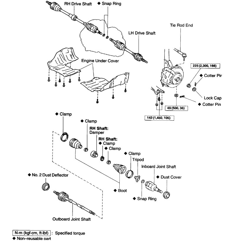

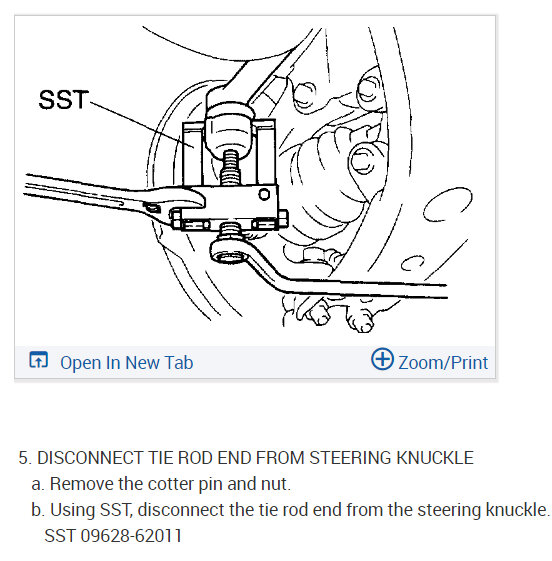

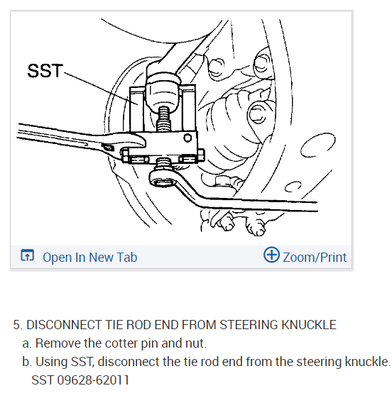

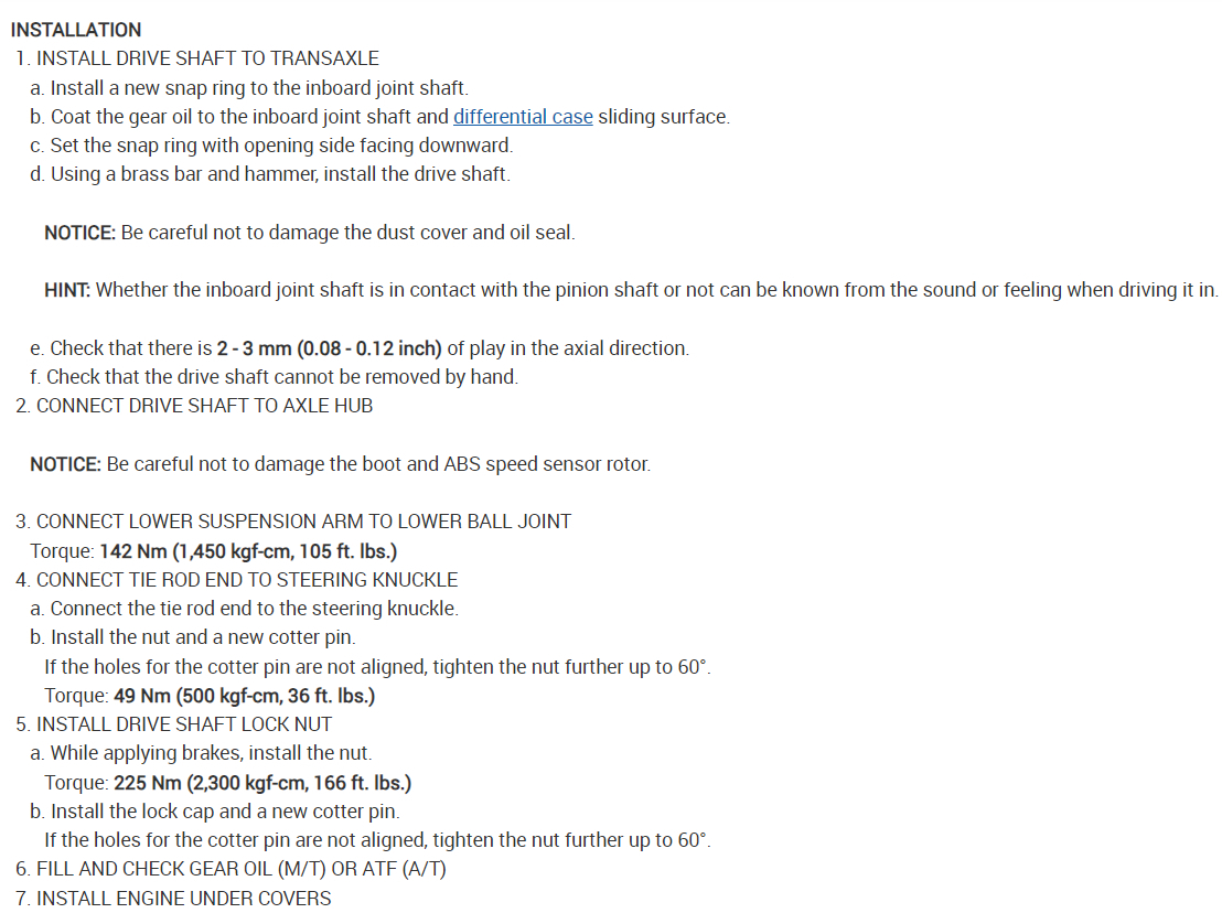

This noise can happen when the CV axles are worn out and with 300,000 on the car they need to be changed, to be sure, can you please shoot a quick video with your phone so I can hear the noise? That way I can tell for sure what's going on. You can upload it here with your response. Here is how to change the axles out so you can see what needs to be done. Check out the images (below). Please upload pictures or videos of the problem so we can see what's going on.
