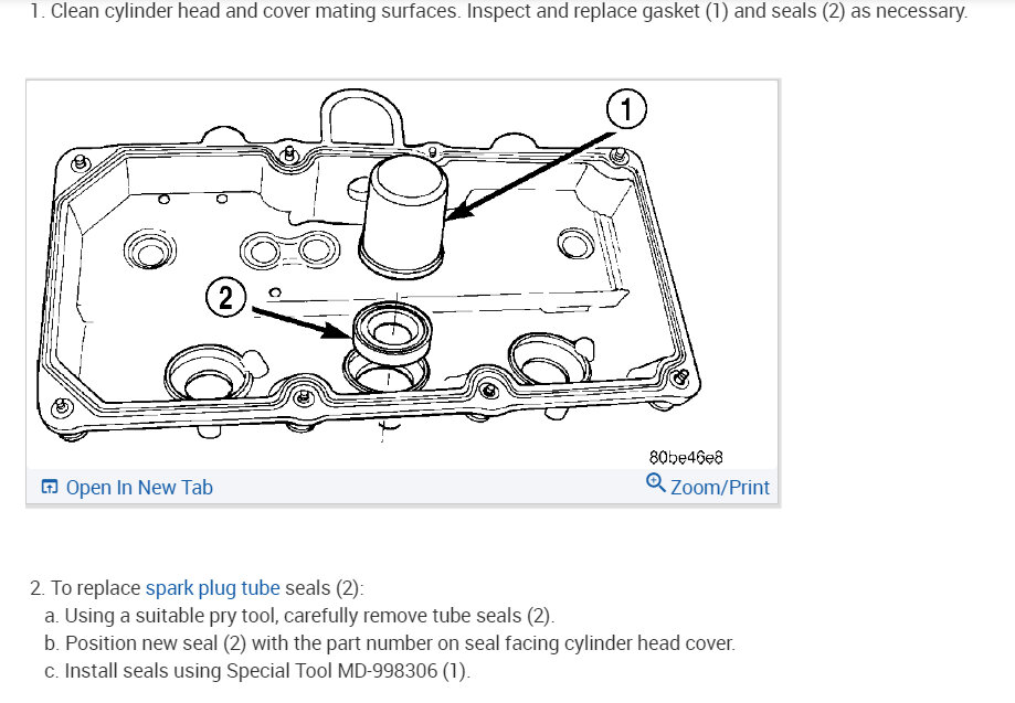

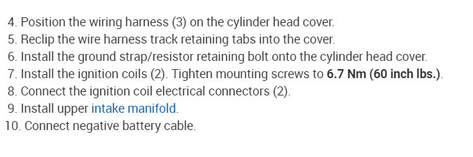

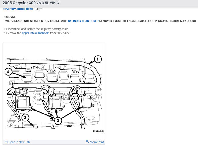

  • 55,433 POSTS

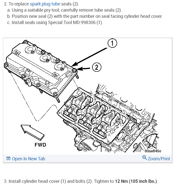

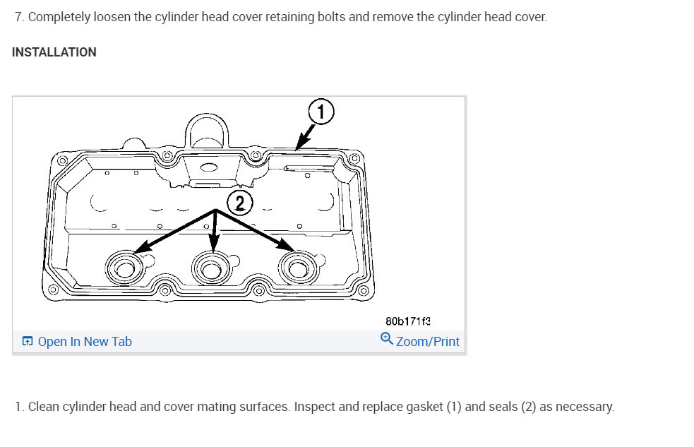

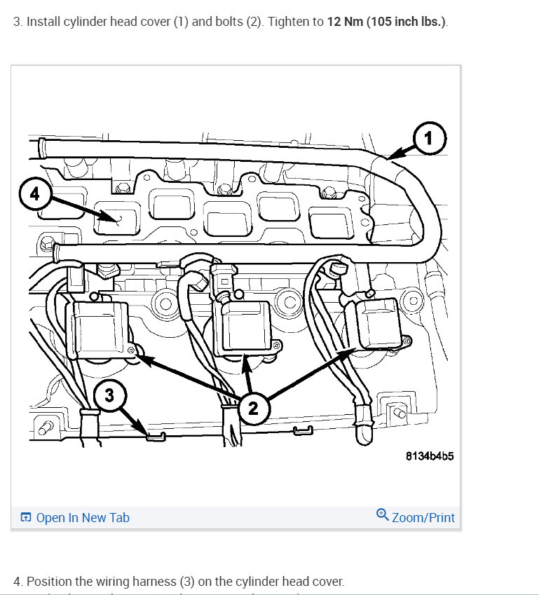

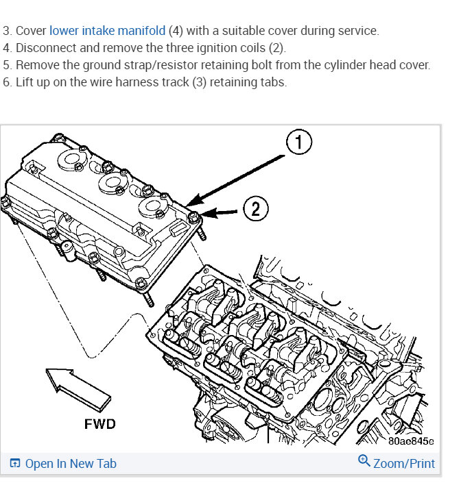

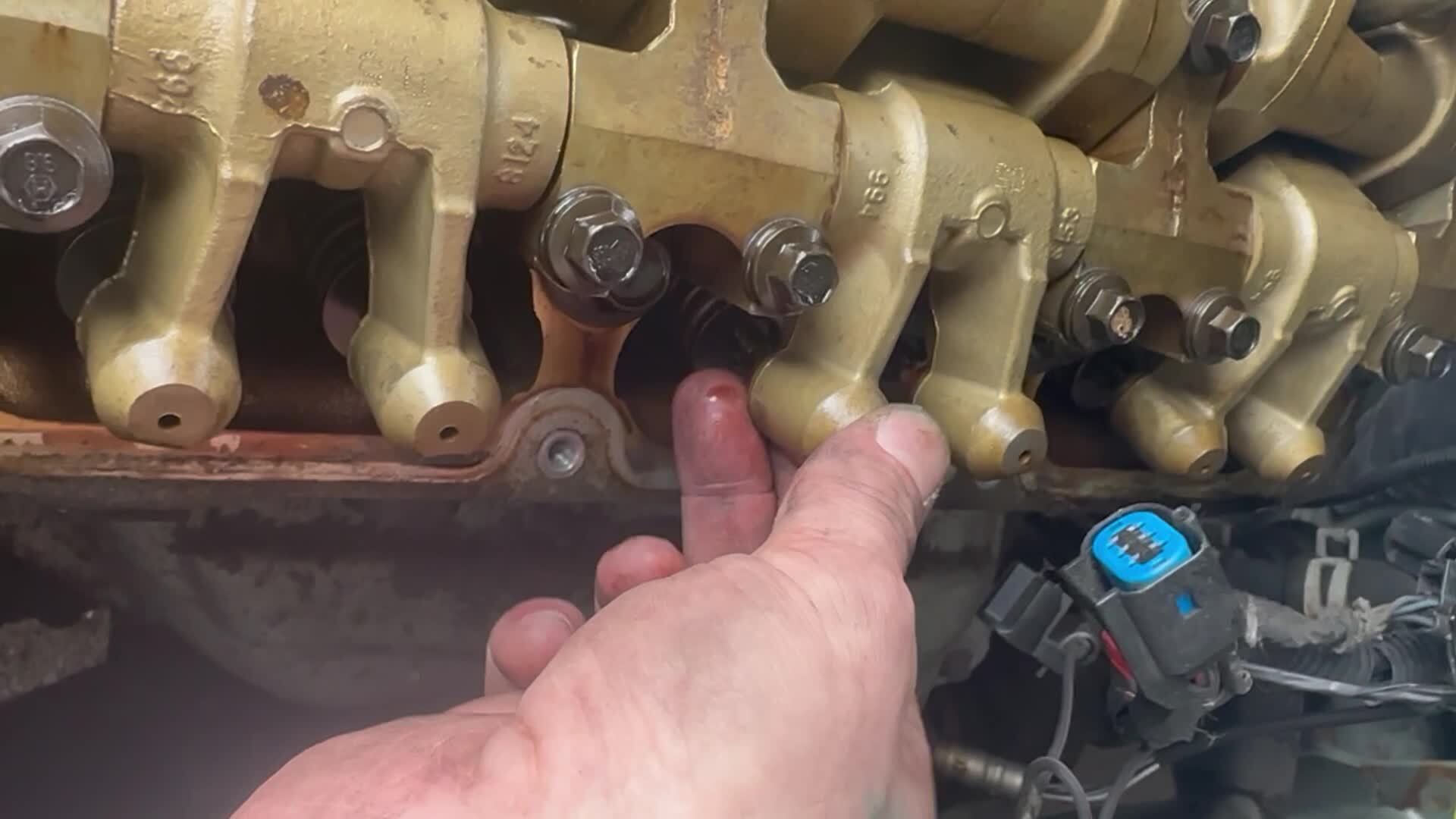

Okay, these engines had problems with the valve train, I would remove the valve cover on the side of the engine that is making the noise to check the rockers and valve lash. You are looking for excessive clearance. Check out the images (below). Let us know what happens and please upload pictures or videos of the problem so we can see what's going on.
Aug 5, 2023 at 3:14 AM

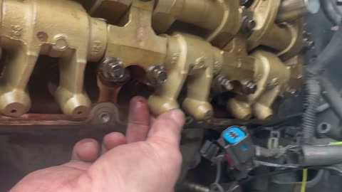

BOOSTISLYFE
  • 6 POSTS

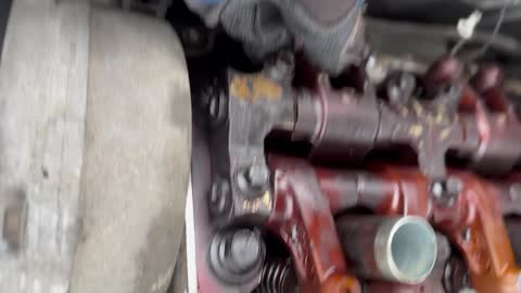

Here’s a video of the rocker assembly.
Aug 7, 2023 at 12:49 AM
  • 55,433 POSTS
Thanks for the video. From what I saw the rocker seems to be okay. You might want to turn the engine over by hand to rotate the camshafts and check the clearance again. The movement that you show is normal. Also use a flashlight and check the valve springs to make sure none of them are broken. And while you are at it check the camshaft lobes for wear.

BOOSTISLYFE
  • 6 POSTS

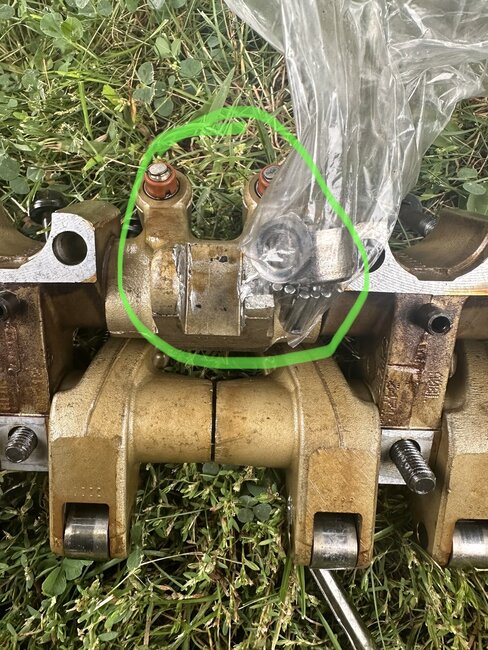

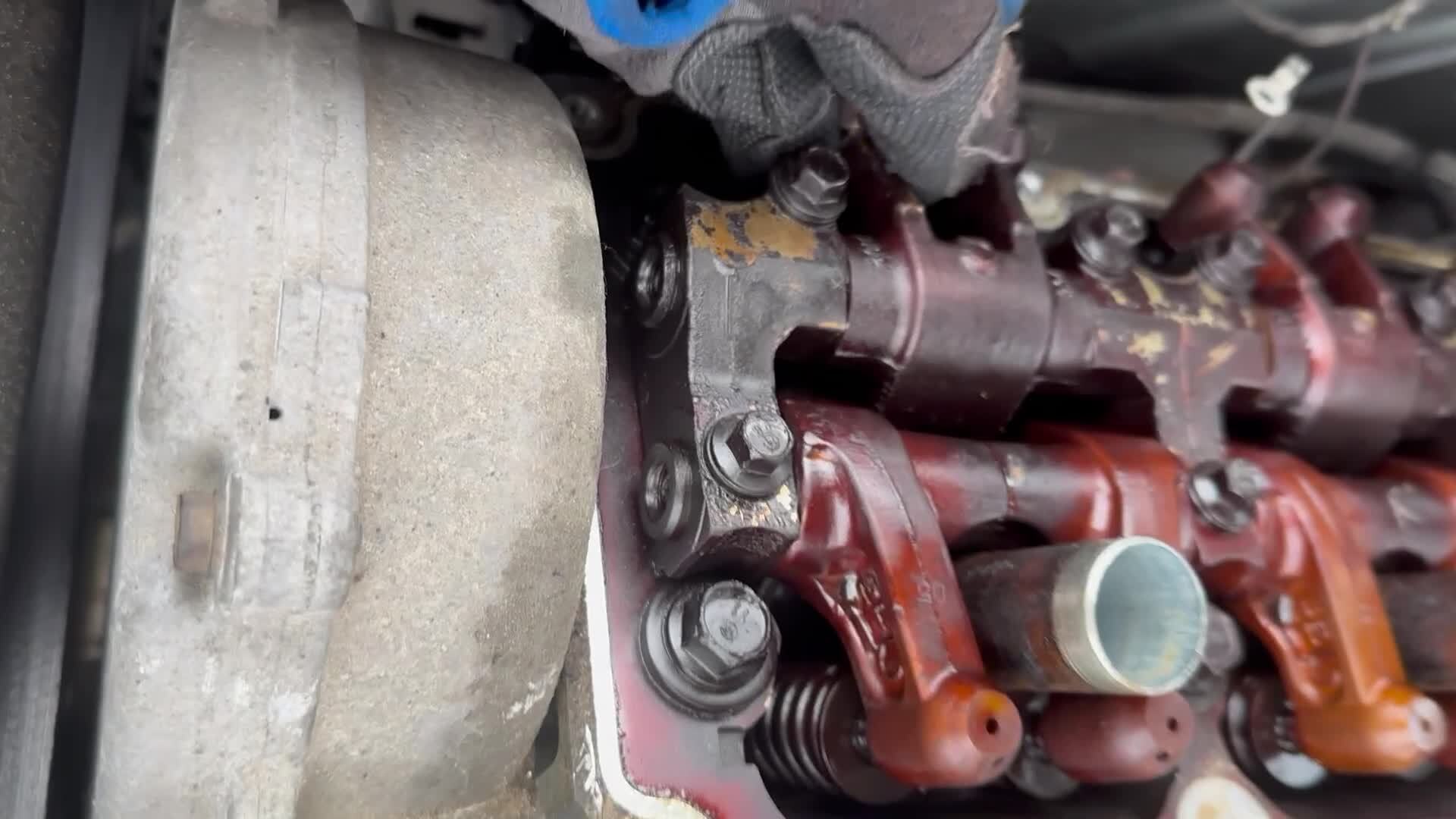

Found this on the other side.
Sep 6, 2023 at 8:00 AM
BOOSTISLYFE
  • 6 POSTS
No that was after taking that one off and why it was loose and coming off the valve.
Sep 8, 2023 at 7:15 AM
  • 55,433 POSTS
Yep, you found the problem, nice work, thanks for the video, let me know if you need anything else to fix the engine.
