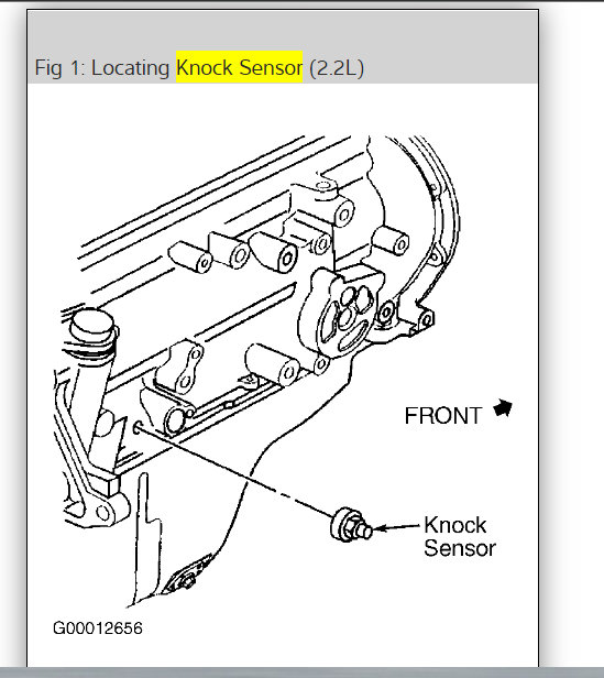

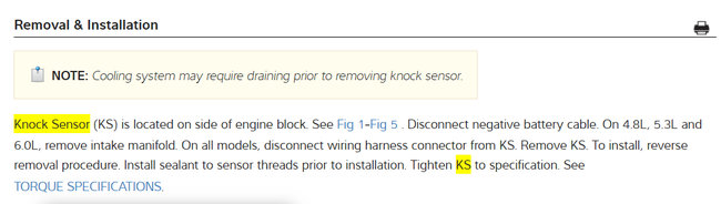

Can you tell me how many knock sensors are on my vehicle and the location?Is there a step by step instruction on how to change?

Changing your vehicle Knock Sensor(KS) is straight forward and pretty simple. I have included the directions for changing your vehicle's KS in the diagrams down below. Please get back to us with how everything turns out.
