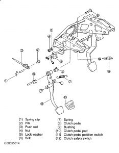

When I start my car I need to push down on the clutch. Lately my car will not start unless I pop the clutch. Or it is raining. Can it be the switch that controls the starter when the clutch is pushed down? If so what does it take to repair it and how much are they?

replace the clutch safety switch. Check out the diagrams (Below). Please let us know if you need anything else to get the problem fixed.
