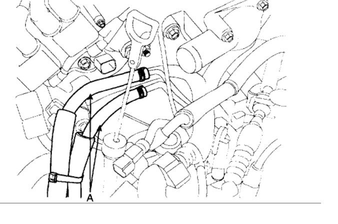

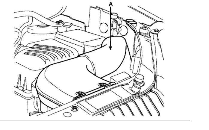

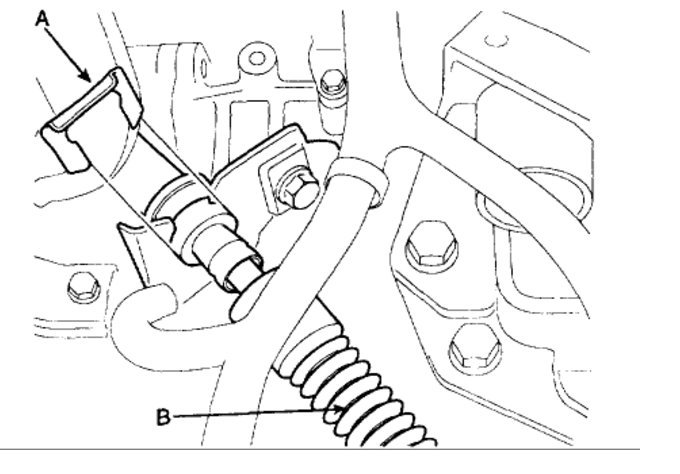

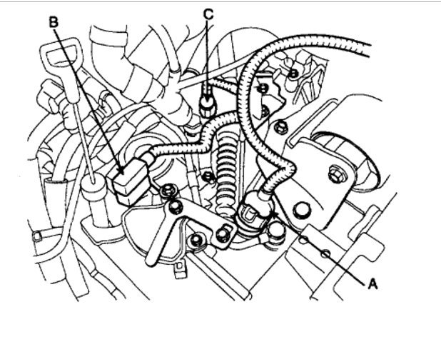

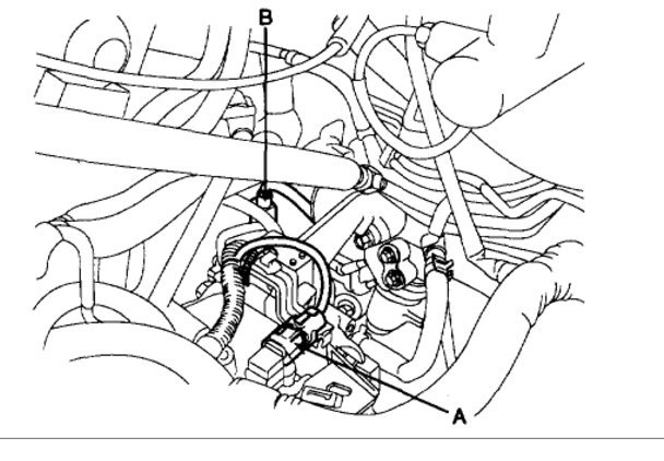

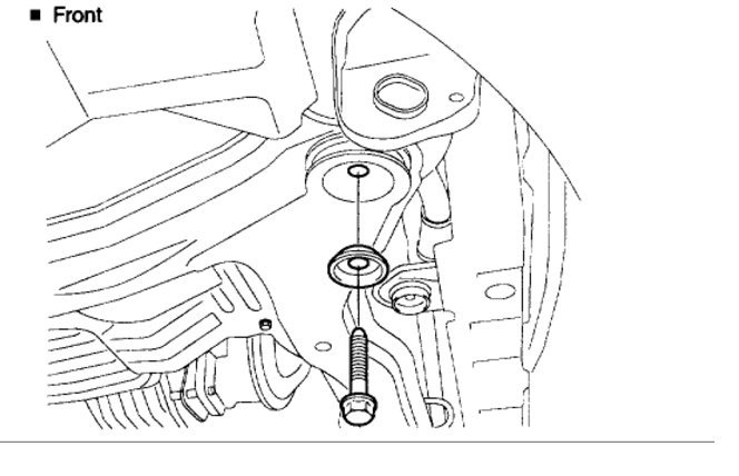

Hello , can I remove the transmission through the wheel well ?
Jun 14, 2017 at 12:16 AM
  • 55,434 POSTS

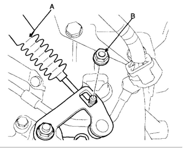

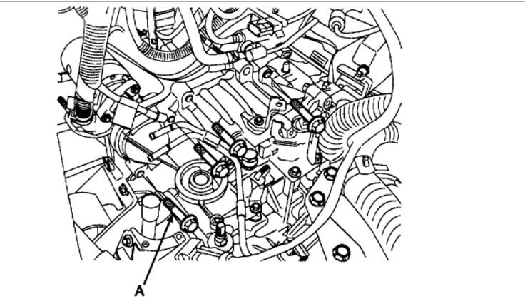

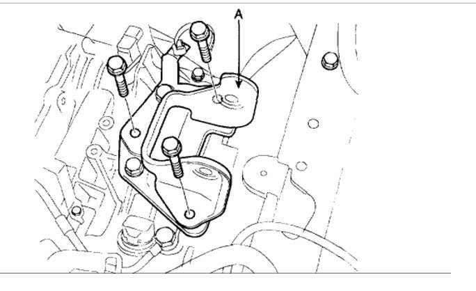

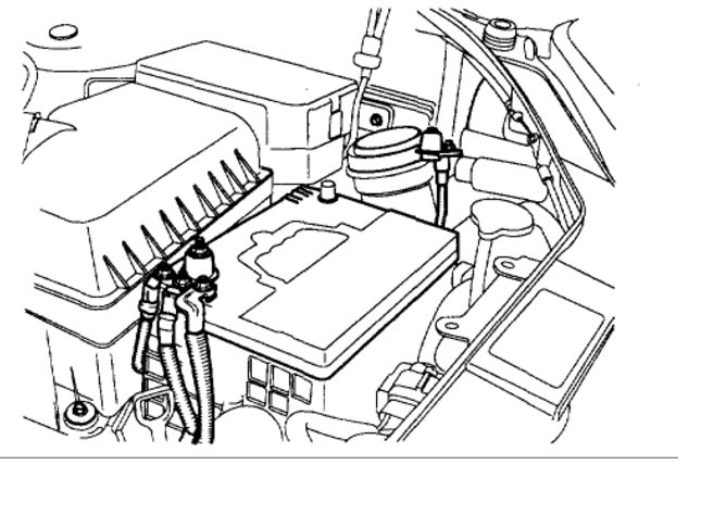

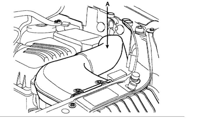

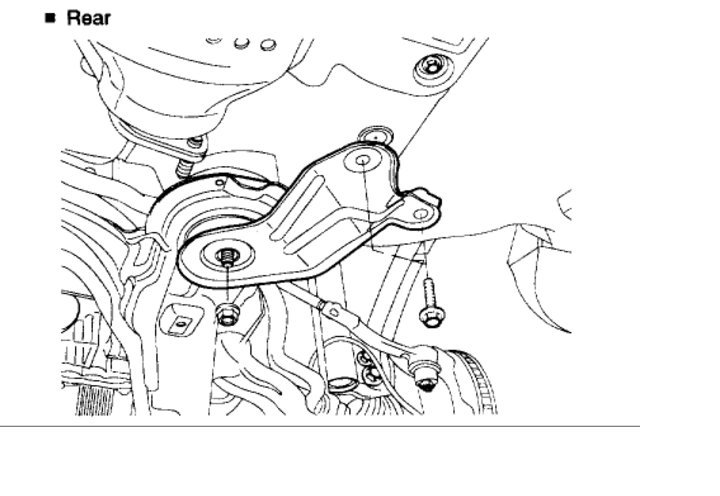

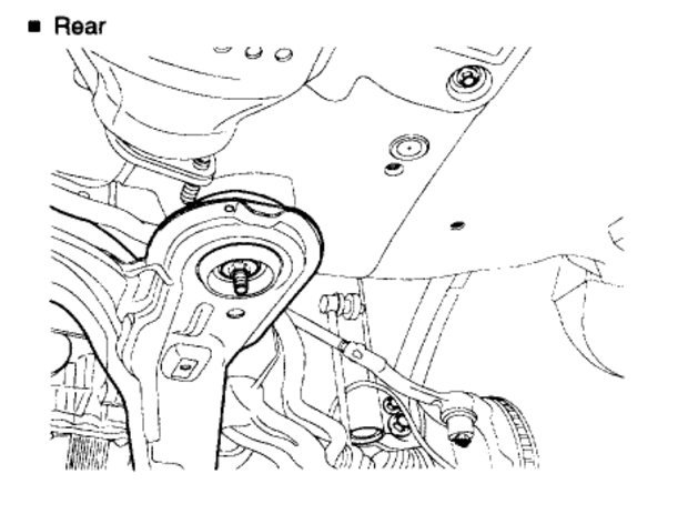

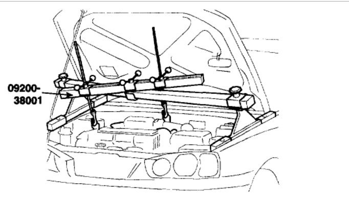

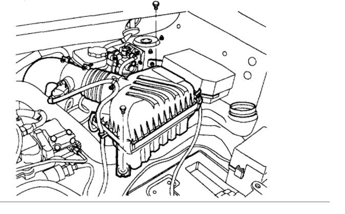

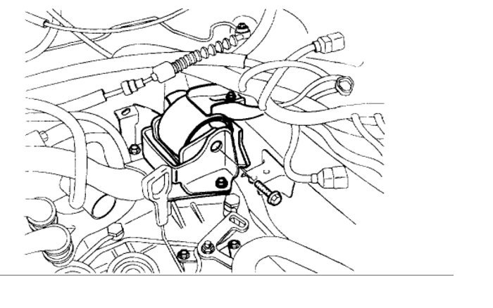

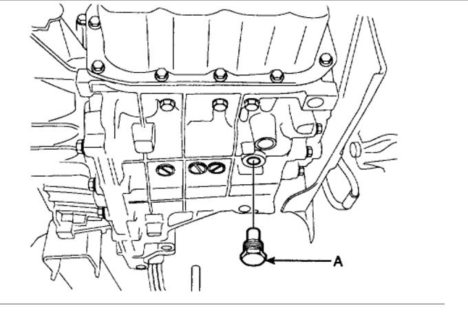

It looks like you with need to support the engine from up top and drop the cradle. Here are some diagrams (below) of the job being done. Also a guide to give you an idea on what you are in for when doing the job.
https://www.2carpros.com/articles/transmission-replacement-removal-manual
Please let us know how it goes

Hello , I need the procedure for the removal of the automatic transmission on the car listed above. I need to rebuild the transmission. Does the transmission come out through the wheel well? Thank you!
Jun 16, 2017 at 4:52 AM (Merged)
MHPAUTOS
  • 31,937 POSTS
The transmission is removed from below, the engine is supported with a frame over the engine bay and the sub frame or K frame is removed, the transmission then can be removed from below. i would suggest that you purchase a work shop manual as this will show you all the points you need to know, what tools are required and plenty of pictures to assist you. i have this here, but for a big job like this it would take many pages of typing and pictures to get it all to you, get the manual, they are not expensive and you will have a reference to any thing else that you need.
