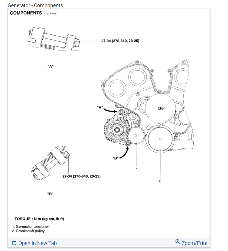

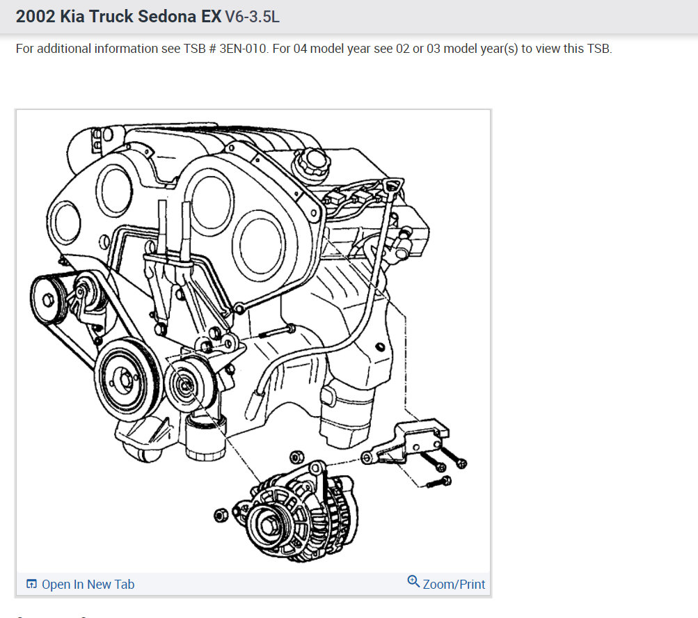

I need to remove the alternator. What I see is a confined area, and I can't find enough space to remove it. Could be possible to be removed by myself without pay a lot of money? I have mechanical skills.
Dec 13, 2020 at 1:53 AM (Merged)
IMPALASS
  • 3,112 POSTS

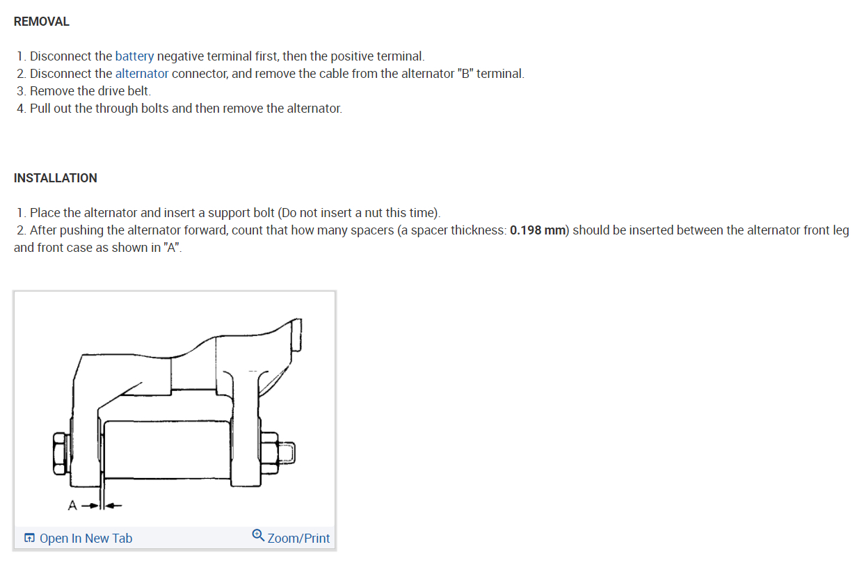

Hello - They do not have a step by step. If you have mechanical skills you should be just fine. It looks by the pic you may have to go in from the bottom. Or, some vehicles have a removal panel in the fender well area that gives you access to all. I would look there....if so remove tire and press. It also looks like you may have spacers so be careful to see what order they are. I am giving you info for a EX model....is yours the EX or LX? Also please let me know anyway the size of your engine in liter. REMOVAL Fig. 8: Removing & Installing Generator
https://images.2carpros.com/forum/automotive_pictures/248015_f8_2.jpg
INSTALLATION 1. Place the alternator and insert a support bolt (Do not insert a nut this time.) 2. After pushing the alternator forward, count that how many spacers (a spacer thickness : 0.198 mm) should be inserted between the alternator front leg and front case as shown in "A". 3. After inserting spacers, insert and tighten a nut securely. Fig. 14: Measuring For Spacers Courtesy of KIA MOTORS AMERICA, INC.
https://images.2carpros.com/forum/automotive_pictures/248015_f14_3.jpg
