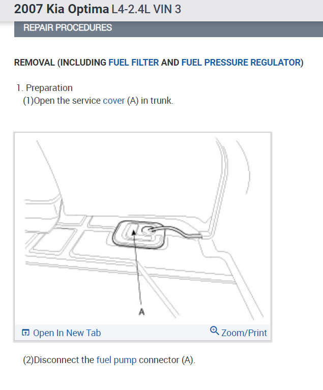

RUTHLESSJUGGALO

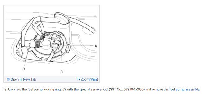

I need to change my fiancees fuel filter on her optima. Where is it located at?
Nov 5, 2010 at 1:33 AM

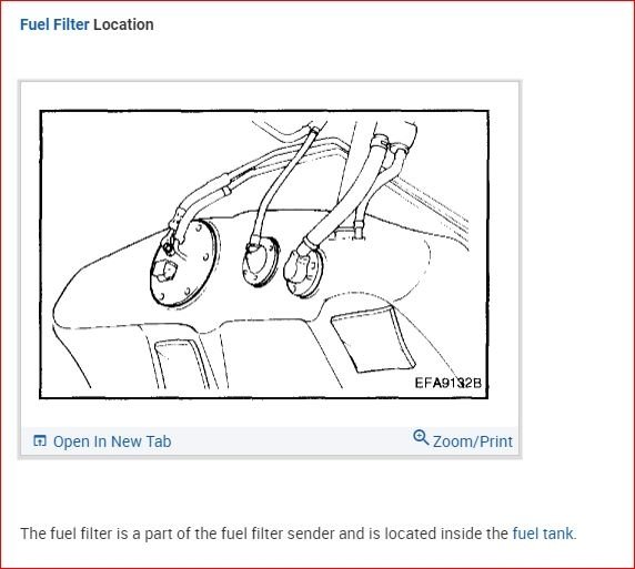

DOCFIXIT
  • 18,828 POSTS
In fuel tank part of pump assembly. Here is a guide to help you step by step with instructions in the diagrams below to show you how on your car.
https://www.2carpros.com/articles/how-to-change-a-fuel-filter
Dec 31, 2019 at 5:58 AM
RUTHLESSJUGGALO
So I have to drop the tank to get to it?
DOCFIXIT
  • 18,828 POSTS
no it is accessed through the trunk

GDSMOPAR
Where is my fuel filter located on my vehicle? The car is showing signs of sluggishness up hills and when I speed up rapidly; it may be misfiring caused by a fuel injector, but I would like to try changing the fuel filter first. I have a 2.4 liter 16v DOHC four cylinder engine and cannot find the fuel filter; normally they are located near the fuel tank and did not see it. What am I missing? Your help would be greatly appreciated. Thanks.
Jan 22, 2021 at 5:14 AM (Merged)
BLUELIGHTNIN6
  • 16,542 POSTS
Yeah, it should be near fuel tank if it is an in-line filter which is what it is listed as. Although, earlier models of the Optima had the fuel filter in the tank with the pump and sender assembly. So I would not be surprised if they have it listed wrong. May want to check there for the fuel filter. Try removing rear seat cushion to see if you have an access panel. Should be able to see sender unit from there to locate filter if it is in the fuel tank.
GDSMOPAR
Thanks. The access hole is in the trunk just behind the seats you do not need to remove the seat to access it; it is in the middle with a plastic cover. Thanks again, as soon as I figure out how to open the sending unit cover I will let you know how it runs if you are interested; I am sure it just unscrews. Anyway thanks again.

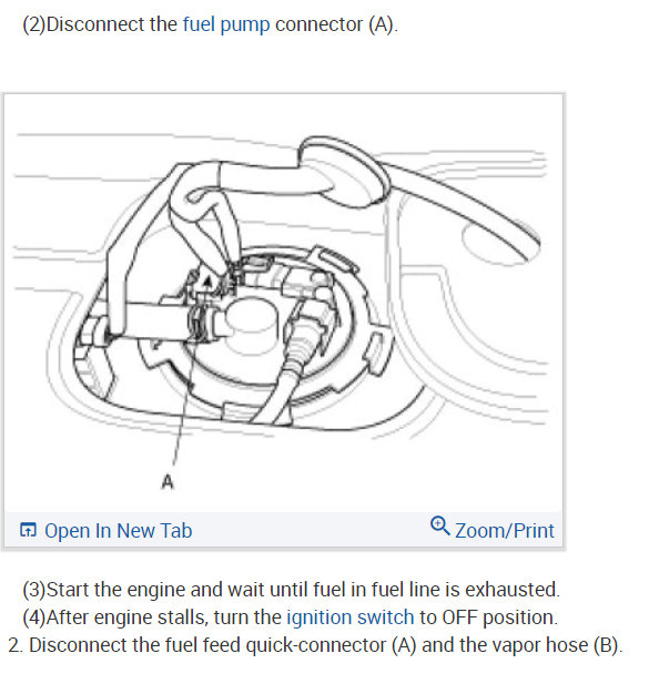

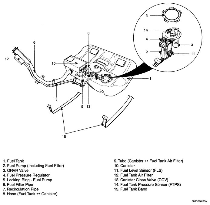

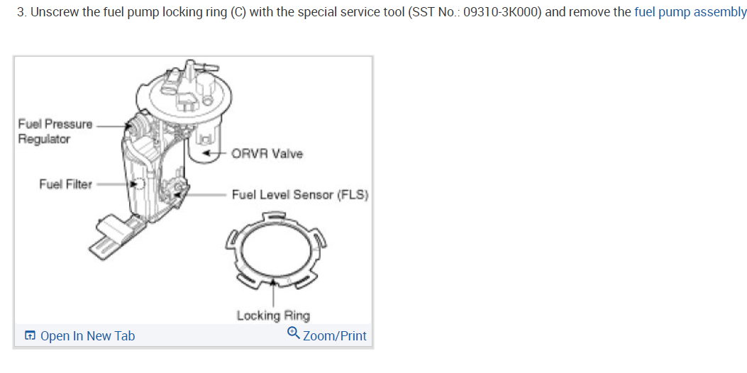

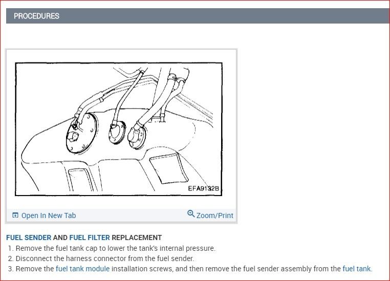

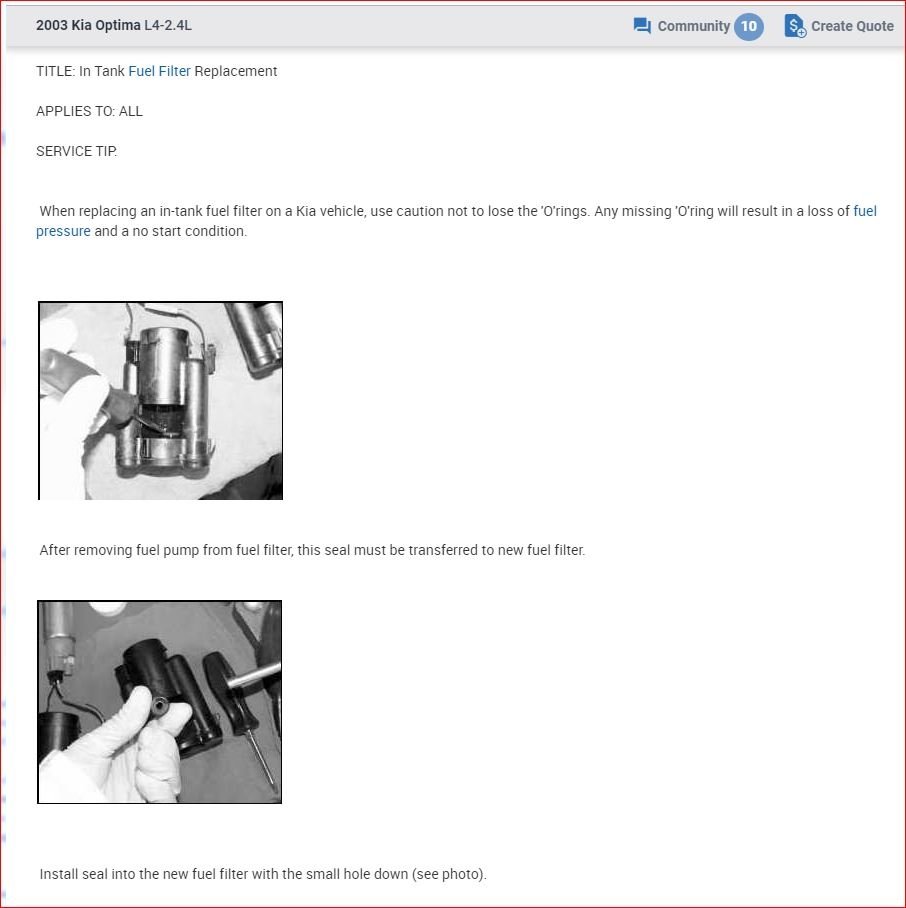

CJ MEDEVAC
  • 11,004 POSTS
The fuel filter is part of the in-tank fuel pump in your vehicle (#2), you will need to remove the fuel tank to get to it.
Check the guide below on fuel tank removal as well as the diagrams for your specific vehicle and get back to us if you need anything else.
https://www.2carpros.com/articles/how-to-replace-an-electric-fuel-pump

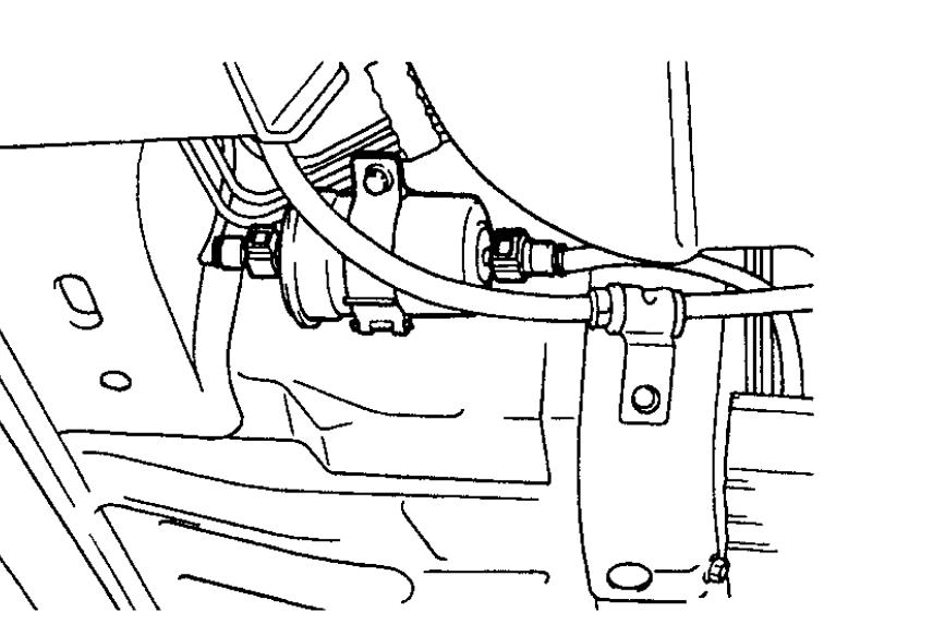

I am having a difficult time locating to the fuel filter on a my car it has a 2.4 liter engine. Could you please help me locate it and give me any tips you could to assist me in changing it? I was told it is inside the gas tank and it may or may not have an access panel. Is there a gasket I will need or is is even in the tank?
Jan 22, 2021 at 5:15 AM (Merged)

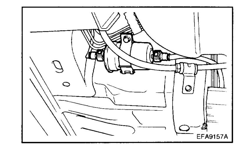

BLUELIGHTNIN6
  • 16,542 POSTS
It is under vehicle mounted in the fuel rail line (pictured below). Some cars have them and some don't depending on production date.
https://images.2carpros.com/forum/automotive_pictures/261618_1_69.jpg
INSTALLATION: Install the filter in the mounting bracket. Connect the fuel lines to the filter. Install the bracket nuts and tighten to 9.5 ft. lbs. (13 Nm) for 1.5L, 1.6L, 1.8L and 2.0L engines. For 2.4L engines, torque the nuts to 18-25 ft. lbs. (25-35 Nm). Connect the negative battery cable. Run the engine and check for any fuel leaks. Thanks for using 2CarPros.com! check the post BELOW!

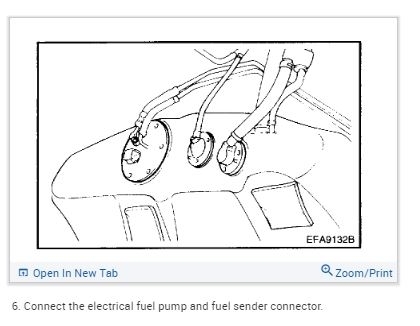

  • 55,447 POSTS
This fuel filter location is in the rear of the car near the fuel tank on the drivers side.
Here is a guide to help you get the job done:
This guide will show you how to raise the car up safely.
Some Kia's do not have an external fuel filter the filter is in the tank, check out these diagrams (below) Its considered a lifetime filter.

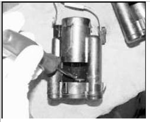

BIGGUY1968
I have looked all over and can't find the fuel filter.
That is because the filter is part of the fuel pump inside the tank. The only time it is replaced is when the pump is removed for other reasons. Otherwise it just stays in there.
I attached the info on this. Let us know if you have more questions. Thanks

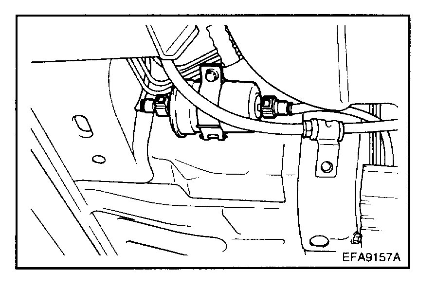

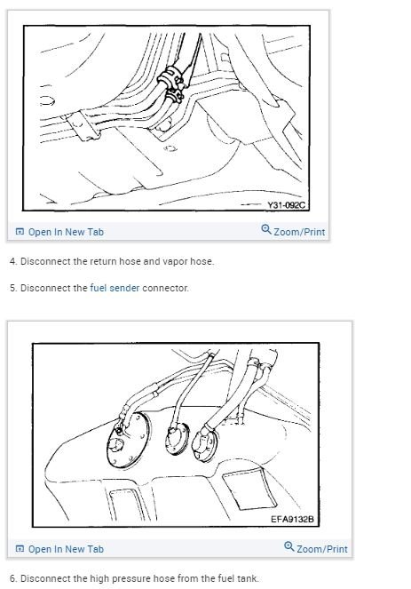

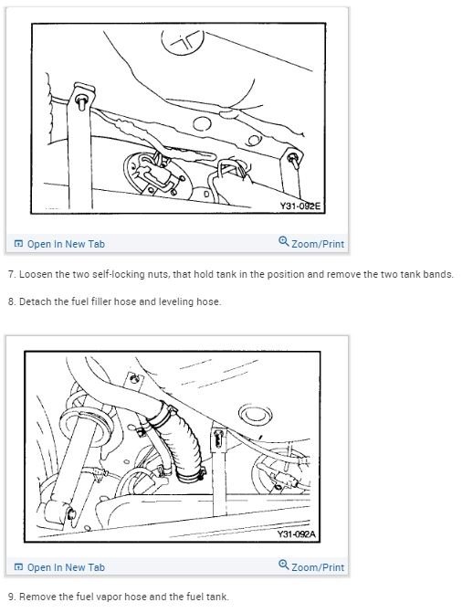

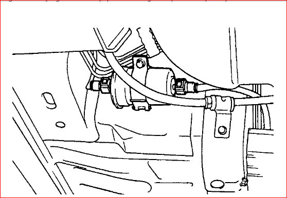

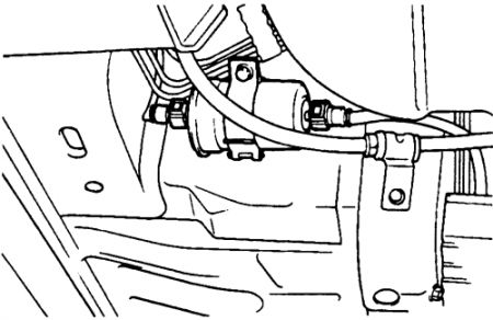

  • 110,244 POSTS
The fuel filter is located underneath the chassis on the left hand side of the fuel tank.
See picture 1
Here is a link that shows in general how one is replaced:
Here are the directions specific to your vehicle for replacement:
___________________________________
FUEL FILTER REPLACEMENT
1. Reduce the internal pressure of the fuel lines and hoses and perform the following operations.
- Disconnect the fuel pump harness connector in the trunk room.
- Start the engine and, after it stops, turn the ignition switch to OFF.
- Disconnect the battery negative (-) terminal.
- Connect the fuel pump harness connector.

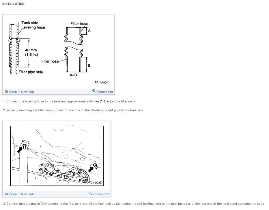

2. Remove the two fitting nuts while holding the fuel filter nuts securely.
See picture 1
3. Remove the fuel filter mounting bolts, and then remove the fuel filter from the fuel filter clamp.
Tightening torque
Fuel filter fitting nut : 25 - 35 Nm (250 - 350 kg.cm, 18 - 25 lb.ft)
____________________________________

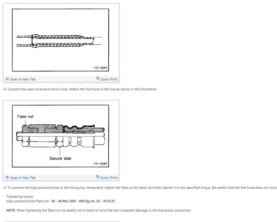

  • 75,992 POSTS
Here is a guide to help walk you through the job with a diagrams below to help you see the location on your car.

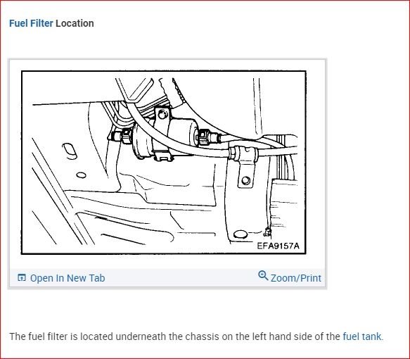

JENJOHN24
Having a problem finding the fuel filter on my car.
Good afternoon,
What is the issue?
Hi John,
I attached the location of the filter from the manual. However, it appears there are some that do not have this external filter. If yours does not have the filter in this location, the second attachment shows the in tank filter. Unfortunately, this is inside the fuel tank but all in tank filters are serviced for life and do not require replacement unless the pump comes out for some other issue.
Let me know if you have any other questions about this. Thanks

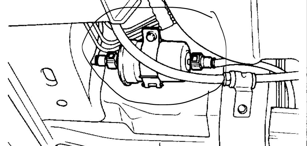

DANNY L
  • 5,648 POSTS
Hello, I'm Danny,
Here is a basic fuel filter replacement tutorial for you to view:
I've attached a picture (below) of its location. It's under left side of vehicle, forward of fuel tank. Hope this helps and thanks for using 2CarPros.
Danny-

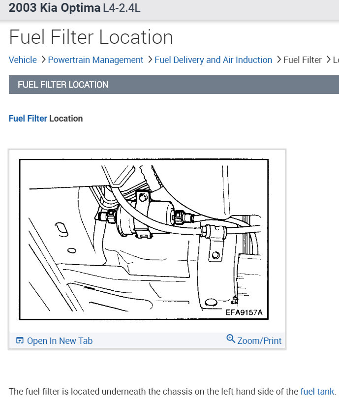

GINA VANSELOW
I need to change my fuel filter?
Good morning,
The fuel filter is located underneath the chassis on the left hand side of the fuel tank. Check out the diagrams (Below). Please let us know if you need anything else to get the problem fixed.

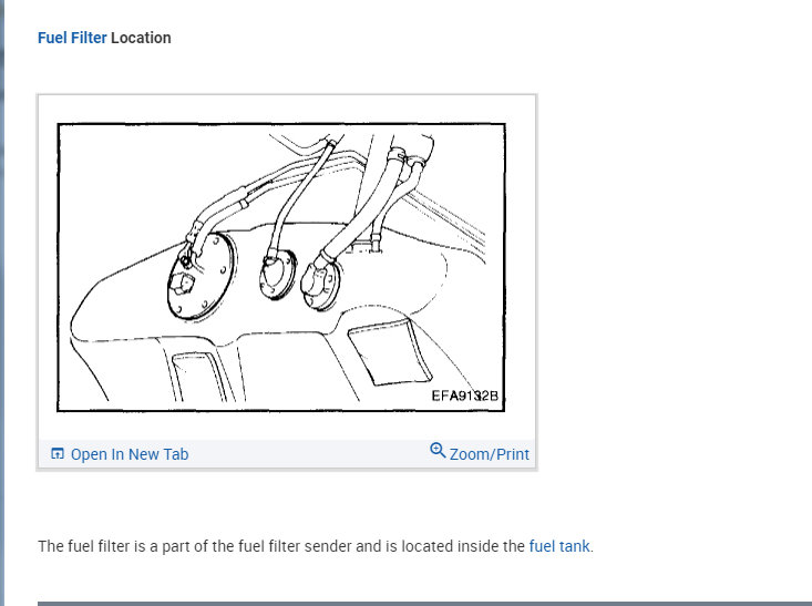

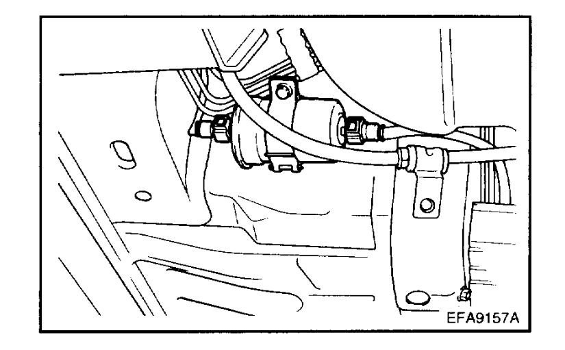

ARNOLDG576
I have been trying to find the location of the fuel filter, but cannot seem to find it. although I looked thoroughly under the car.

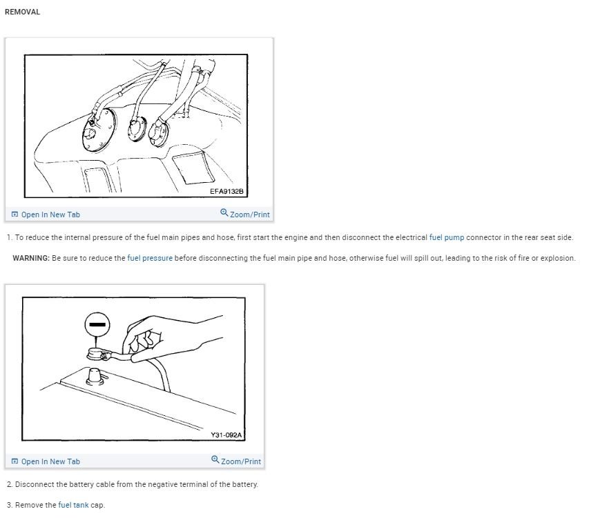

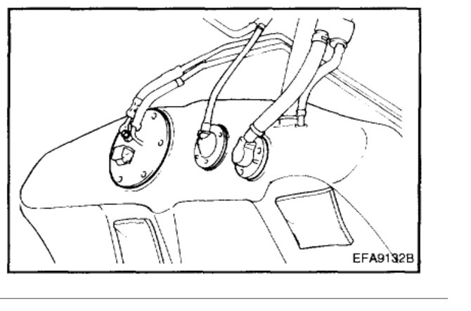

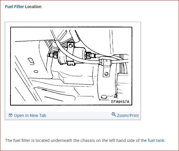

  • 110,244 POSTS
Welcome to 2CarPros.
I believe it is the left side, under vehicle, near the rear wheel. Take a look at the attached picture.
Here are the directions specific to your vehicle:
2003 Kia Optima L4-2.4L
Procedures
Vehicle Powertrain Management Fuel Delivery and Air Induction Fuel Filter Service and
PROCEDURES
pic 2
Tightening torque
Let me know if that helps or if you have other questions.
joe
