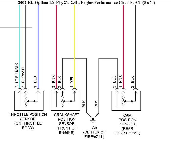

also when i got the car, the three wires that plug into the cmp (camshaft position) sensor are wired directly, idk what order they need to be in and the engine balancer shaft belt was missing, so either someone already looked took it out of someone left it out a while back, if the shaft was somehow messed up and causing vibration, what would leaving the balance shaft belt off do?

KHLOW2008
  • 41,812 POSTS
The attached diagram shows the wiring circuit. Hope it is helpful.

thank you for the diagram!
is the crankshaft position sensor more important than the camshaft position sensor?
Jan 10, 2020 at 3:43 AM (Merged)
KHLOW2008
  • 41,812 POSTS
Both are equally important as each has its own own duties.

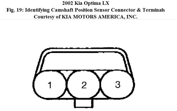

does anyone know what order the wires to the CMP sensor need to be in from top to bottom, theres a black ground wire, a black signal wire with a few dashes on it, and a pinkish hot wire

The faulty CMP would cause difficult starting and erratic idling and stalling.
The above wiring diagram shows the order of the CMP wires.

thanks for the diagram again
