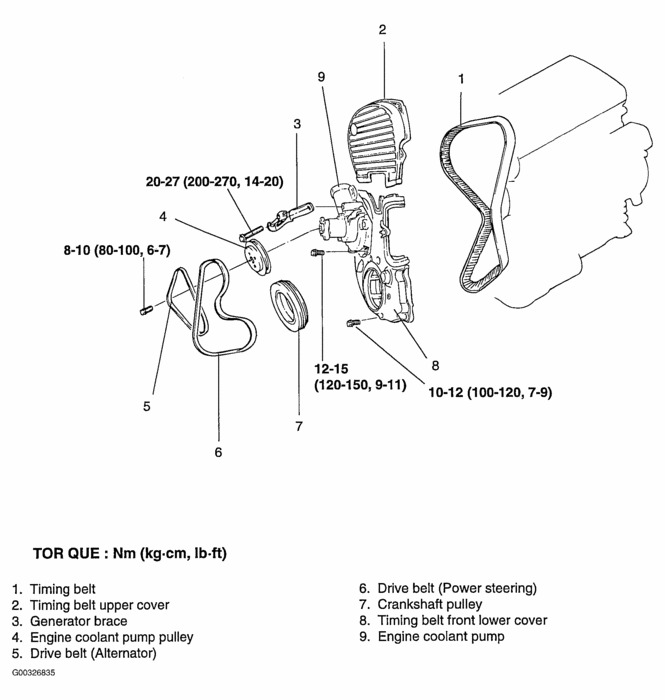

RIVERMIKERAT
  • 6,110 POSTS
Water pump noise means the bearing is going out. Replace it soon.
Two person job: With the hood up and one person standing to the side of the vehicle, have the other person put the car in gear while holding the brake firmly and with the parking brake engaged. Person in the driver's seat gives the engine a little throttle. Observe the engine for jumping or movement.

COPTERMECH
Thanks, I was afraid you'd say that. The water pump looks like a pain to change! I'll check the other items also though I haven't noticed any performance or mileage changes.

RIVERMIKERAT
  • 6,110 POSTS
See image.
2.4L 4-CYLINDER ENGINE -2003 Kia Optima SE
Page 1 of 2
ENGINE COOLANT PUMP
REMOVAL
Drain the coolant and disconnect the radiator outlet hose and engine coolant by-pass hose from the engine coolant pump.
Remove the drive belt and engine coolant pump pulley. Remove the timing belt covers and the timing belt tensioner.
Remove the engine coolant pump mounting bolts and then remove the alternator brace. Remove the engine coolant pump assembly from the cylinder block.
Install the timing belt tensioner and timing belt. Adjust the timing belt tension, and then install the timing belt covers.
Install the engine coolant pump pulley and drive belt, and then adjust the belt tension. Refill the coolant.
7. Run the engine and check for leaks.

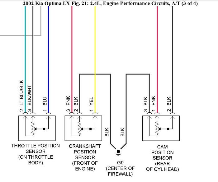

BOBAREZO
  • 28 POSTS
alright so i bought a 2002 Kia Optima 2.4L for cheap cause it was broke, the timing belt broke and all valves got bent, so i installed reman. head and timing belts, everything is timed perfect including balance shaft, got a tune up, oil change, new cmp sensor but still when all back together, starts for ab 3 seconds, vibrates excessively (like a electric toothbrush on steroids) then dies every time even with map sensor, maf sensor or cmp sensor unplugged (1 at a time) im pretty sure its throwin a code, will have it scanned tomoro......any ideas of what i need to check
Jan 10, 2020 at 11:43 AM (Merged)
BOBAREZO
  • 28 POSTS
also when i got the car, the three wires that plug into the cmp (camshaft position) sensor are wired directly, idk what order they need to be in and the engine balancer shaft belt was missing, so either someone already looked took it out of someone left it out a while back, if the shaft was somehow messed up and causing vibration, what would leaving the balance shaft belt off do?

KHLOW2008
  • 41,814 POSTS
The attached diagram shows the wiring circuit. Hope it is helpful.
BOBAREZO
  • 28 POSTS
thank you for the diagram!
is the crankshaft position sensor more important than the camshaft position sensor?
KHLOW2008
  • 41,814 POSTS
Both are equally important as each has its own own duties.

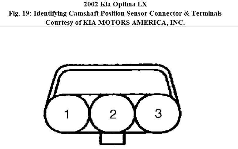

BOBAREZO
  • 28 POSTS
does anyone know what order the wires to the CMP sensor need to be in from top to bottom, theres a black ground wire, a black signal wire with a few dashes on it, and a pinkish hot wire

KHLOW2008
  • 41,814 POSTS
The faulty CMP would cause difficult starting and erratic idling and stalling.
The above wiring diagram shows the order of the CMP wires.

BOBAREZO
  • 28 POSTS
thanks for the diagram again
