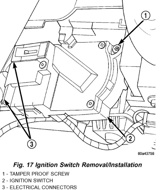

I overhauled this car replacing all pistons with new rings after piston one from the back break both block and sump.
After the overhaul this car started but was losing power as it drives or will just switch off while driving and stops. One day it started by not starting and after trying for several time it started but still with no power until the key could only turn to on only. What might be the problem because the mechanic where I took it could not fix it.
Please help me

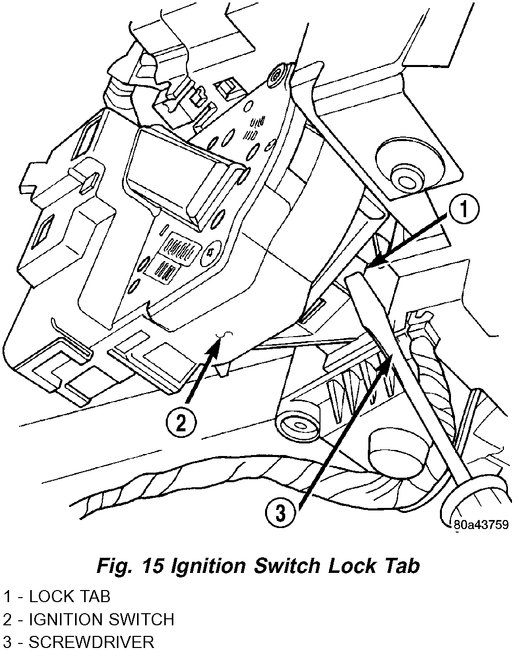

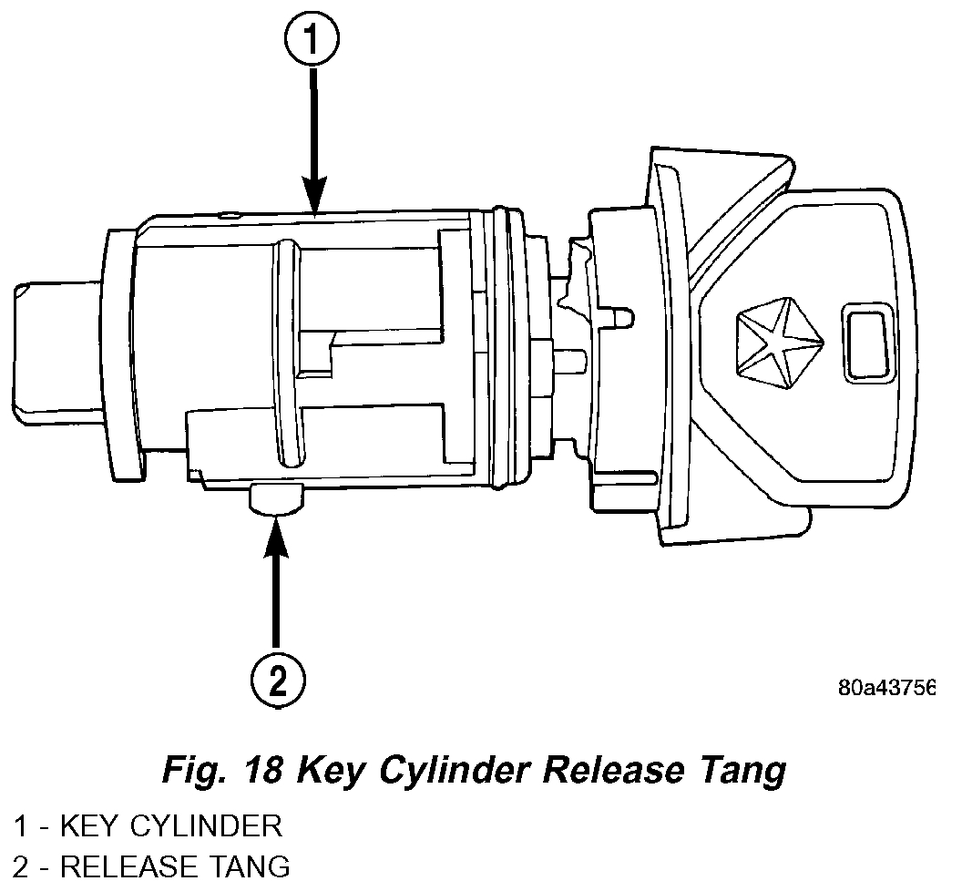

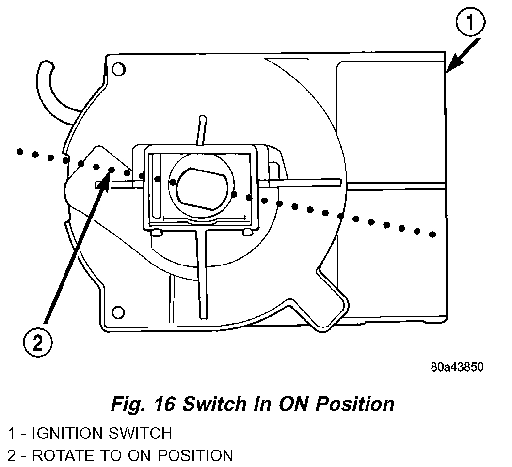

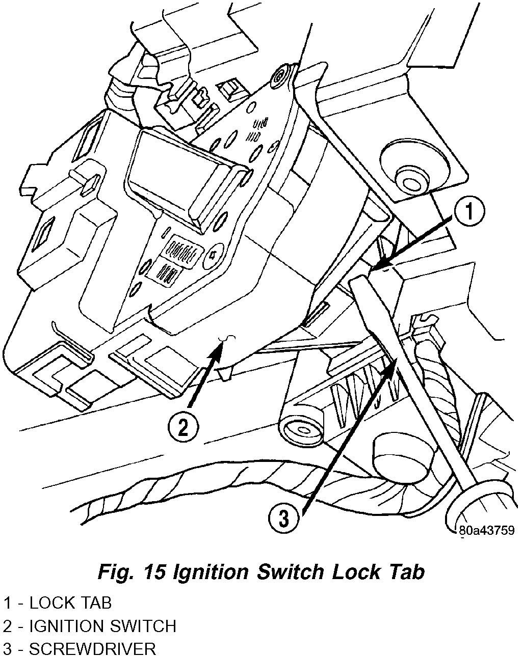

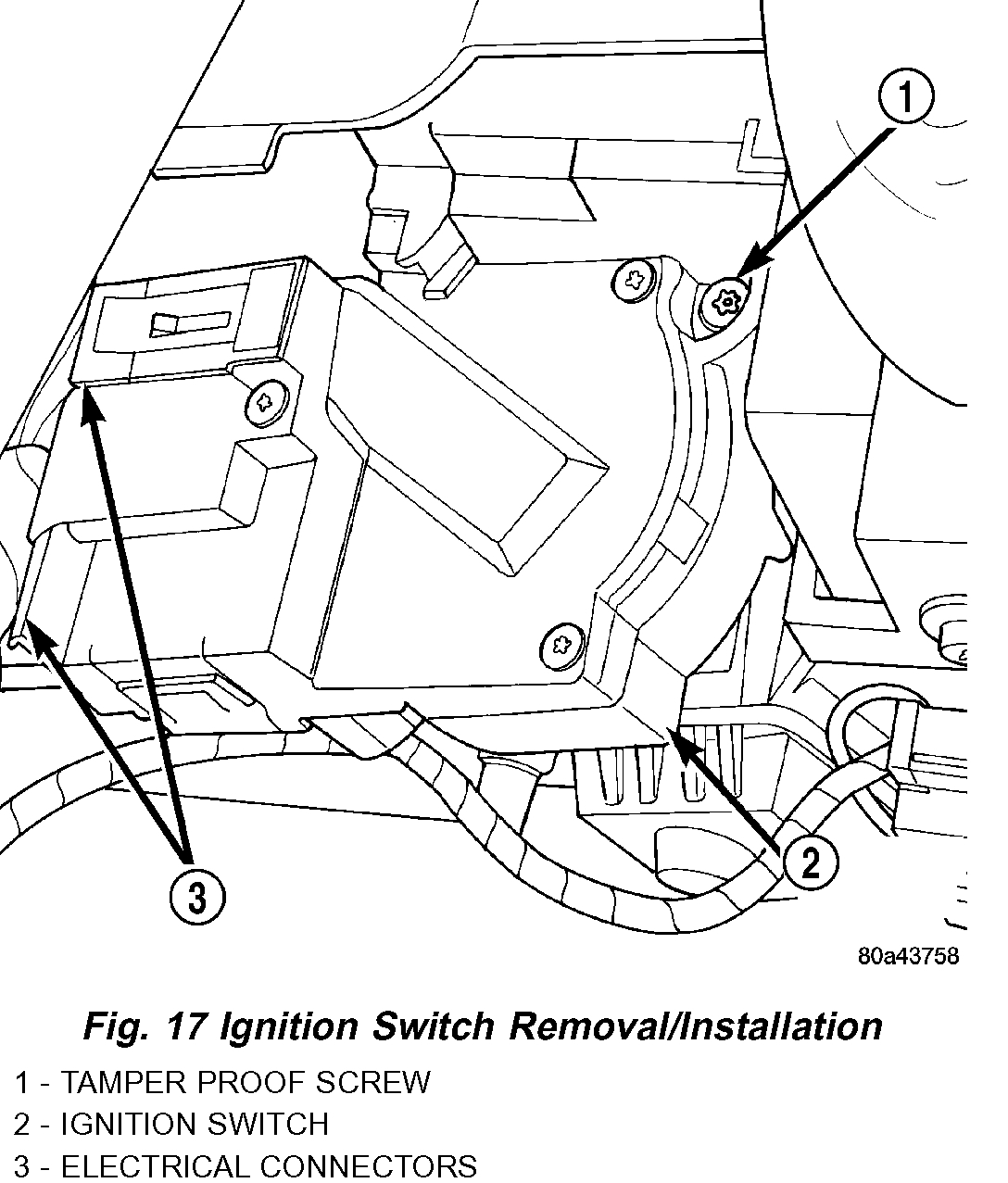

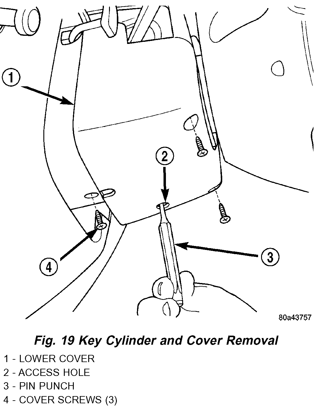

My first suspect is the switch itself is bad. Since the key still turns to the on position, it doesn't sound like the tumbler is bad.
I would remove the switch itself and see if there are any issues with it. When it is out, confirm a proper connection between the switch and the lock cylinder.
Here are the directions for removal of the switch. The attached pictures correlate with the directions.

IGNITION SWITCH REMOVAL
The ignition key must be in the key cylinder for cylinder removal. The key cylinder must be removed first before removing ignition switch.
1. Remove key cylinder. Refer to previous steps.
Pic 1
2. Remove lower steering column cover screws and remove cover.
Pic 2
3. Remove ignition switch mounting screw. Use tamper proof torx bit to remove the screw.
Pic 3
4. Using a small screwdriver, push on locking tab and remove switch from steering column.
5. Disconnect two electrical connectors at rear of ignition switch.
IGNITION SWITCH INSTALLATION
Pic 4
1. Before installing ignition switch, rotate the slot in the switch to the ON position.
2. Connect two electrical connectors to rear of ignition switch. Make sure that locking tabs are fully seated into wiring connectors.
3. Position switch to column and install tamper proof screw. Tighten screw to 3 Nm (26 inch lbs.).
4. Install steering column lower cover.
Here are the directions for lock cylinder removal which is required to remove the main switch.
2002 Jeep Truck Grand Cherokee 4WD Laredo L6-4.0L VIN S
Vehicle Starting and Charging Sensors and Switches - Starting and Charging Ignition Switch PROCEDURES
LOCK CYLINDER
REMOVAL
1. Disconnect negative battery cable at battery.
2. If equipped with an automatic transmission, place shifter in PARK position.
3. Rotate key to ON position.
Pic 5
4. A release tang is located on bottom of key cylinder.
5. Position a small screwdriver or pin punch into tang access hole on bottom of steering column lower cover.
6. Push the pin punch up while pulling key cylinder from steering column.
