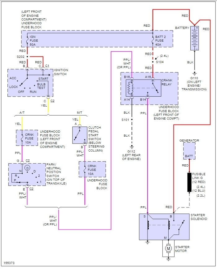

Yes I checked all the fuses inside the car and under the hood. All checked good EXCEPT (1) under hood that is a 10amp that says CRANK? Took the fuse out and there's NO power going to the slot where this fuse goes?? The switch checked good, the solenoid checked good......all but that 1 fuse checked good.the wires going to the panel under hood ALL checked good for no power to be going to that slot for the 10amp crank fuse?? Battery is charged. Tried swapping the 10amp crank fuse and the fuse showed to be good in another slot, and a good fuse didn't light up in the crank slot??
Aug 24, 2020 at 4:20 AM
  • 55,402 POSTS
Hi Amanda,
I founds this wring diagram for you it looks like the crank fuse is being fed by the ignition switch and then a 50 amp fuse, please test through the switch harness and let us know
Best, Ken

There is power on everything INSIDE the car. There is power on everything under the hood EXCEPT the 10amp crank fuse.I took fuse out and tested the slot that the fuse goes in and I have no power.I put the fuse in another slot and it lit up so the fuse is good.I took a fuse that lit up and placed it in the crank slot and I did not show power. So all fuses are good. All relays are good.All wires are good. Solenoid is good.Everything shows to have power except that 10amp crank fuse that appears to feed off the 50 amp ingnition fuse. When I try to start the car all guages are working lights come on and the anti theft does NOT blink it just goes out. I want to run something else by you but don't want to confuse you so I will ask your opinion when I hear back from you.

Doesn't look like that fuse has power unless your cranking the engine.You have a manual transmission?Also it's not Ment to start with a screwdriver that's what the pass lock system is for to keep people from starting line you were suggesting.

You can try it but the pass lock doesn't effect the starter not working.Unless your new switch is bad.It's worth a shot.See if the yellow wire coming out of the switch has power with the key in the start position.

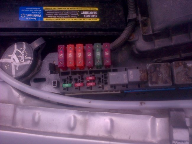

Do you have power to both sides of the crank fuse while the key is in the start position?

Are u talking about the( 2) 10amps under the hood?
  • 55,402 POSTS
Can you send pictures of what you are talking about? that would help us.
MAXIMILIAM
  • 436 POSTS
The small 10amp (the top one facing you) is the only one that will not light up! Fuse is good but no power in its slot?
/Amanda
AMANDA FUNK MARSHALL
  • 15 POSTS
I don't have power on the 10amp crank fuse under the hood in the picture.I took a wire and put it with the 2nd 10amp fuse and went to put it in with the dead 10amp and the car started!! I pulled the dead crank fuse out & just touched the wire to the slot and the car started again.. What could be going on now?

  • 55,402 POSTS
It sounds like you have a connection problem with the fuse panel itself, can you remove it and disassemble it to look for broken wires, you can also wire in a separate fuse holder and just run new wires.

The yellow wire from your ignition switch feeds power to that fuse only when the key is in the start position.You said the yellow wire coming off the ignition switch has battery voltage when the key is in the start position?if so then you have a open from the ignition switch to the fuse box somewhere.
