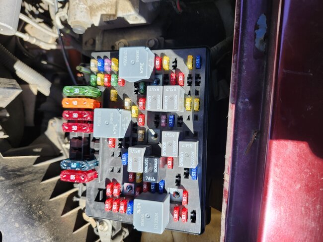

So, my truck was running okay, I did notice the past couple of days it was having a tough time starting usually starts on first turn. I should say a couple days before that I had a security link out issue, I'm not sure what happened but I couldn't get my car to start after I believed a motion detected security breach engaged disabling my car from starting. I looked up how to resolve. Reset my security still would not start. My boyfriend pulled out a battery charger and started right up I drove car for the time estimated to give a good charge and viola however I was told that putting a charger on a battery while still connected to car can create issues with the battery due to the amount of voltage it can run through the charging system. And here I am, I got up the other morning and my car was dead. I put the key in and it would not release the key I checked the shifter and it got stuck in reverse or neutral I ended up getting it into park but my lights and bells would intermittently go off as if not a good connection so a friend was going to give me a jump and I heard arching underneath the hood of my car in the fuse panel box. I do not know what to do next.

Well, it sounded like you just needed a new battery, but with the second jump it might have been connected backwards unfortunately.
Here is a video on how to jump start a car correctly:
https://youtu.be/a9Ycibu9cwY?si=AvagQR_A919Mk9gY
Here is a guide on what to do now:
https://www.2carpros.com/articles/resolving-reverse-battery-connection-in-cars-a-step-by-step-repair-guide

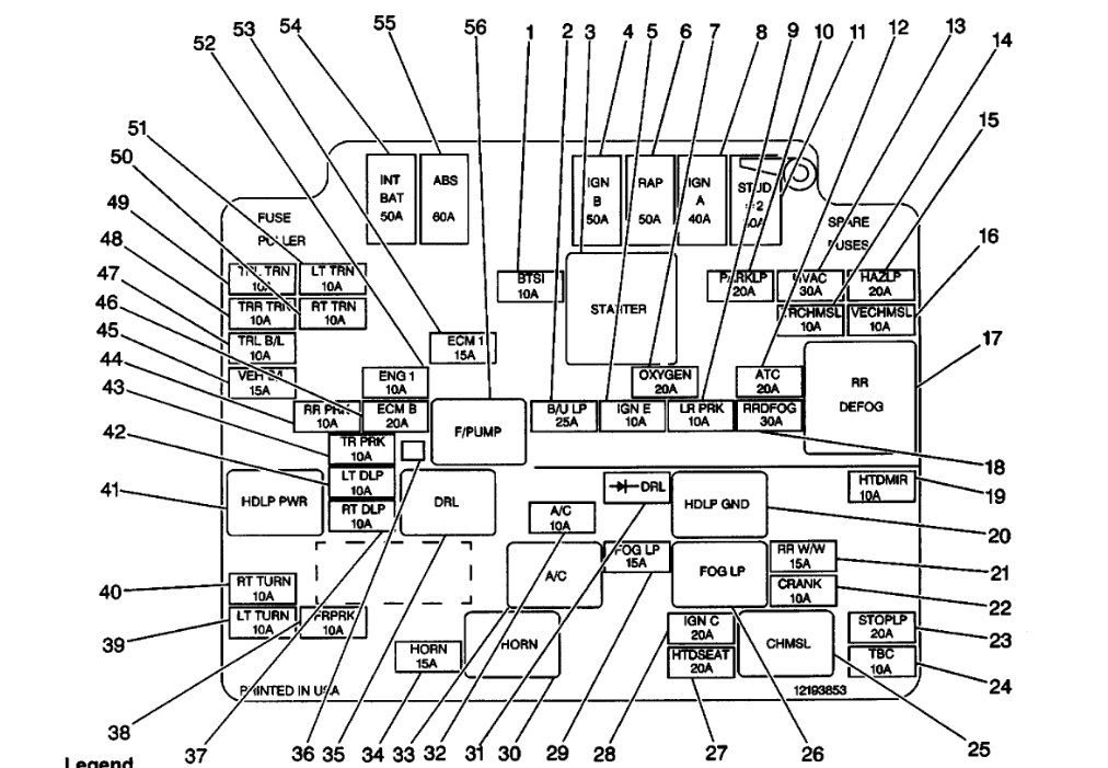

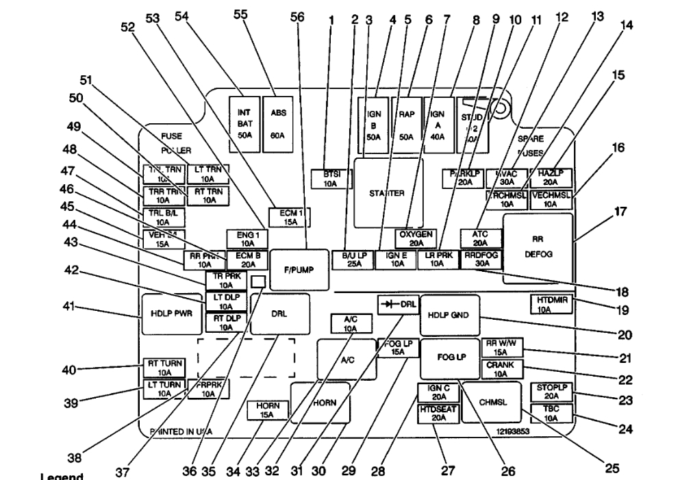

I would lift the hood and check the fuses and main fusible. here is a guide to help and the fuse location to help you fix it:
Test with the key on. Check out the images (below). Please upload pictures or videos in your response of any problems so we can see what to help you with.

This is a bit overwhelming for me. I have taken out the battery this is my fuse panel box can you tell me which ones are the main and where to start checking
Sep 20, 2024 at 4:18 AM
  • 55,447 POSTS
I would not pull the fuses out, I would use a test light which is a few bucks and amazon or the auto parts store and go over this guide, test the fuses with the key on.
Please go over this guide and get back to us.
