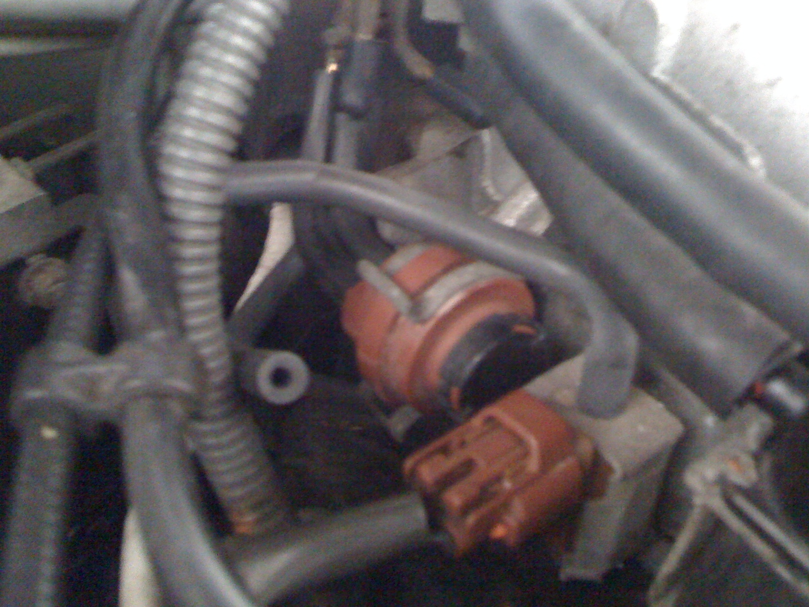

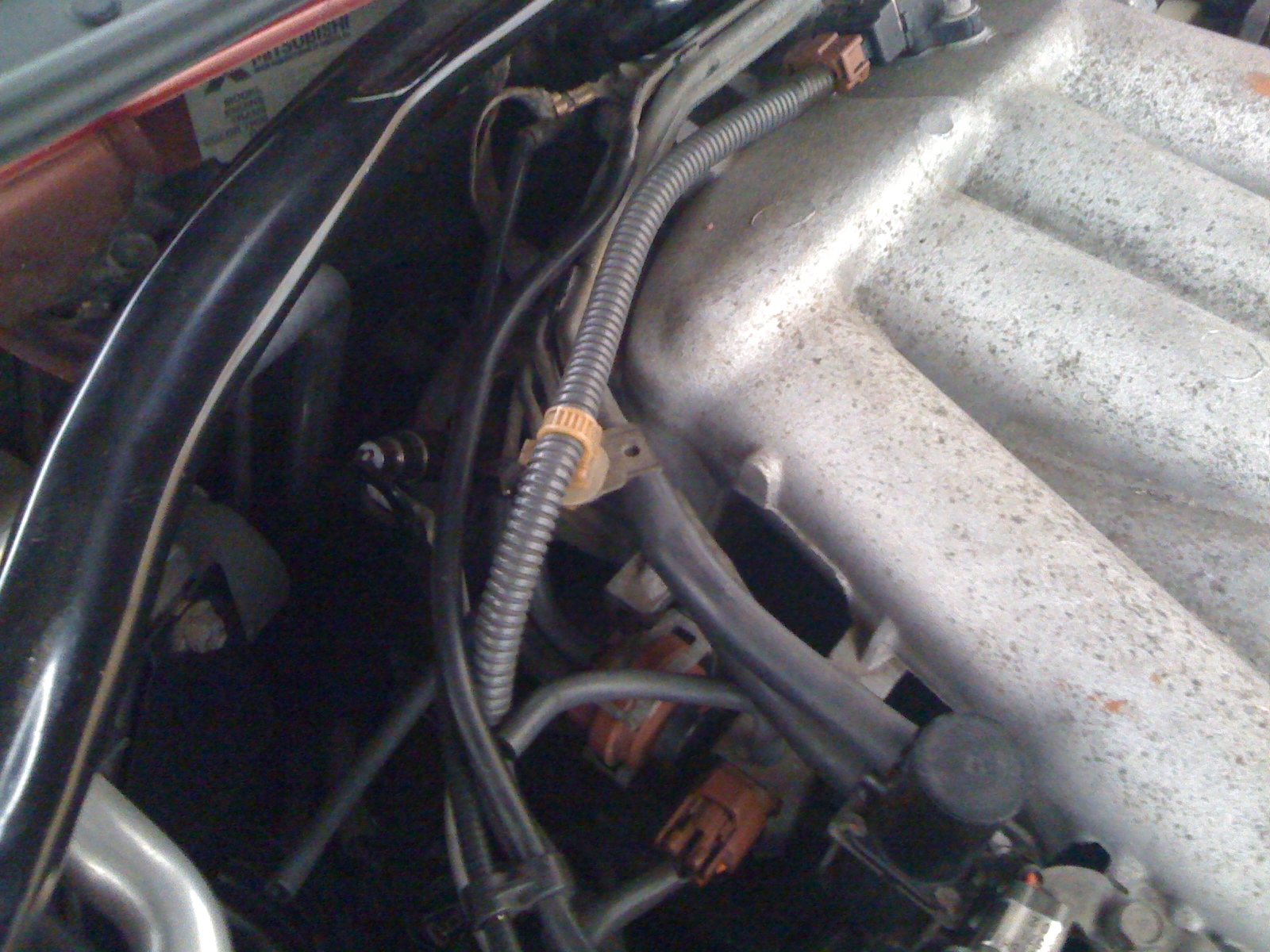

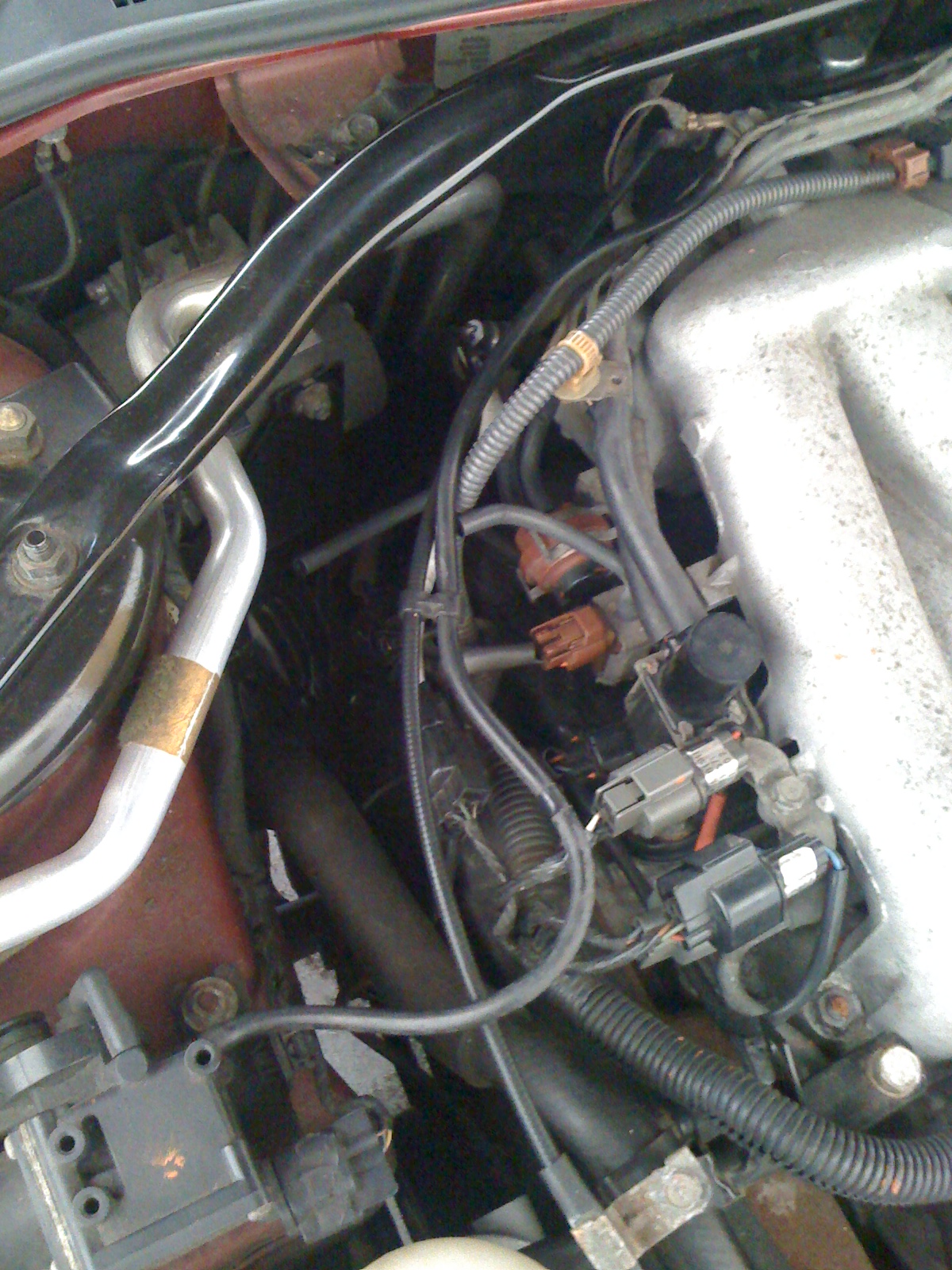

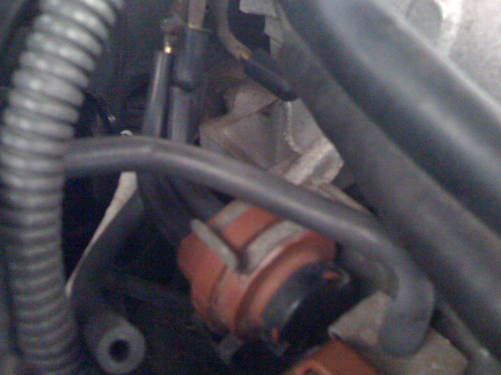

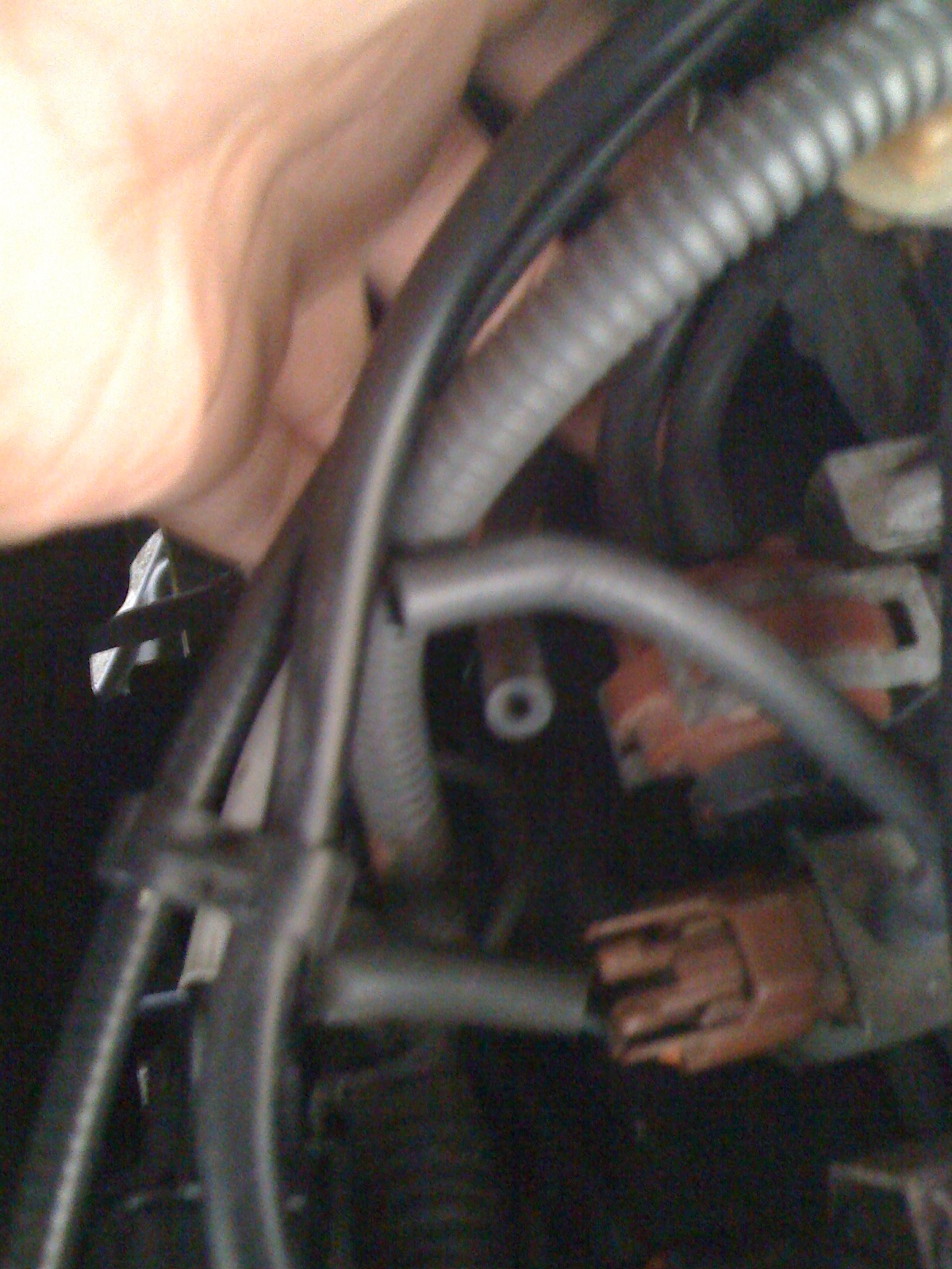

BADCAR21
After checking I see some wires cut
Aug 20, 2020 at 1:38 AM (Merged)
DOCFIXIT
  • 18,828 POSTS
And your question?
BADCAR21
where do these go and do they affect the car in the way that i described?Dodge Stratus Car hesitates
DOCFIXIT
  • 18,828 POSTS
Evaporative emission Purge solenoid has been removed does check engine light come on? have you had it checked for codes?just but car?

BADCAR21
yes have had it checked and it shows a code for random misfire
DOCFIXIT
  • 18,828 POSTS
P0300 only code? that is MOST difficult code to diagnose. With that Evap solenoid removed may effect EGR operation and cause code. Need to have diagnostic scan done to help find fault
