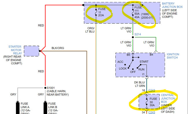

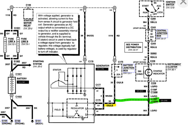

Hello, which fuse exactly do you have to keep changing? Looks like Fuse #11. The only component on that circuit seems to be the Alternator. So, either that wire has a break in the insolation somewhere or the Alternator itself has a short to ground internally. So, you can trace that wire back to the Battery Junction box where the fuse is, it's the orange/light blue wire coming from the Alternator.
You can also try unplugging the Alternator connector that has that orange/light blue wire and turn the key to the "on" position and see if the fuse still goes. If it doesn't then most likely the problem is internal to the Alternator.
Do you own a basic multimeter? If you find that the fuse still goes with the Alternator unplugged. You can check for continuity from the Alternator connector to ground with the fuse out. That will tell you if the wire is touching ground somewhere. After years of engine vibrations sometimes the wiring harness will rub through contact points. This vehicle being a 2001, it can definitely be an issue. But try unplugging the Alternator first, don't start the vehicle, just turn the key on. We would usually put an automotive fuse breaker in there to prevent having to replace the fuse while trying to find the short circuit, but those kits are pretty expensive. Let us know what you find.

Another option if you have a multimeter. It is to set the meter on the ohms setting, unplug the alternator and put one lead of the meter clipped to that orange/light blue wire and the other end, pull the blown fuse, and you should read continuity on that wire to the fuse from the Alternator. Since this isn't an open circuit, you can watch the meter and do a wiggle test of the harness and watch the meter. When you come to the short you should see the ohms reading on the meter change, that means you're close to the short.

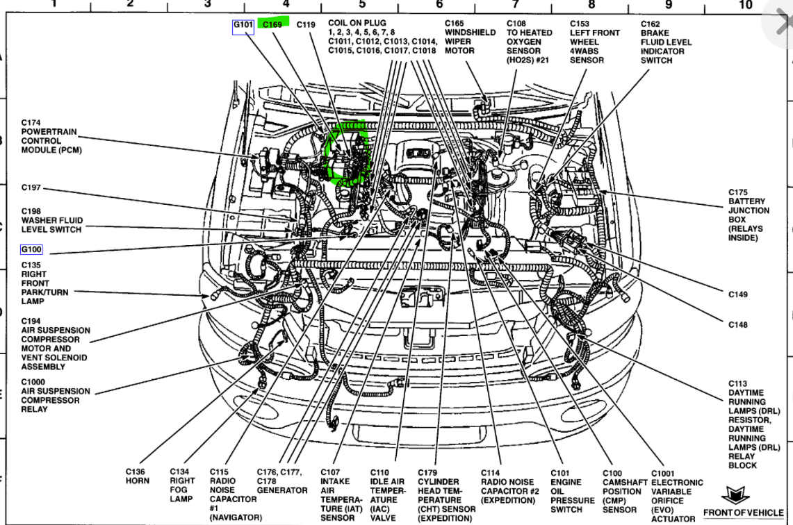

I believe the Alternator is right on top on this model.
I added 2 OEM diagrams below, there is a connector the wire runs through. 169M, its location is in the 2nd diagram. To help you get an idea of what path that wire takes to the Junction Box.
You don't need to take out the whole harness, you just need to follow that wire..
