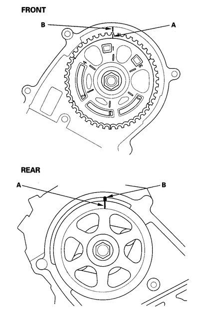

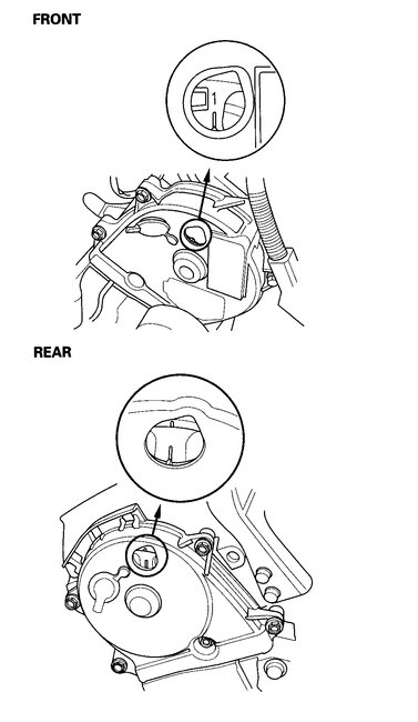

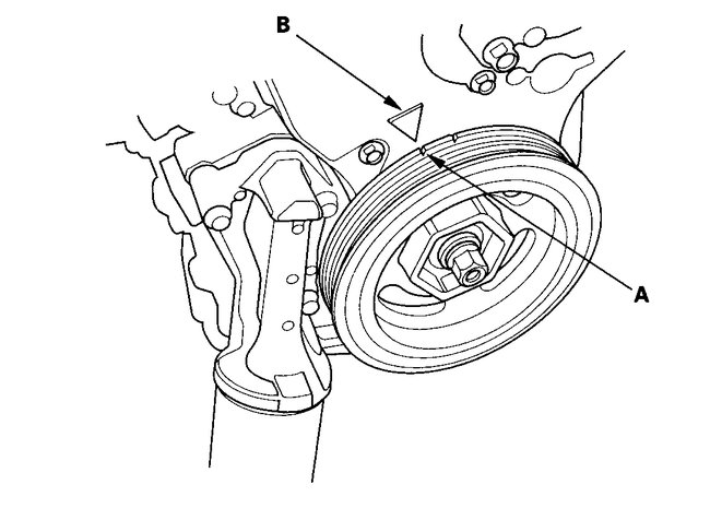

Replacing the timing belt and rear camshaft pulley is off 2 cogs with the front and crankshaft timing marks lined up. What the process to correct?

Here are the directions for replacing the belt. The attached pictures (below) correlate with the directions and include timing mark locations.

2. Set the timing belt drive pulley to top dead center (TDC) by aligning the TDC mark (A) on the tooth of the timing belt drive pulley with the pointer (B). on the oil pump.
pic 1

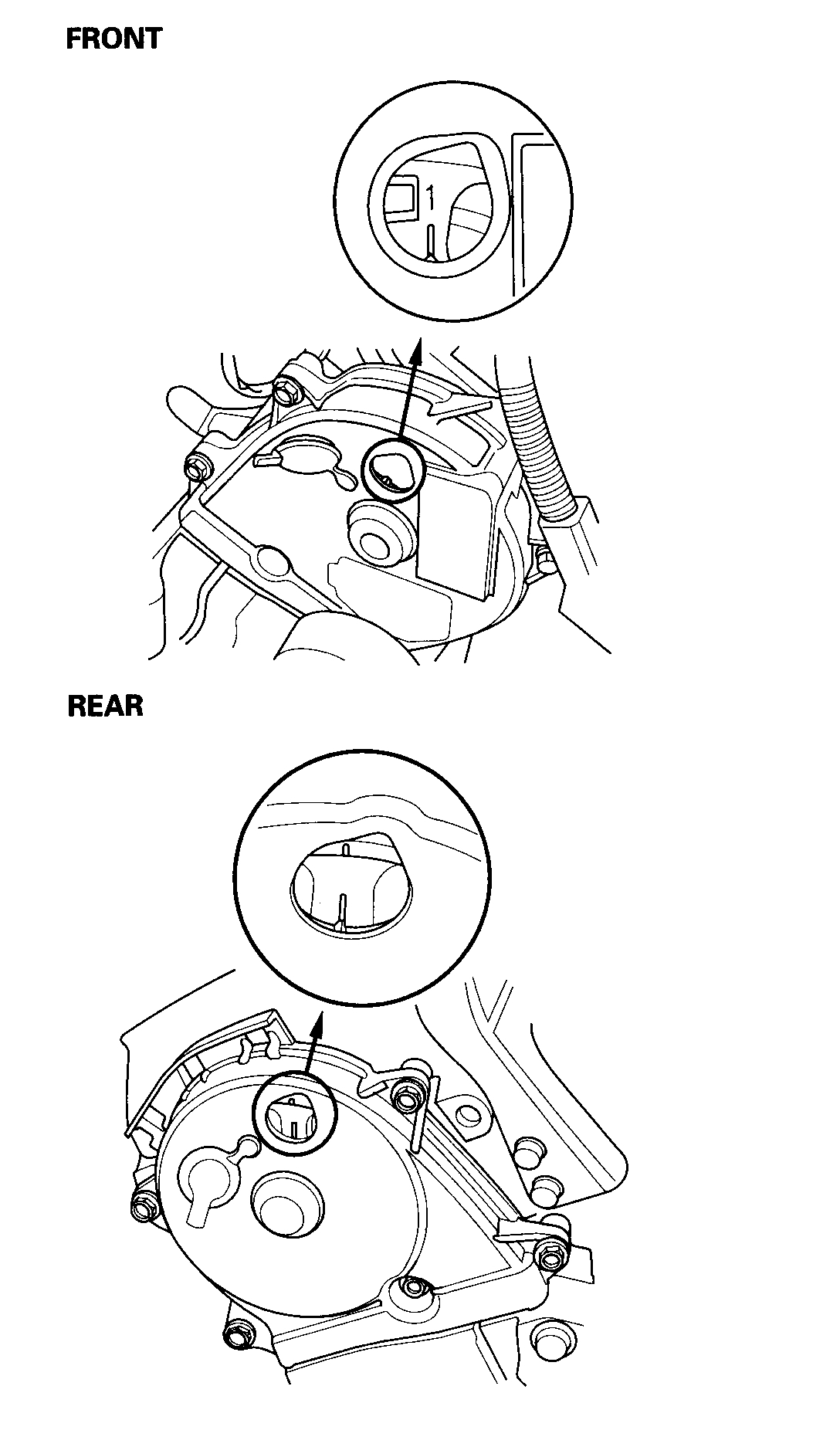

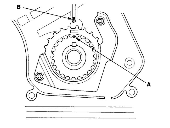

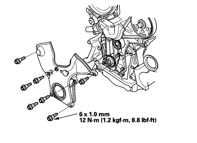

3. Set the camshaft pulleys to TDC by aligning the TDC marks (A) on the camshaft pulleys with the pointers (B) on the back covers.
pic 2

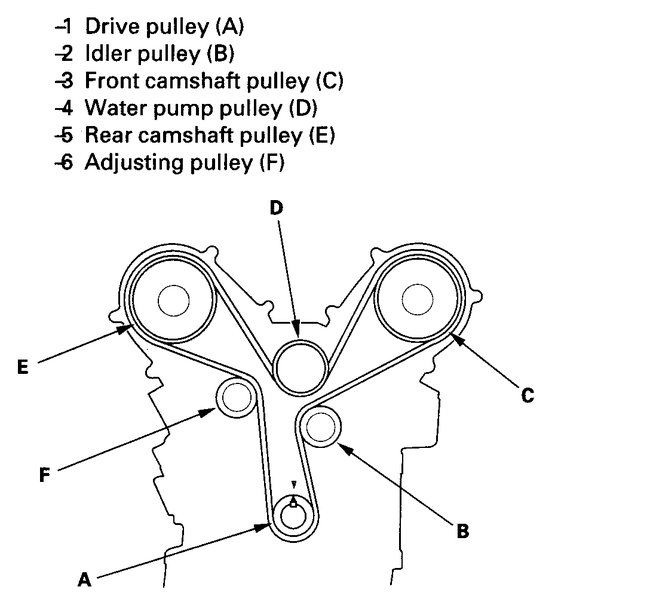

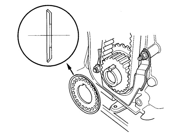

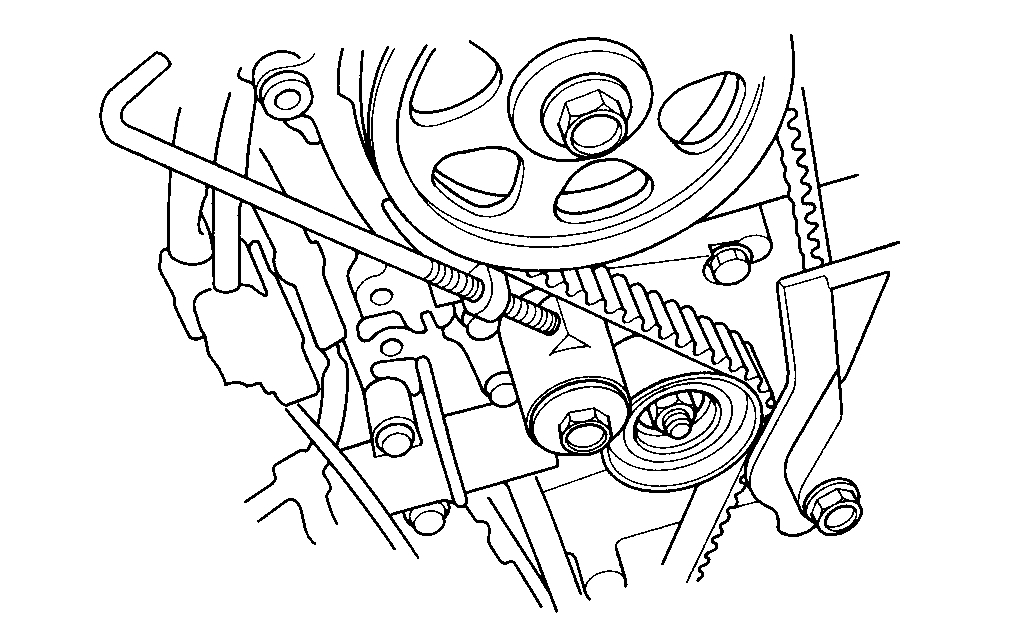

6. Install the timing belt in a counterclockwise sequence starting with the drive pulley. Take care not to damage the timing belt during installation.
pic 3

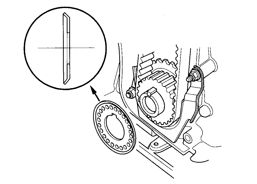

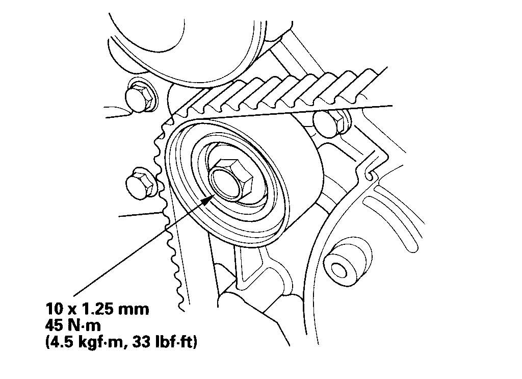

7. Tighten the idler pulley bolt.
pic 4

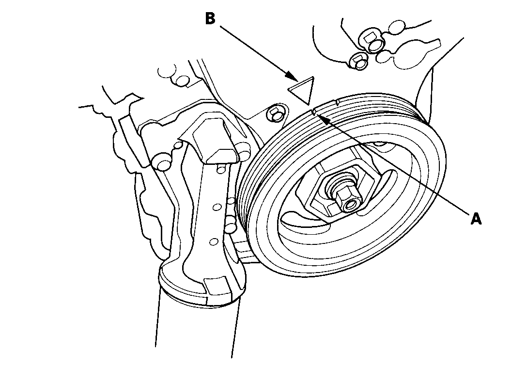

8. Remove the battery clamp bolt from the back cover.
pic 5

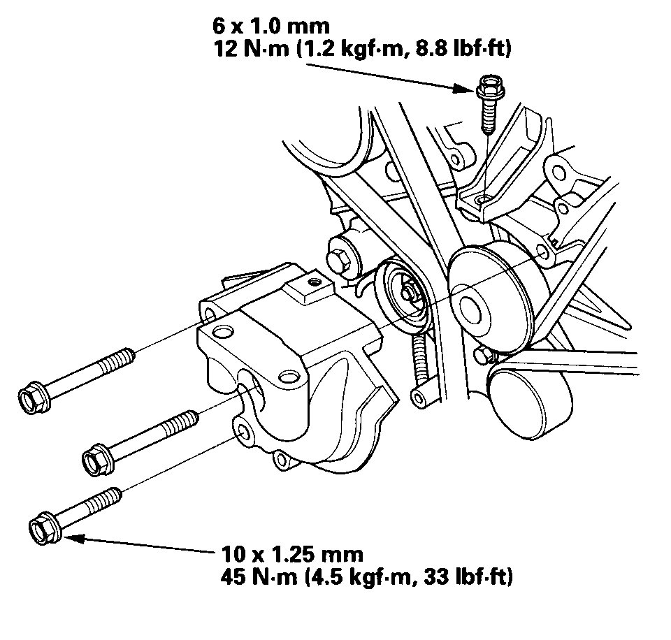

9. Install the lower half of the side engine mount bracket.
pic 6

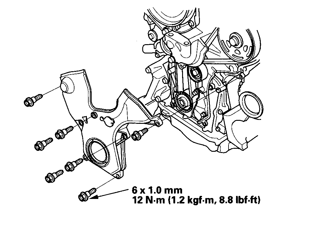

11. Install the lower cover.
pic 8

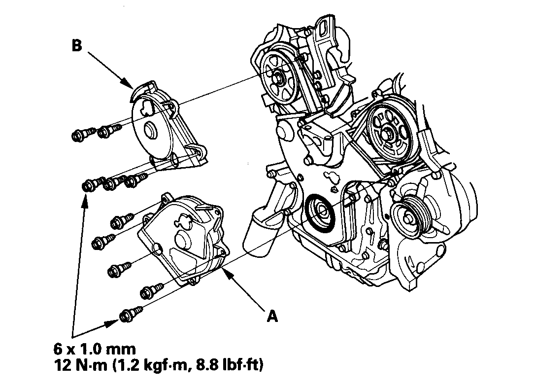

12. Install the front upper cover (A) and the rear upper cover (B).
pic 9

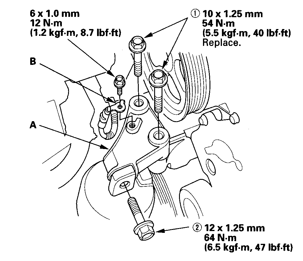

17. Install the upper half of the side engine mount bracket (A), then tighten the mounting bolts in the numbered sequence shown.
pic 12

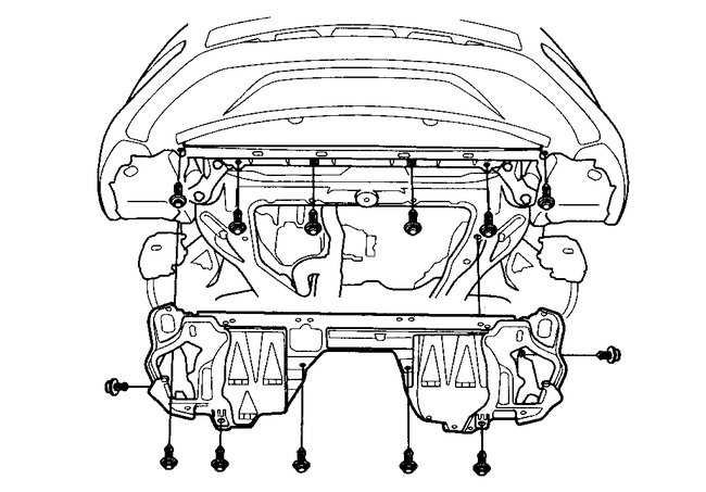

20. Install the splash shield.
pic 13

I understand the process but the rear camshaft is out of time by two cogs. Can I align it independently with the old belt off before I put on the new belt or is it a bigger issue than that?

Since it only jumped 2, chances are it is okay. However, it is an interference engine, so once the new belt is installed and timing is set, you may have to check compression to determine if there was damage.

I'm in the belief that it is also okay, but how do I correctly reset the timing on the rear camshaft that is off? can I rotate it independently backwards to align it with the other two after the old belt is off or is there another procedure to align them?

Yes, once the belt is removed, then you will be able to align the mark.

I have a 2007 Honda Accord LX 3.0 Vtec. I am in the process of changing the timing belt. Before I removed the old belt, I rotated the Crankshaft and set both cams and the crank to TDC. I removed the old belt installed the new one and was about to pull the tensioner pin. I figured I would double check everything first. To sum up now my crank is at TDC. My Front cam is at TDC but my rear cam is at approx 3 o'clock. I can not turn the rear cam far enough. I tried and it sprung to 9 o'clock (Praying I didn't bend a valve). Please help.

You didn't bend any valves unless you really forced the cam sprocket. To get the cam to top dead center, just turn the crankshaft the same way the cam sprocket is off about 1/8 turn. You only need to move the crank far enough to lower the pistons so none of them are at top dead center. That will let you place the cam sprockets in the right position, but you'll have to do something to hold them there while you bring the crank back to tdc.

Thank you for the help. I kinda figured it was going to require a bit of force but I was hesitant to do that. I also didn't know to offset the crank. I offset the crank and the rear cam was right on the verge of "triggering" off the tdc. I offset the crank as you suggested. I forced the rear cam into position. Wasn't easy but wasn't too hard either. Cool thing was I played with the crank and cam first and could actually feel when there was contact. Being a novice to mechanics this was a very good learning experience. Anyways I supported the wrench holding the rear cam into place with a book (wedged against the frame). It was all I could find that was the perfect size. I then placed a 2 x 4 across the top of the engine. My son held the 2x4 while I repositioned the crank and viola. Belts on and all marks line up. No significant force was required. I manually rotated the crank multiple times. Feel smooth and all marks kept. I am confident I'm in the clear. Got a late start yesterday. I'll button her up today test and report. Thanks again. I appreciate the help.

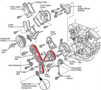

where is the timing belt located on a 2005 honda accord v6?
Jan 11, 2021 at 9:07 AM (Merged)
ZACKMAN
  • 4,202 POSTS
It is hidden inside the the timing cover. Check out the diagrams (Below). Please let us know if you need anything else to get the problem fixed.
https://images.2carpros.com/forum/automotive_pictures/55316_05accordtb_2.jpg
