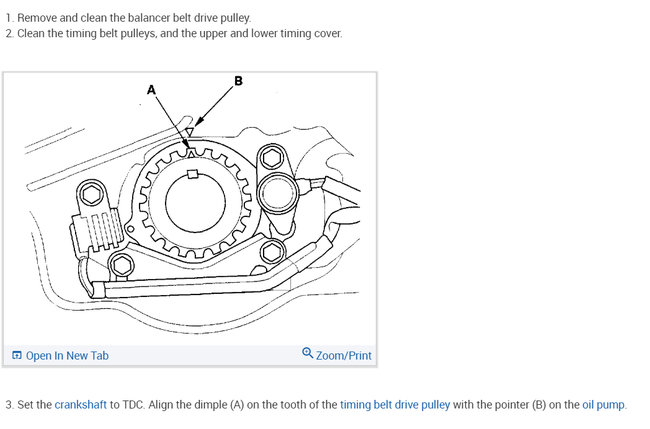

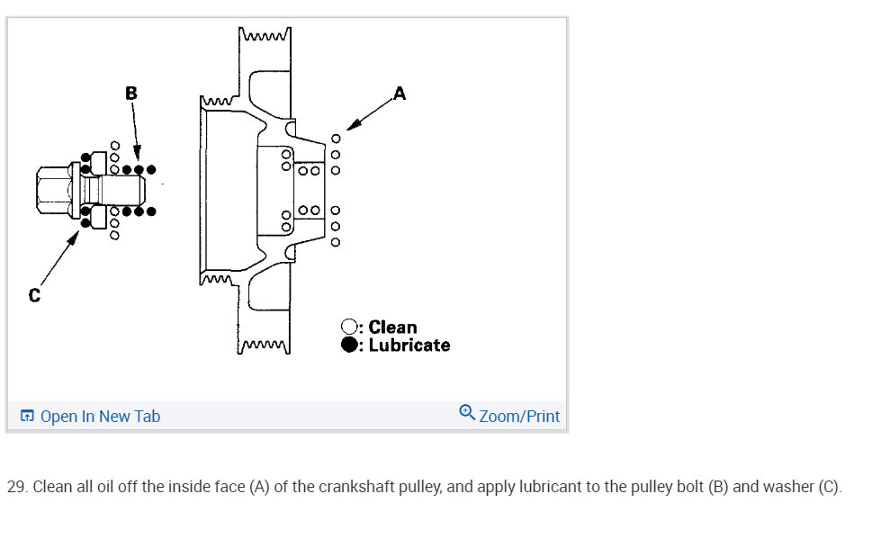

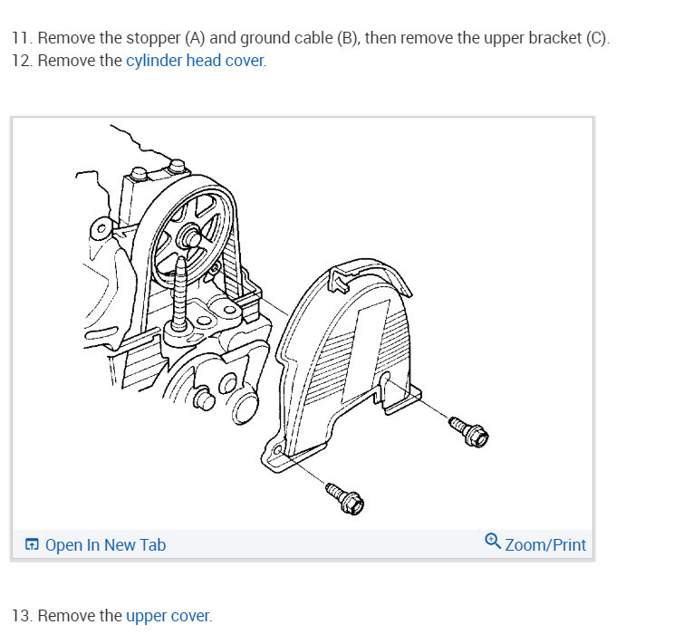

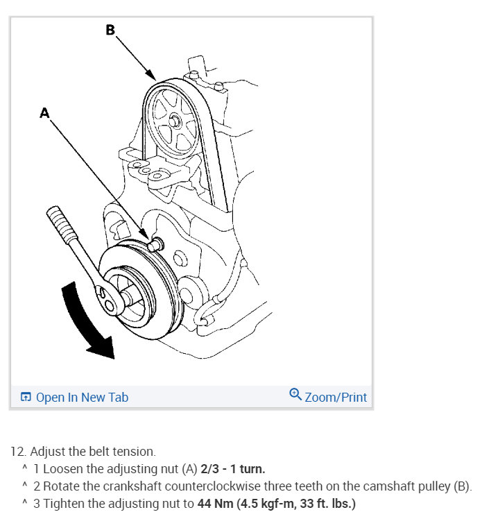

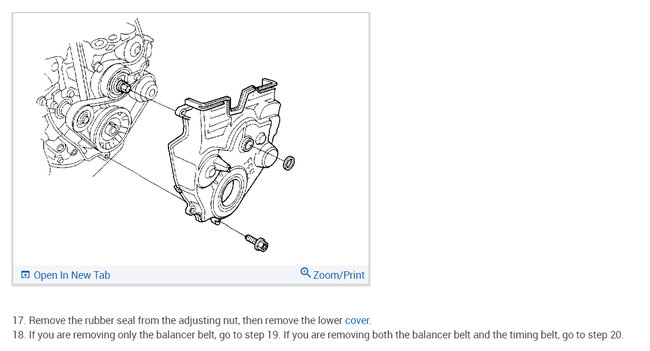

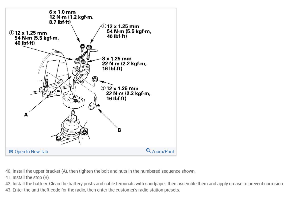

Hi Sharadendu,

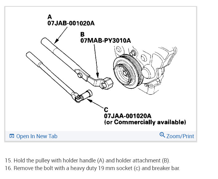

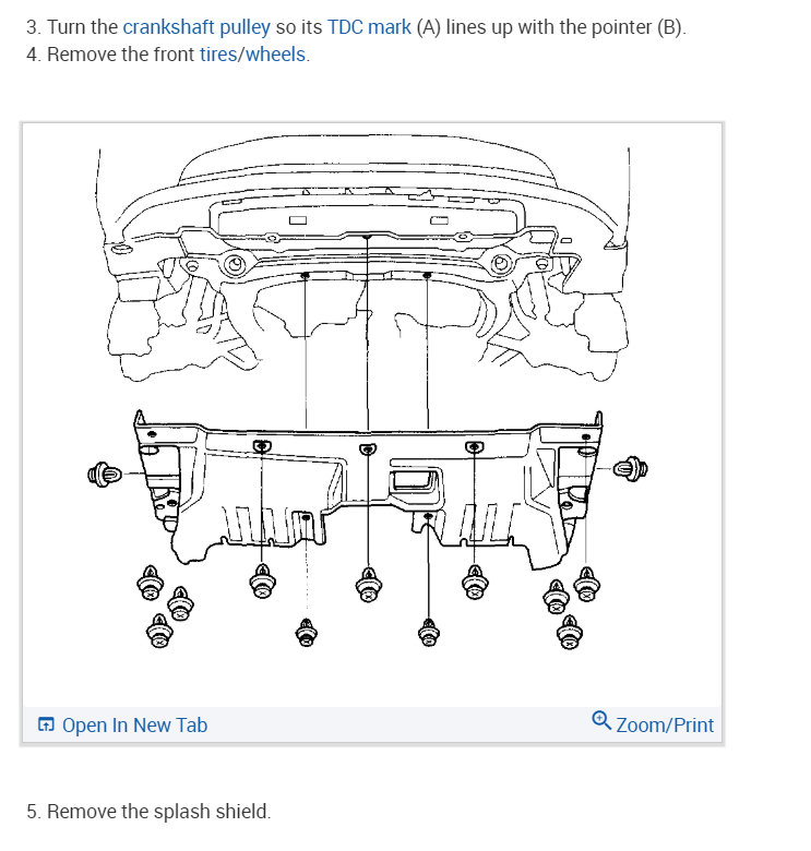

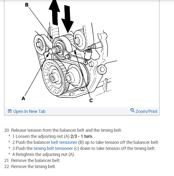

As long as it uses a timing belt, it should be replaced according to the recommended mileage. Here is a guide to help you step by step with instructions in the diagrams below to show you how on your 4 cylinder.
Here is a guide to help you step by step with instructions in the diagrams below to show you how on your car.
https://www.2carpros.com/diagrams/honda/accord/2000

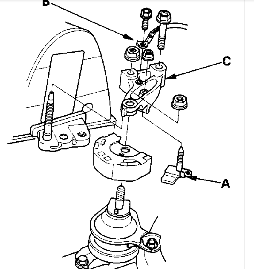

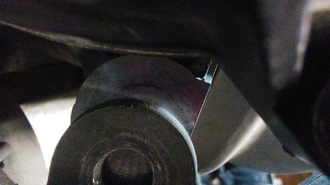

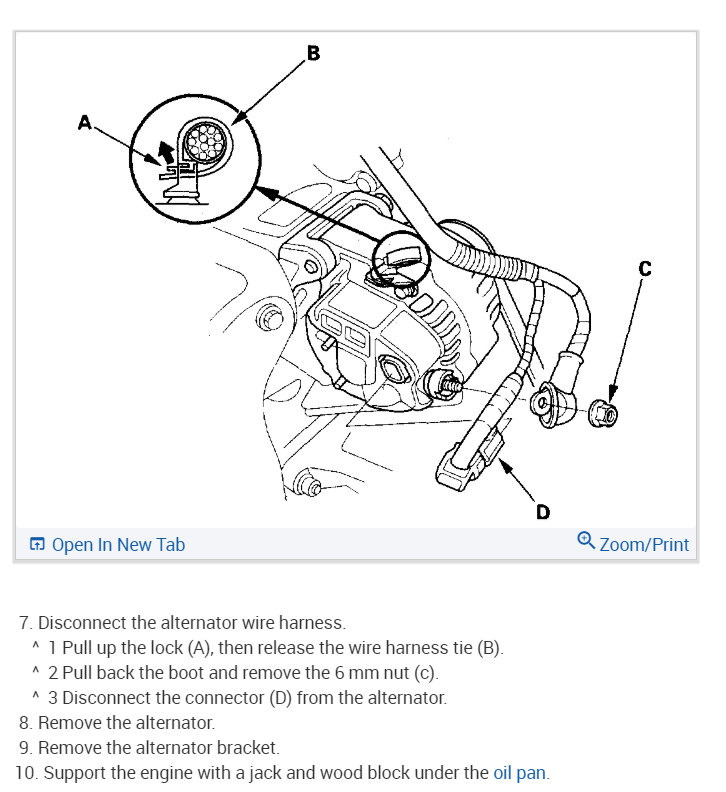

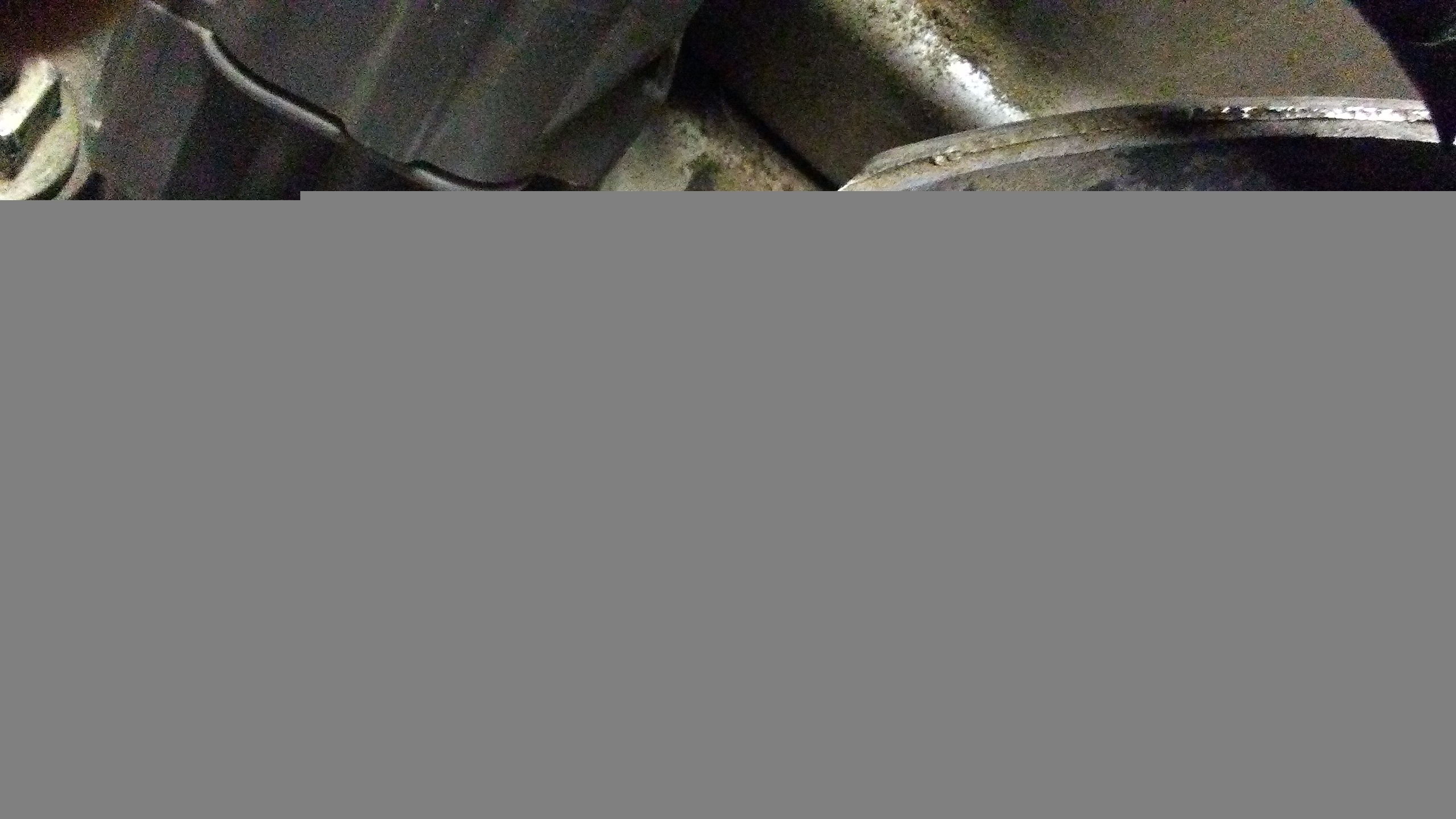

UASUNBUNNY
  • 9 POSTS
Fully stock components
Repair:
Timing belt replacement (first timer).
noticed no free movement of idler pulley? (Slick pulley located up and right of crankshaft)
Figured maybe with belt tension it couldn't be moved by hand.
Completed job
Upon start:
Loud growling from under timing belt covers.
Upon inspection and removal of covers that the engine alignment is now off.
Question: how do I correct the alignment of the engine? Any idea on cause of sound?

SATURNTECH9
  • 30,869 POSTS
So the timing belt idler pulley was not turning with the belt tension on it? I would say that would be normal. Are you sure the cover was not rubbing? Also what exactly did you replace?
Jan 11, 2021 at 8:42 AM (Merged)
UASUNBUNNY
  • 9 POSTS
Thank you for the quick reply. My first thought was that the idler pulley has seized and there was too much tension on the belt making the sound. My next thought was that the timing belt is not pushed back quite enough and it is rubbing on the cover. Should I check anything else visually?
Any thoughts on the motor misalignment? I did loosen the passenger side motor mount and tried moving the motor with come along straps but I had no luck.
Is there a way to donate money for your assistance?
Thanks again.

SATURNTECH9
  • 30,869 POSTS
That should have a automatic hydraulic tensor correct? Also when I replace the belt I only remove the top engine mount and never have any engine mount alignment issues. You never said the exact parts you replaced? I will find out how you can donate they were supposed to add a donation link on the questions.

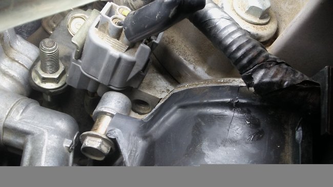

UASUNBUNNY
  • 9 POSTS
Parts replaced: water pump, idler pulley, guide pulley (?), auto tensioner. Yes only the top mount but I am nervous about this misalignment around the alternator in this picture:
SATURNTECH9
  • 30,869 POSTS
I cannot see the whole picture it is not coming up. You did not remove the old alternator did you? I never remove the alternator.
UASUNBUNNY
  • 9 POSTS
Sorry. And no I did not touch it.

UASUNBUNNY
  • 9 POSTS
And this one.

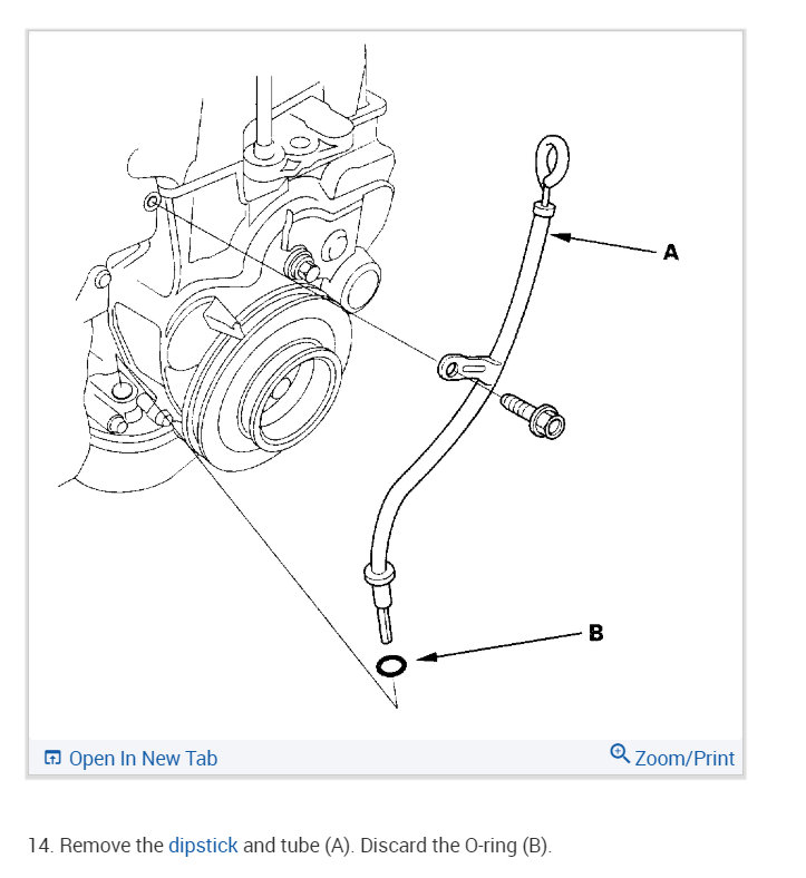

SATURNTECH9
  • 30,869 POSTS
It is hard to tell from the pictures. Did you put floor jack under the engine to support the engine?

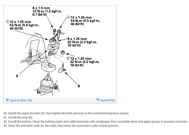

UASUNBUNNY
  • 9 POSTS
Yes with a piece of wood in between. I am afraid maybe I did not support it enough/correctly. I am used to my BMW's weak aluminum pan so I was a little hesitant. Can I fix that issue?
SATURNTECH9
  • 30,869 POSTS
Without seeing more it really makes no sense to me that it wont line up from just removing that upper mount. I have done it that way on the Honda's v6 and 4 cylinder and never had a issue.What exactly is not lining up?

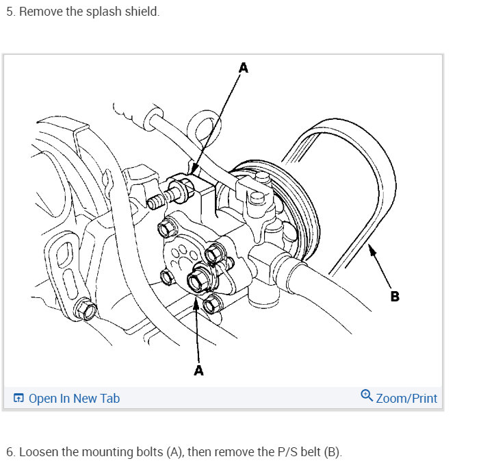

MILOGALT
Got my timing belt, serpentine belts, and two engine mounts replaced at a local repair shop (was charged 650) yesterday...
Immediately after I took the car, it started making noises while steering (and I think the steering wheel vibrates with the sound, and the noise is louder when the vehicle is going slower/starting up)...the noise isn't always loud, but its worryingly loud many times, and constantly, there is a noise...
When I went back to the guy who made the repairs, he confirms the "steering wheel pump" is broken, and that it has nothing to do with the repairs (of course!)...he says he will change the pump for the cost of the part only (no labor)...
Jan 11, 2021 at 9:15 AM (Merged)
2CARPRO JACK
  • 11,533 POSTS
According to Mitchell, all they removed was the belt to replace the timing belt.If it didnt make the noise before hand you can try to get him to cover the entire cost, bu the probably wont.What does the noise sound like? is it a schreeching noise? check the belt tension to be sure it is ok first and that it isnt low on fluid
MILOGALT
Thanks for the response, Jack!
The power steering pump fluid is full...
By "belt tension", which belt is being referred to?
Also, how much would the pump cost (just the part, without labor costs)?
The noise is coming from inside the pump (I put my ear to a screwdriver touching the pump, and could hear the vibration noise when a friend moved the steering wheel), its an annoying buzz of sorts, with vibration on the steering wheel...the noise is distinctly louder when I turn the wheel/car, but I would like to think there is a humming vibration on the steering wheel even when I am driving straight...
I Do know only the timing belt was changed, and not the water pump or the cam/crankshaft seals...he showed me the vehicle when he had "opened it up", and he clearly showed/said that the pump and the seals were very dry and very good, and that there was no need to have them changed (which is against convention, I guess, but I am not sure the convention is all that correct, since its only the timing belt Honda recommends for a change, and not the water pump or seals, also the charges tend to mount for a "timing belt package deal", which does not go lower than 600 anywhere for a V6 2000 Accord)...
In addition, the serpentine belts were changed, and I can see that the engine mounts have been replaced too, though I dont know if that could cause the problem...
2CARPRO JACK
  • 11,533 POSTS
The belt tension on the pump. If th enoise is coming directly from the pump, it may be bad.Looks like that pump is almost $400.00, the labor guide only pays .9 to replace it (just under 1 hour)

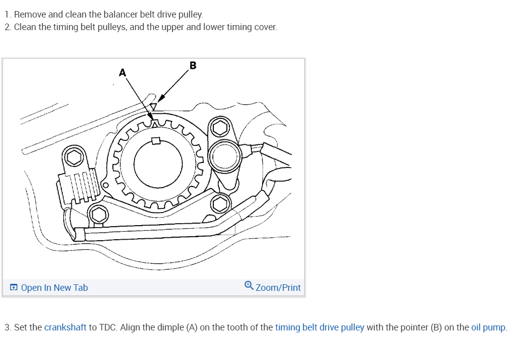

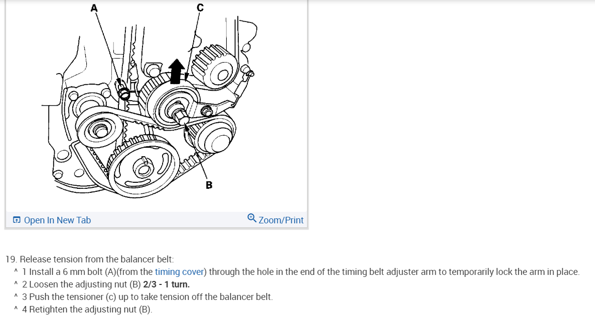

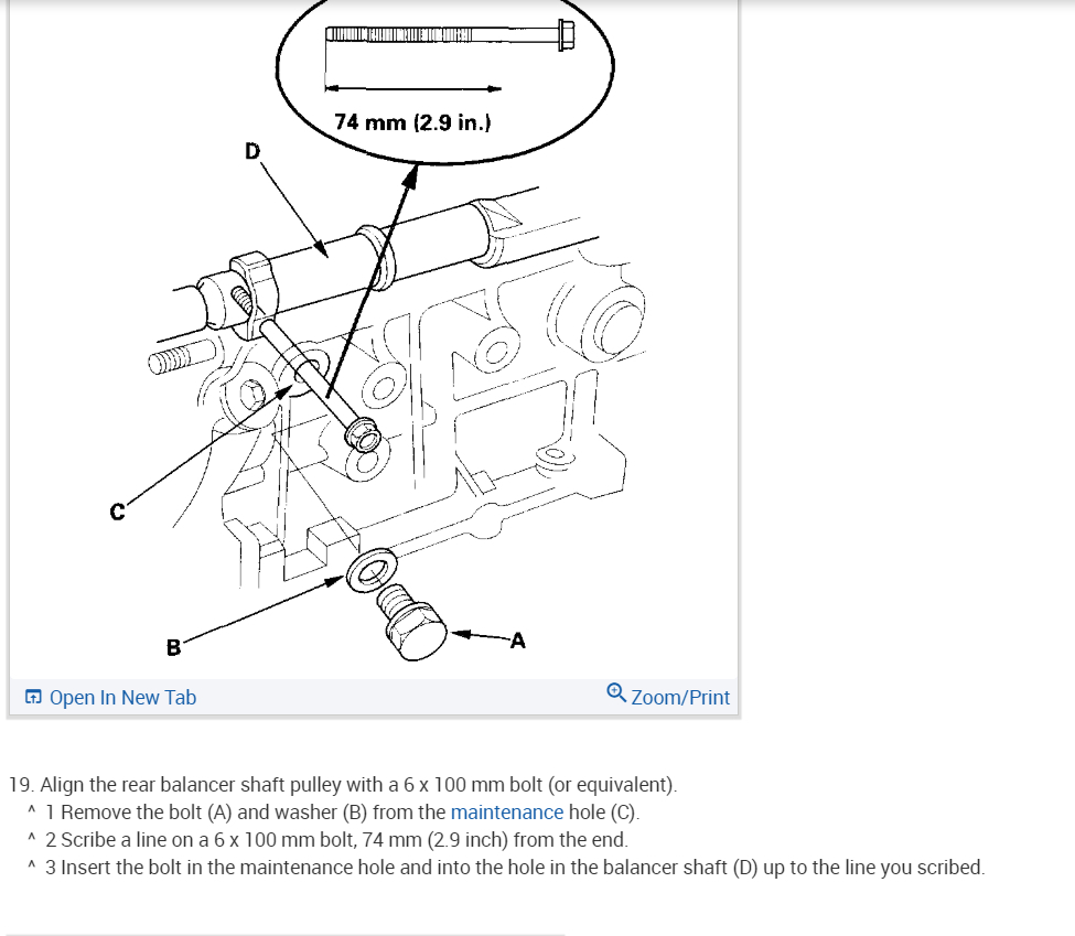

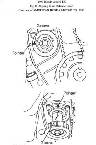

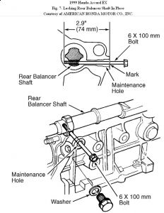

FINALLYFREE09

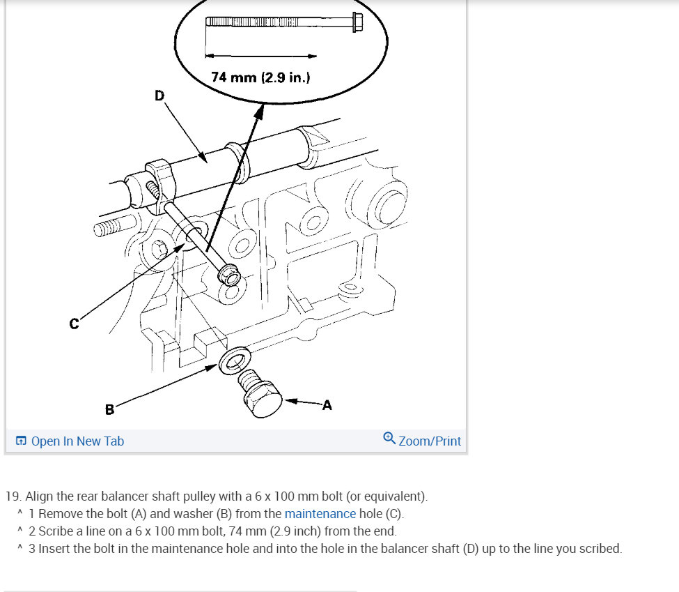

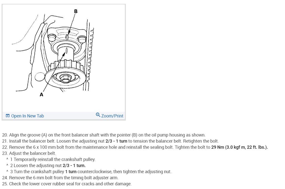

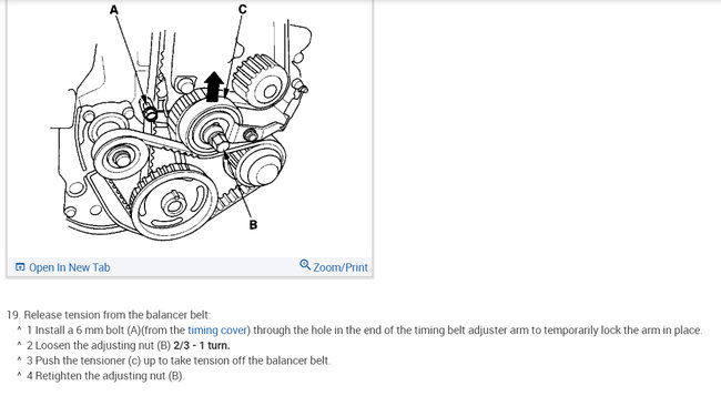

how do i set my balance shaft so the motor will stop vibrating
Jan 11, 2021 at 9:16 AM (Merged)
KHLOW2008
  • 41,812 POSTS
Hi finallyfree09, The diagram shows the markings. The first diagram show where a bolt should be removed to insert a bolt for holding the balancer shaft.
https://images.2carpros.com/forum/automotive_pictures/192750_TimingBelt99AccordFig07_1.jpg
https://images.2carpros.com/forum/automotive_pictures/192750_TimingBelt99AccordFig08_1.jpg

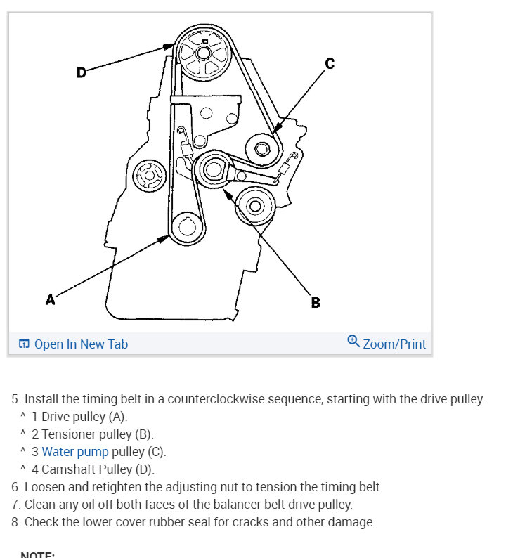

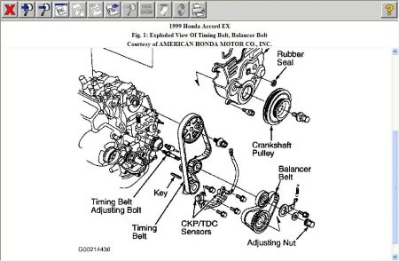

INDY49
Interior problem
1999 Honda Accord 4 cyl Two Wheel Drive Automatic 103k miles
I'm planning to get the Timing Belt and Water Pump replaced on my 1999 Accord, 4cyl/4Dr, EX. It has 103k miles on it.
I will probably buy Genuine Honda parts online and get them replaced by a local mechanic. Just to save a few hundred dollars :).
My question is .. what parts should/need to be replaced along with Timing belt and Water pump? For ex, any other belts, seals, tensioner etc?
Can you please provide a recommended list?
thanks
Jan 11, 2021 at 9:17 AM (Merged)
KHLOW2008
  • 41,812 POSTS
Hi indy49, List of things I would recommend. 1. Timing belt and tensioner bearing. 2. Balancer belt and tensioner bearing. 3. Water pump. 4. Camshaft oil seal 5. Front Balancer shaft oil seal 6. Crankshaft oil seal 7. Rear Balancer oil seal and O ring. 8. Alternator/AC belt 9. Power steering belt 10. Valve cover gasket, bushes and plug seals.
https://images.2carpros.com/forum/automotive_pictures/192750_TimingBelt99Accord_1.jpg

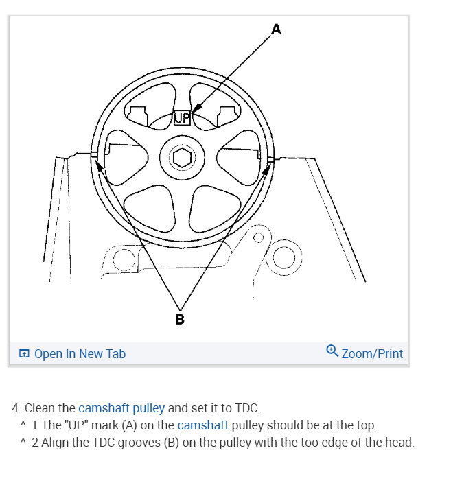

JAYROLX3
Engine Mechanical problem
1998 Honda Accord 4 cyl Front Wheel Drive Manual
timing belt broke. now forsure camshaft and crankshaft is not at TDC/aligned. What step do I need to take in order to have camshaft and crankshaft at TDC together before installing the belt. how do I get the cam and crank to aligned just if the belt was never broken.
KHLOW2008
  • 41,812 POSTS
Hi jayrolx3,
If the timing belt did not break but the belt has skipped a few tooth, that could mean bad news. The valves would most probably be damaged.
Before turning anything, get the valve cover, crankpulley and timing belt cover off first.
To turn and align crankshaft, being a manual trans, it is rather easy. Jack up the driver side front wheel, engage 4th gear and turning the front wheel would allow you the turn the crankshaft.
Turn the crankshaft at least 30 degrees away from TDC before attempting to turn the camshaft, which can be done by turning the cam sprocket. Removing the spark plugs would make turning easier.
Before proceeding with anything else, check the valve clearances. If any clearances are excessive, the valve is bent.
After aligning the cam shaft, turn crankshaft to TDC and disengage the gear. This is to prevent accidental turning of the crankshaft.
