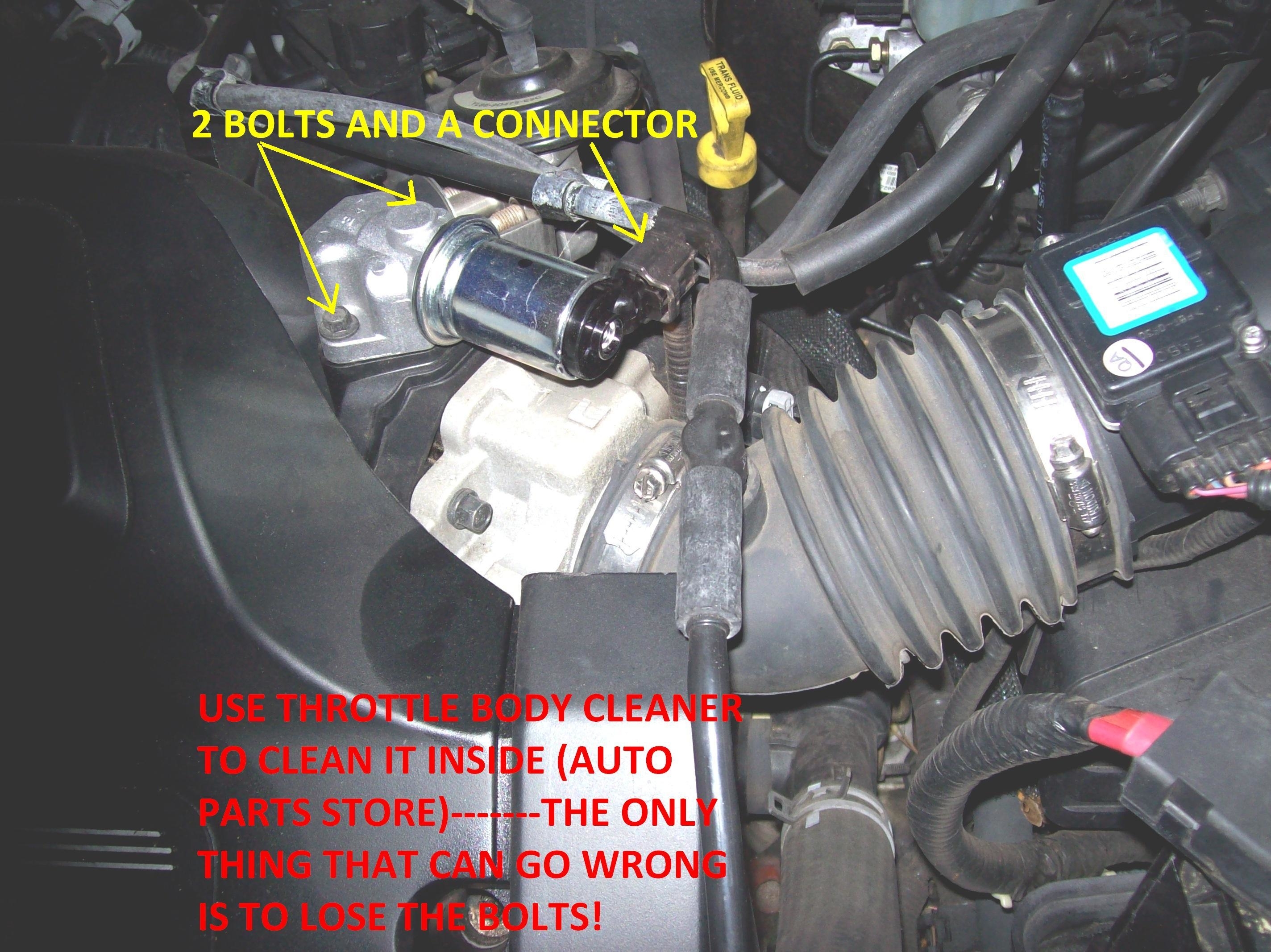

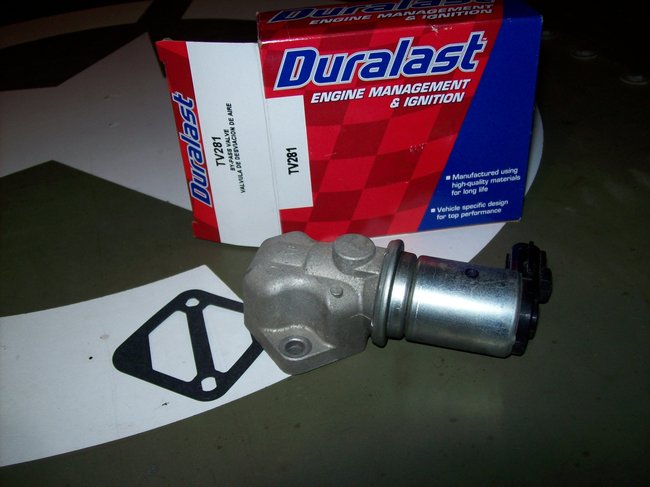

Cleaning this will cost you less than $10.00 to try. Replacement will be more.
Here, is what controls idle (idle air control-IAC)....it has a plunger in it that constantly moves, allowing itsy-bitsy amounts of air to bypass the closed throttle valve to mix with the fuel from the injectors
This was my experience with the wifey's '03 Ford Escape w/3.0L.
Our Escape would idle low, then it got to point it would die when you stopped.
Revving + holding brake was only way to keep it running.
No warning or service lights came on.
Sometimes while it is running and acting up, you can give the IAC a little "love tap" with a wrench or screwdriver. This is not a fix, just a test! If you notice a difference in the RPMs and it runs better, you may be more confident that you are probably dealing with the correct problem part! This "test" sometimes has no effect.
I took the IAC off and cleaned it, it seemed fine, but just because the engine had over 100,000 miles on it, I went ahead and replaced it (preventative maintenance). I figured it had been moving and wearing for a long time.
This was the wife's rig, so that was the big factor!----I take no chances---she'll whoop my butt!
this is a very simple thing to clean or replace.......no need to take it to the stealership!
The only difficult thing about it is not to drop the 2 screws you removed to take it off!
We're gonna use "throttle body cleaner" (from an auto parts store) and clean the IAC and the hole it came out of.
Here's a couple of guides from our "Repair Guides", top right of our pages.
https://www.2carpros.com/articles/how-to-replace-an-idle-speed-control-motor-iac
another
https://www.2carpros.com/articles/idle-air-control-valve-service
Keep us posted as you progress.
The Medic

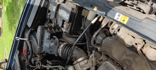

These pics are of the wife's Ford Escape and IAC.

LETICIARAMOS2890
  • 58 POSTS
Thank you will get someone to check that out for me. Will let you know if that was the fix. Again thanks.

LETICIARAMOS2890
  • 58 POSTS
Had someone clean the IAC yesterday as CJ MEDEVAC suggested and that has helped,not feeling any jerking. Not sure if this is going to be a temporary fix or just going to replace. But definitely looking into getting oil changed and tune up. I will keep you all updated and thanks for your responses on this matter.

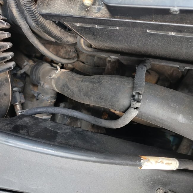

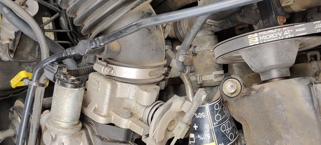

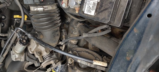

LETICIARAMOS2890
  • 58 POSTS
Can anyone tell me what the small hose is and what it's suppose to be connected to? Thank you.
May 21, 2020 at 2:53 AM
  • 55,333 POSTS
Can you please take more pictures and upload them so we can so where the hose is coming from and where it might go? we need to see more.
May 23, 2020 at 3:01 AM
LETICIARAMOS2890
  • 58 POSTS
Is this better?
May 25, 2020 at 3:55 AM
  • 55,333 POSTS

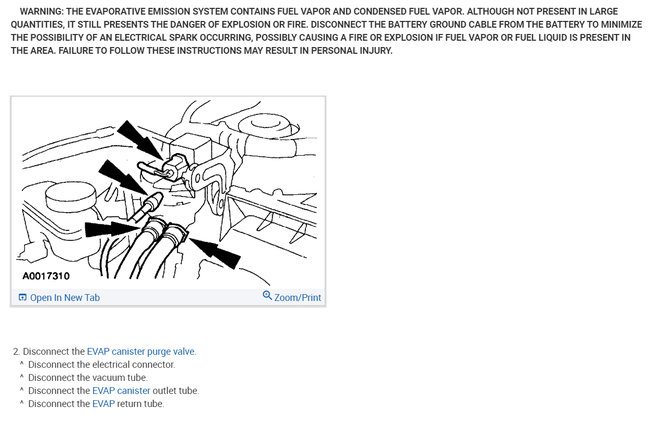

Okay, it looks like it goes to the EVAP purge solenoid. diagrams below to replace the hose it looks bad. Check out the diagrams (below). Please let us know what happens.
