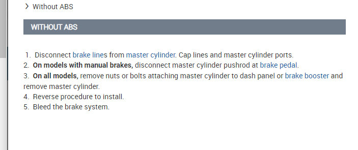

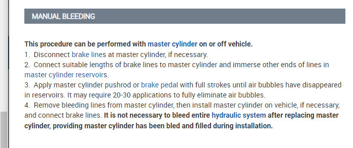

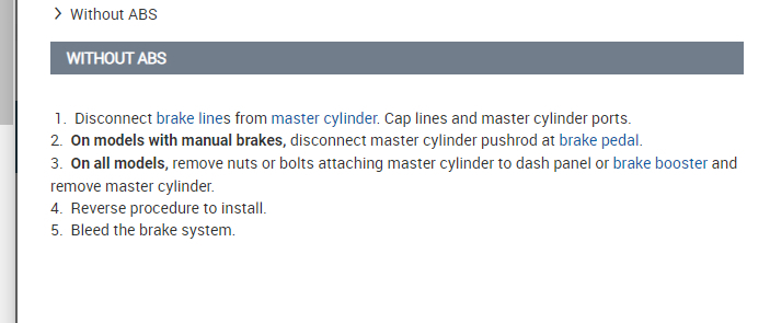

I am attaching the process from the manual that will help with this, but you need to make sure you have bled the master before installing it.
Please run through this and let us know what you find. Thanks
