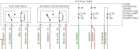

I drained the fuel tank out of fear someone had put something in the tank because we saw someone in the middle of the night out by it. This is a new car for us so I immediately drained the tank just in case. Jeep ran perfect before this. I jumped relay with a wire to drain the tank. Luckily nothing was in the fuel. I reconnected the relay put a quarter of a tank of new fuel in just in case & now it will not start & service engine light is on. I have tried another relay per a mech at the dodge dealership to check to see if the fuel would pump it does not. If I reconnect just the jumper wire it pumps fuel. But with relay in it does not. Please help.

Hello !
Have you check the fuses?
How do you "jump" the relay to start the pump?
Did you "touch" the coil connectors on the relay base?
Could be a bad efi fuse. Or a powertrain control Module fuse.
Check those and let us know on your findings!
Good luck!

Hello !!
Thanks for your Pm
Here you have the wiring schematics:
https://www.2carpros.com/forum/automotive_pictures/576_98_wrangler_1.jpg
https://www.2carpros.com/forum/automotive_pictures/576_98_wrangler1_1.jpg
Like I told you I really hope that the problem its just a blown fuse..
Let us Know on your findings!
