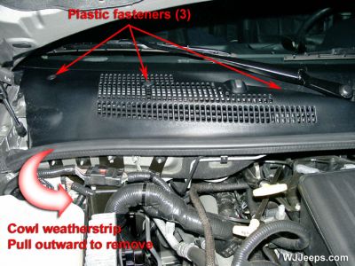

Hello, I have a 2000 Jeep Grand Cherokee Limited and it has Dual temperature. I live in Miami and it boils down here. The problem is that when I place my A.C. on High or any fan speed and temperature, only 1 vent produces decent air, the rest of the vents are very, very faint barely any air. I've taken it to the dealer in the past and they simply told me that its just the way it is with this car. I don't believe them, I need my a.c. work properly. My heater does not work either, I don't need it but I thought I'd mention it to see if that has any effect. My goal is for all of the fan vents to produce strong wind, not just one vent. Please help!

Have you looked to see if your jeep has a cabin air filter? If it does have one it may be pluged.

I don't know, how can I check. Do I have to remove the dashboard for that?

If your Jeep has one it will be under the plastic cowl. Here is a pic of the location if equiped and what it looks like from the front and back. Hope this helps let me know what you find.
https://images.2carpros.com/forum/automotive_pictures/249564_cabinair7_1.jpg
https://images.2carpros.com/forum/automotive_pictures/249564_cabinair8s_1.jpg
