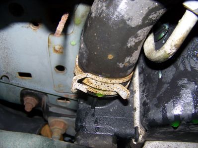

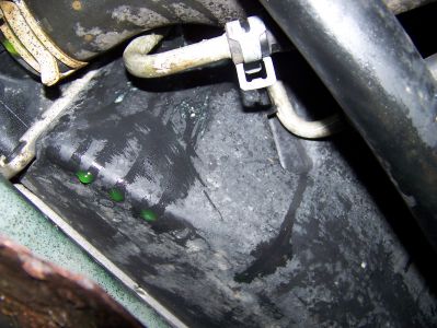

To racefan966, thanks for your detailed answer. I drained the system using the drain. I disconnected the upper two bolts for the shroud. I disconnected the upper radiator hose from the radiator, I took the serpentine belt off and the idle pulley. For some reason this jeep (grand cherokee laredo 99) does not have a fan clutch, just an electric controlled cooling fan. I guess that makes things easier. Now my questions: 1) On the left lower side of the radiator I see the lower radiator hose going to the water pump. Do I have to disconnect better here or at the water pump? 2) Again, on the lower left side of the radiator, there are two smaller rubber hoses leading to metal hoses, leading to ??? Do I have to disconnect those as well? I have some pictures attached. 3) Do you know any trick-of-the-trade how to loosen the rubber hoses once the clamp has been removed? Thanks.

Oh yea you have a 4cylinder there is no engine fan other then electric so dismiss the fan removal. Now on the lower hose I usually disconnect it from the water pump only unless I am going to replace it. As for getting them loose I us a screw driver to break the seal (putting it between the hose and the pump) and twist and pull at the same time. The other two hoses if they are not in the way of getting the pump out then I would leave them alone. Hope this helps anything more just ask.

The other two hoses you see in the pictures are also connected to the radiator and seem to come from the heating. I believe I would have to disconnect them as well?

Only if you plan on removing the radiator, other wise no need to.Thanks and have a Happy New Year.
