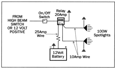

2000 jeep laradeo 78300 mi. 6cyl want to install 2 emergency light bars to jeep. how do i wire them usinf an on-off switch and relay to reduce heat?

A 25 amp fused main power into each realy (1 for each light bar)Power out to the lights,a ground for the relay use the switch in the Jeep to supply 12 volts for the relay trigger, that way you dont have any heavy draw on the wiring in the cab of the Jeep ,
https://images.2carpros.com/forum/automotive_pictures/1639_wiringdiag_small_1.gif

Suggested Repair
Use a 25-amp fused main power feed into each relay, one relay per light bar. Run power from each relay to its lights and ground the relays. Use the in-cab on-off switch only to supply 12 volts to the relay triggers so the cab wiring does not carry the heavy light-bar current.
