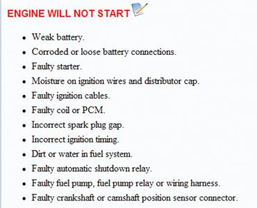

I have a 1996 Jeep Grand Cherokee Lt.d, V8 engine, mileage-99,000. I wrote that my engine wouldn't start up for some reason and that every time, it didn't start, I would hear a little clicking noise right below the right passenger side airbag. the engine won't start up for some reason. merlin2021 suggested that its probably where the relay is. If that is so, should I purchase another one from an autoparts store? Or is it something else?

No it's not the starter relay you hear thats under the Hood!
https://images.2carpros.com/forum/automotive_pictures/62217_96JeepNoStart_copy_1.jpg
https://images.2carpros.com/forum/automotive_pictures/62217_96StarterRelay_1.jpg
https://images.2carpros.com/forum/automotive_pictures/62217_30961_mitchell_2_63.jpg
Check these probable causes!
