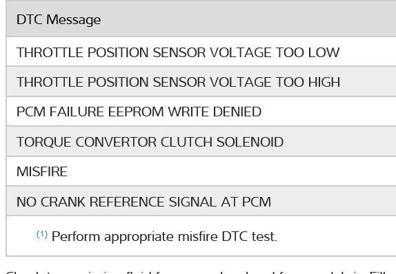

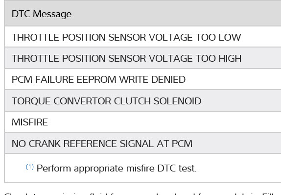

pic shows probable causes misfire is one of them have a local pro freeze frame to see if anything is making it misfire. that will be your cheapest way out with checking and replacing all kinds of parts to find it only to not find it.
