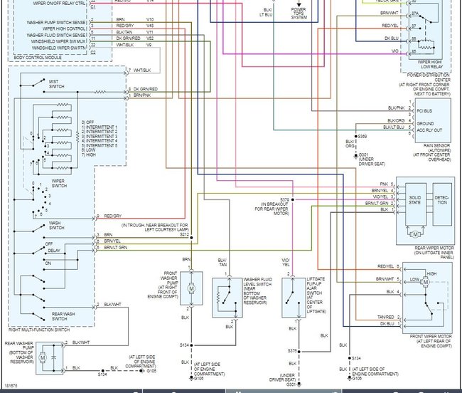

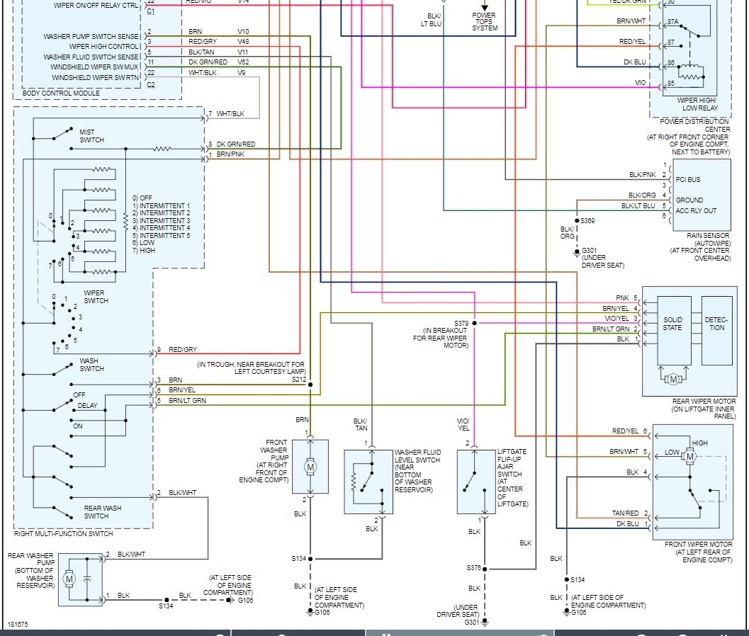

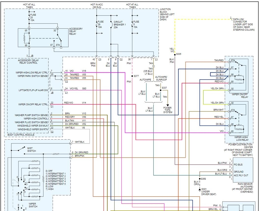

I was wondering what the problem was with the wipers on my vehicle? I have only had the vehicle for about a month and ever since I bought it the wipers have driven me crazy. They work perfectly normal on low and high speed and the wash switch works fine but the problem is in the intervals. The wipers will turn on and stop in various positions on the windshield, they will be going then stop vertical and diagonal. And also not just in intervals but anytime I turn the windshield wipers on, I have to guess when they are coming to the resting place and turn them off real quick as like a guessing game to get them to stop at the bottom out of my sight, as if I just turn them off they stop wherever they are at that point on the windshield. What could be the problem? I would appreciate any information!
Aug 20, 2009 at 9:38 AM
MERLIN2021
  • 17,250 POSTS

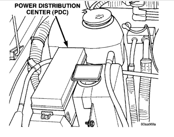

This will sound crazy, but your wipers operate through the BCM (Body control module) and the multifunction switch (steering column). Powered by two micro relays under the hood in the power distribution center, then to the wiper control module, any of theses, except maybe the relays, could be the cause! A test with a Chrysler DRB III tool is needed to find out if a module, or the motor, or switch is at fault. My money is on the wiper motor park switch, inside the motor, but test first!
Operation; the front wiper module operation is controlled by the battery current inputs received by the wiper motor from the wiper on/off and wiper high/low relays. The wiper motor speed is controlled by current flow to either the low speed or the high speed set of brushes. The park switch is a single pole, single throw, momentary switch within the wiper motor that is mechanically actuated by the wiper motor transmission components. The park switch alternately closes the wiper park switch sense circuit to ground or to battery current, depending upon the position of the wipers on the glass. This feature allows the motor to complete its current wipe cycle after the wiper system has been turned off, and to park the wiper blades in the lowest portion of the wipe pattern. The automatic resetting circuit breaker protects the motor from overloads. The wiper motor crank arm, the two wiper linkage members, and the two wiper pivots mechanically convert the rotary output of the wiper motor to the back and forth wiping motion of the wiper arms and blades on the glass.
Heres a guide on testing wiring and relays
Wiring diagrams for your wipers are attached below

I have a 2004 Jeep Grand Cherokee. The wipers on the front wind shield do not park or stop in a down or off position. When selecting off or intermitted they will stop anywhere along their route of travel. To get then to stop in the down position, the sws must be selected off at just the right time. I have tried replacing the relay and that did not work. Any suggestions before I have to take it to the dealer.
Feb 7, 2021 at 1:10 AM (Merged)
SERVICE WRITER
  • 9,123 POSTS
I don't have a testing procedure on this. The porblem lies in one of three likely areas. The switch, the intermittant wiper controller or the motor.
The switches on the late model chyslers were having a problem like this. Having said that I have also seen the intermitant wiper controller be the bigger source. The controllers are very common on the GMs.
The exception to this is if the windsheild has been replaced with the wrong one, the rain sensor will pick up an incorrect refraction of light...this is a long shot.

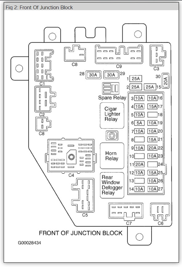

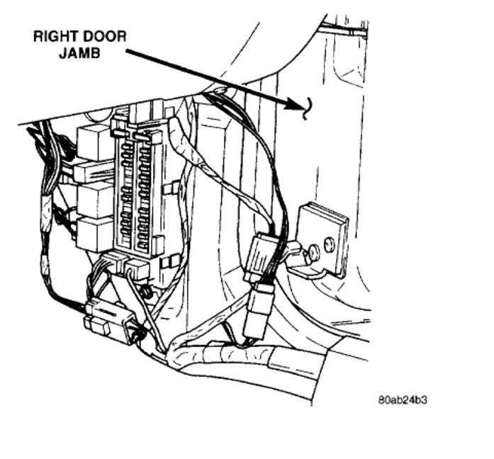

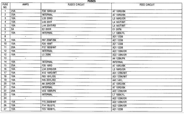

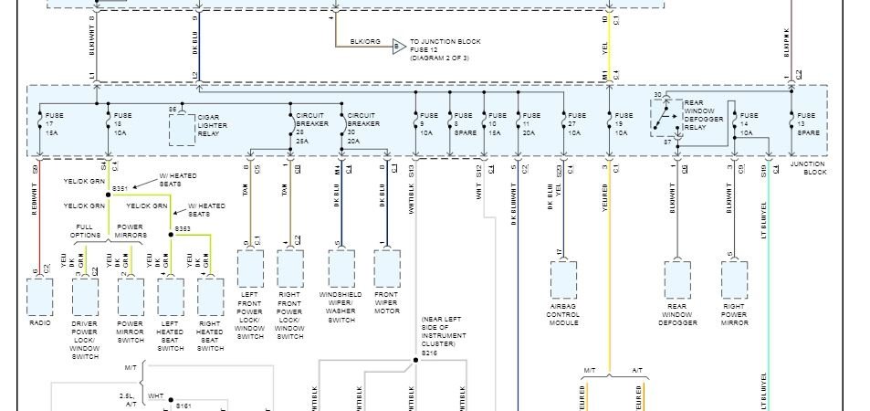

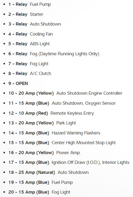

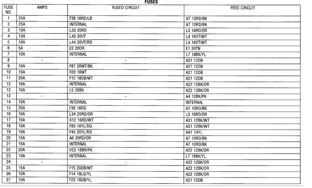

My wipers stopped working as if a fuse blew. I checked the manual but no fuse for front wipers was listed. I also checked the Power Distribution box under the hood but still can not find a fuse for the front wipers. I went to an auto zone and looked in a repair manual for my jeep and in the wiring diagram it shows a 7.5 amp fuse for the wipers in the fuse block, but it doesn't exist. I also called some jeep dealers and they say its in the fuse block. Please help!
Feb 7, 2021 at 1:11 AM (Merged)
LALORENZO
  • 28 POSTS
There is a detailed listing of your fuse box.It looks like the wipers run off a breaker (#30)instead of a fuse Every electrical component in your car is fused. Here is a guide and some diagrams (below) so you can get the problem fixed.
Check out the diagrams (Below). Please let us know what you find. We are interested to see what it is.
Feb 7, 2021 at 1:12 AM (Merged)
KIMODAN

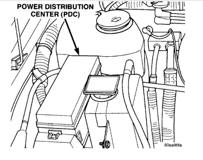

I have checked the manual from cover to cover also a chiltons repair manual which says there is a 7.5 amp fuse for the wipers but doesn't tell where it is. I even pulled every fuse inside and under the hood in the power distribution box to check them in case of mislabeling but they are all good. Where ever it is , its not in a obvious location.

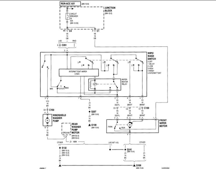

wipers only work on high speed, washer works,will not return to park. i installed a new switch and still the same as before. i have read about a (intermittent wiper module). if it has one could you please tell me where it is at and if i can replace it? Thanks!
Good morning.
The logic you are talking about is part of the switch.
In most cases, the motor itself is the failure. I attached a wire diagram for you to view. check the wires to the motor when in lower positions. you know it works on high. if you have power it is the motor. if it does not have power it is either wiring between the switch and motor or the switch itself.

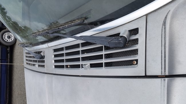

My windshield wipers are not working. I check the fuse for corrosion. They try to work when I push the knob, so they are getting power. Could the wiring not be on all the way? Could it be the motor? My limited mechanic skills could not get me out of this one.
Feb 7, 2021 at 1:13 AM (Merged)
CARADIODOC
  • 34,381 POSTS
Two things to look at. First, turn the switch to the "low" or "high" position; not an intermittent setting. Now push on the wiper motor to see if it starts running. Alternately, check for the presence of 12 volts on the metal case of the wiper motor. Be sure your meter's negative probe or your test light's ground clip is on the battery's negative post or on the engine, not on the plate the motor is bolted to.
If you find 12 volts or the motor starts to run, add a jumper wire from the motor to the body.

Do i need to push on the actual motor? Do I need to take the protective plastic off?
CARADIODOC
  • 34,381 POSTS
Yes, push on the wiper motor. Alternatively, tug up on one of the wiper arms in your photo. That will move the linkage and motor. The most common cause of this problem is an arced ground strap on the motor, and just moving it slightly will momentarily get it going. If it does, there is a simple fix. You can almost get the motor to run temporarily by staring at it hard enough!
When the motor is easily accessible, you can also measure the voltage on the metal case of it. If there is any voltage when the wiper switch is on, that ground strap needs to be repaired.
If moving the motor doesn't work, we'll need to do some voltage measurements to solve the problem.
