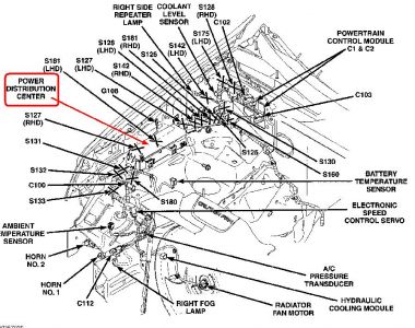

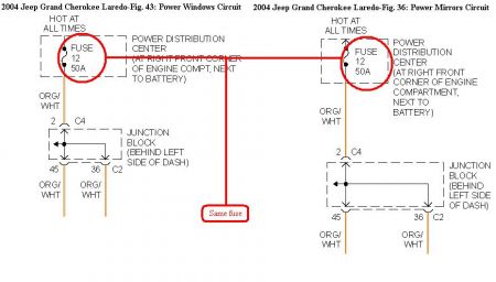

no 12v power at master widow switches/mirrors. No fuse or breaker labeled windows that I can find. What is the current flow from the source to the switch pack? I do not have a specific wiring diagram for this year or a componet locator.

Will this work?
http://www.2carpros.com/forum/automotive_pictures/55316_04gcherokeepw_1.jpg
http://www.2carpros.com/forum/automotive_pictures/55316_04gcherokeeunderhood_1.jpg
or do you need the actual wiring diagram. If you do email me, I'll forward the pdf to you. They don't look good in the post and they are way too small.

Yes, a diagram will be helpful. Thanks for the fuse info and quick reply.

The wiring diagrams are in your email.
Thanks.
