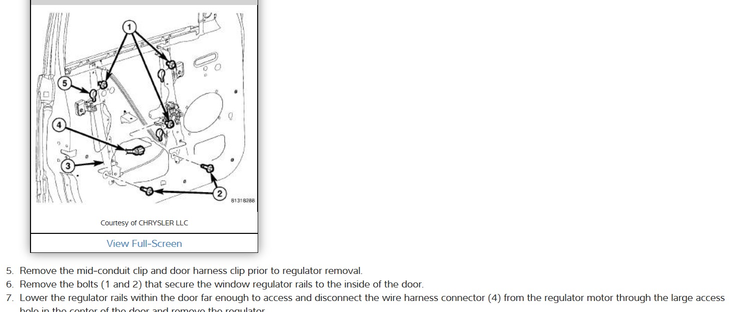

hi i need to repair glass motor?
Apr 26, 2015 at 3:57 AM
HMAC300
Experienced Mechanic
48,601 POSTS

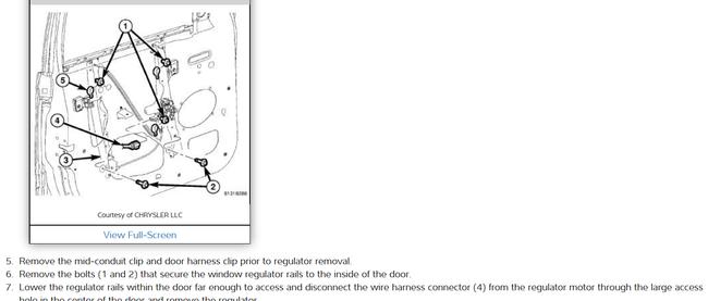

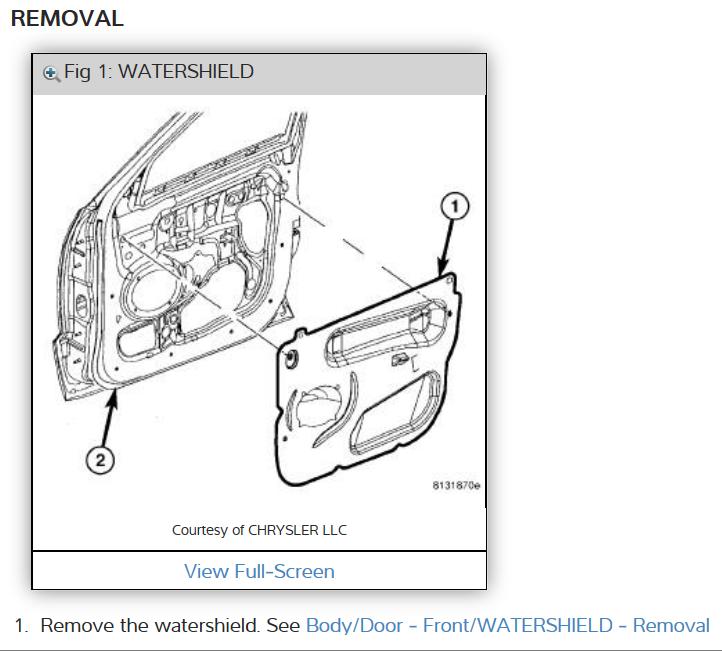

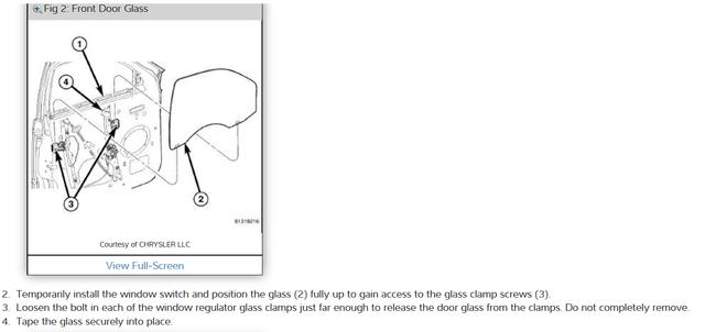

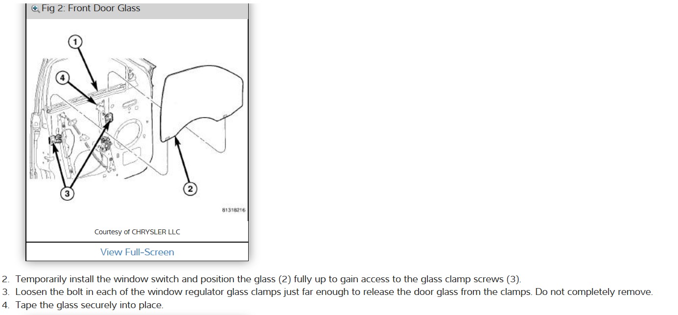

see pics for removal. Check out the images (below). Let us know what you find.
