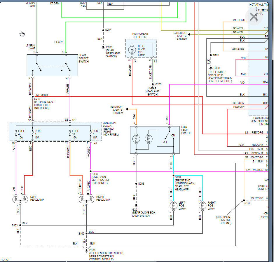

headlights do not work?
2004 JEEP CHEROKEE
139,000 MILES • 4 CYL • AWD • AUTOMATIC
MICHIGANDRIVER
the head lights on the driver side completely do not work. No brights, dims or turning signal. What could cause this and is it an easy to fix myself?

first check the bulbs and don't touch the glass on the head light bulb with fingers the grease from hands can damage the bulb if the bulbs are ok check the grounds. I have seen the TIPM cause this issue which is common here is how you can change it out also I have includes a guide to check the fuses and the fuse location as well.

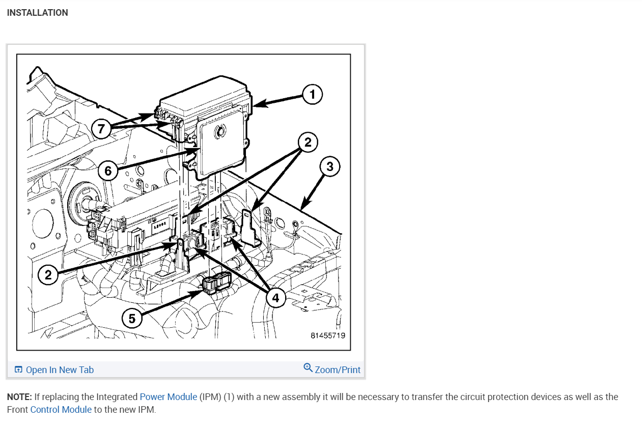

DANNY L
  • 5,648 POSTS

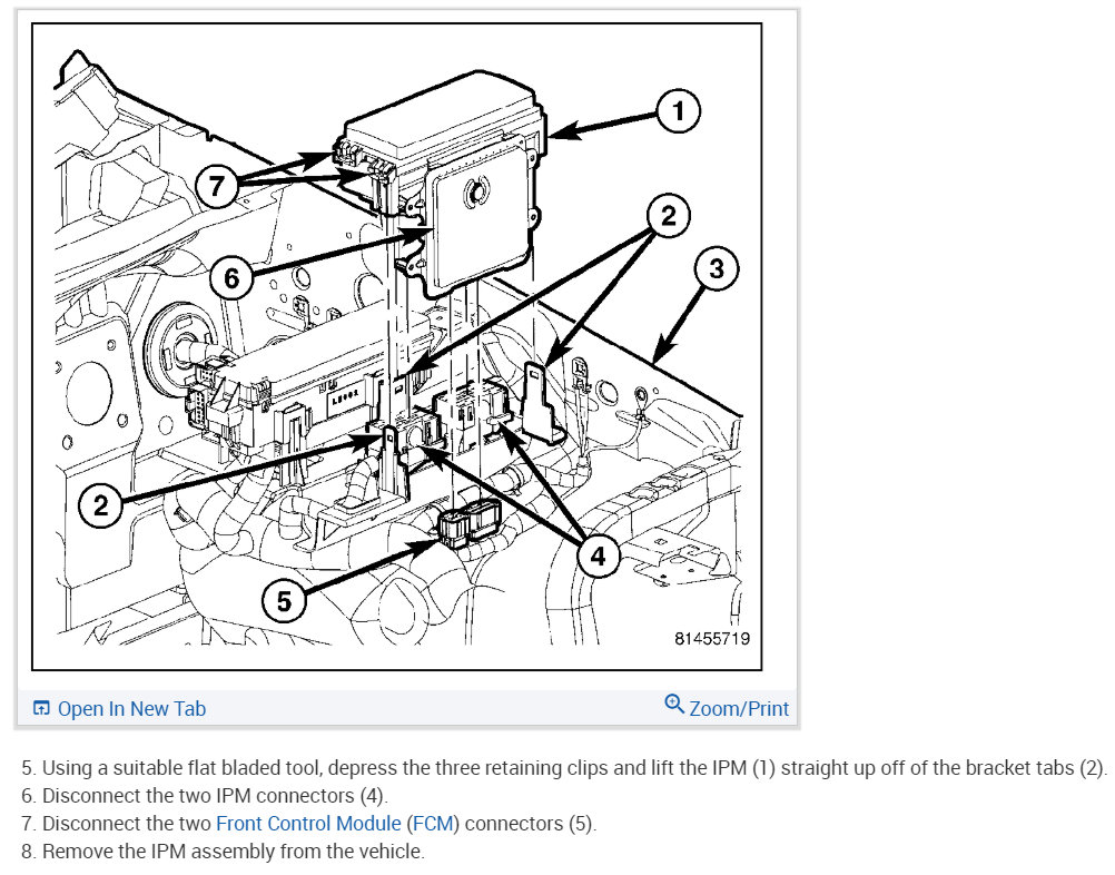

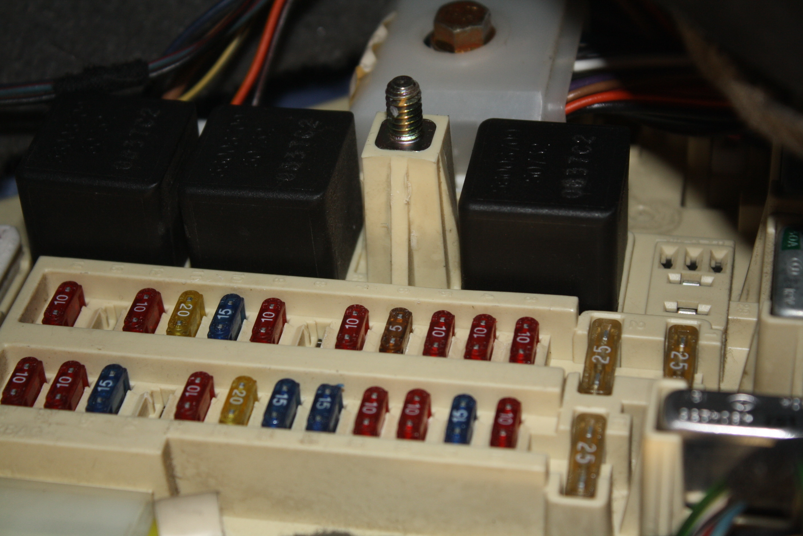

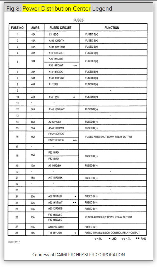

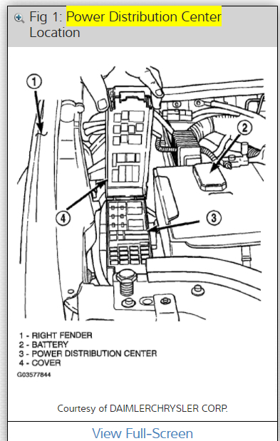

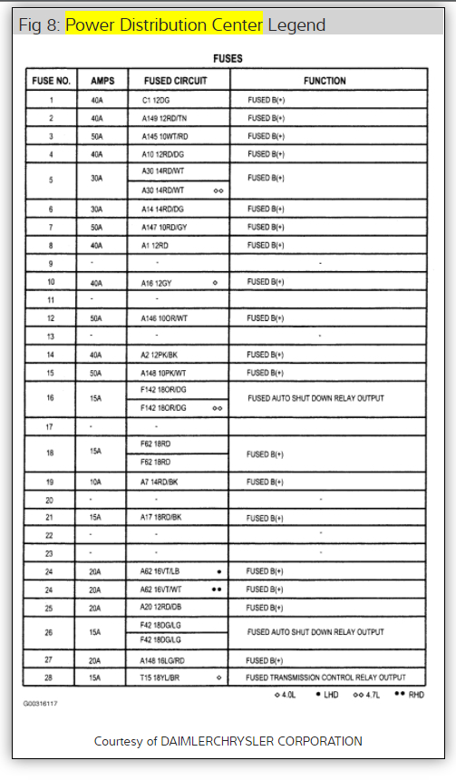

Hello, I am Danny.

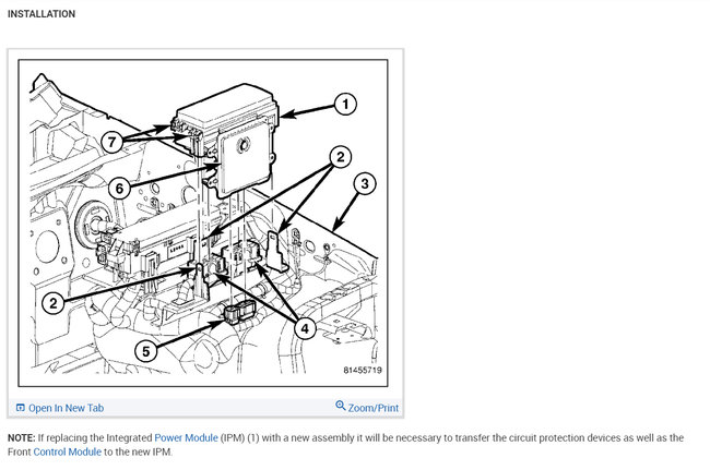

It sounds like you might be having trouble with the Headlight Relay. I am attaching a picture of the power distribution center that is under hood mounted on the passenger side fender. That is where the relay would be located.If you have access to the owner's manual you could find the fuses and relay numbers in the fuse section. I cannot find a diagram just yet, but I will keep looking. I have also attached a tutorial showing how to test a relay. Hope this helps and feel free to ask any other questions. Thanks for using 2CarPros.

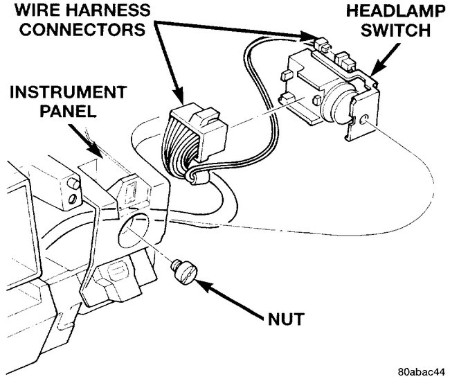

  • 110,240 POSTS
Chances are there is an issue with the light switch itself. When they don't turn on, wiggle the switch around to see if they turn on. If they do, replace the switch.
Here are the directions if you find that is the issue. The attached pic correlates with these directions.
Removal
Warning:
1. On vehicles equipped with airbags, refer to air bags and seat belts/air bags before attempting any steering wheel, steering column, or instrument panel component diagnosis or service. Failure to take the proper precautions could result in accidental airbag deployment and possible personal injury.
2. If the headlamp switch was on, wait five minutes to allow the ceramic dimmer resistor to cool. If the ceramic dimmer resistor is not allowed to cool, it can burn your fingers.
1. Disconnect and isolate the battery negative cable.
2. Remove the knee blocker as described.
3. Pull the headlamp switch control knob out to the On position stop.
4. Reach up through the outboard side of the steering column opening and depress the headlamp switch knob and shaft release button on the inboard side of the switch.
5. Pull the switch knob and shaft out of the headlamp switch.
Headlamp Switch Remove/Install
6. Remove the spanner nut that secures the head-lamp switch to the instrument panel.
7. Move the headlamp switch into the steering column opening far enough to access the wire harness connectors.
8. Unplug the two wire harness connectors from the headlamp switch.
9. Remove the headlamp switch from the instrument panel.
10. Reverse the removal procedure to install. Tighten the spanner nut to 2.7 N.m (24 in. lbs.).

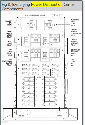

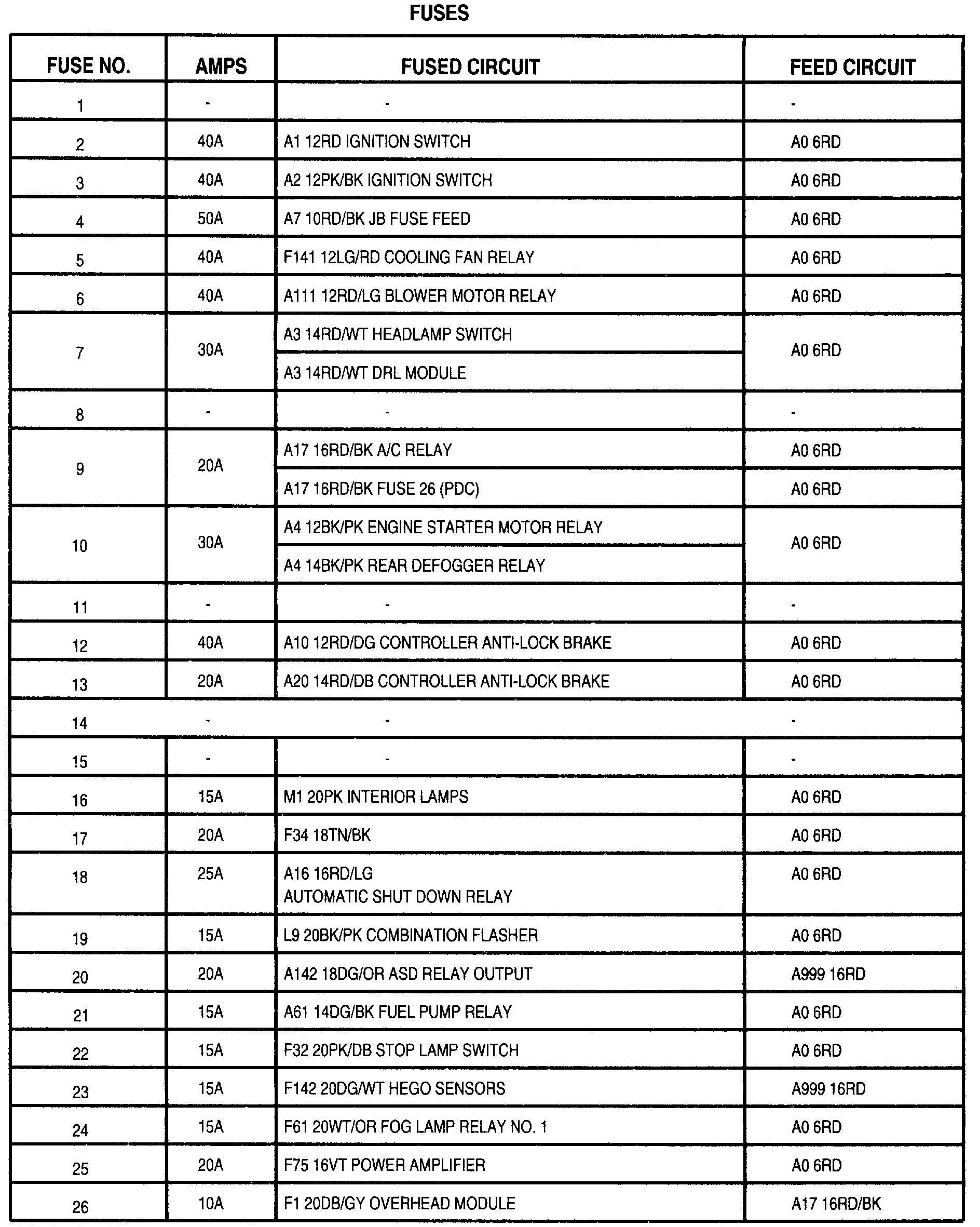

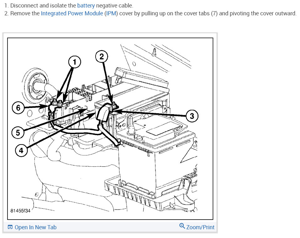

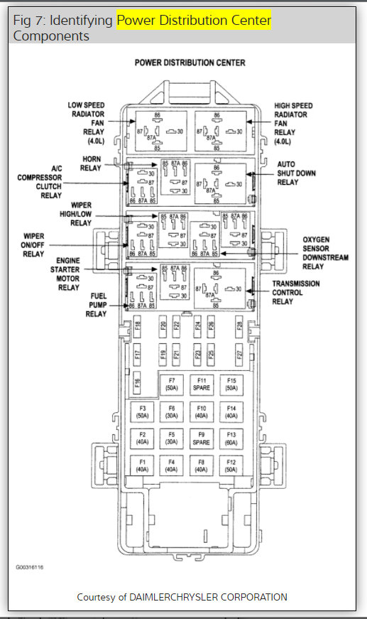

I attached a pic of the power distribution box under the hood. Confirm that fog light relay 1 is tight and making good connections, as well as the headlamp fuse B10.
Let me know if this helps.

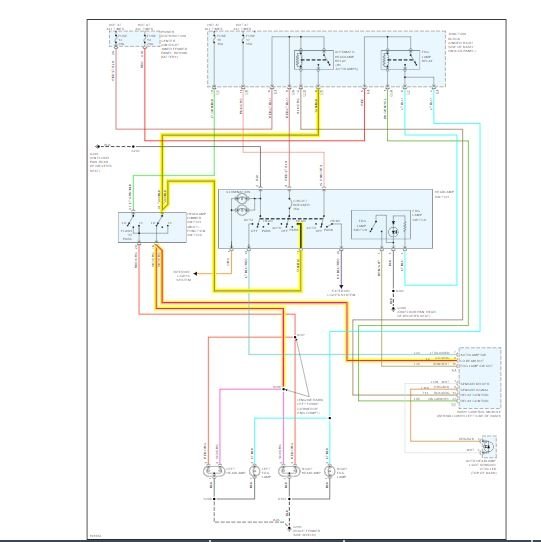

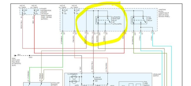

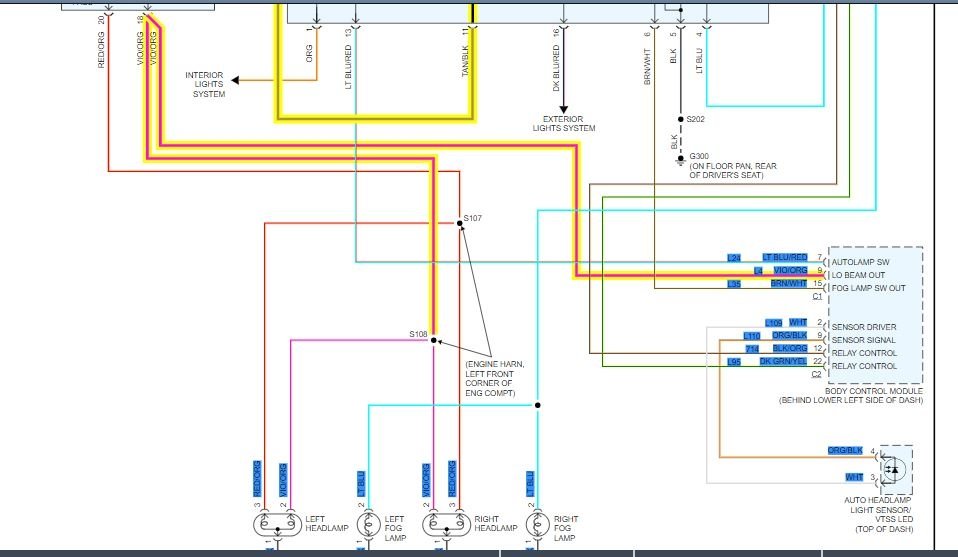

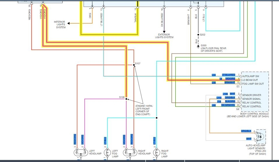

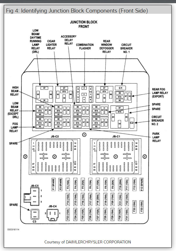

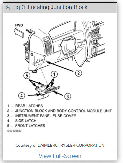

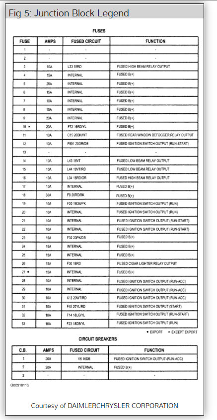

Good afternoon,
I attached the wiring diagrams for you to view.
The one thing I see if the BCM. If it is failing, it can ground out the power to the headlights causing no lights.
Check the system with a scan tool that can read the BCM live information and see if there are any faults.
I also circled the delay relay for you.

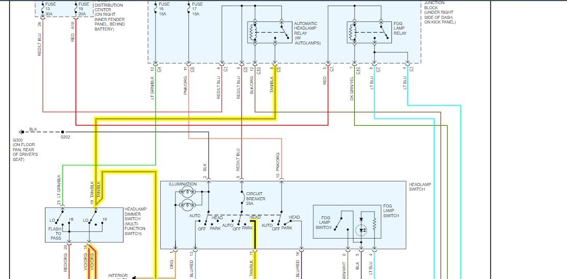

Roy, I don't know what "BCM" means and the first two schematics show a headlight relay. This car does not have a headlight relay in it. This is a 1998 Cherokee.
Oct 14, 2020 at 6:25 AM (Merged)
The relay is under the dash right side on the fuse panel as listed in the diagram.
The BCM is a body control module which controls all the body functions of the car.

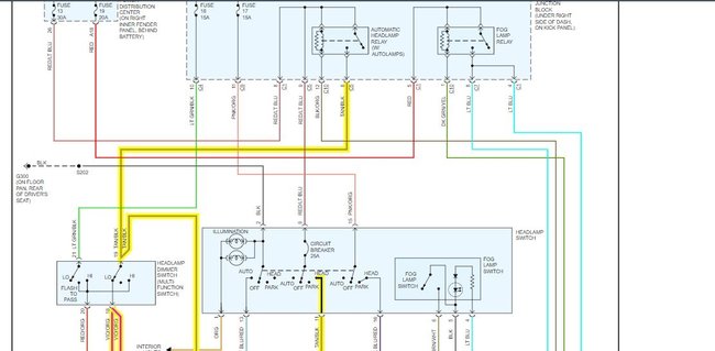

None of the previous schematics I have seen show a headlight relay. The one in your schematics designates it as an "automatic headlight relay". This car does not have automatic headlights, it has the headlight delay module for keeping the headlights on after the ignition switch is shut off and that works fine. I turned the lights on and I pulled the three large relays in that kick panel and none of them affected how the headlights work. There are four circuit breakers but, according to my documentation those are for power seats, power windows, the alarm system and the rear window heater. I haven't found anything on the large relays.

You need to test for voltage to the dimmer switch when the issue is present. If he drove it home with no lights, that's when you need to test it.
Also, if the highs and lows do not change the dimmer switch is the issue for that.
there is no separate relay for the headlights. Power comes out of the fuse block to the dimmer and then off to the lights.

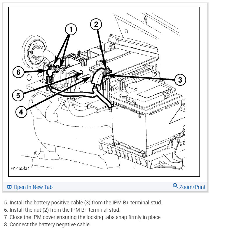

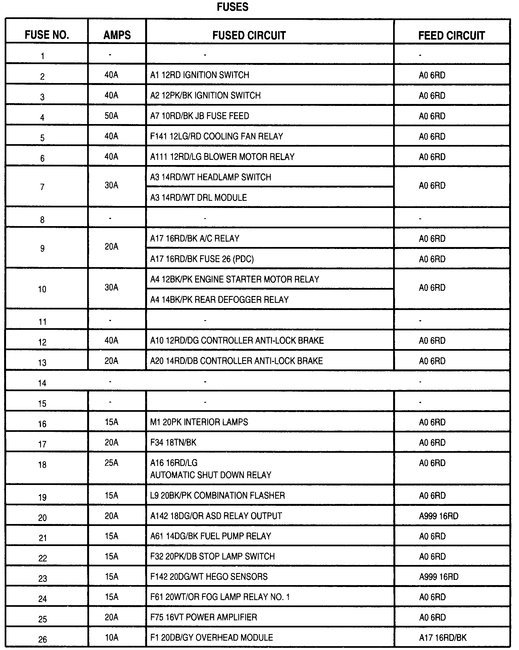

Does your vehicle have fog lights and do you know if they were working? The reason I ask is the most likely cause of both headlamps to go out and then return is a ground issue. The fog lights and headlights share a ground so we need to check this and see if it is loose or have corrosion around it causing a poor connection.
You should see it by the PCM bolted to the fender.
Let me know if this is clean and tight and then unfortunately we will need to test the vehicle when it is acting up. It doesn't have to be night to duplicate this. Just turn the lights on and start wiggling the harness from the head lights back to the junction block shown in the wiring diagram.
Let me know what you find. Thanks

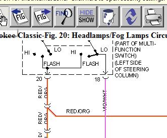

ok i just researched the wiring schematic and i found that your problem is the headlight switch. its cut and dry that the problem is the switch and not a wiring problem. hope this helps.

Welcome to the forum, may be a problem with the dimmer switch? Red wire with orange tracer is voltage for high beam. Violet wire with white tracer is voltage for low beam. You may be able to access those wires on the lower part of steering column.
