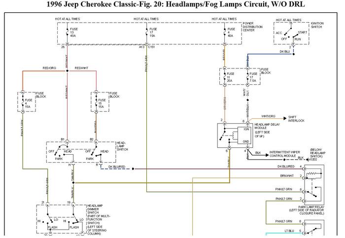

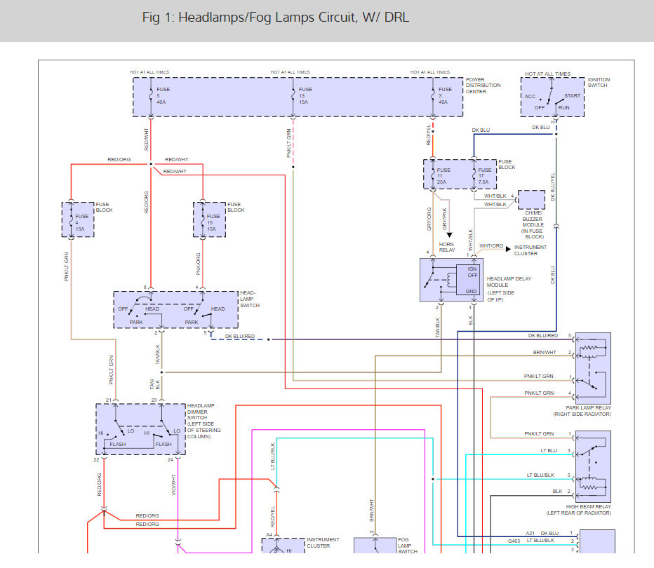

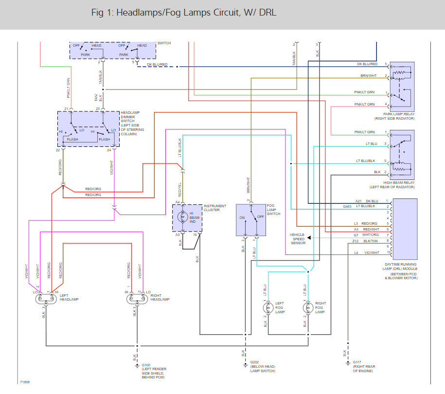

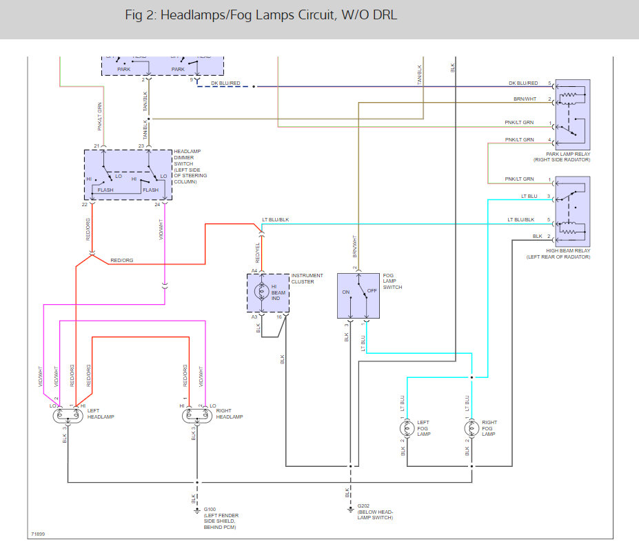

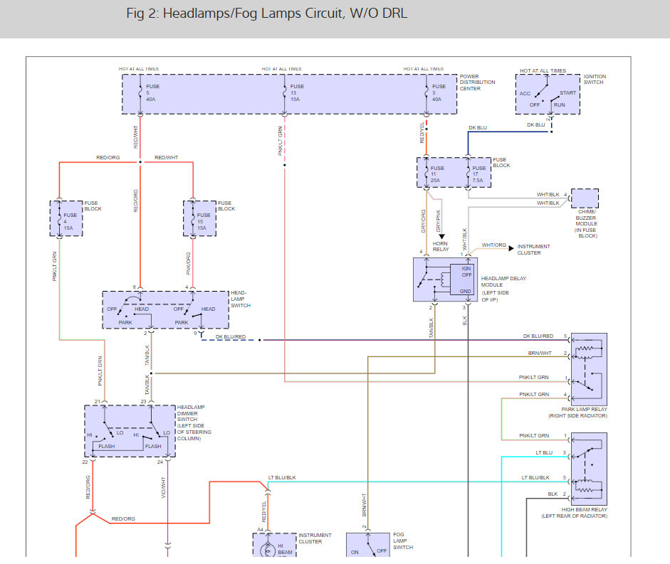

I have a 1995 jeep cherokee sport w/ 217k miles, automatic. I need to find the wiring diagram for the headlights.
My head light switch is not working and does not turn on the head lights. Also, the highbeam switch won't stay on High beams.The result is I have no head lights.
Is there a wiring diagram I can download or could it maybe be a fuse issue?
Thanks in advance,
Milt
Nov 2, 2007 at 7:04 AM
MIKE H R
  • 3,094 POSTS
Here are the headlight wiring diagrams for both DRL and non DRL headlight systems with a guide to show you how to test the wiring.

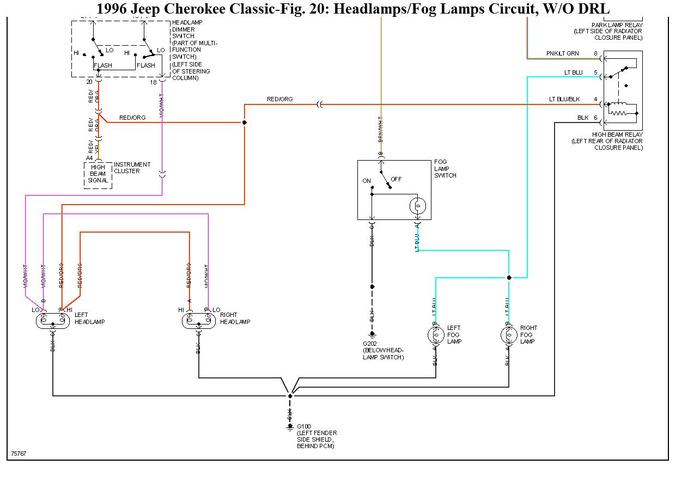

Lights work except high beam on passenger. I get no continunity at the high beam harness plug on Passenger side. Low beam works. Where does the harness run from the drivers side to the Passenger side? Are there any plugs to check along the way? Are there any common problems for this particular malfunction?
Jan 9, 2019 at 12:27 PM (Merged)
KHLOW2008
  • 41,814 POSTS
Is your vehicle equipped with Daytime Running Lights?
Have you checked/tested the bulb?
NOTSMALL
No daytime lights and yes, the bulbs work on the drivers side. There are two red wires in the high beam side of the plug on the drivers side. One apparently goes to the Pass. side which only has one red wire into the highbeam portion of the plug. No power or continuity to the pass. side red wire. Apparently there is a break between the Driver and passenger side. The wires disappear into a loom and I am wondering if the is a plug to check .
KHLOW2008
  • 41,814 POSTS
Attached are the schematics. Passenger side (right) has the Red/Orange wire running from between the two headlights.
When high beam is turned on and you do not have battery voltage at this wire, it means a break in between.
NOTSMALL
Got it, Thanks. Do you know where the wire runs ? I see where it ends up but I don't know where it physically goes. Is there a plug some where that could be compromised?
KHLOW2008
  • 41,814 POSTS
I could not find any information on connectors between the two and wiring between headlights usually come as a single harness which runs across the radiator to the other side. Most wires would break at the ends, meaing the break should be near the plugs for the bulbs. Tug at the wires and note if any parts seems give way/lenghtens and that should indicates a break. Wiggling the wires might help to diagnose which area is faulty.
