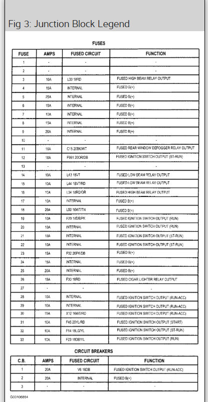

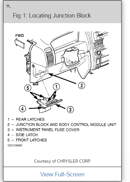

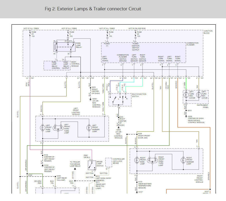

have put in new bulb in tail light and checked the connection, still won't work any ideas?
Jun 10, 2009 at 9:36 AM
KBROOKS35
  • 7 POSTS

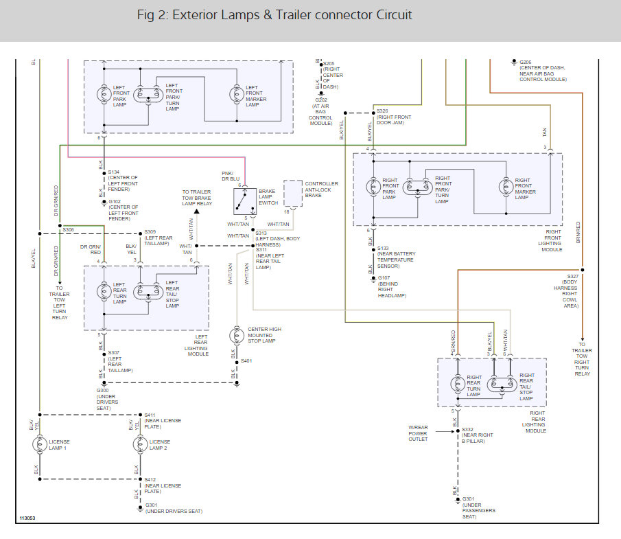

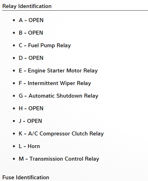

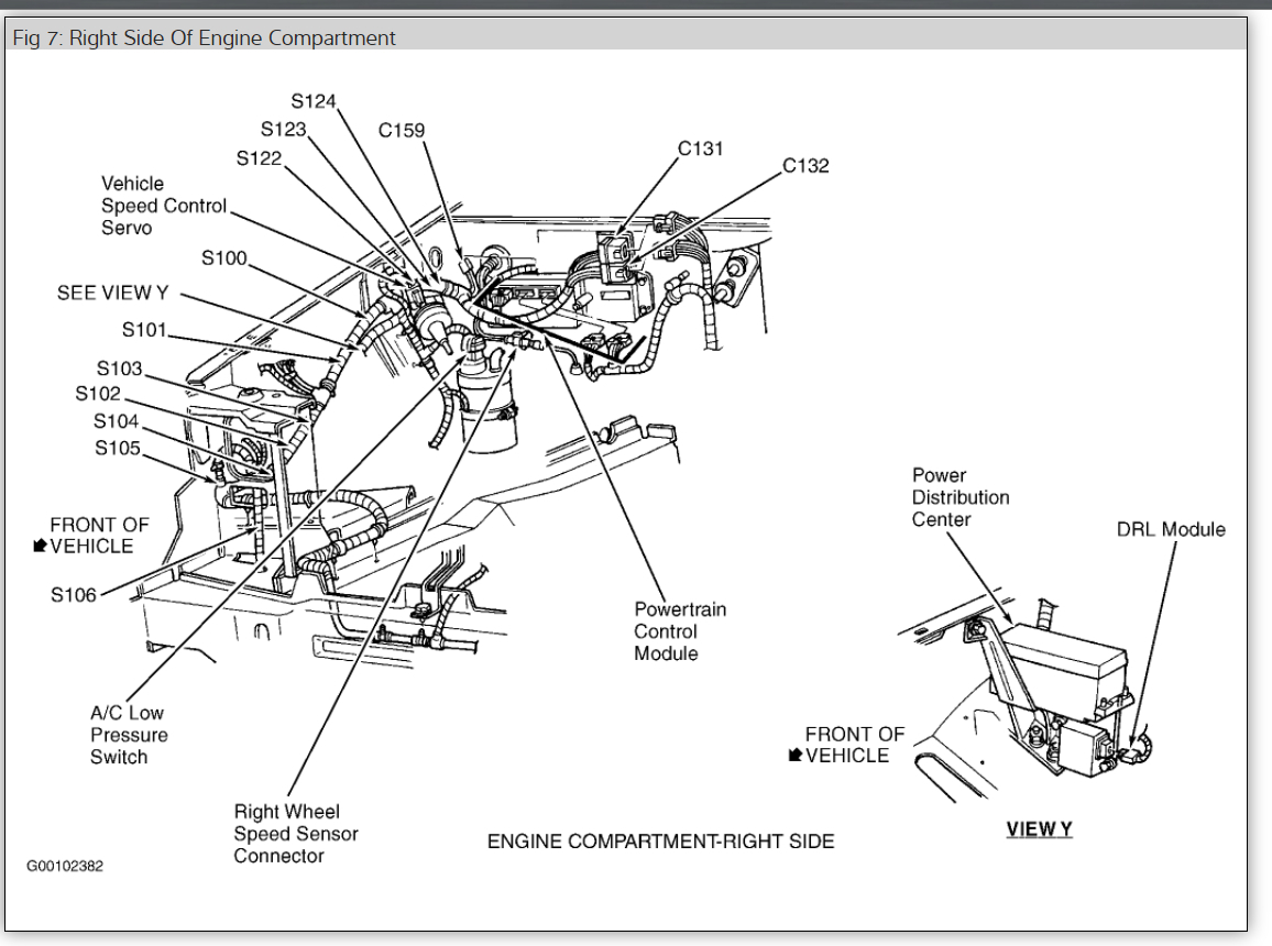

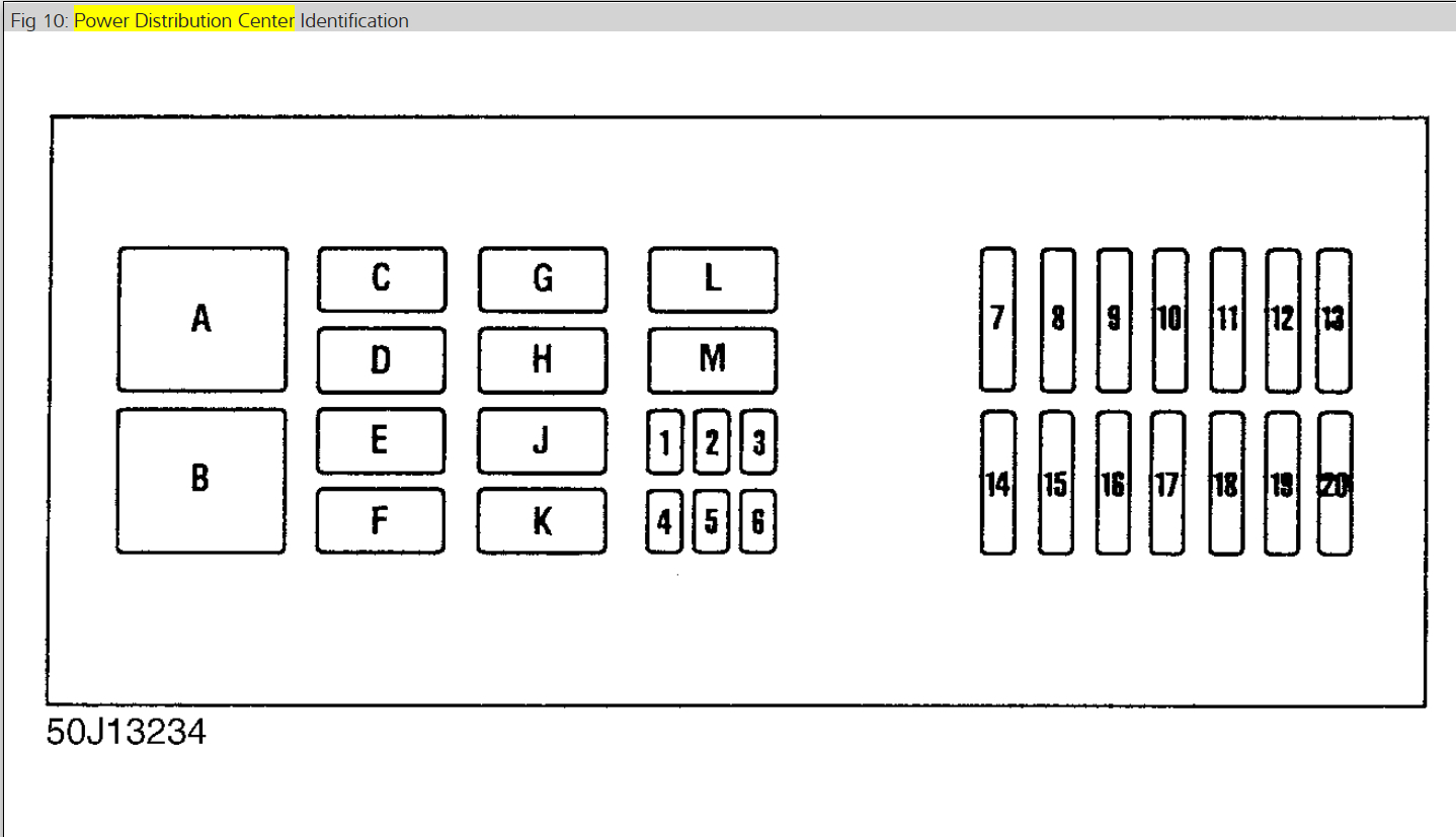

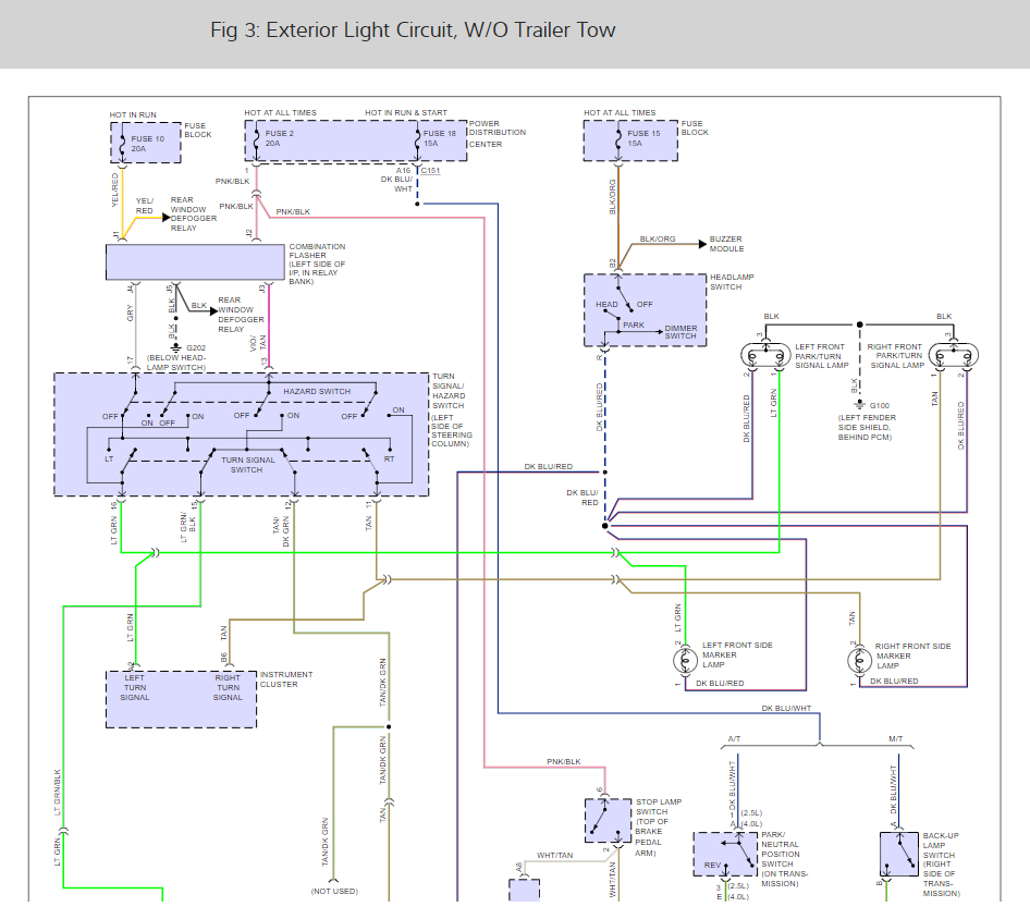

if its like my jeep your tail light relay is out here is a guide to help test it and the running light wiring diagrams so you can see how it works with the relay location as well.
Check out the diagrams (Below). Please let us know what you find. We are interested to see what it is.
Jun 11, 2009 at 8:35 AM
MATTICE31
Thanks you for this post I had this problem and had to get a new relay cost me $23.00 all fixed I love this site.

HOUSEJUDGE
I hooked up to a trialer I had not hooked upto before. I noticed later that the marker lights were not working on the trailer, or on the driver side marker lights. This is a trailer 'T' connection, that I have used in the past. I've checked fuses, blubs, and everything seems to be in good working order, turns, brakes, and hazard all work, markers on right side work. I have tried removing the 'T' connector, still same problem.
Sep 10, 2019 at 10:35 AM (Merged)
  • 110,244 POSTS
Is there power to the light?
HOUSEJUDGE
Not on the marker lights, there is on the brakes, and turns
  • 110,244 POSTS
The markers are on a seperate power supply. Follow the wiring from them to the power source. There has to be an open circuit.

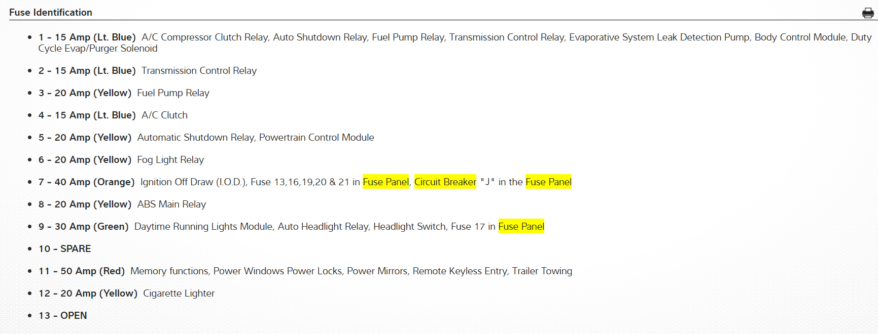

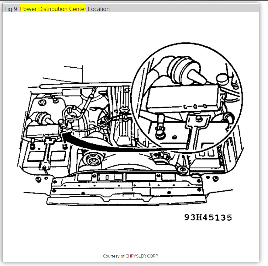

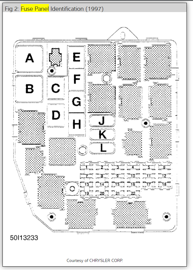

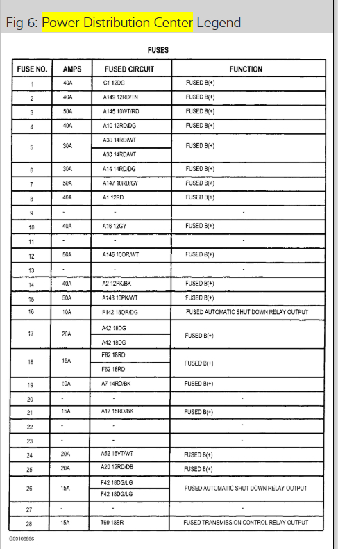

WASKOWSTEVE
Electrical problem Four Wheel Drive Automatic 206000 miles
The tail lights don't work on my jeep. The brake lights work and I suspect a blown fuse, but can't find the blown fuse. I need to know which fuse or fuses may cause this.
  • 55,423 POSTS

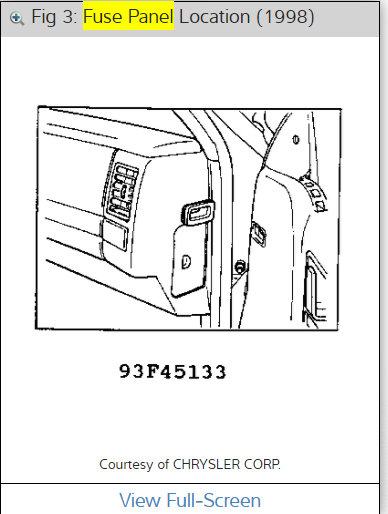

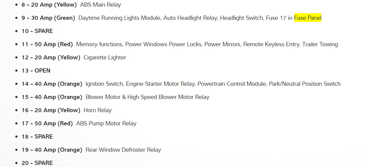

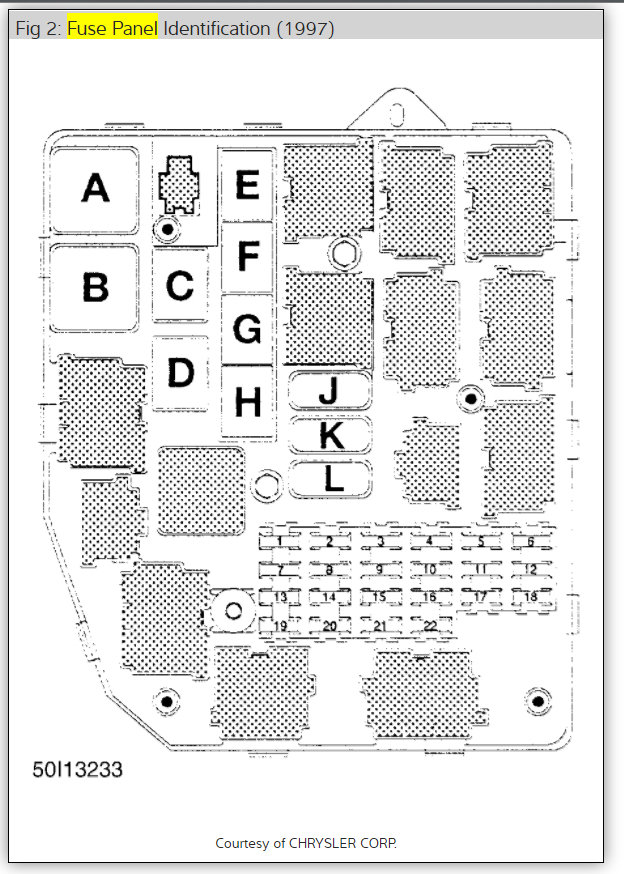

It does sounds like a fuse has blown. Here is guide that will show you how to test the fuses and to if the fuse has power.
Here is the wiring diagrams so you can see where you are losing power.

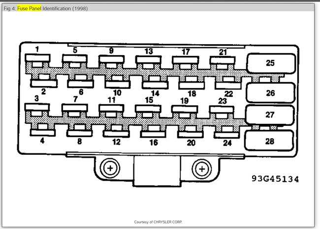

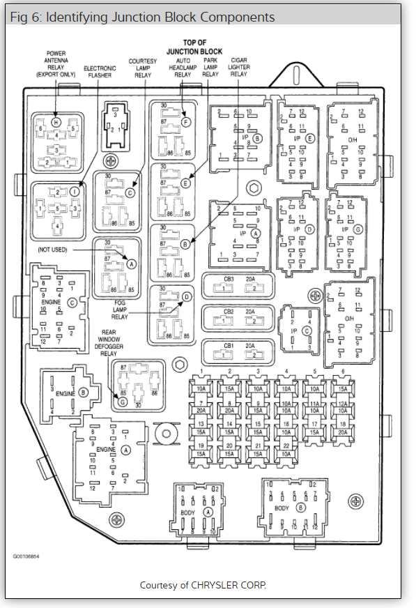

ANGELLEE06
no dash lights and no tail lights, i checked all fuses and replaced the headlight switch. what could it be?
Sep 10, 2019 at 10:36 AM (Merged)
WRENCHTECH
  • 20,761 POSTS
That's either a bad headlamp switch or a fuse. Make sure you are testing those fuses with a test light and the lights have to be on at the time.

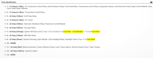

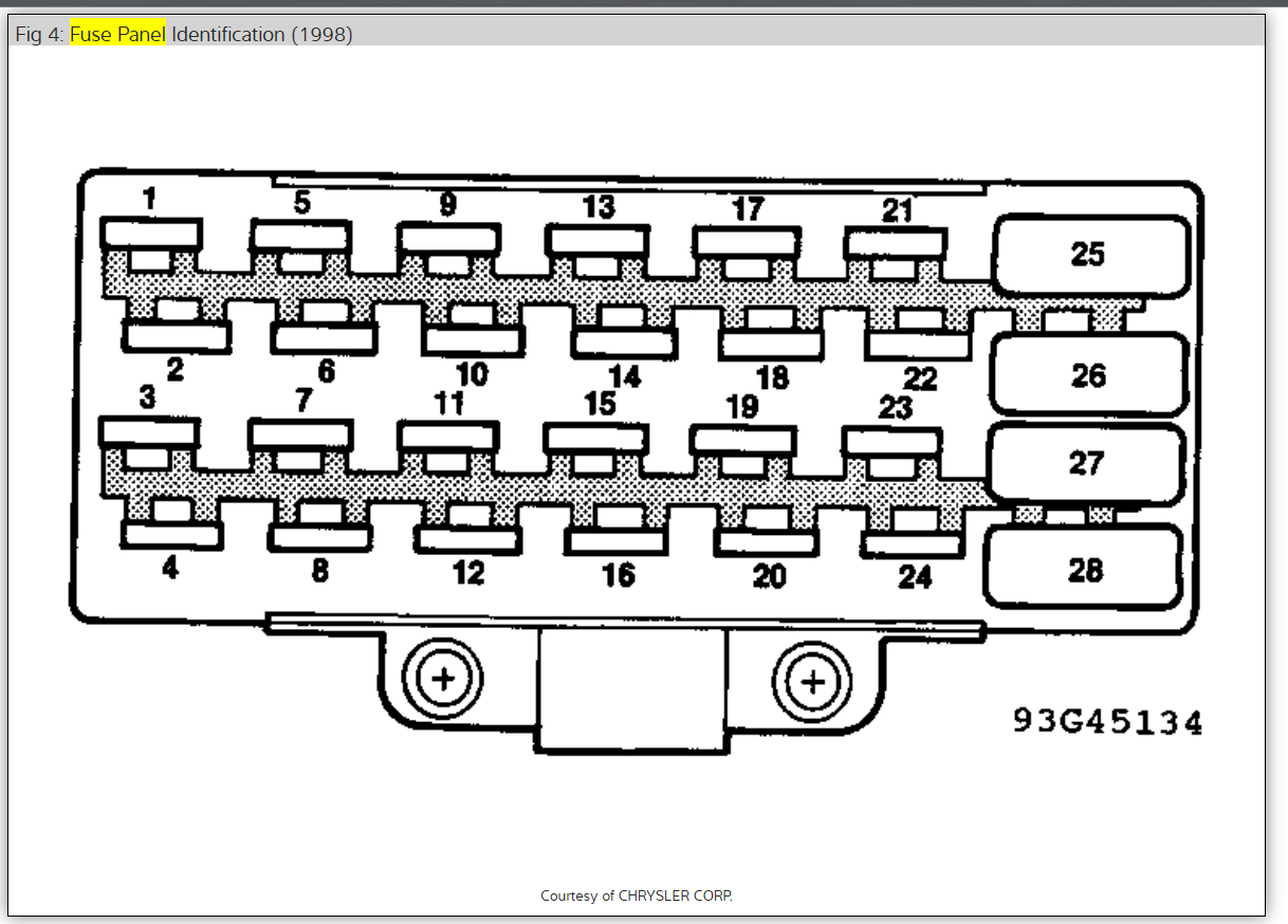

BAILEYROCK65
I have no running lights. Have changed bulds, fuses, and switch. Is there a inline fuse or relay. My head lights, brake lights and backup lights all work. My dash lights are also out. Even replaced the negative ground on the battery. Please help, am ready to straight wire to a switch.
2CARPRO JACK
  • 11,533 POSTS
You will find a full wiring diagram here
https://www.2carpros.com/articles/mitchell1eautorepair-car-repair-manuals
printable. Looks like your running lights are tied into some other stuff.

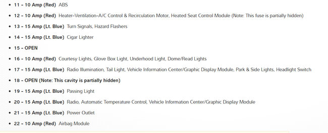

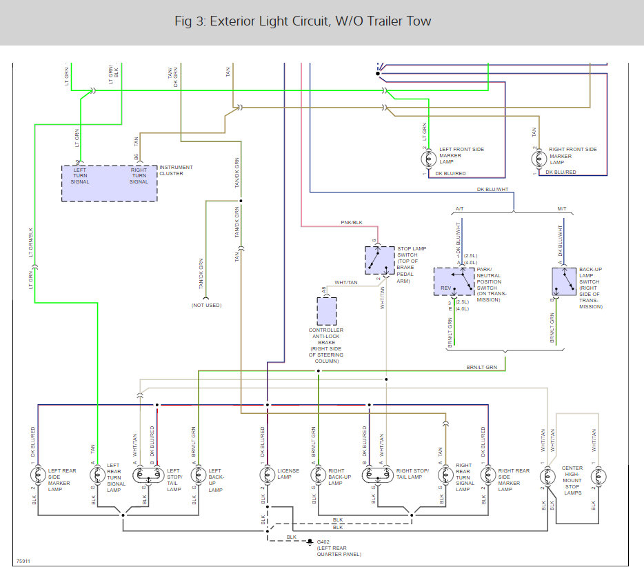

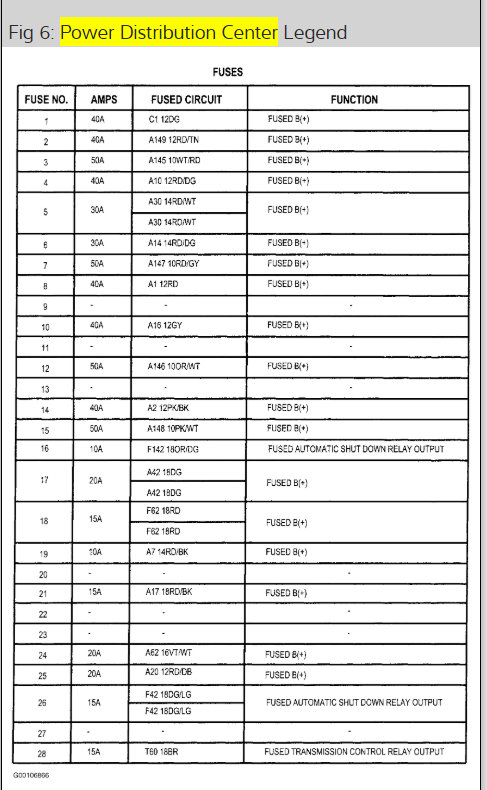

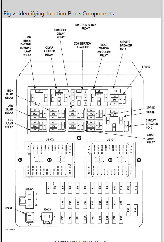

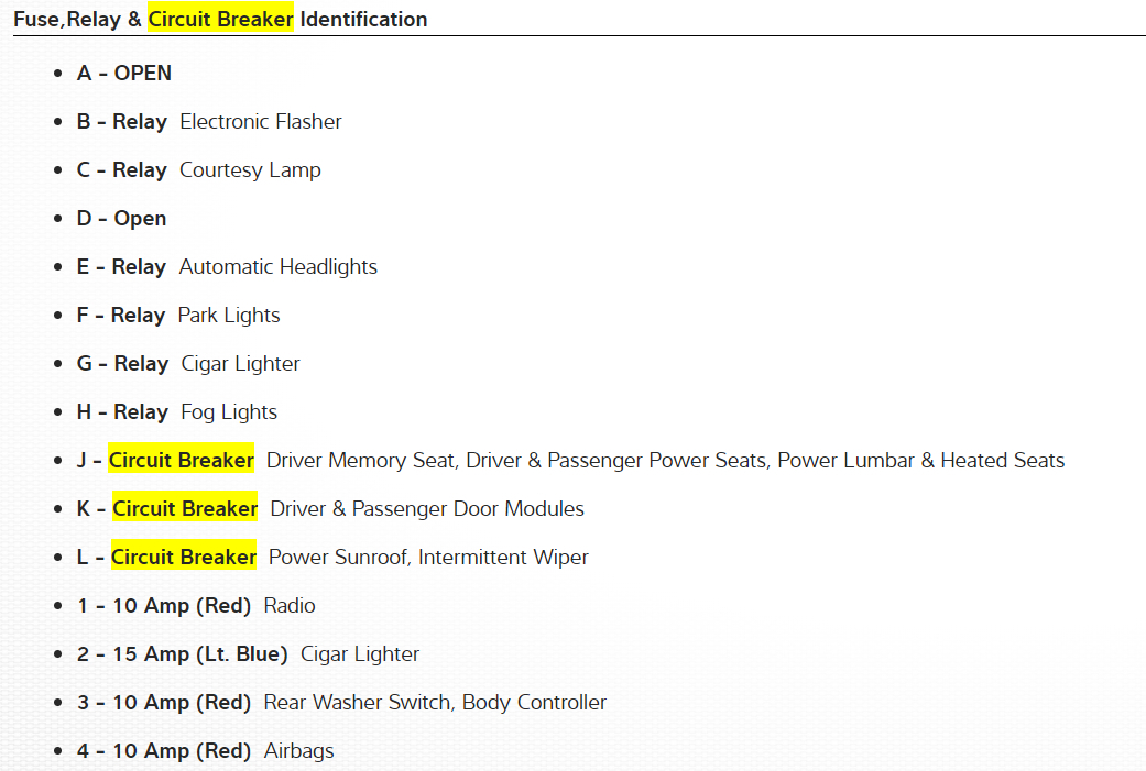

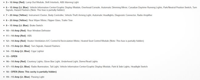

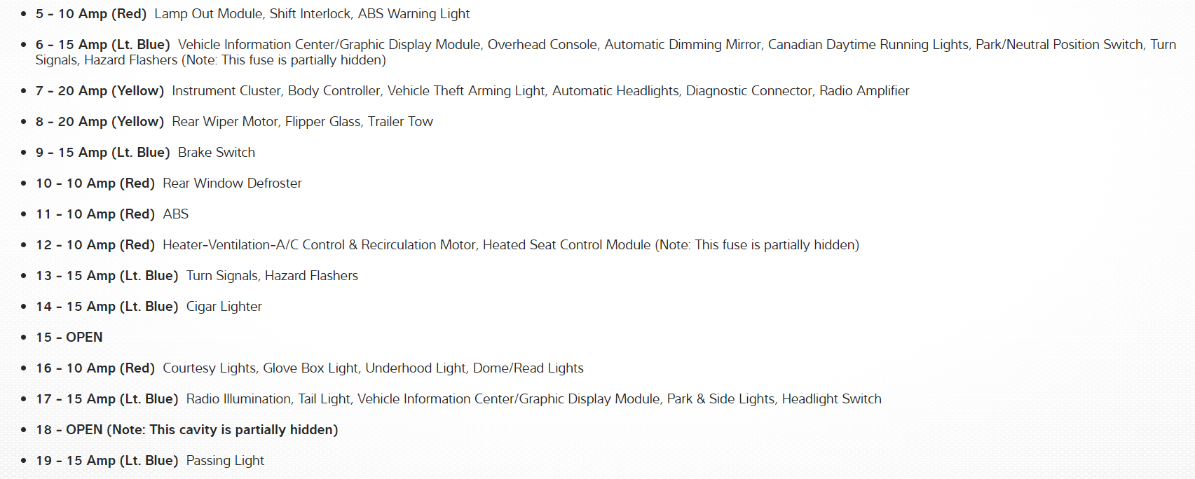

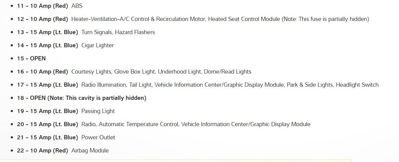

530JEEPDRIVER

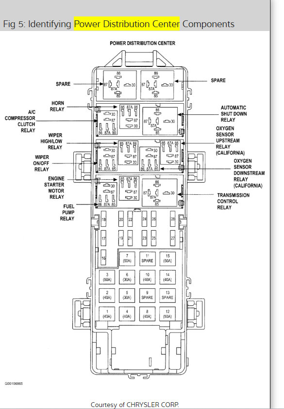

i had an issue with my head lights before where they would shut off and then turn back on when i pushed the headlight switch in then pulled it back out. then they stopped working completely so i replaced the switch and everything worked fine, then i noticed that my turn signals were acting up and shortly after that my dashlights and running lights went out. i replaced the fuse that it blew but that one blew again to. so i think that it could be one of the relays or maybe the combination buzzer but im not sure

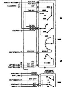

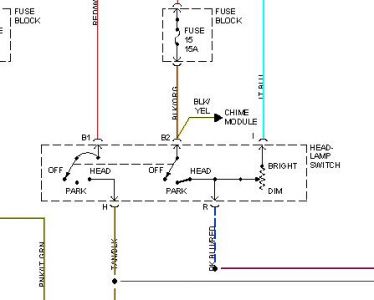

JDL
  • 16,098 POSTS
Thanks for the donation, can you tell us the amp rating of the fuse that keeps blowing? I was trying to find what all was on the fuse circuit, just not sure which fuse? That fuse serves several circuits. In the picture for the headlamp switch, the dark blue wire with red tracer goes to the fog lamp relay. I had to enlarge the picture to make it readable. When I enlarge, I can only capture a small part of diagram.
https://images.2carpros.com/forum/automotive_pictures/170934_instrument_panel_lamps_jeep_1.jpg
https://images.2carpros.com/forum/automotive_pictures/170934_headlamp_switch_jeep_1.jpg
530JEEPDRIVER
its a 15amp fuse and its number 15
SCOTTY DEE
  • 592 POSTS
Relays and chime are okay. There is a direct short in that circuit. You will need a wiring diagram in order to locate the short in the turn signals, dash lights, & running lights. They may share a common ground.
530JEEPDRIVER
alright but the chime acts up also sometimes it works, sometimes it doesnt and sometimes it sounds really weak
530JEEPDRIVER
well i checked out the license plate light pulled it out put a new fuse in and my dash lights work and all of my running lights work now so it must have been the license plate light but my blinkers are still acting up

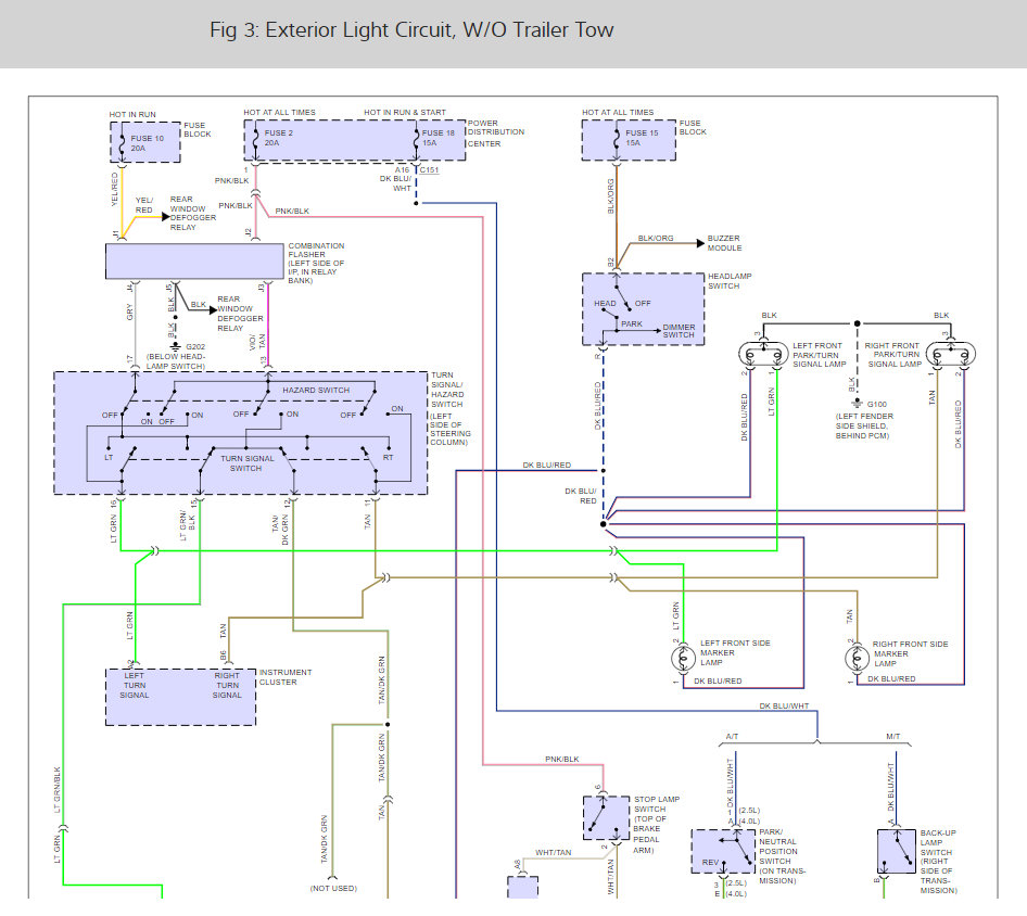

SHOT2HELL6969
Electrical problem
1989 Jeep Cherokee 6 cyl Four Wheel Drive Automatic
i turned the hazard lights on the other night and now i have no head light, dash, tail light but i have turn signals what could be the problem
JDL
  • 16,098 POSTS
Hi, I'd have to check park fuse, use a testlite, make sure the circuit is hot. Then I'd check the circuits at the headlamp switch.
https://images.2carpros.com/forum/automotive_pictures/170934_jeep_headlamp_circuit_1.jpg
