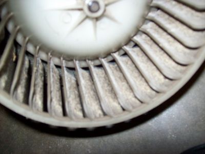

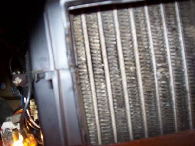

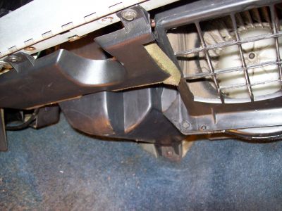

On CJs, you do use outside air to assist the fan in blowing over the heater core----Just the way somebody designed it! I would think that in a '98, it would recirculate the cockpit air without outside assistance (are you certain there is no door to close off the outside air?) Like is it "Vent Only", and nothing to do with heater operation? Can you find a diagram of the heater, in an exploded view? In a Manual? Did you click around You Tube for additional info? Were you static or driving while air was coming thru from outside? I see no reason that blocking the outside air would hurt anything, as long as you have great airflow over the heater core............and it is removed for other operations needed for summer use.........? On several older rigs, I have cleaned the heater core and all of the vanes on the squirrel cage fanmade a heck of a difference in air flow!Think maybe thats all you need to do? I took pics to show Dad his T-Bird airflow problem,----I washed out the core, in place (after removing the fan box), with Purple Power................plastic in the floorboard, and Mr. Gardenhose! Core is left of the fan in the box (along with the evaporator)

Core sorta had "Felt" caked on the fins (removed in this pic) still plenty dirty under it!

See the caked on crap in the Fan Vanes? I used a Army rifle cleaning brush on then (the little end of the toothbrush......brush!)
