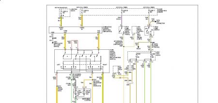

I replaced a 10 amp fuse in the fuse panel on the passenger side. I did nothing. Is there another fuse related to the turn signals under the steering wheel? which is it? how do i know if my relay is the problem?

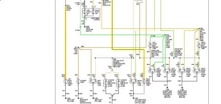

What about fuse no.19 15amp in the PDC if okay next step is the combo flasher test it/swap/replace it if okay it all boil downs to the turn and hazard switch and its not a ground problem.
