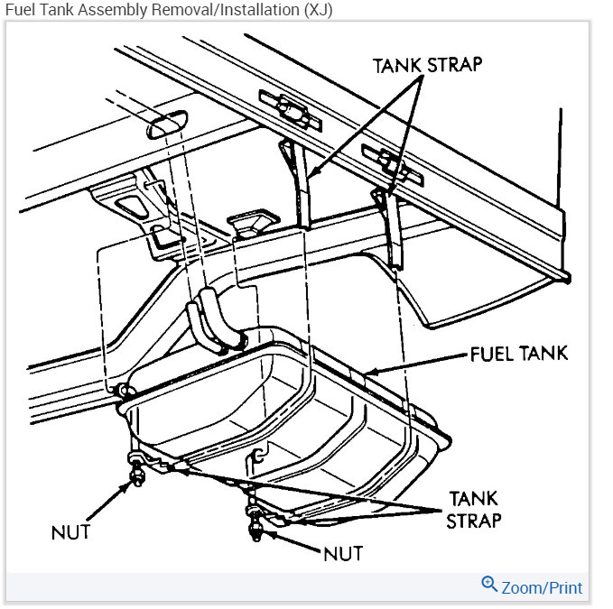

Hey there
I have a 1996 Jeep Cherokee SPORT. I can't seem to find where the FPR is located. Is it inside the tank with the fuel pump, and, if so can I replace the FPR without having to replace the new pump? The pump is only a couple of years old, but I didn't install it myself, so I don't know.
Jun 28, 2010 at 4:36 PM
SATURNTECH9
  • 30,869 POSTS

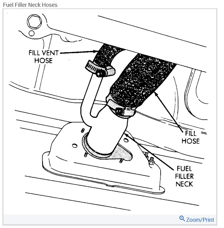

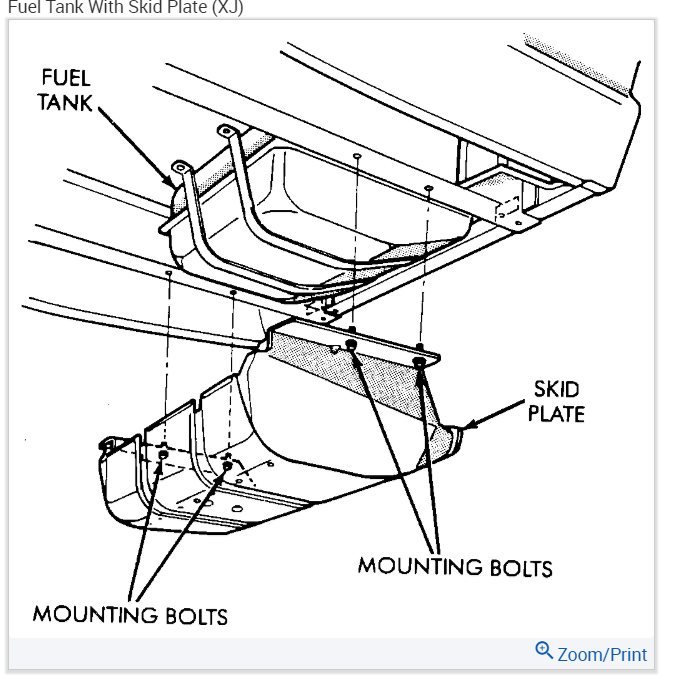

The Fuel Pressure Regulator can be replaced...it's located on the fuel pump assembly (in the tank), but can be replaced without purchasing a whole new pump assembly. Some say you can do this without taking the tank down but the manual says you do.
Here is a diagram to help show you how.
https://www.2carpros.com/articles/how-to-replace-an-electric-fuel-pump
Cheers
Jun 28, 2010 at 4:43 PM
JIMZER
Yep, thanks for the guide and diagram worked perfect I took the tank down though I can see that you can get your hands in there to do the job if you had too.
