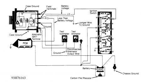

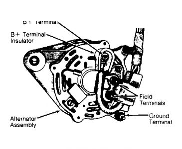

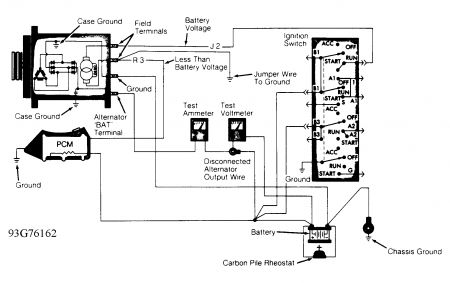

rebuilt alternator failed 4 times
is alternator internally regulated or ecu controlled
or broken wire where?
Aug 24, 2008 at 8:21 AM
MERLIN2021
  • 17,250 POSTS
Output Wire Resistance (Voltage Drop) Test 1. Ensure battery is charged. Turn ignition off. Disconnect negative battery cable. Connect a 0-150 DC ammeter and a voltmeter (0-18 volts) to vehicle's charging system. See Fig. 1 . 2. Connect a carbon pile rheostat between battery terminals. Ensure carbon pile is in OFF position before connecting leads. 3. Connect one end of jumper wire to ground and other end to alternator field terminal Dark Green wire on rear side of alternator. See Fig. 2 . Connect negative battery cable. 4. Start engine. Reduce engine speed to idle. Adjust engine speed and carbon pile to maintain 20- amp current flow. Observe voltmeter reading. Voltage drop should be .5 volt or less. 5. If voltage drop is greater than .5 volt, inspect, clean and tighten all connections between alternator BAT (B+) terminal and positive battery post. If wire resistance (voltage drop) is okay, test is complete. Remove all test equipment. CAUTION: Alternator has 2 field terminals. In step 3), DO NOT connect jumper wire to alternator field terminal Dark Green/Orange wire. Page 1 of 1 ALTERNATOR - NIPPONDENSO -1993 Jeep Cherokee
https://images.2carpros.com/forum/automotive_pictures/62217_Jeepa_1.jpg
https://images.2carpros.com/forum/automotive_pictures/62217_Jeepb_1.jpg
https://images.2carpros.com/forum/automotive_pictures/62217_Jeepc_1.jpg
https://images.2carpros.com/forum/automotive_pictures/62217_jeepd_1.jpg
Is your check engine light on? If yes turn the key from off to on three times, on the fourth one leave it in the on position, count the flasshes...22 would flash as 2 blinks, then a short puase, then 2 more blinks...if several codes are stored, the pause is longer between codes, code 55 will be the last code...do this and post all codes found...

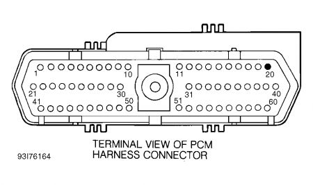

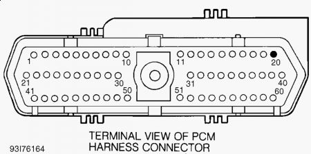

This is for the 93 Jeep, I will aslo look up the car But I need the model? TEST CH-2, ALTERNATOR FIELD NOT SWITCHING PROPERLY (CODE 41 ) 1. Put DRB-II in voltmeter mode. Check voltage of Automatic Shutdown (ASD) circuit by probing Dark Green/Orange wire (Dark Green/Black wire on Grand Cherokee and Grand Wagoneer) at back of alternator. If voltage is less than 10 volts, repair open circuit from ignition switch. If voltage is 10 volts or greater. go to next step. 2. Check voltage of alternator field driver circuit by probing Dark Green wire at back of alternator. If voltage is less than 10 volts, go to next step. If voltage is 10 volts or greater, go to step 6). 3. Turn ignition off. Disconnect and inspect PCM connector. Repair, if necessary. Disconnect alternator harness from back of alternator. Using an external ohmmeter, check field driver circuit (Dark Green wire) for resistance. If resistance is less than 5.0 ohms, replace PCM. If resistance is 5.0 ohms or greater, repair open in Dark Green wire. 4. Turn ignition off. Disconnect PCM connector. Disconnect alternator harness from back of alternator. Using an external ohmmeter, check for resistance between alternator field terminals. If resistance is 5.0 ohms or greater, replace alternator. If resistance is less than 5.0 ohms, go to next step. 5. With DRB-II in ohmmeter mode, check resistance in field circuit of alternator harness. If resistance is 5.0 ohms or greater, repair short to ground in field driver circuit (Dark Green wire). If resistance is less than 5.0 ohms, replace PCM. 6. Turn ignition off. Disconnect PCM connector. Disconnect alternator harness from back of alternator. Using an external ohmmeter, check for resistance in field driver circuit alternator harness terminal and cavity No. 20 on PCM connector. See Fig. 4 . If resistance is 5.0 ohms or greater, repair short to ground in field driver circuit (Dark Green wire). If resistance is less than 5.0 ohms, replace PCM. Perform CHARGING VERIFICATION (CH-VER) test. NOTE: Perform TEST CH-1, BATTERY CONDITION CHECK before proceeding.

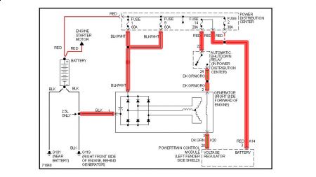

We have replaced the alternator and battery it worked fine for a few days then voltage kept dropping and going back up again now will not go back up to get jeep to start could it be the ECM?
Aug 11, 2020 at 11:26 AM (Merged)
  • 75,988 POSTS
Could be the PCM also check all the fuses
