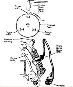

i have a jeep cherokee lerado, 89, 4.0, in line six. I has developed an intermitting problem where we are not getting spark from the coil. The coil ohms out as being good and the i.C.M. (Ignition control module) has been tested several times and has checked out good. It turns over but doesnot want to start. Please help me figure this out can anyone tell me what this problem is and how I can fix it?Thank you for your time and consideration.

Change the crank position sensor
Or they called it on the 89 jeep engine speed sensor
Located in the bell housing back of the engine
Here a picture
Good luck
https://www.2carpros.com/forum/automotive_pictures/99387_jeep_2.jpg
