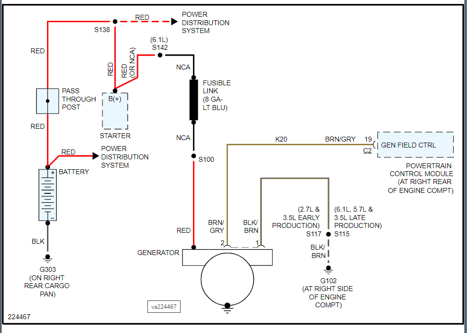

Converting to 70's electronic regulator, is there a way to wire it so the battery light will go out?
Also when engine is off I have one wire hot in the pig tail. I think both should have no voltage until key is in run position right. Tested unplugged.
Sep 21, 2021 at 3:05 PM

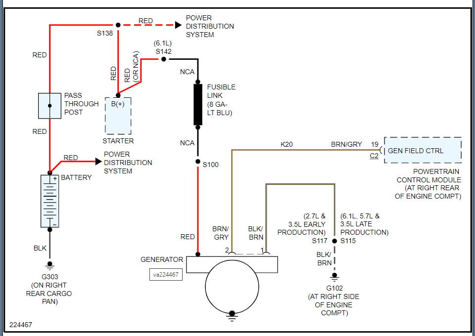

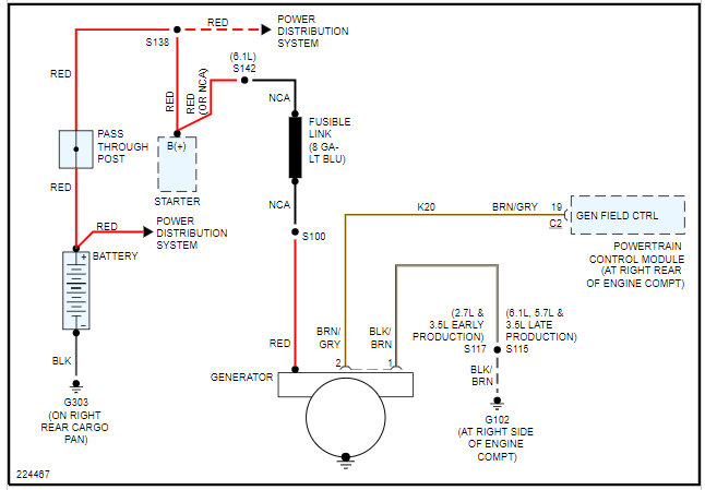

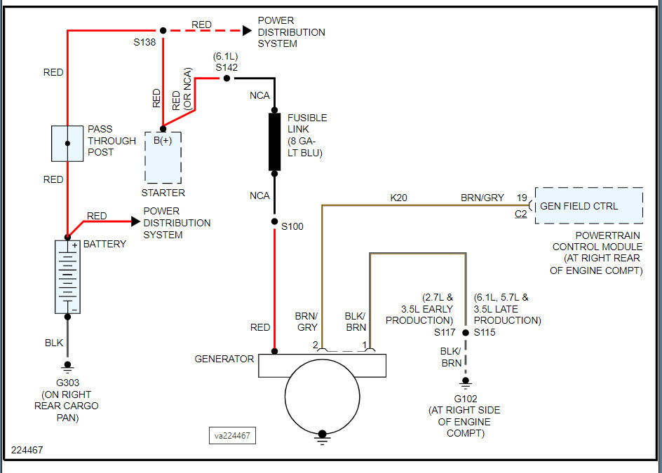

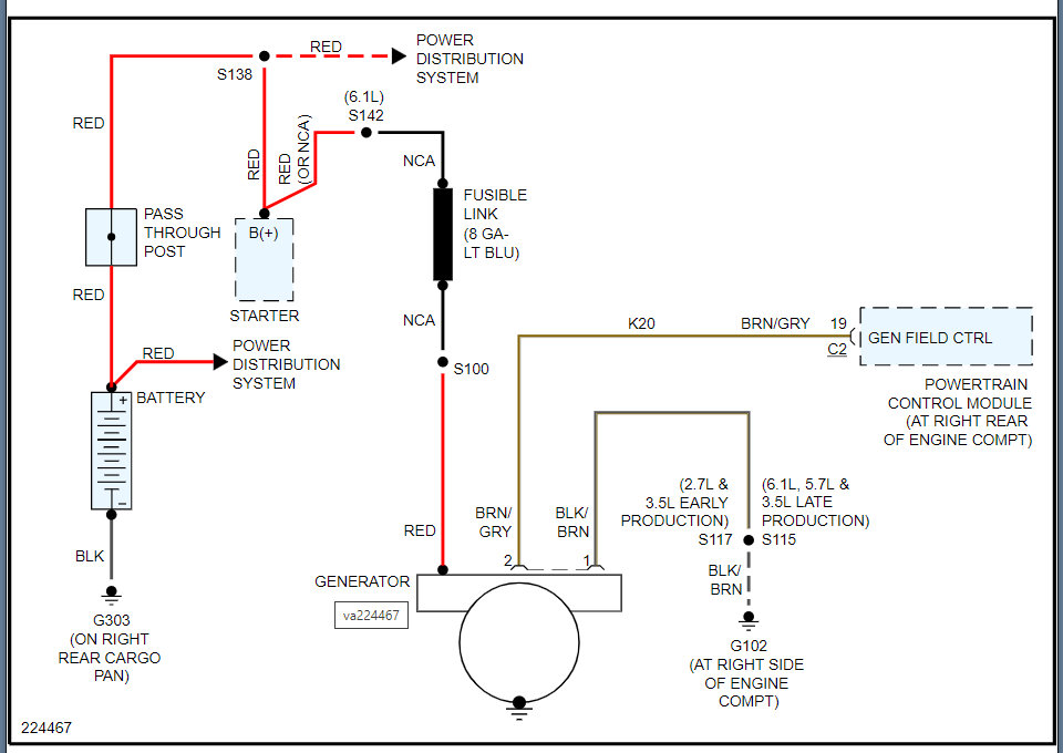

Couple things. First, I suspect the wire that is getting hot is the one from the PCM? See the wiring diagram below.
If this is the case, I have seen this a number of times. The alternators are failing because the driver (field control) in the PCM is shorted and causes the alternator to fail and even to cause the wiring to melt.
The solution to this is to replace the PCM and alternator if it is failed.
Also, if the wiring is damaged then it needs to be replaced as well.
Even if you change to the older style alternator this will be an issue until it is fixed. So I would suggest just repairing this and go with the OEM alternator.
Please see the wiring diagram below and let me know what questions you have.

If you did not have the alternator smoking issue until you replaced it with the used one then I suspect that PCM has the failed field control circuit.
This is very common on these. I would put the old PCM back on and see if the alternator has an issue. If not, then you are going to have to find another PCM.
Clearly if that PCM had the other engine code issues then you are going to still have those but that would be better short term then a smoking alternator.
Let me know what happens when you put the old PCM back and we can go from there. Thanks

At this point, we need to check the wiring. Sounds like we may have damaged some wiring along the way.

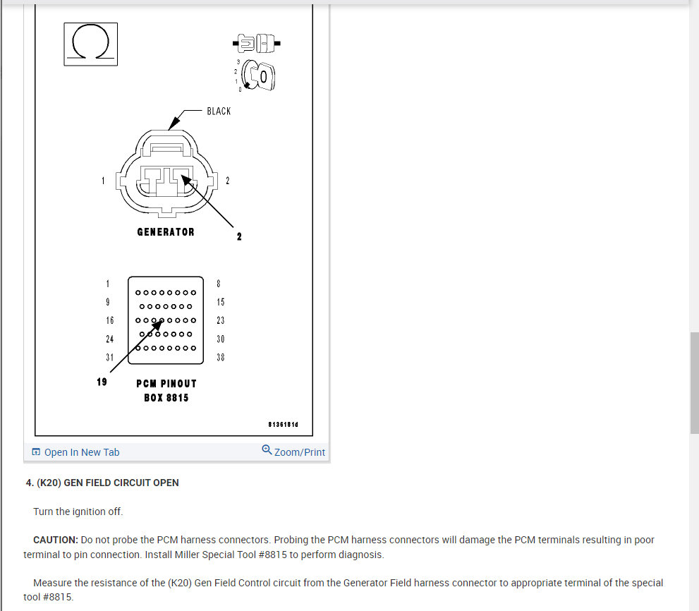

So we need to measure resistance on cable from the battery to the alternator.
The we need to check the ground and field control wire as well.
I am leaning towards a faulty ground but clearly we are missing something and that is most likely the wiring.
Unhook them at both ends and measure ohms.
Sep 23, 2021 at 7:13 PM

Unhooked at both ends. Black/brown wire 4 ohms.
The brown/gray wire is nothing. Skinned back at PCM white center wire plug in, and tested to second pin from left bottom corner with pin holes facing me (latch is center top). Continuity at this short distance but nothing at alternator end.
Sep 24, 2021 at 11:54 AM

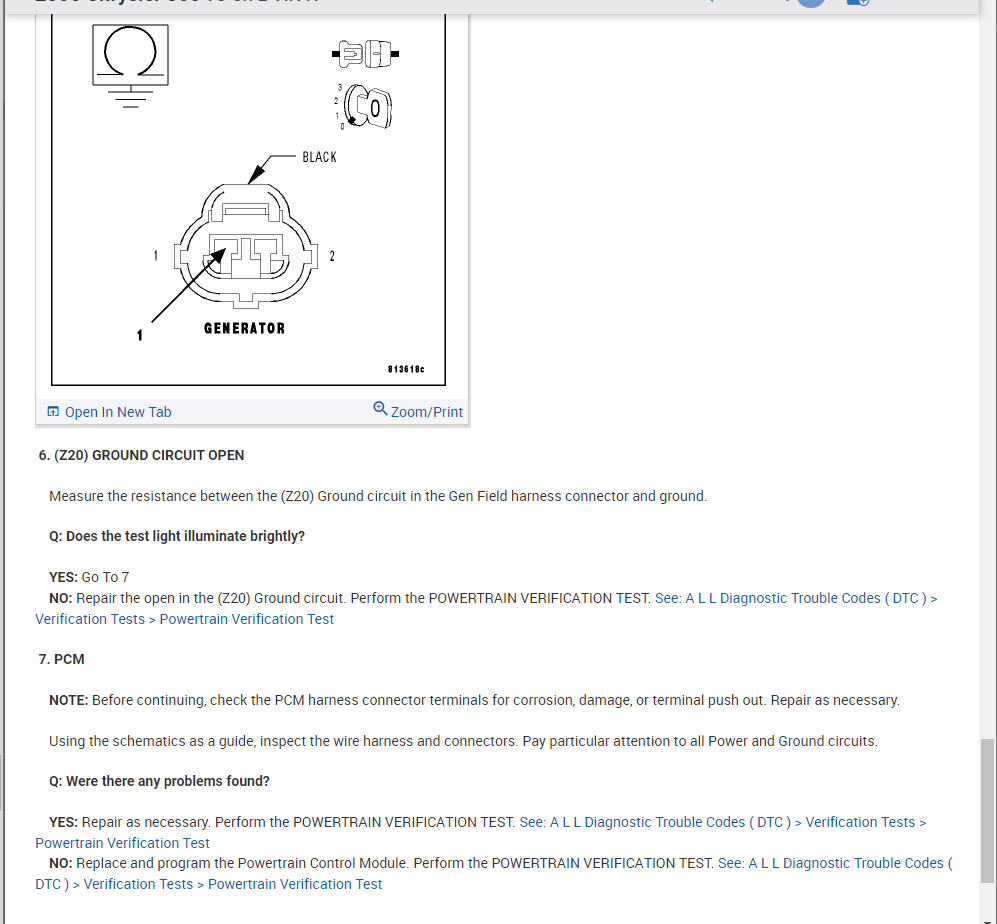

The black brown wire is the ground wire so you have 4 ohms or you have 4 tenths of an ohm?
If you have 4 ohms on your ground wire then that is the issue.
However, can you set your meter up and try to get a picture of how you are testing this because I am not sure I am understanding?
Also, the other wires when testing from end to end, you should have a less then a half ohm. Your meter may show 0 ohms which is ok but if it shows OL or something very high then that is an issue.

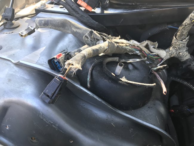

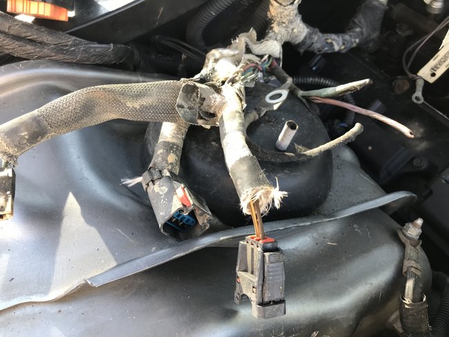

Found this at the starter.
Sep 26, 2021 at 3:18 PM
SSOTORPS
  • 14 POSTS
Another view.
Sep 26, 2021 at 3:19 PM
SSOTORPS
  • 14 POSTS
Those are 2 views of wire from alternator to the starter. There it is bolted on top of the three way battery harness which bolts to the starter also, at the bulkhead coming through the passenger floorboard, and also to the front power distribution box front right fender.
All battery cables ohm out .04 to .06 except for the one in the photo.
The black/brown wire at alt is .06 ohms.
The brown/grey wire at alt (field) is .034.
Sep 26, 2021 at 3:27 PM

Wow. Great find.
Clearly the priority is to fix those wires. Then to find out if the alternator is okay, we just need to test it again. Most parts stores can do this free of charge. Here is a guide that will show this type of testing:
Let us know what you find with this. Thanks for the updates so far.

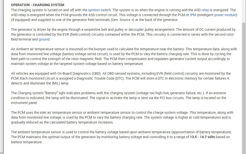

Okay. So, this sounds like we have more to this at this point. The alternator does not appear to be charging so that may not be the alternator at this point. It may be the PCM due to all the codes you have.
Let's start with two things. First what are all the codes that you are getting? I don't need the steering code just all the ones related to the PCM.

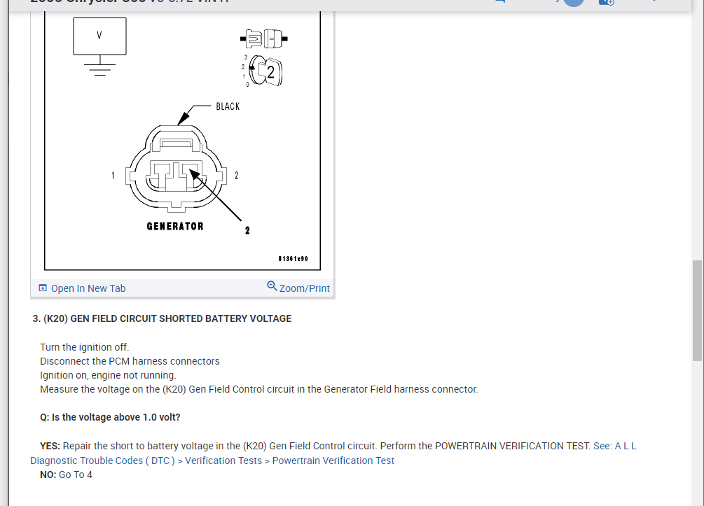

Next, we need to check the voltage at the alternator on the brown/gray wire coming from the PCM when the vehicle is running.

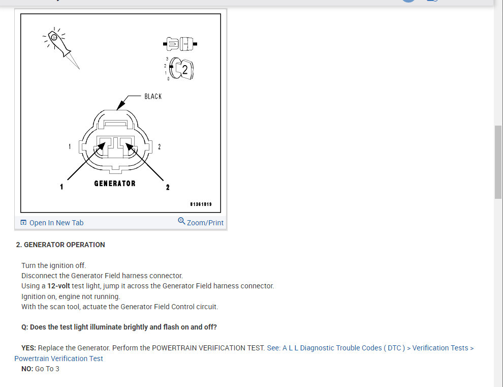

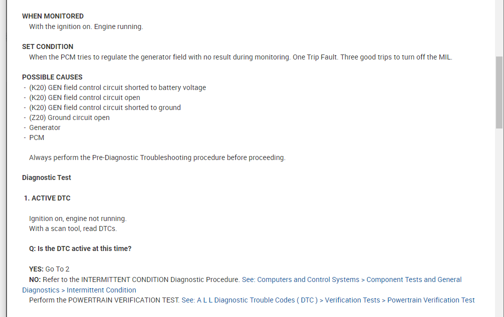

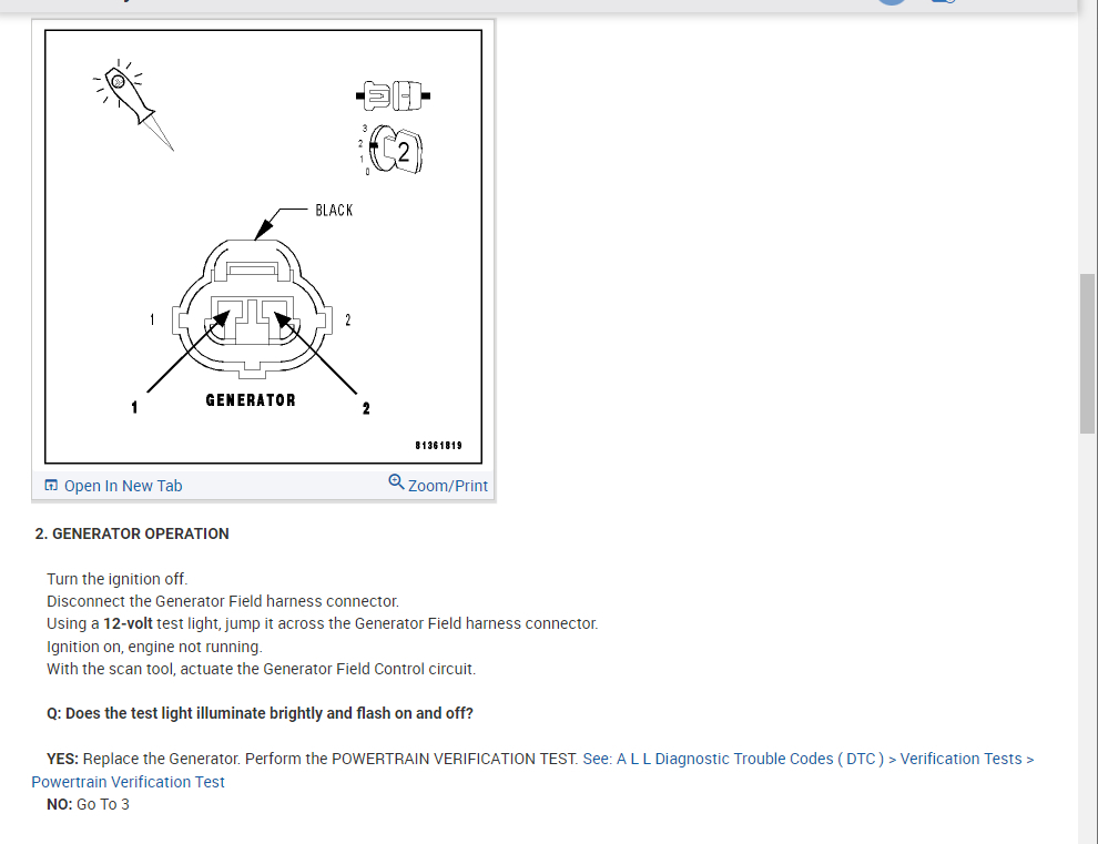

Okay. Just to be clear, the alternator is new again and it is producing 12 volts?
Basically, that is not turned on and you are just passing through the battery voltage.
Then all these U codes go away when you have a battery charger on the battery?

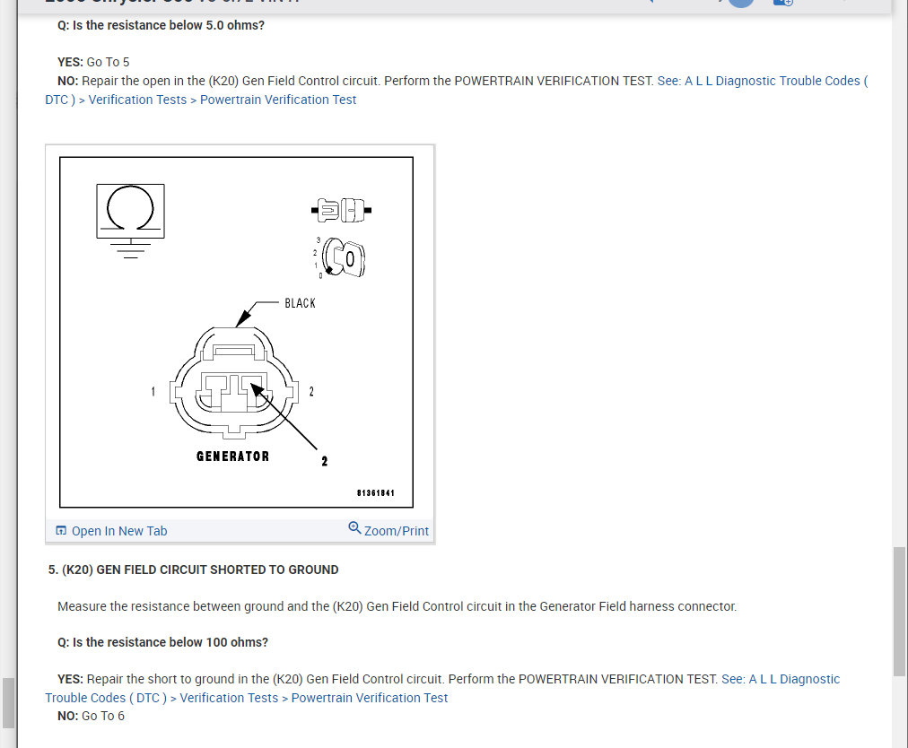

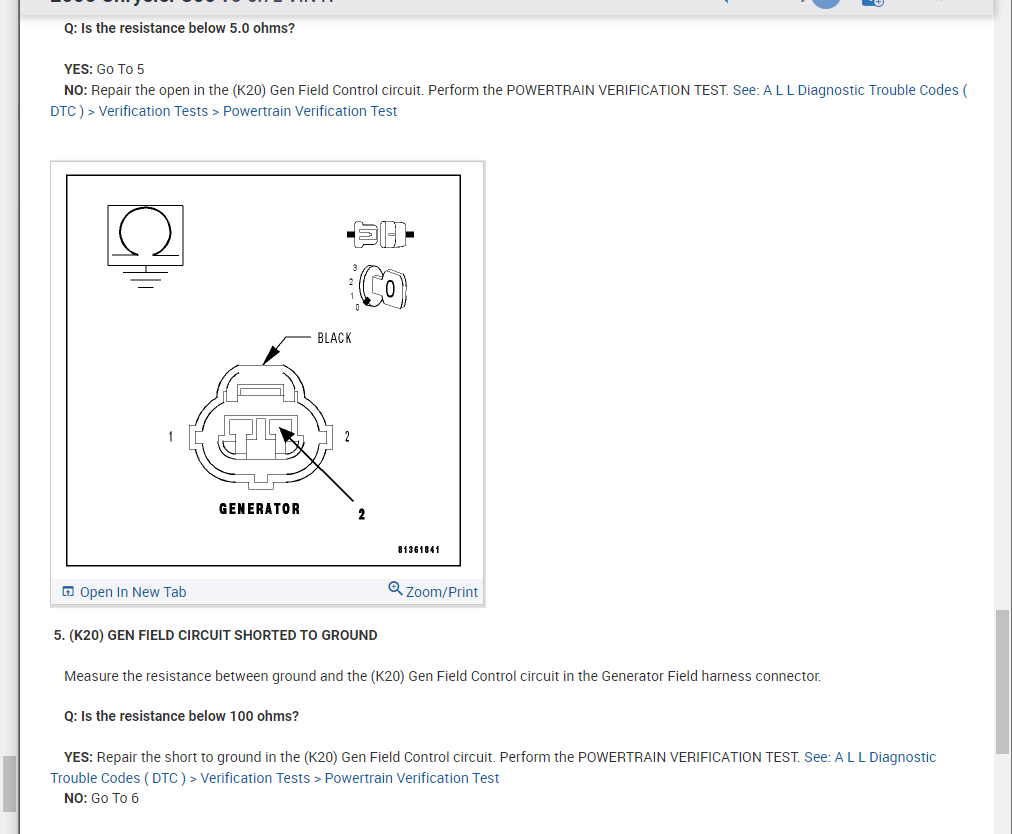

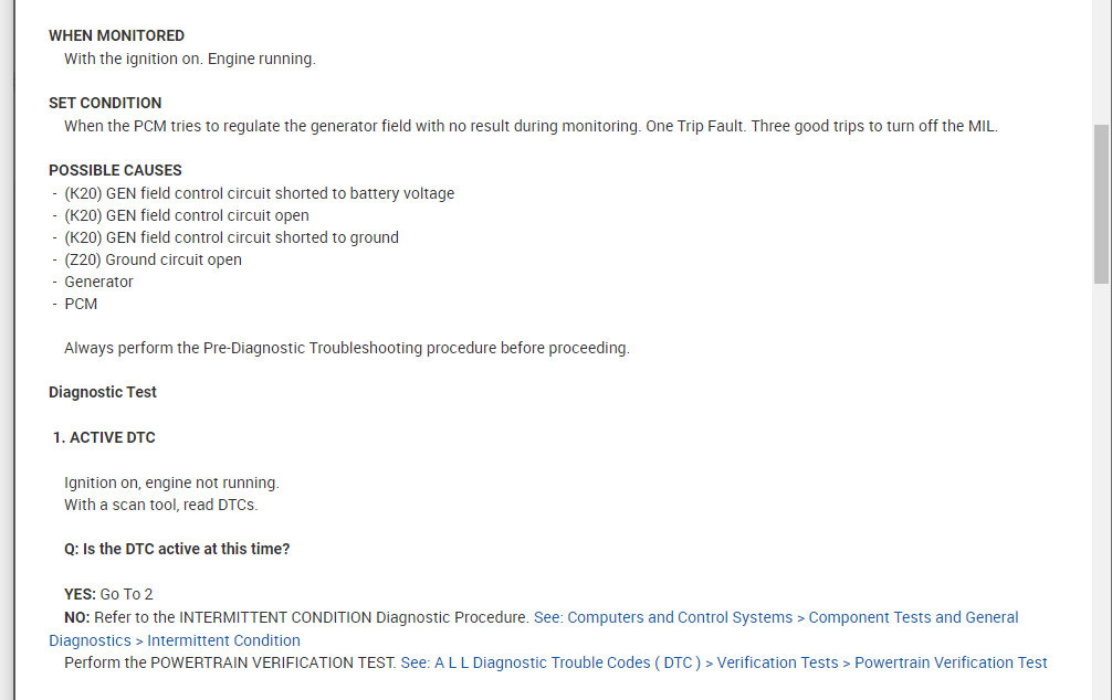

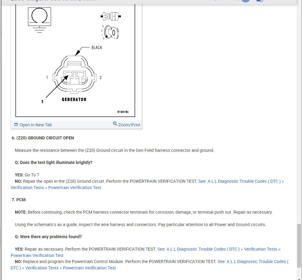

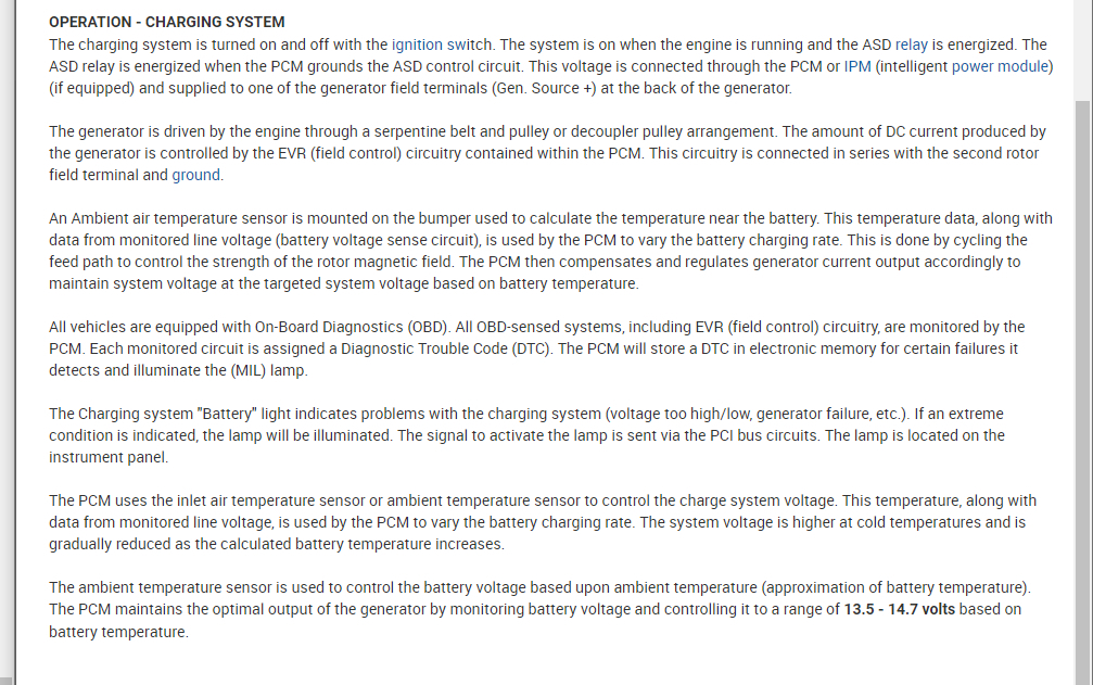

Lastly did the P0622 come in because you had the alternator unplugged? I attached the testing for this code but if you had the plug unhooked then that explains it as the generator sense circuit would be an open circuit.
However, no matter what I suspect your EVR in the PCM has failed so I would be sourcing a PCM but run through this testing if you want to confirm it further.
