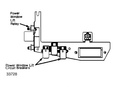

i just bought a 1986 jaguar xj6 and we drained all the fluids from it and got it running again but the windows wont roll down or up. my dad and i tested the motors on the windows by giving them power and they work fine, but i dont know if it is the switch or if there are other wires or what to do. i also cant find any car manuels in libraries or online on how this car works . please help thanks.[img:040647c3dc]http://www.2carpros.com/forum/automotive_pictures/510464_my_jag_1.jpg[/img:040647c3dc]

check the relays and circuit breakers Power Window Circuit Breaker...At door pillar.
https://images.2carpros.com/forum/automotive_pictures/266999_jag_99.jpg
