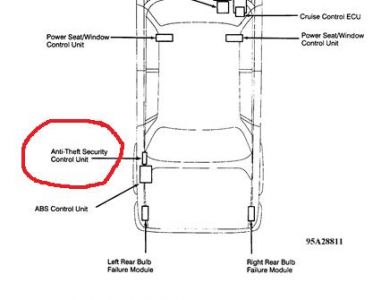

I had an issue with a sticking fuel door latch on a 1994 Jaguar XJ6. I lifted a white lever in the inside left of the trunk up by the fuel door. Don't know if it's related, but the car would not start, the dash lights would not come on, and the brak/shifter link would not work. It was running fine up to that time. Battery is fine, even tried connecting jumpers to another car. No luck. Tried removing, checking and replacing fuses, no luck. Any thoughts?

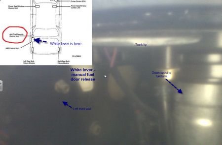

Hello .. thanks for the donation .. much appreciated. Not sure of any white lever inside left of trunk ? .. is it possible you could supply a photograph ? .. or supply more details of this lever ... the security control unit is up in left side of trunk and also an inclination sensor ?

Here is a picture of the white lever - it is the manual fuel door release.

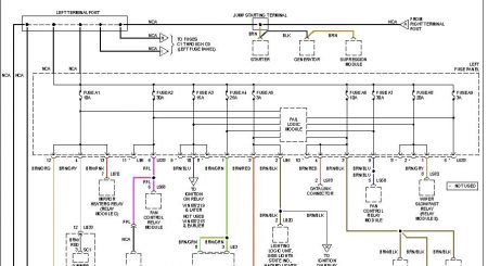

I checked the fuse block on the lwer left fotwell. It seems there is no current to the lower left fuses. I removed the block and cleaned with electrical cleaner - still no current.

The fuse box gets it's hot/live feed direct from the battery !
