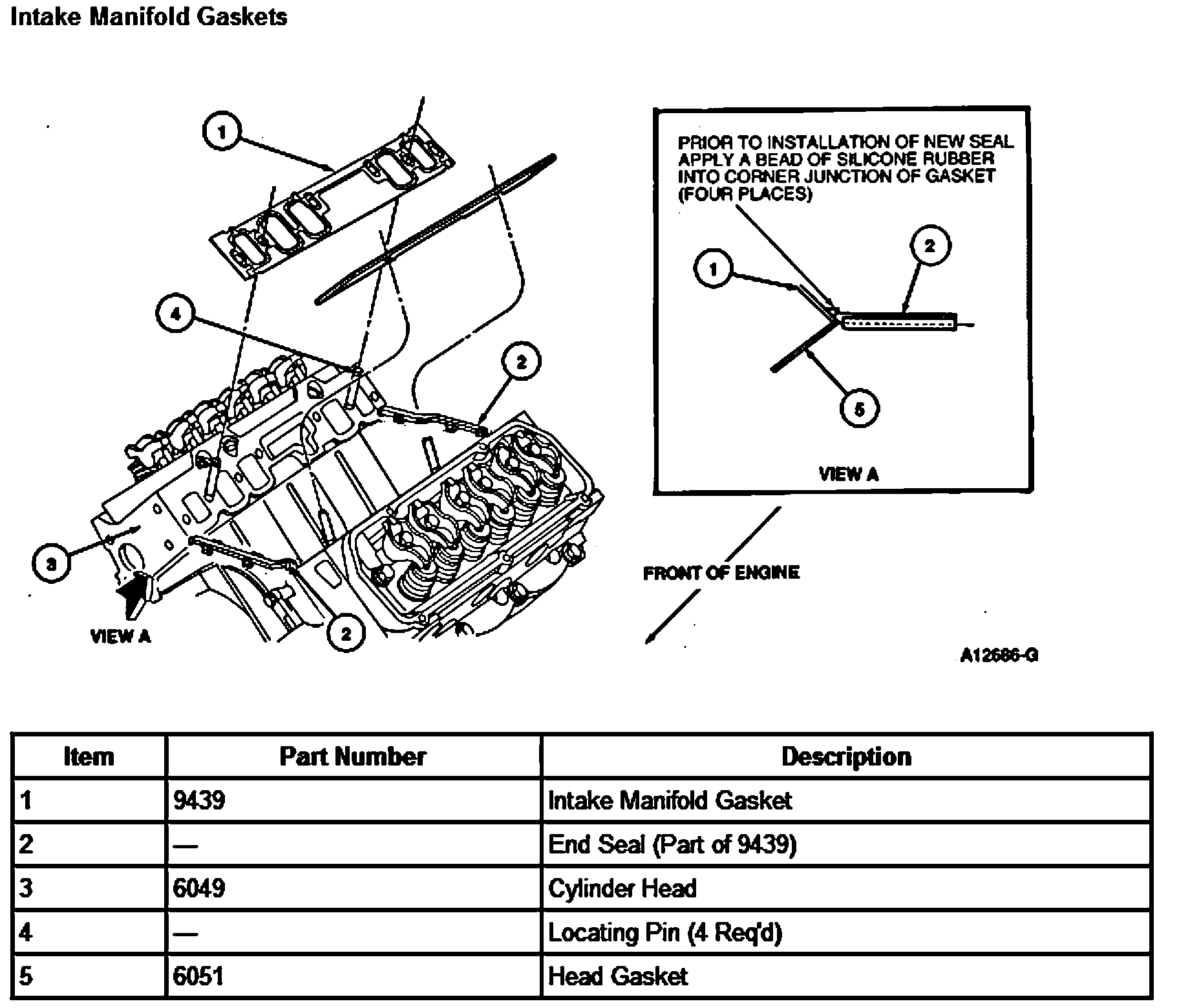

So I just redid the headgaskets on my mustang gt I used the correct torque pattern and specks I used felpro head gaskets and and new head bolts I had the heads serfaced but I just started it up and looked under it and there is oil runing down the exhast manifold and it looks like chocolate milk and shur enough my engine coolent and oil are mixing and mixing on the ground too.
What did I do wrong was I supost to put the gaskets on with some type of sealent cause I put them on dry. Nothing is being burned out the exhast pipe if I haft to redo that head gasket will I need to replace thehead bolts for the 3rd time?

  • 109,755 POSTS
It sounds like the head gasket is bad. Is there evidence of coolant mixing with the engine oil? It will have a tan creamy appearance. Take a look through this link. It explains how to check for a bad head gasket. You will see pics of what I'm referring to.
If there is coolant mixed, it's likely that the bearings were damaged. When it is now running, is there any knocking or ticking from the engine?

1. Prepare cylinder head components as follows:
a. Lightly oil all bolts and stud bolt threads before installation, except those specifying special sealant.
b. Clean cylinder head, intake manifold, rocker arm cover and head gasket surfaces. If cylinder head was removed for head gasket replacement, check flatness of cylinder head and cylinder block gasket surfaces.

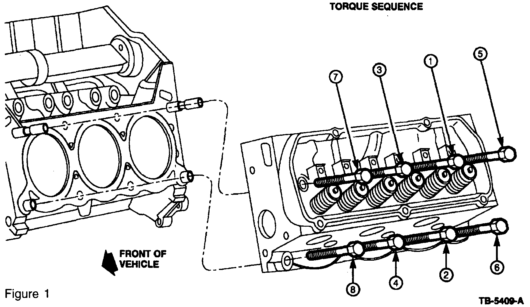

2. Position new head gasket(s) onto cylinder block using dowels for alignment, then position cylinder heads onto cylinder block.

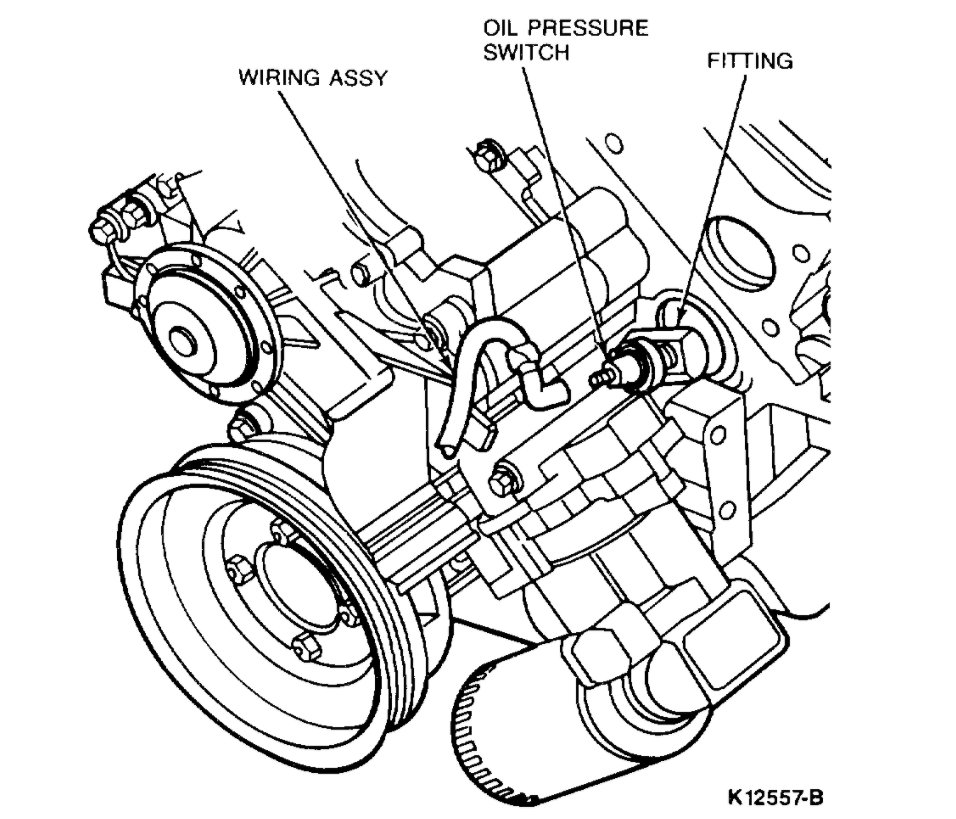

FWD 3.8L
pic 1
3. Reassemble and tighten the new head bolts to the following specifications:
Tighten all bolts in numerical sequence, as shown, in three steps as follows:
- 20 Nm (15 lb-ft)
- 40 Nm (30 lb-ft)
- 50 Nm (37 lb-ft)
Caution: Do not loosen all of the bolts at the same time. Work on one bolt at a time in the sequence shown. Failure to loosen bolts in proper sequence could cause cylinder head to warp.

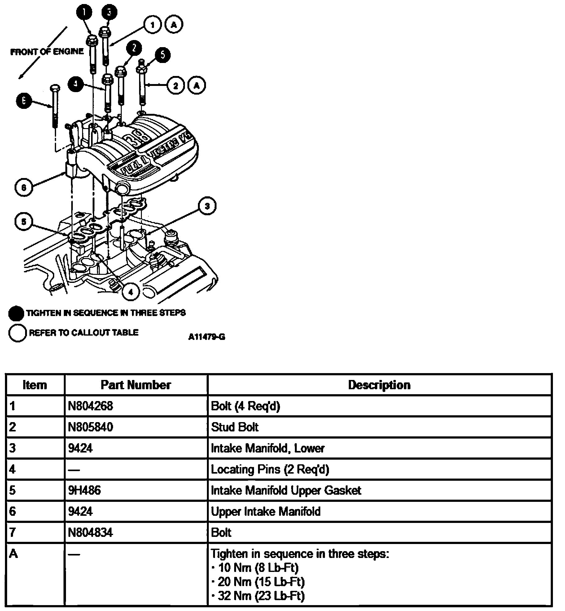

1996 Ford Mustang V6-232 3.8L
Upper
Vehicle Engine, Cooling and Exhaust Engine Intake Manifold Service and Repair Procedures Upper
UPPER
Removal
1. Remove air cleaner outlet tube (9B659).
2. Disconnect accelerator cable (9A758) at throttle body (9E926). Disconnect speed control actuator cable (9A825) (if equipped).
3. Remove retaining bolts from oil pressure gauge (9273) and position cables aside.
4. Disconnect vacuum lines at upper intake manifold (9424).
5. Disconnect necessary electrical connectors.
6. Disconnect crankcase ventilation tube (6758) at the upper intake manifold and at positive crankcase ventilation valve (PCV valve) (6A666).
7. Remove throttle body if necessary.
8. Remove the EGR valve (EGR valve) (9D475) from the upper intake manifold.
9. Remove the nut and bolt retaining engine support and wiring retainer bracket located at the LH front of the intake manifold and set aside with ignition wires.
10. Remove upper intake manifold retaining bolts/studs.

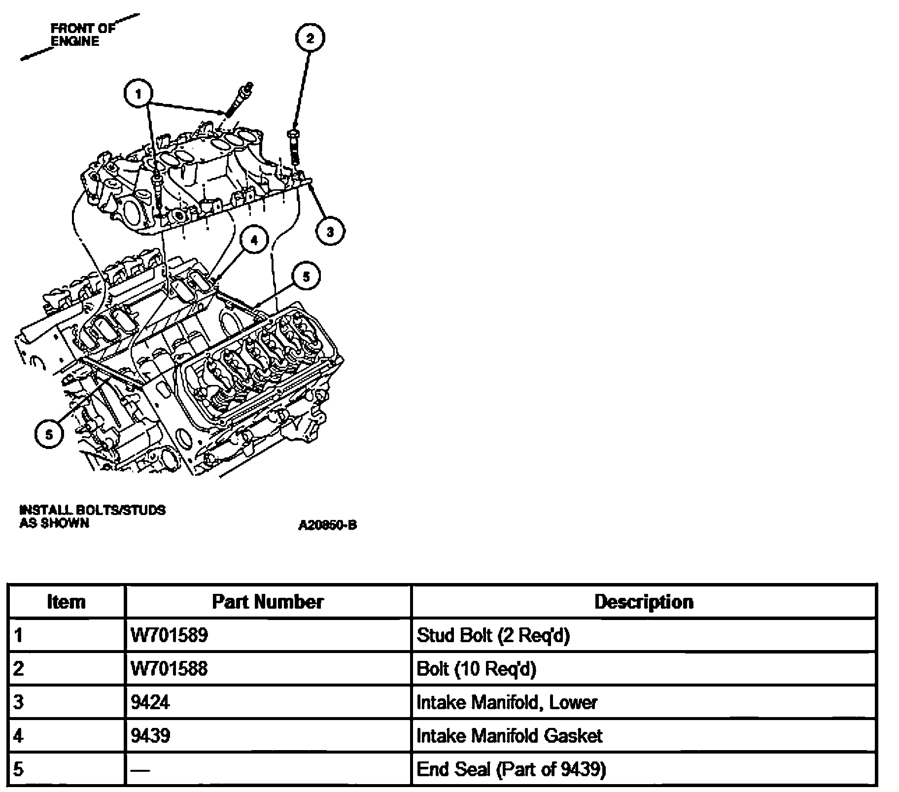

pic 2
11. Remove upper intake manifold and intake manifold upper gasket (9H486).

1. Position new intake manifold upper gasket and upper intake manifold on top of lower intake manifold.
NOTE: Apply a light coat of Pipe Sealant with Teflon D8AZ-19554-A or equivalent meeting Ford specification WSK-M2G350-A2 and ESR-M18P7-A to retaining bolts and stud bolt threads prior to installation.
2. Install bolts and stud bolts in original locations.
Tighten in sequence as shown under Removal Step 11, in three steps:

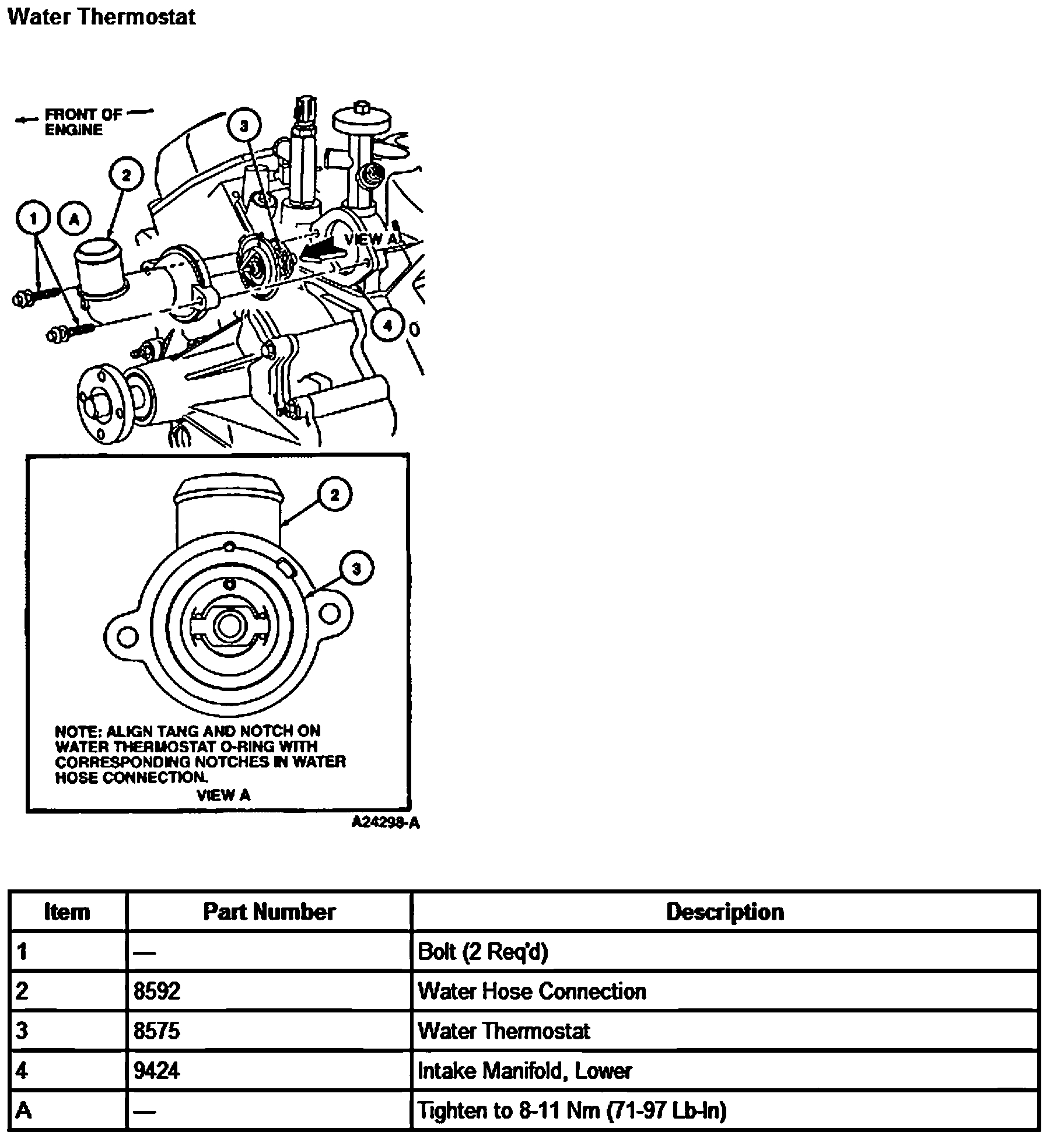

- 10 Nm (8 Lb-Ft)
- 20 Nm (15 Lb-Ft)
- 32 Nm (23 Lb-Ft)
3. Install engine support and wiring bracket and retaining nut and bolt to LH front of the upper intake manifold. Tighten retainers to 20-30 Nm (15-22 lb-ft).
4. Install the EGR valve.

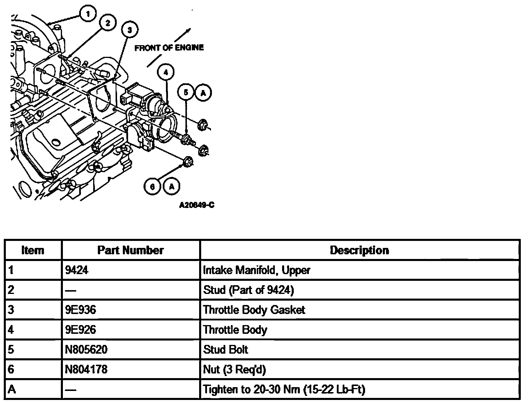

pic 3
5. Install new throttle body gasket (TB gasket) (9E936), throttle body if removed. Cross-tighten retaining nuts to 20-30 Nm (15-22 lb-ft).

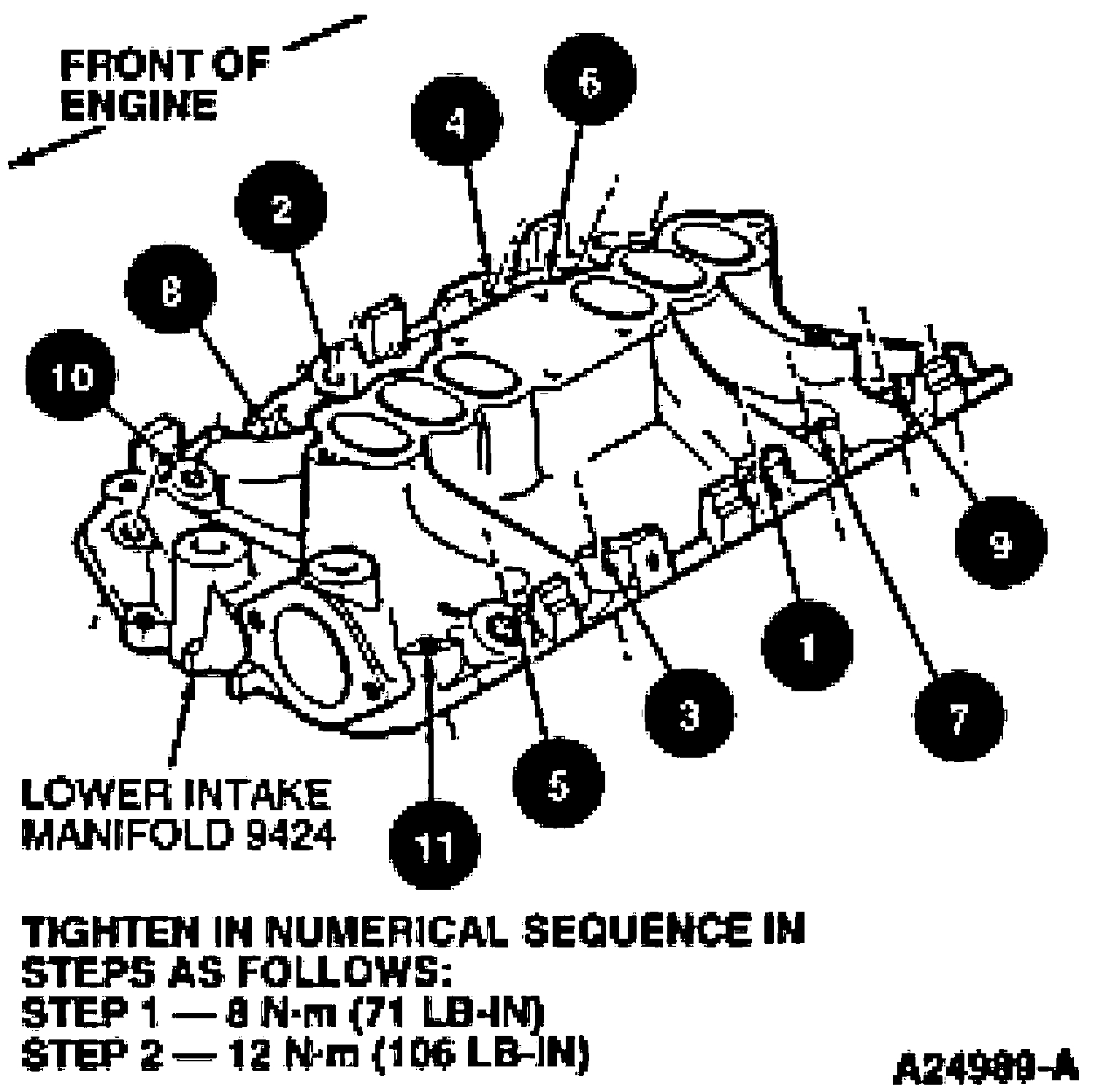

Here are the lower intake directions.
Lower
Vehicle Engine, Cooling and Exhaust Engine Intake Manifold Service and Repair Procedures Lower
LOWER
Removal
1. Drain engine cooling system.
2. Remove upper intake manifold as outlined.

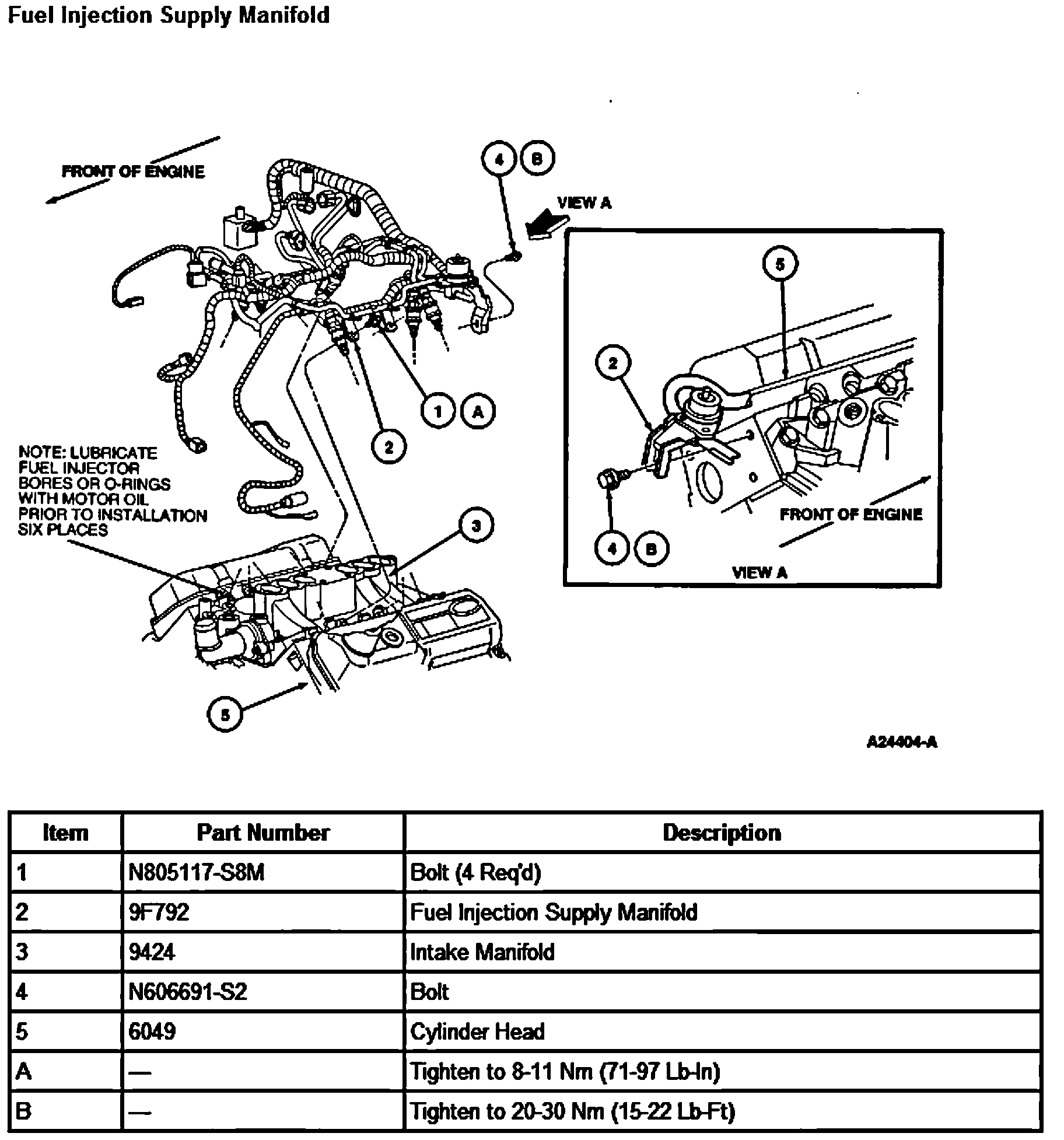

pic 4
3. Remove fuel injectors (9F593) and fuel injection supply manifold (9F792).
4. Remove heater water outlet hose.
5. Remove lower intake manifold retaining bolts/studs.
CAUTION: The lower intake manifold is sealed at each end with silicone sealer. To break the seal, it may be necessary to pry on the front of the lower intake manifold with a prybar. If it is necessary to pry on the lower intake manifold, use care to prevent damage to machined surfaces.
6. Remove lower intake manifold.
7. Remove and discard intake manifold gaskets (9439) and end seals.
pic 5

b. Install clutch pressure plate (note direction) and water thermostat. Install water hose connection (8592). Tighten retaining bolts to 8-11 Nm (71-97 lb-in).

3. Apply a 3-4 mm (0.125 inch) bead of Silicone Rubber D6AZ-19562-AA (clear) or equivalent meeting Ford specifications ESB-M4G92-A and ESE-M4G195-A or F4AZ-19562-B (black) meeting Ford specification WSE-M4G323-A1 at each corner where the cylinder head joins the cylinder block (6010).
4. Install new front and rear intake manifold end seals.
pic 6
5. Install new intake manifold gaskets.
6. Carefully lower intake manifold into position on cylinder block and cylinder head. Use locating pins as necessary to guide lower intake manifold.
pic 7
7. Install bolts and stud bolt in their original locations.
pic 8
8. Tighten bolts and stud bolts in numerical sequence to the following specifications in two steps:
a. 8 Nm (71 lb-in).
b. 12 Nm (106 lb-in).

10. Install fuel injectors and fuel injection supply manifold. Tighten fuel injection supply manifold to lower intake manifold bolts to 8-11 Nm (71-97 lb-in). Tighten fuel pressure bracket bolt to 20-30 Nm (15-22 lb-ft).
