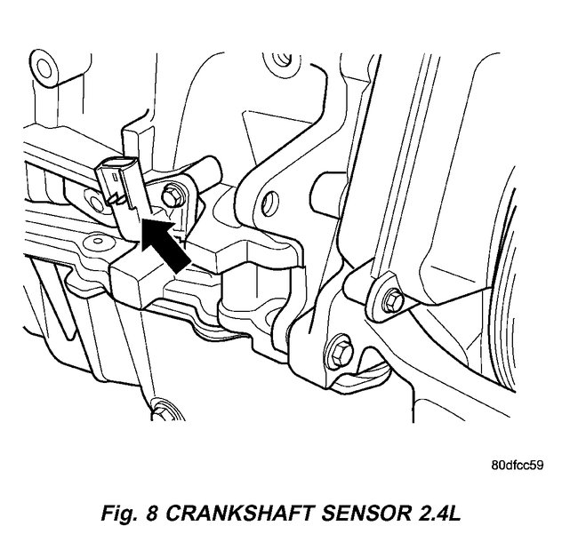

It keeps shutting off on when I'm driving it, but it shut off all by itself then I have to wait until thirty to forty five minutes. then start again sometimes drives for awhile then shuts off again.
Dec 13, 2018 at 8:13 AM
  • 110,248 POSTS
Hi and thanks for using 2carpros.com.
A crank no start can be caused by many things, however, you already identified there is no spark. My first suspect is the crankshaft position sensor. Take a look through this link:
Now, the easiest way for me to identify a bad crank sensor is by checking for an RPM signal with a live data scanner when the engine is cranking. If you don't have one, see if a parts stores will lend or rent one to you. Here is a quick video that shows how one is used:
https://youtu.be/b2IJGfImVvw
If you determine the sensor is bad, here is a link that shows in general how one is replaced.
Here are the directions specific to your vehicle for sensor replacement.

Fig. 8 Crankshaft Sensor 2.4L See pic 1

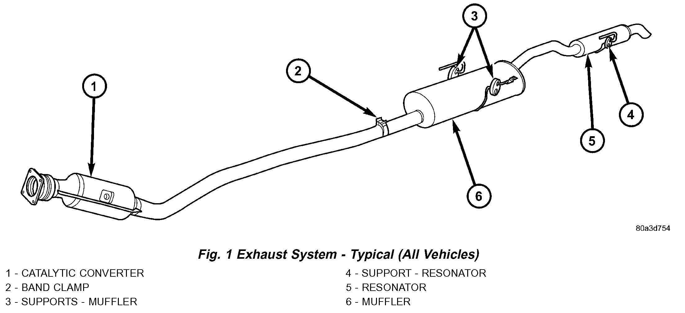

Car does start but if I don’t push the gas quick enough it shuts off and when it goes to idle it will for just a second and shuts off. Blows white smoke out the rear at times that smells horrible.

The sound I hear seems to be a loose catalytic converter. What happens is the insides come loose and then rattle like that. What I need you to do is take a rubber mallet and tap on the exhaust system to see if you can recreate the sound.
Take a look through this link.
I attached a picture that shows where the converter is located. I have a feeling internally it has come apart and is causing the noise and restriction of air flow. Thus, the poor running conditions and the smell you get.

Okay, so the muffler melted the back bumper and when idling sounds like a knock and keeps lien.

Also puddle of black fluid under car.

Does the black fluid evaporate if you let it sit? Does is seem like oil? Where is is aprox under the vehicle?
Also, have you tried following the link for checking a converter?
