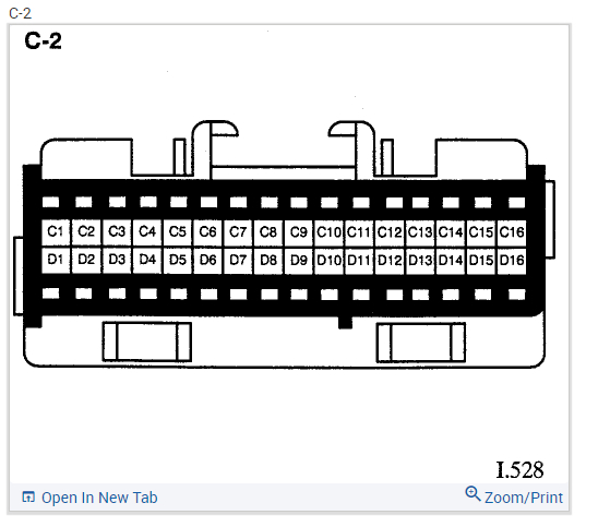

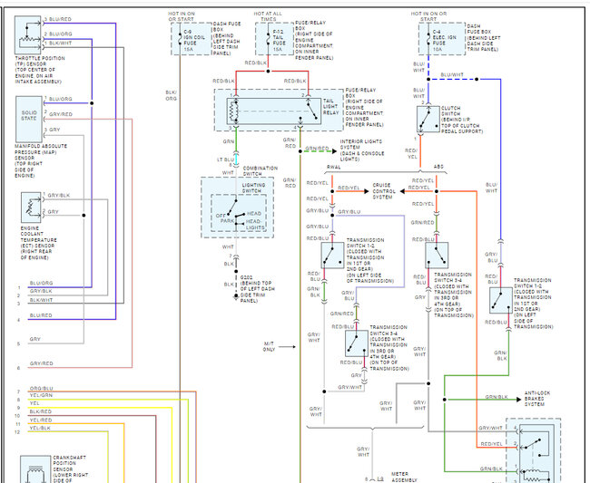

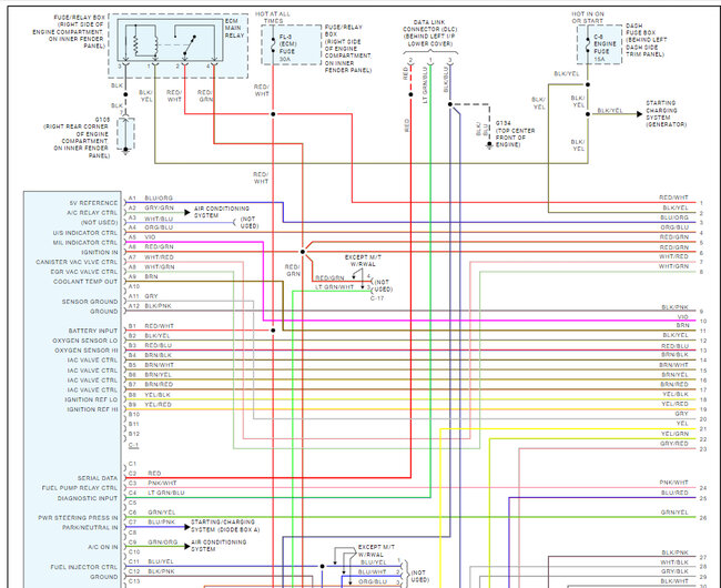

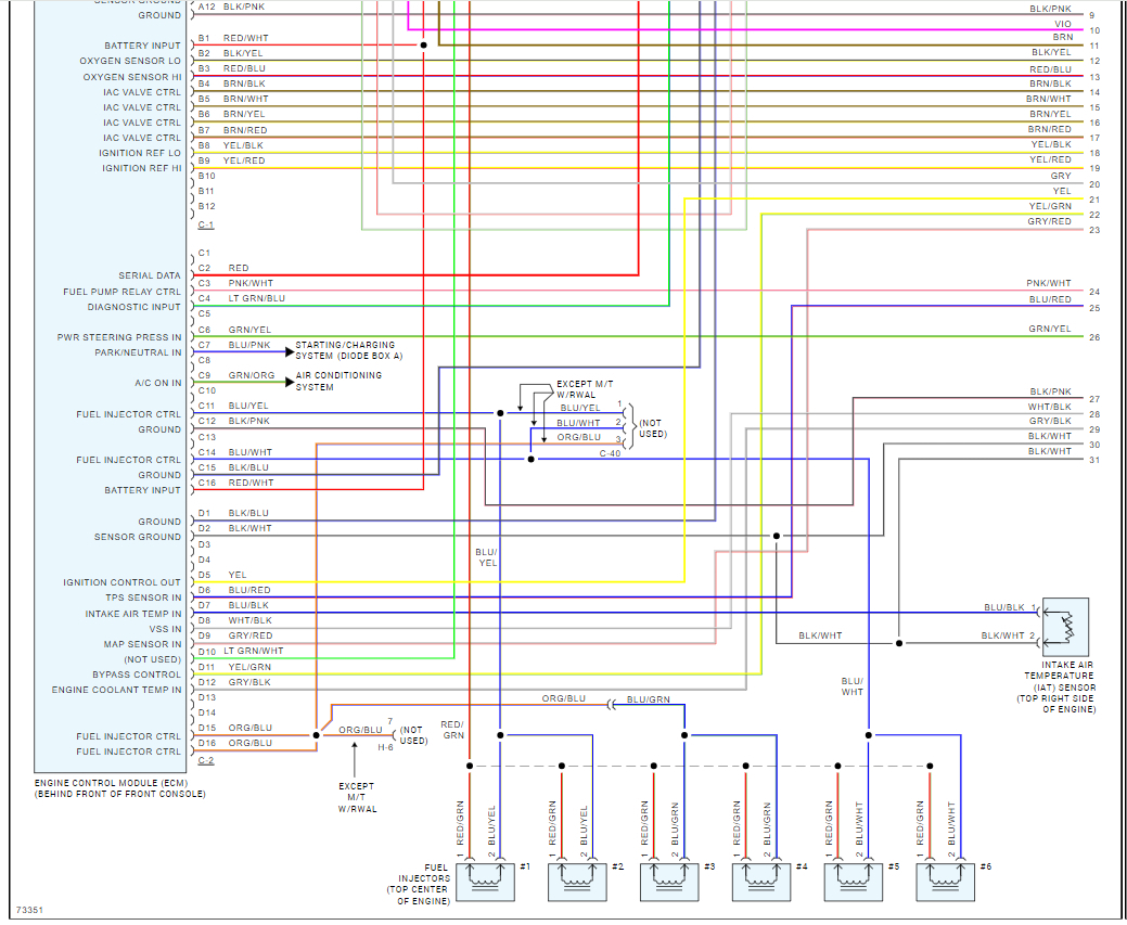

3.1 4jg2. Can someone please give me ECM pinout diagram? Thanks
Mar 5, 2021 at 10:30 PM
DAVEH429
  • 41 POSTS

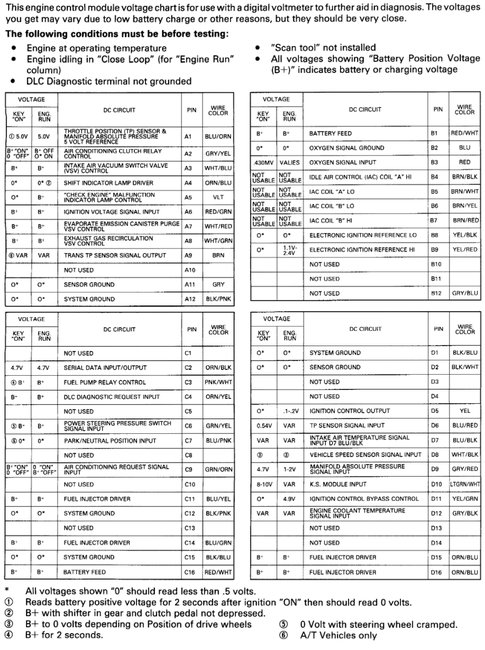

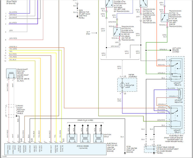

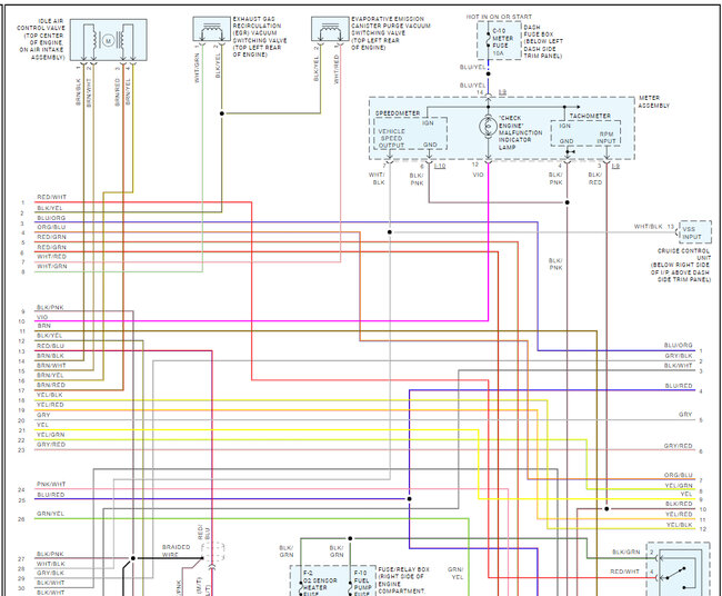

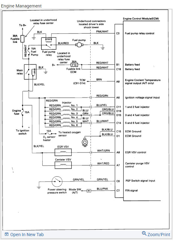

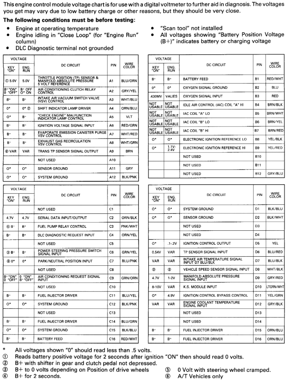

Have added the pin out in the diagrams below with identity diagram.
Hope this helps with your repair. Please keep us updated on your repair outcome and do not hesitate to contact us again for further information or assistance.
Thanks for using 2CarPros.
Dave ~H~
Mar 5, 2021 at 11:34 PM

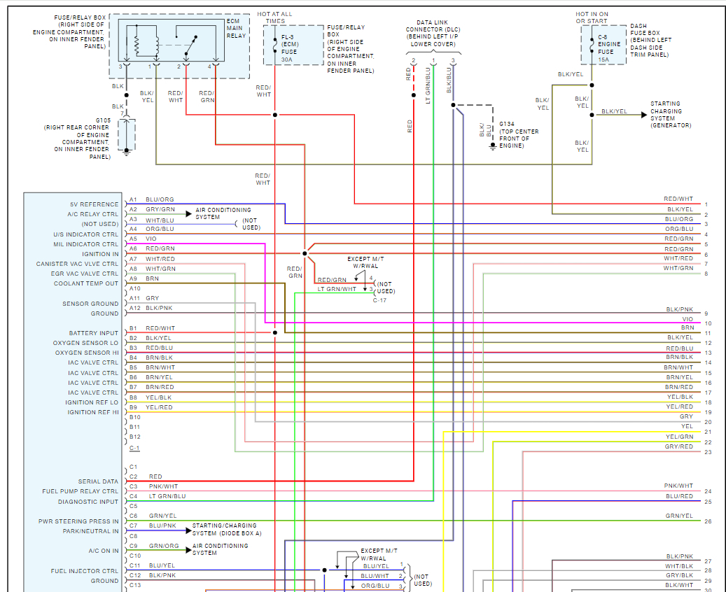

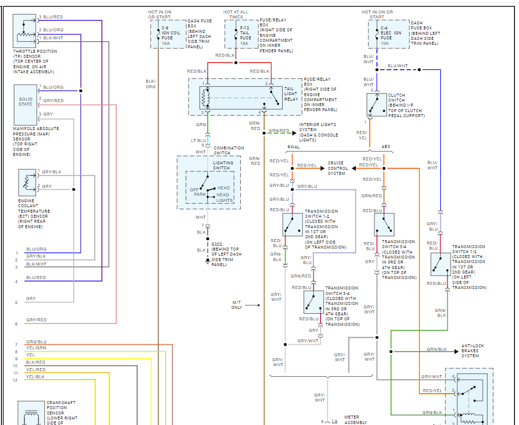

By the way sir, I have a 4 connector ECM for my 3.1 Trooper. Is this the same pinouts?
My trooper issue was MIL was missing. When ignition on, check engine lights wont show up. It cranks and fires up but it will shut off in 1 to 2 seconds.
Mar 6, 2021 at 1:52 PM
DAVEH429
  • 41 POSTS
Hello.

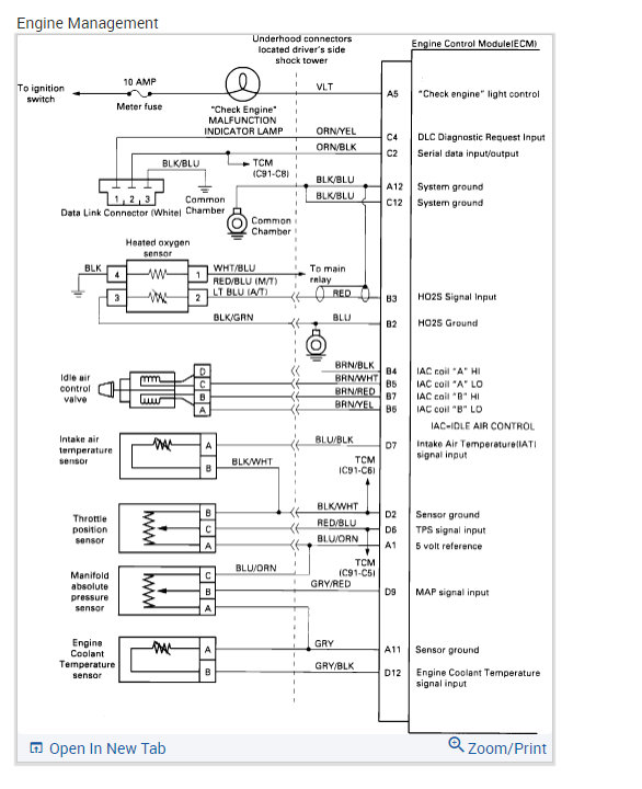

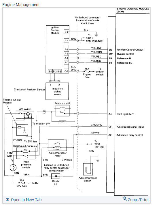

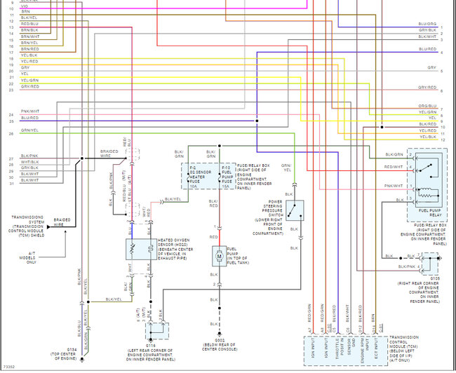

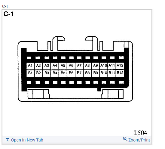

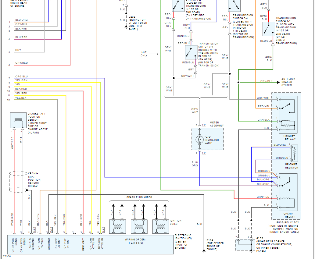

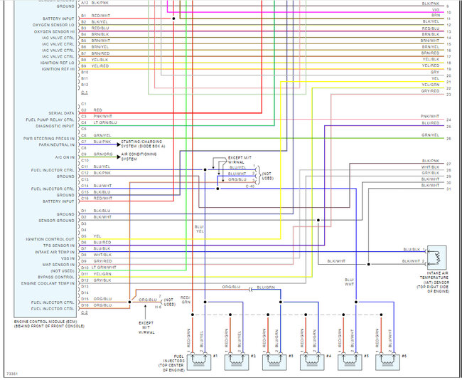

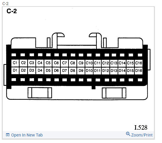

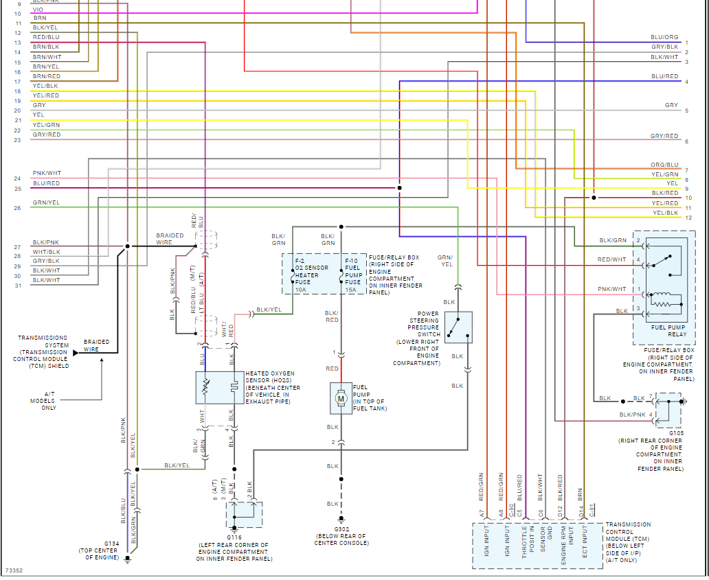

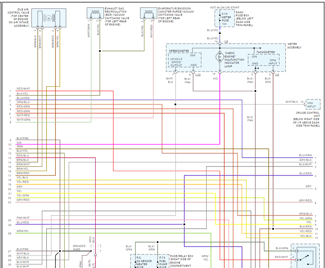

I only see the 2 connectors for the ecm and the pin outs should be the same, I have added some more diagrams that may help.

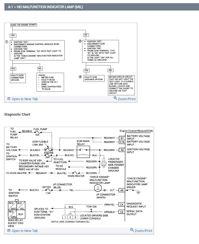

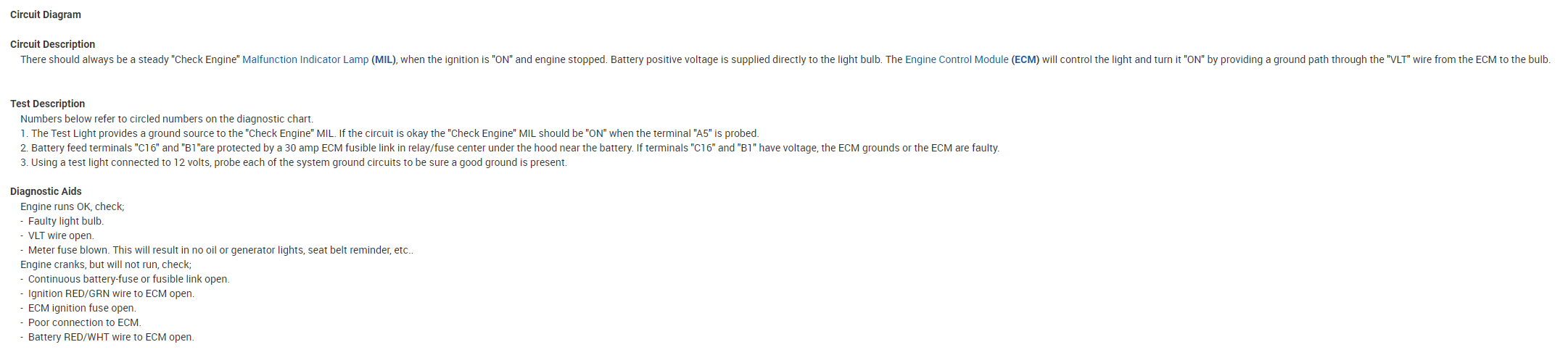

Circuit Diagram
Circuit Description
There should always be a steady "Check Engine" Malfunction Indicator Lamp (MIL), when the ignition is "ON" and engine stopped. Battery positive voltage is supplied directly to the light bulb. The Engine Control Module (ECM) will control the light and turn it "ON" by providing a ground path through the "VLT" wire from the ECM to the bulb.
Test Description
Numbers below refer to circled numbers on the diagnostic chart.
1. The Test Light provides a ground source to the "Check Engine" MIL. If the circuit is okay the "Check Engine" MIL should be "ON" when the terminal "A5" is probed.
2. Battery feed terminals "C16" and "B1"are protected by a 30 amp ECM fusible link in relay/fuse center under the hood near the battery. If terminals "C16" and "B1" have voltage, the ECM grounds or the ECM are faulty.
3. Using a test light connected to 12 volts, probe each of the system ground circuits to be sure a good ground is present.
Diagnostic Aids
Engine runs OK, check;
- Faulty light bulb.
- VLT wire open.
- Meter fuse blown. This will result in no oil or generator lights, seat belt reminder, etc..
Engine cranks, but will not run, check;
- Continuous battery-fuse or fusible link open.
- Ignition RED/GRN wire to ECM open.
- ECM ignition fuse open.
- Poor connection to ECM.
- Battery RED/WHT wire to ECM open.
this diagnostic aid refers to the last 2 diagrams added.
Hope this helps with your repair, Please keep us updated on your repair outcome and do not hesitate to contact us again for further information or assistance.
Dave ~H~

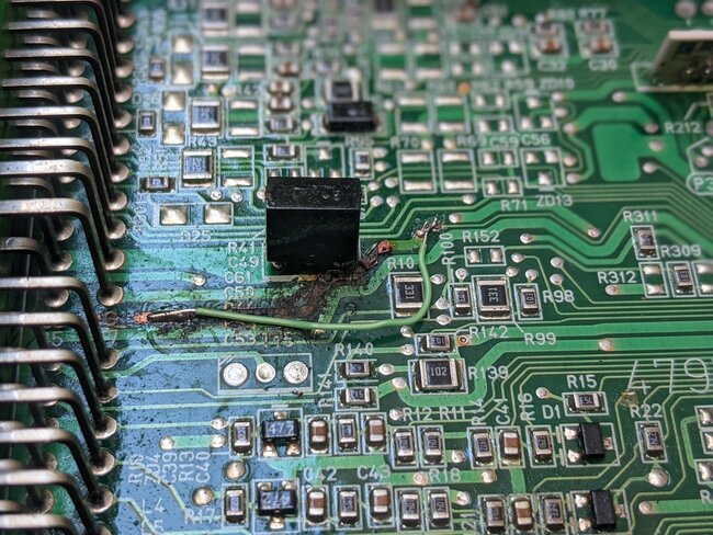

Hi Joe! Sorry for late reply. Dave's diagram is not compatible for my engine. I got a 3.1 4jg2 diesel bighorn. After some time of diagnostics, i found out that there is a busted capacitor in the ECM. Its 50v 100uf capacitor. I replaced it and voila! MIL shows up on ignition on.

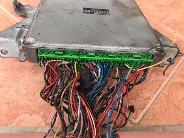

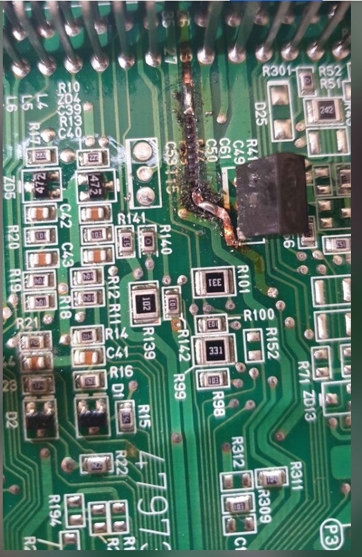

I have the same Bighorn surplus from Japan. I am wondering if you still have the picture of the capacitor location on the ECU. I bought this non-running unit and was told there is an ECU issue. Looked like somebody tried to fix it without knowing the source of the problem. I have attached the ECU with the burned trace. Hope you can help. can't tell what it is connected to. I can see it is connected to 3 of the pins.
Dec 21, 2023 at 5:34 PM
THAI YANGCO
  • 6 POSTS
At first, I thought it was the MOSFET but the burnt trace is not connected to the MOSFET.
Dec 21, 2023 at 7:43 PM
  • 54,840 POSTS
Yep, I don't know what that is? I would try to get a used unit by searching ebay.
Dec 22, 2023 at 10:27 AM
THAI YANGCO
  • 6 POSTS
I already bought a used ECU but if I don't find the source of the problem, it might just burn it again? I need to know what those pins are connected to.

Thanks for the ECM diagram. Unfortunately, it's for a 6-cylinder gasoline engine. I have the 4JG2 diesel engine with electronic injection control. There are two variations to this engine. One with mechanical injection control and one with electronic control (not the modern CRDI injection). I know it's a long shot to find the wiring diagram for this electronic injection control.

I fixed the burnt trace on the ECU but that didn't make any difference. The problem is that this car has been worked on before by some other "mechanic". So, i don't know when exactly did this trace burn. was it burnt by the guy who tried to fix it? or was it the original issue? Of course, I don't know if fixing the burnt trace fix the problem. I hope somebody here with experience with the 4JG2 can help.
