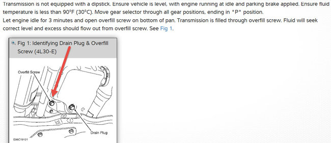

It does not have one. It has to be checked on level ground. See picture for instructions on how to do it.

I cannot find where to put transmission fluid on the engine. The dipstick/location is not there!

Your vehicle is not equipped with an ATF dipstick. You will have two plugs facing downward on the larger transmission pan. The plug higher up on the pan is the fill/level check (stamped/recessed into the rear right corner of pan). ATF should just dribble from this plug on a hot, idling truck, in neutral on a level surface. The lower one is the drain. The one at the back of the pan in a recess is the filler. You need a hand pump or something similar to fill it to overflowing then top it off with the engine running. Make sure you shift through the gears a couple of times when topping off.

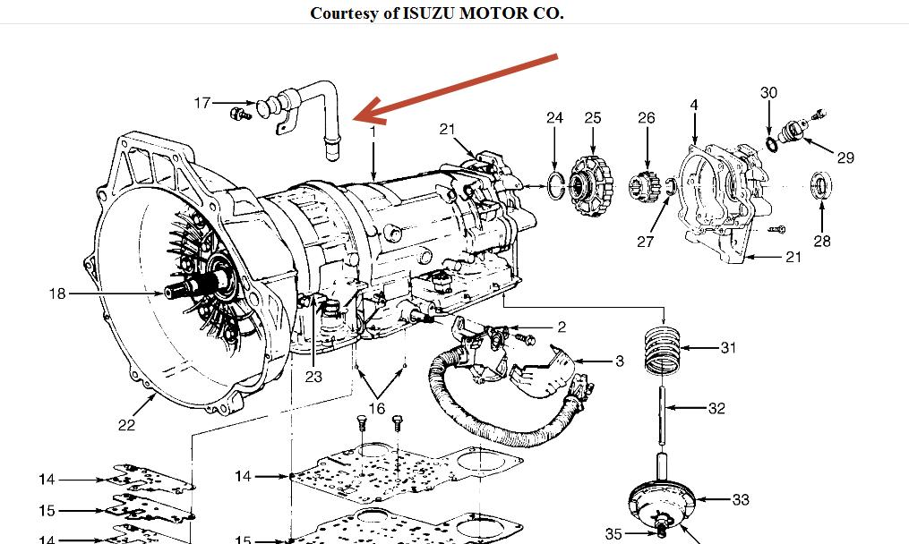

How do I add automatic transmission fluid?

The dip stick is under the car (#4) but you check it the same way this guide will help you see how to check the fluid with a diagram of the dipstick location below.

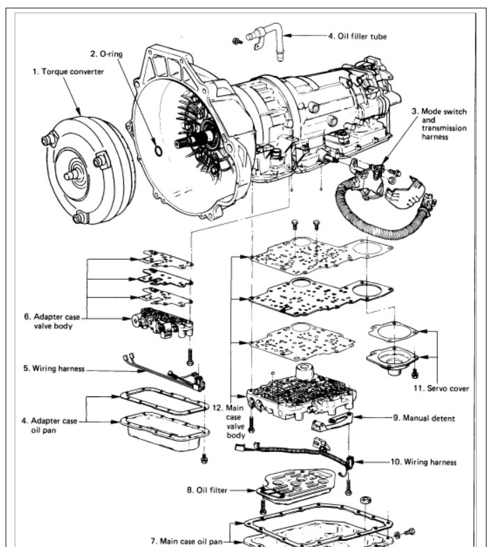

Where should transmission dipstick attach to transmission. What brand would be the best to install or easiest. Looking found a hole on passenger side of transmission towards the front of transmission is this the location? Or is it somewhere else?

The transmission dip stick is on the passengers side its a little short guy so you will need to be under the car to get to it. Click the image below to see.
